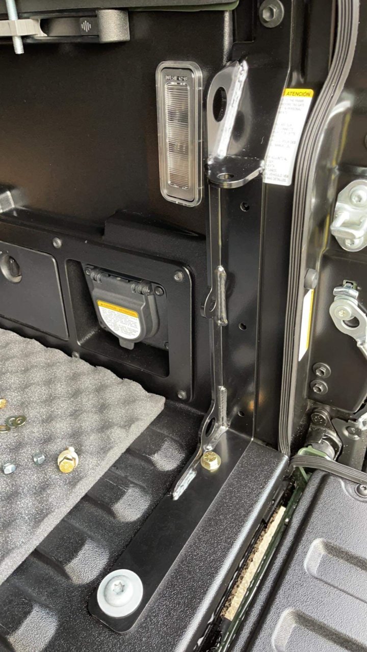

    Installed Raptor lights. Tapped in to the tail light fuse (under the dash) and they come on as long as the side markers are on rather than if just the headlights are on which is what you get if you tap into the headlight fuse under the hood.

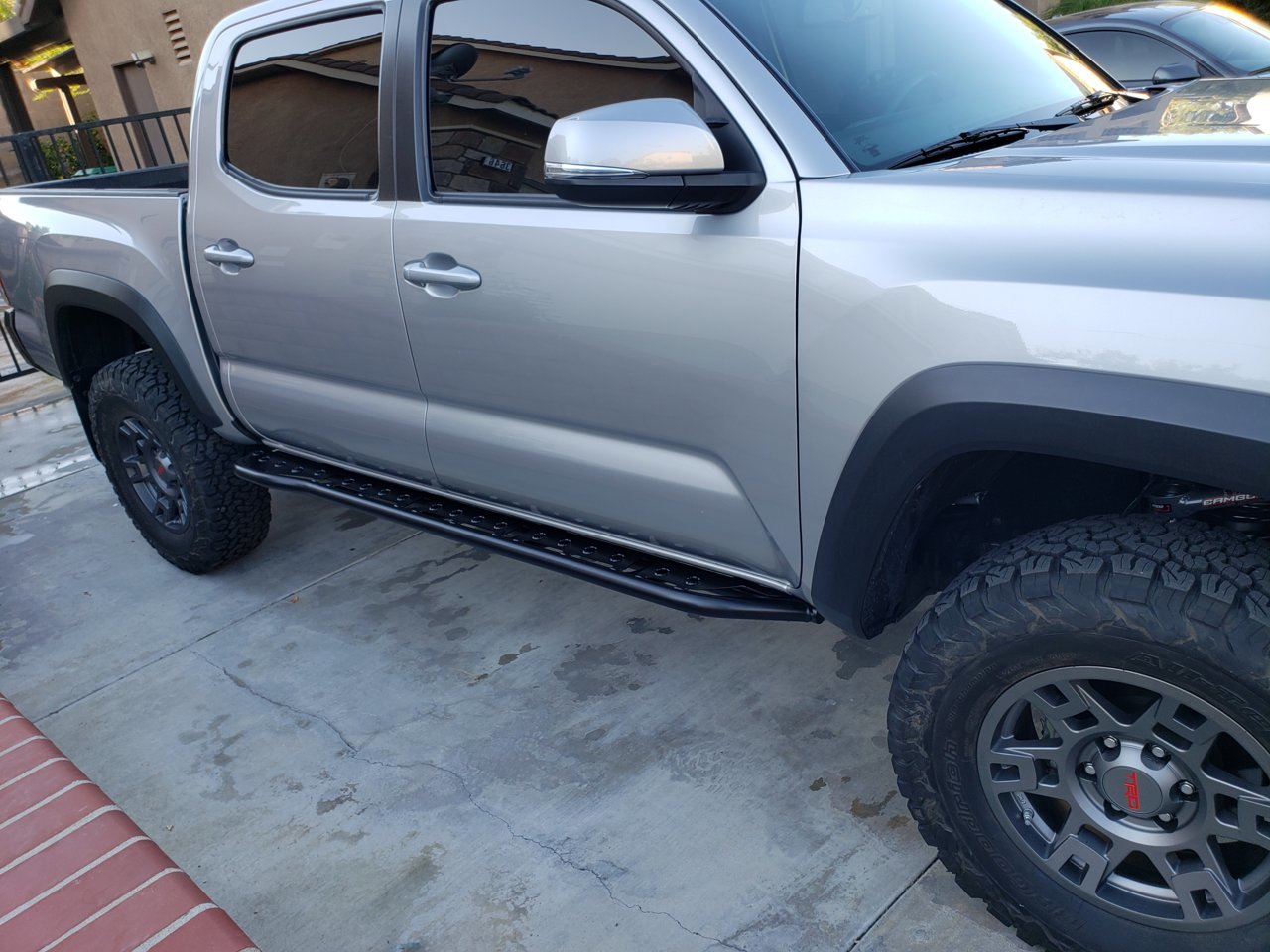

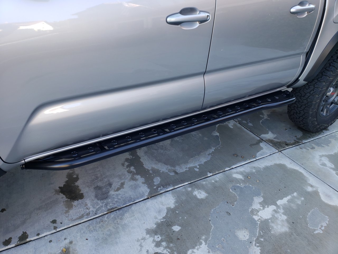

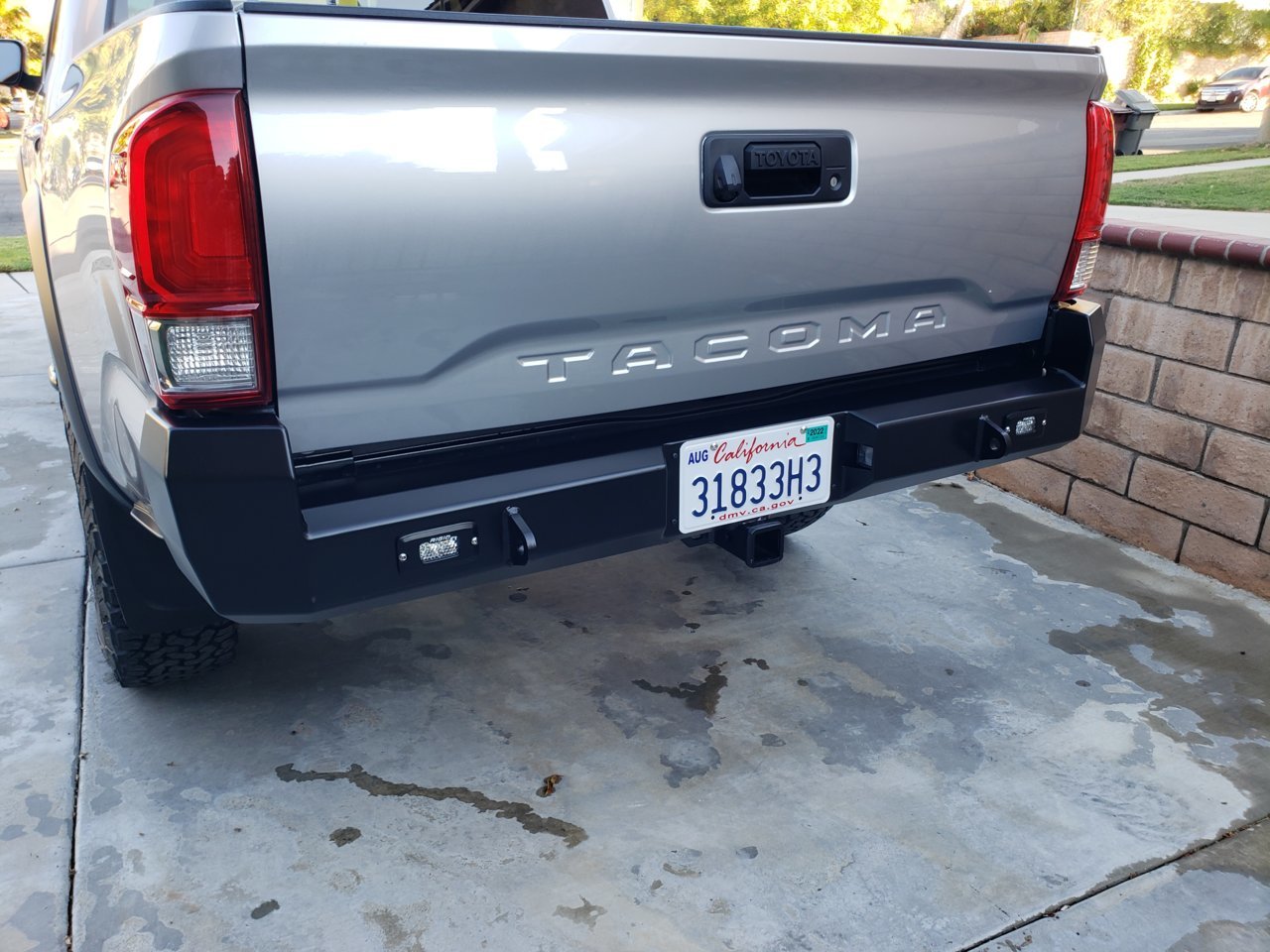

    Installed the 4xinnovations sliders and rear bumper. There may have been some cussin n swearin, but they're on. Solid doesn't begin to describe them. Still waiting on SSO for the front. 20211014_164748.jpg 20211014_164647.jpg 20211014_164711.jpg

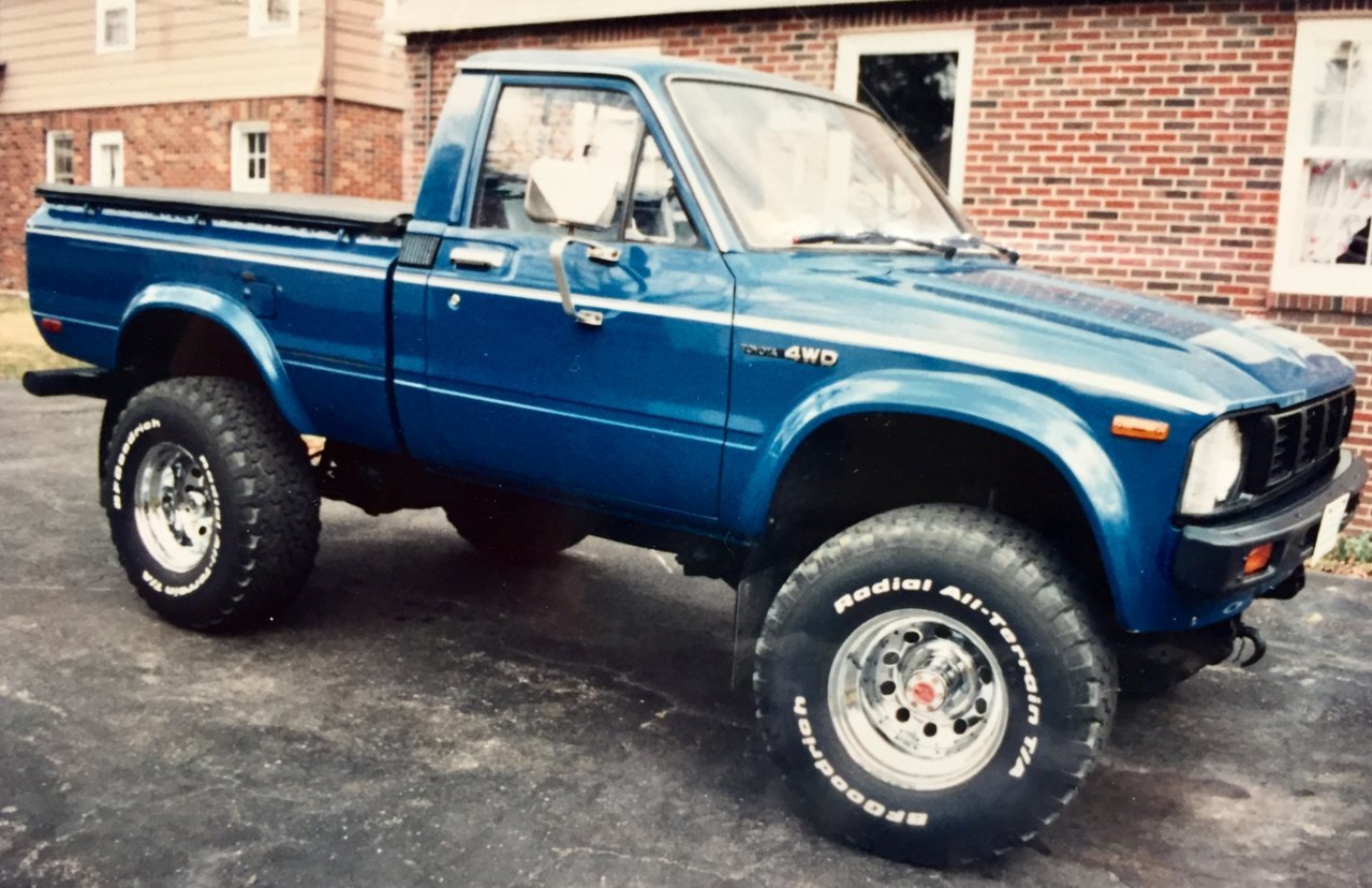

    4F4CC933-15EB-47F4-A126-39B935E57133.jpgOther than the two piece bed sides that rotted out, these were great little trucks, easy to work on, and looked good too!

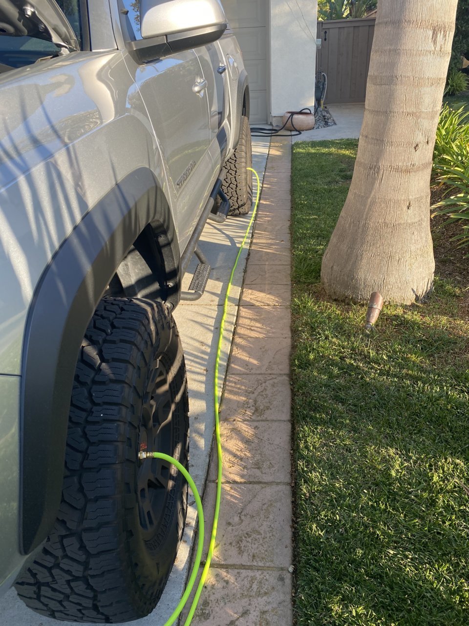

    Got the truck back after the exhaust reroute and had the ARB locker and compressor wiring and switches installed.
    huge props to Jason (@Speed Freek) for the work.
    finished installing the rest of the RCI skids.
    also got to play around with the Morflate.
    4 minutes from 15psi to 36psi.

    Are those the bolt on 4x sliders? Usable as a step for front and back doors?

    They're bolt on. They're high, so usefulness as steps, not so much, but you can step on em to get access to racks, etc.

    Got it, so useable to stand of at least. I really like the look of the 4x as they have some angle but they built the plates in nice and flat. Good distance from the sliders to pinch weld? I'm looking for some robust and good looking sliders and I keep coming back to the 4x ones.

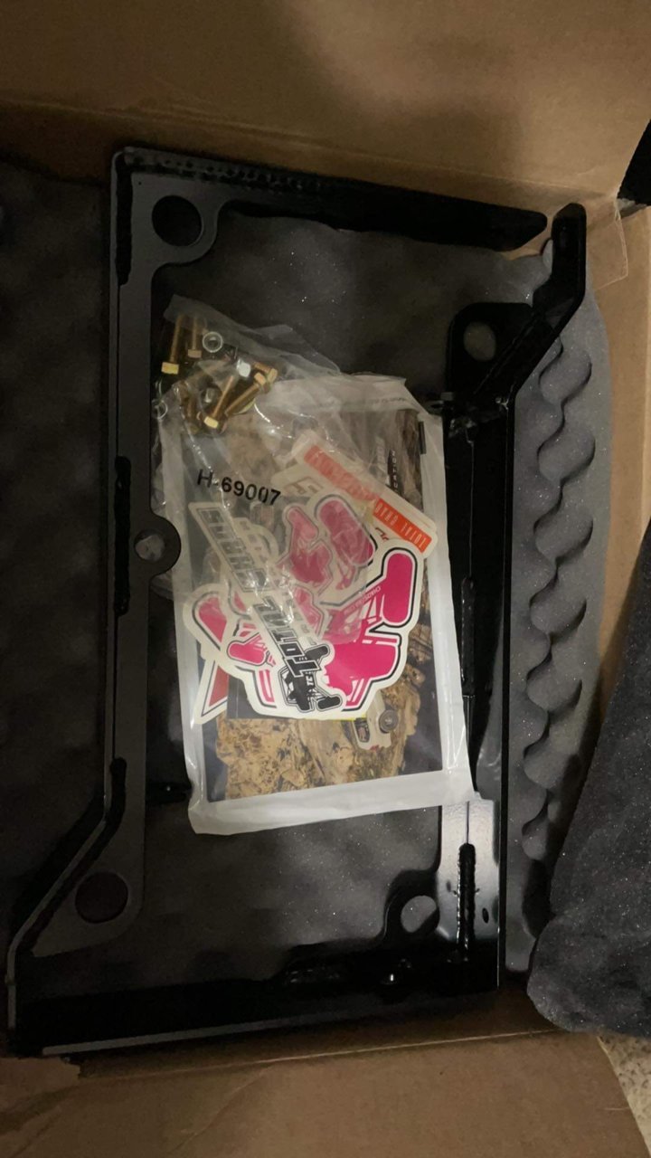

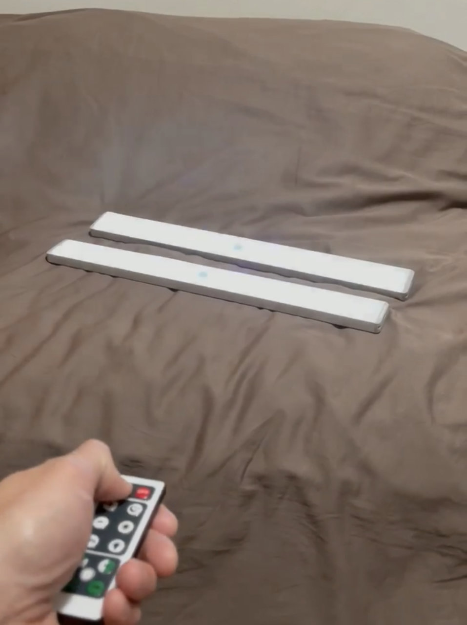

    Installed total chaos bed stiffener. Used Graphite on my RSI cap locks and it made it a lot easier to insert the keys. Also slapped these magnetic led light bars onto my canopy.

    Well!!! What the heck is that other stuff? o_O What is the remote for.:confused:
    We all got to know. :cheers:
