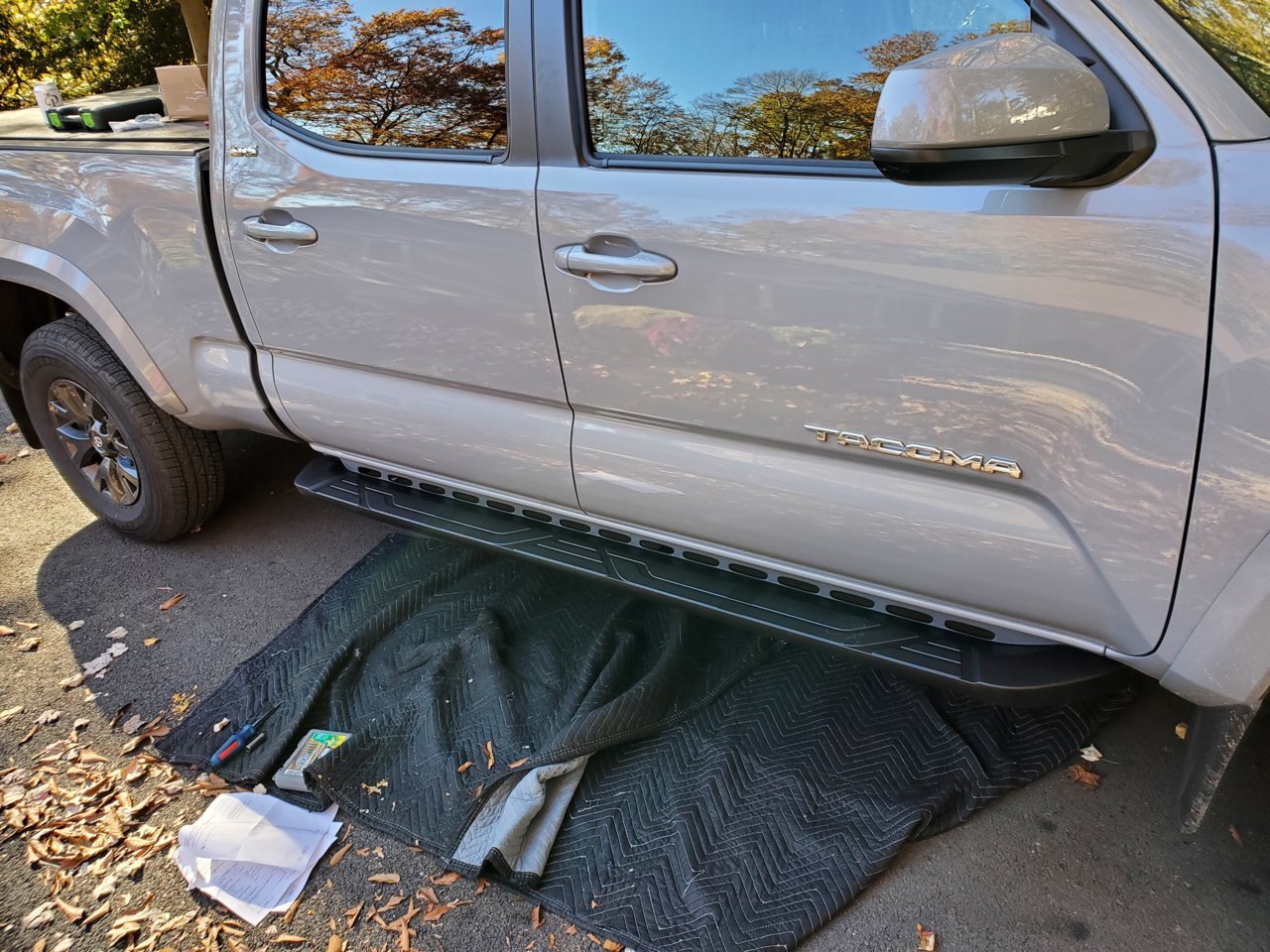

    New 2nd generation running boards! About $300 on Amazon, so after hearing good things (and that they fit the 3rd gen) I snagged them.
    I love the look against the Cement color

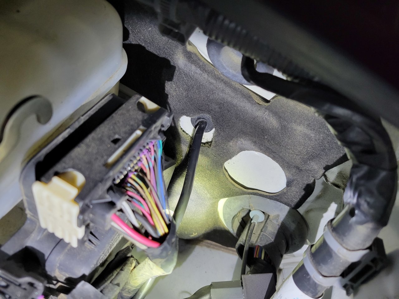

    Pro tip: there is a hole through the fire wall that has a grommet filling it. Drivers side of the brake master is where you'll find it...
    Pop the grommet out, put a small hole in it, spread it open with some needle nose and then put your wire through it. Now you have a clean hole through the fire wall without having to put holes in other grommets/ boots that wires are already filling or drilling other holes through the fire wall!

    Looks great!

    Thanks! Installation was pretty easy too, although like any running board it takes a little finesse to prop it up while wrenching in the first bolt. Having a friend around to center it would probably help.
    I like the style of this one, with a uniform height and plenty of room to step on it, without sacrificing ground clearance.
    Plus the accent of the black against the cement body is an appealing look. My 5'2" wife can now get in the passenger seat without having to do a hand spring into the cab...

    Does it function as an actual step when getting out of the truck, or is it in the way?

    Literally a steal Tom. They look great on your Cement. Only got mine for rocker protection from snow/ice/salt but I've come to love the way they look. And they're sturdy as hell.

    Good question, I'm fairly tall so I mostly bypass it when I hop in, but my wife loves it, and I noticed even the dog stepped out on the way down out of the cab today.
    On a practical level for me, it helped when I washed the top of the cab and if I need to reach over the front of the bed to drop something in.

    It's true, i noticed they were still in my Amazon wishlist and last I checked they were about $400, so I bought at the right time.
    But agreed, I highly recommend them for both the look and how solid they feel. I'm about 215 pounds and when I put my full weight on them the whole truck moves like they're part of the frame itself.

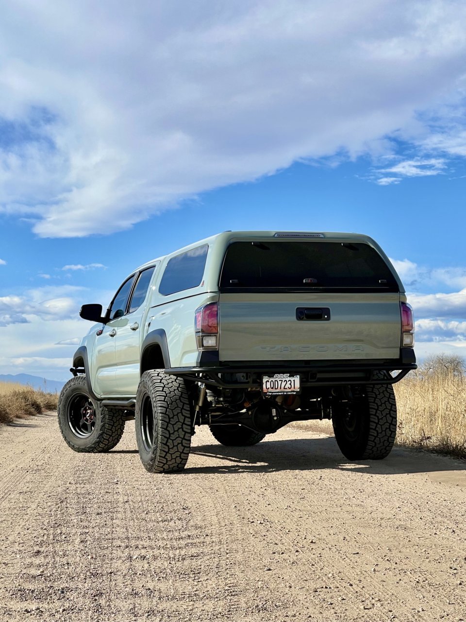

    Finished up some fitment and rear bumper stuff. Need to install rear lights and get some 35s :rolleyes:

    I really like the lunar rock. Sharp on your build.
