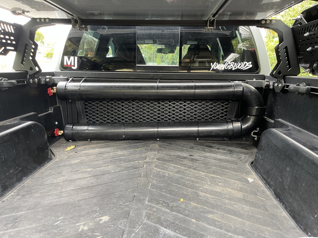

    6128714D-4D95-4329-B41E-AD0CA2BB1D2C.jpg Built water storage today. Wanted the weight low and forward. Works well as I can house pressure fill the bottom and vent the air at the top. Going to add a pressure gauge and schrader valve to the top spigot. That way I can use my compressor if/when I need more pressure. For now the 50-60 psi out of the tap works to pressurize the tank. Ordered 10 ft of braided 1/4 line and a shower head for showers if needed

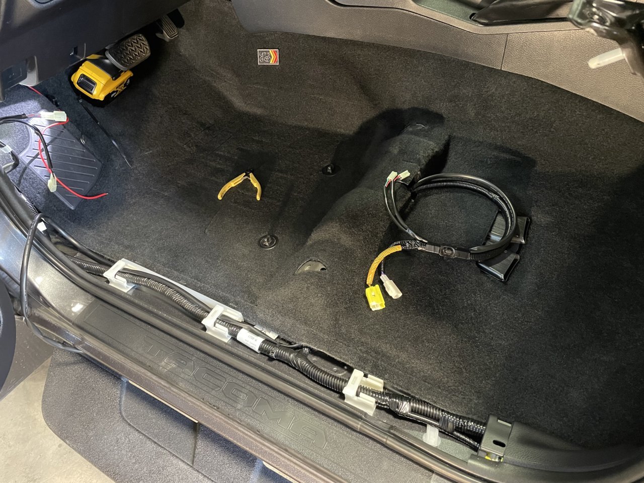

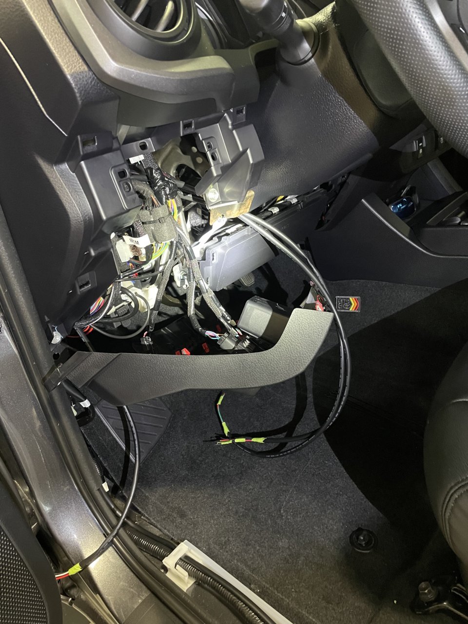

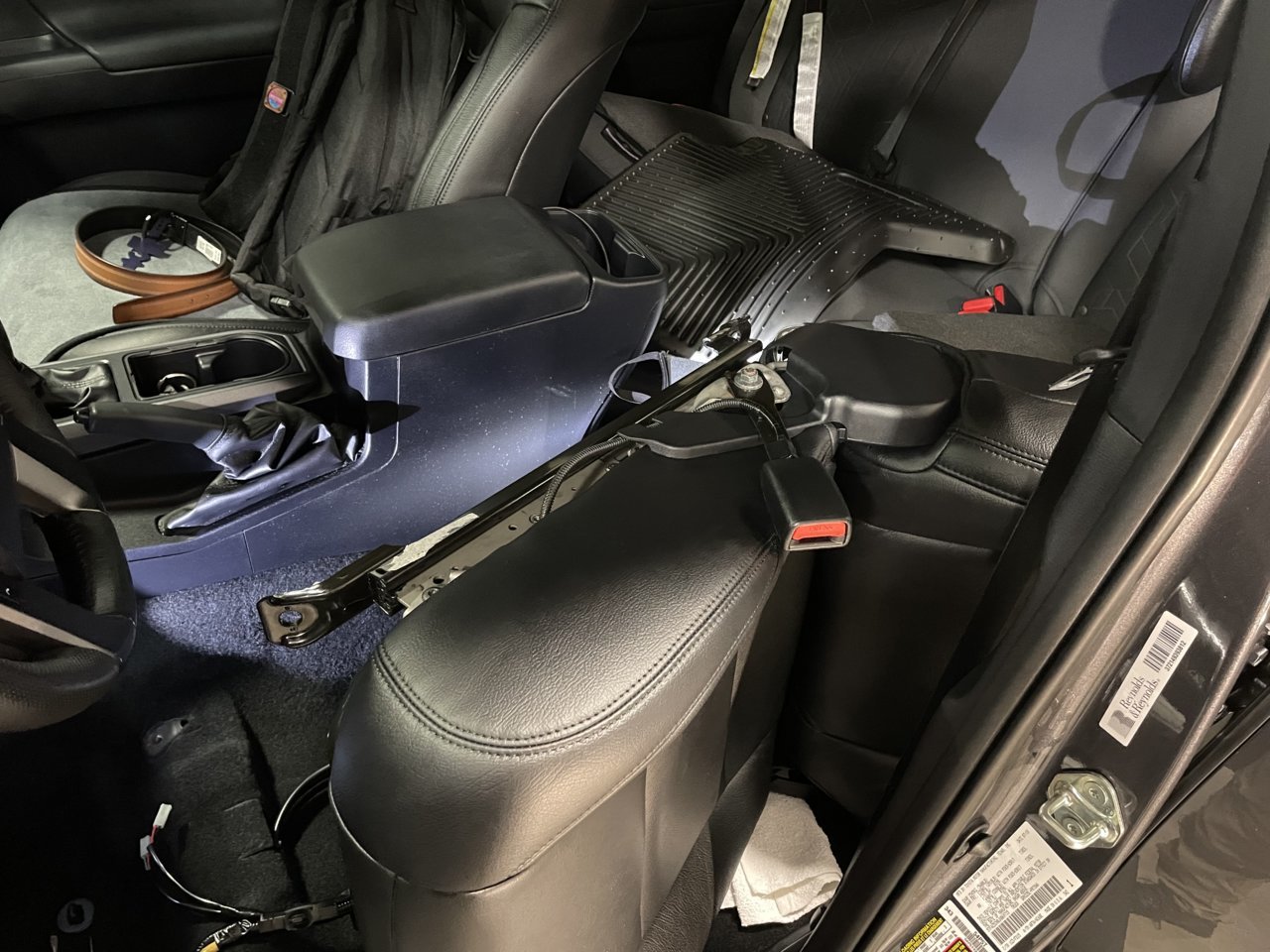

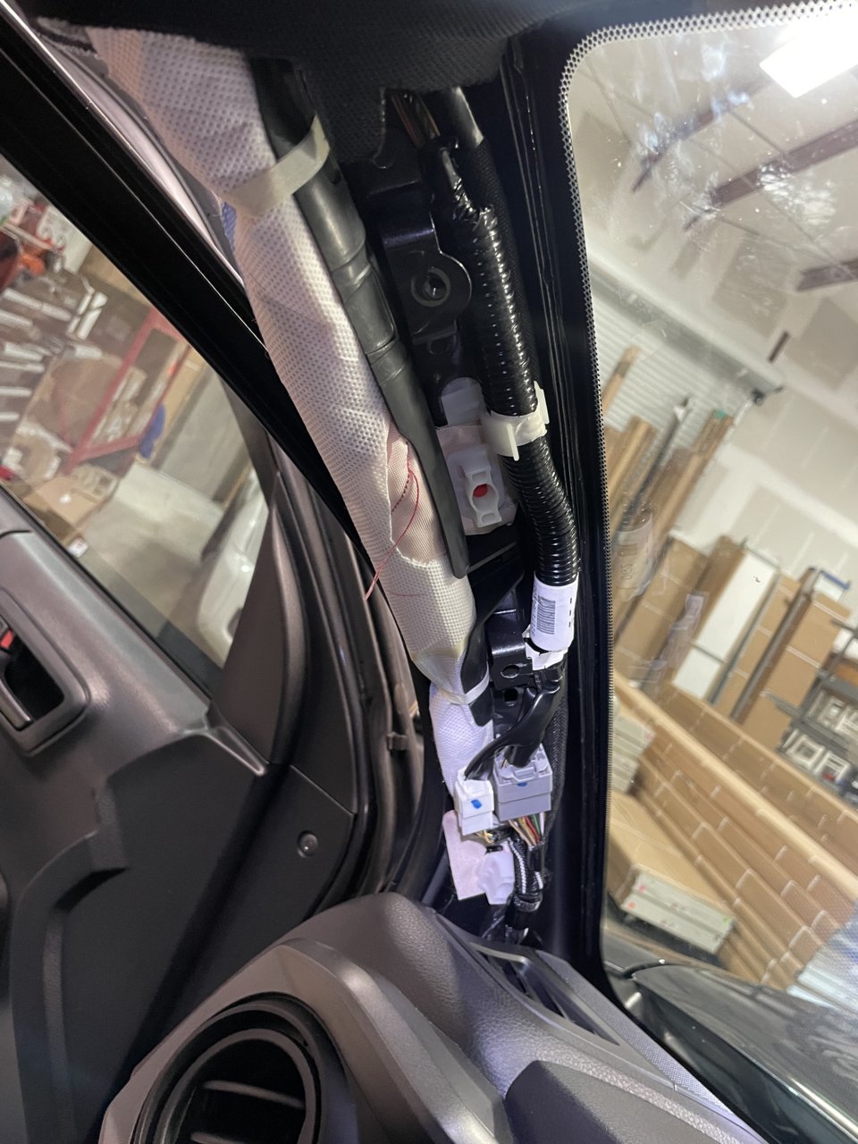

    Follow up- today I worked on the switch side of the harness. Actually it was 3 harnesses to be exact. (Side note: whenever I have a mod that intersects with another I try to do them together to limit the removal of certain parts (not if it’s a simple 1 panel step). This is why it can take up to a yr before I complete a project unfortunately between being side tracked or planning it all out.) So my seat heater switches I wanted in the overhead, I also wanted my front camera switch up top and to relocate my vsc switch from the top to below the climate control. With the limited space in the a pillar I left a void in the sheathing I used on the harnesses in order to combine all into a wrap around style sheath (this way I can add more wires for a forth switch). Now that the harness is ran I need to focus on painting the new switch panel/inserts to complete this 3 mod project.
    D8E63B87-EE29-419A-9895-BD24C495A7B1.jpg E6F1196E-C008-4886-937A-304B441F66A7.jpg F69F01AC-5081-4438-A1B5-E96ABA89E7A4.jpg AB28B7C5-6A4E-413A-B5A1-5939364706E7.jpg
    Was able to squeeze and tuck the harness in the pillar no problem. it’s barely visible, follows factory/away from airbag and no panel bulges when completed.

    How much water does it hold?
