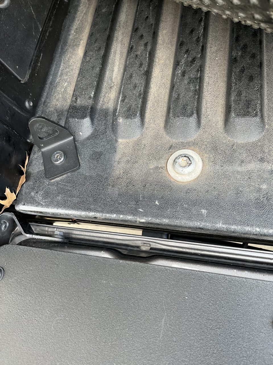

    Any help here? I underestimated the torque needed and stripped this while installing bed stiffeners. Was able to grab a different tool and do the other side just fine but now I have no clue how to get this one out with how well it’s in there. Hoping someone has been here before. Thanks in advance!

    Looks pretty well stripped...hit your local hardware store for a stripped screw extractor set.
    Edit: or, since that head is ruined anyway, you could use a Dremel to cut a grove to fit a large flat screwdriver.

    Yeah none of my extractors will do it because it’s just in there so damn well. The other side I had to get up in the bed and put all my weight on it with an impact just to get it out without stripping. Wish I’d known it took that or I wouldn’t have stripped this one with my feet on the ground. I’m sure I can figure it out. Just figured surely someone else has had this issue with so many folks adding bed stiffeners

    Try grabbing the shoulder of the bold head just above the washer with curved jaw vise grips.

    Not sure if these would work, they may as that bolt has a little bit of flat edge on it. Lots of different sets on Amazon find one that'll fit.
    https://www.amazon.com/Extractor-TH...ipped+Bolt+Socket&qid=1638055623&sr=8-1-spons

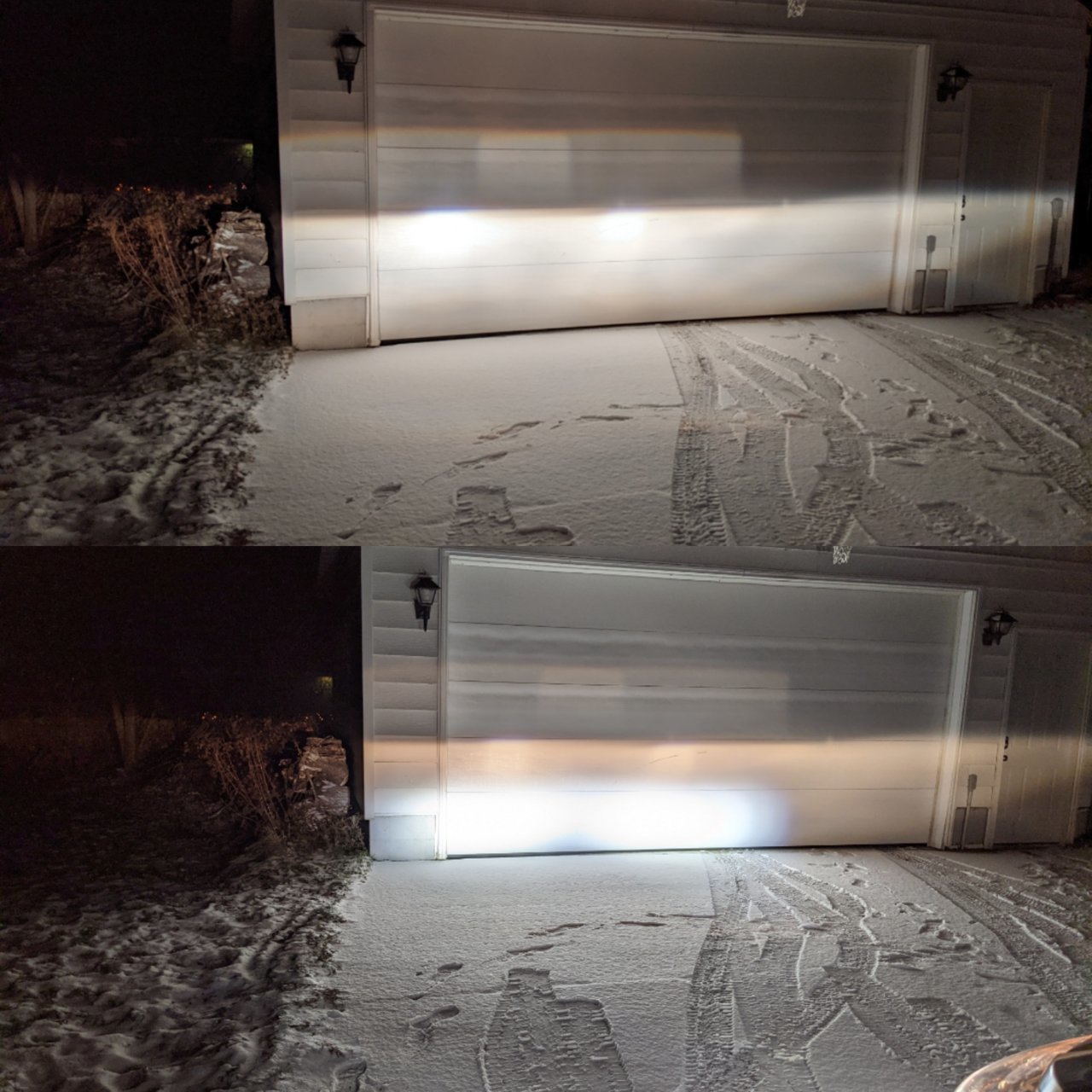

    Got my Diode Dynamics SAE compliant SS3 fog lights today and put them in. holy cow are they bright! On the road they drown out my headlights. Not sure if too much lol

    You'll be getting flashed at if you use them on road!!
