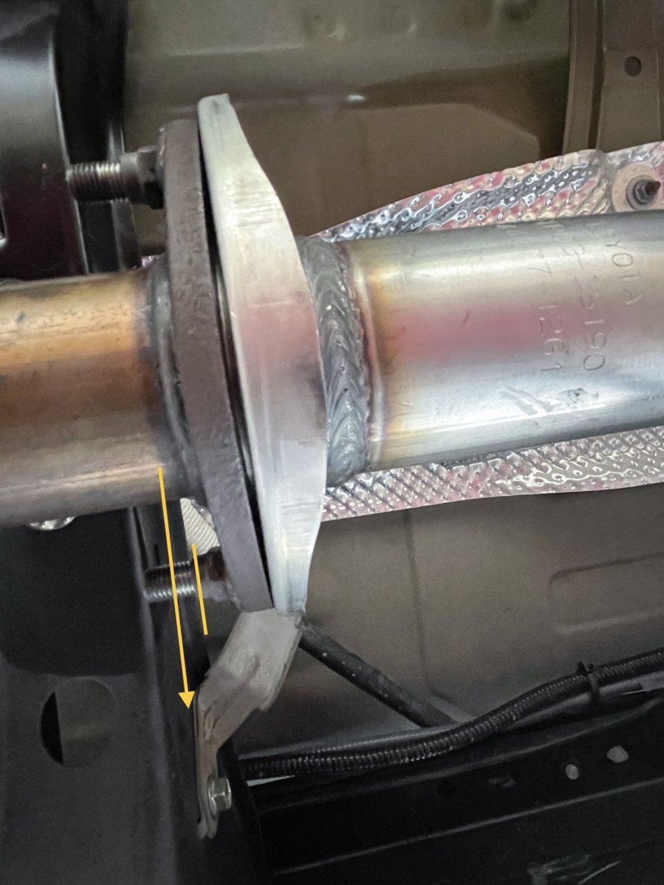

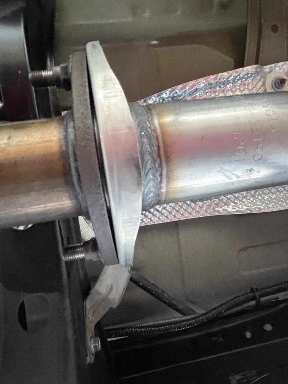

    Sure doesn’t look it. Were the faces flat when you started?
    Is it leaking?

    Some flange clamping systems have strong coil springs with longer bolts clamping the flanges together. That way the flanges don't need to distort in order to provide pressure to the gasket.
    Of course, the sealing gasket is "special" for such systems. sometimes donut shaped.

    The stock exhaust flange is thicker I believe and I didn’t pay enough attention but assume it was more flat. The trd exhaust flange seemed thinner with a rolled edge. I’ll look at the stock flange again

    yea the stock exhaust flange is thicker than the trd. Same thickness as the other half pictured. The trd is ss and thinner- the edge is rolled but if you look at the bolts you can see a difference in old exposed threads to now exposed (looks close to a 1/4” more threads).
    Unless I was supposed to bang on the exhaust to get a better seat I just lined them up and started threading the bolts evenly until torqued.

    Like you said, there's two different mating surfaces. The trd flange looks flat while the oem appears to have a slight curve. You've torqued it and you have the new gasket to seal up the difference. I'm sure you'll be fine the way it is. Don't over think it. :burnrubber:

    I seen the bolts with springs on another flange opposite of the y (near the cat). This flange was just bolts with the welded on nut. That’s what I’m guessing is that the new exhaust being thinner has more flex than the thicker stock. Gasket did get replaced and it’s not leaking (I’m assuming when ppl say leak it’s a liquid leak).

    It looks odd for sure, but as long as its not leaking, don't sweat it.
    It almost looks like the new pipe simply bent inwards when it was torqued.

    You ever have to beat on one to seat it or just butt up against and tighten

    I send it. I would likely try a bigger gasket in my tool box to try and compensate for the bend on this scenario though. Not sure.

    It’s probably the angle- I’d say the oem (left side) is flat just for the fact how thick it is and the trd (right) has the slight curve from torquing the bolts. It’s thinner and slightly bent the flange in versus pancaking the gasket.
