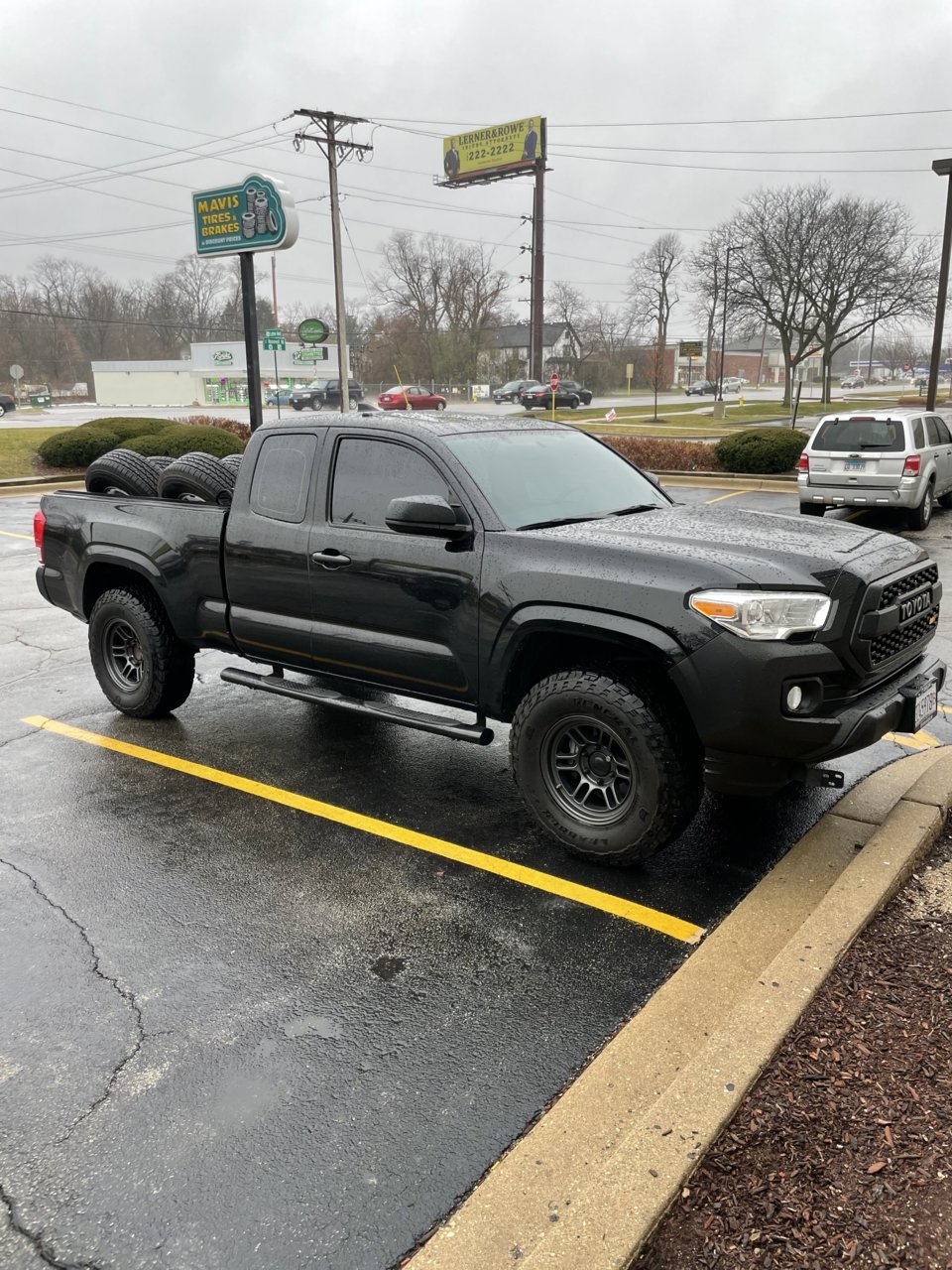

    9638861B-28E0-44F5-AB1F-3F4B24099A72.jpg Found a good deal on some new wheels/rubber. Very happy with getting rid of the stock steelies.
    also got some desert does it seat jackers installed, that’s exactly what it needed

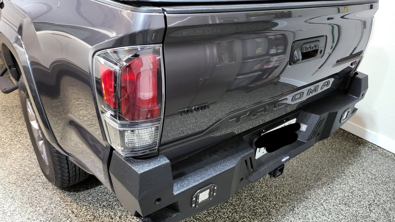

    I finished the Sso full plate bumper install today. I was kicking myself for not thinking ahead....ORDER a winch selenoid mounting bracket from an aftermarket company! I was looking online yesterday, and they are all only like 35 bucks. I soent most of today fabbing my own bracket. What an ass ache. But, u luckily had a sheet of 1/8 inch aluminum that i could use.
    Factory 50-whatevever winch link/hook going on tomorrow.
    In my opinion, washers are needed for the mounting bolts, the bolts are just barely not wide enough when torqued down. So i added washers.
    Also, the winch mounting bilt holes almost made me slam my head on a wall. In the future, i recommend drilling a hole theough the bumper, so you can mount the deeper holes and not break your hand. Plud the holes you drilled with a rubber cap. Something else i thought of after the fact. If i evwr have to take it off, ill be drilling those holes
