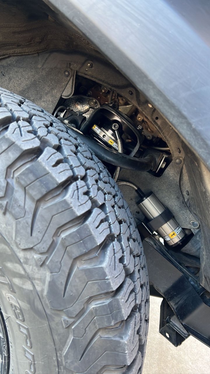

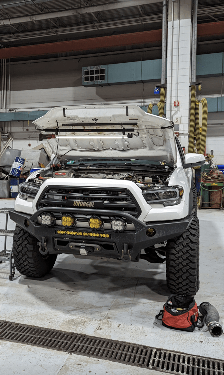

    Installed OME BP51 in the front.

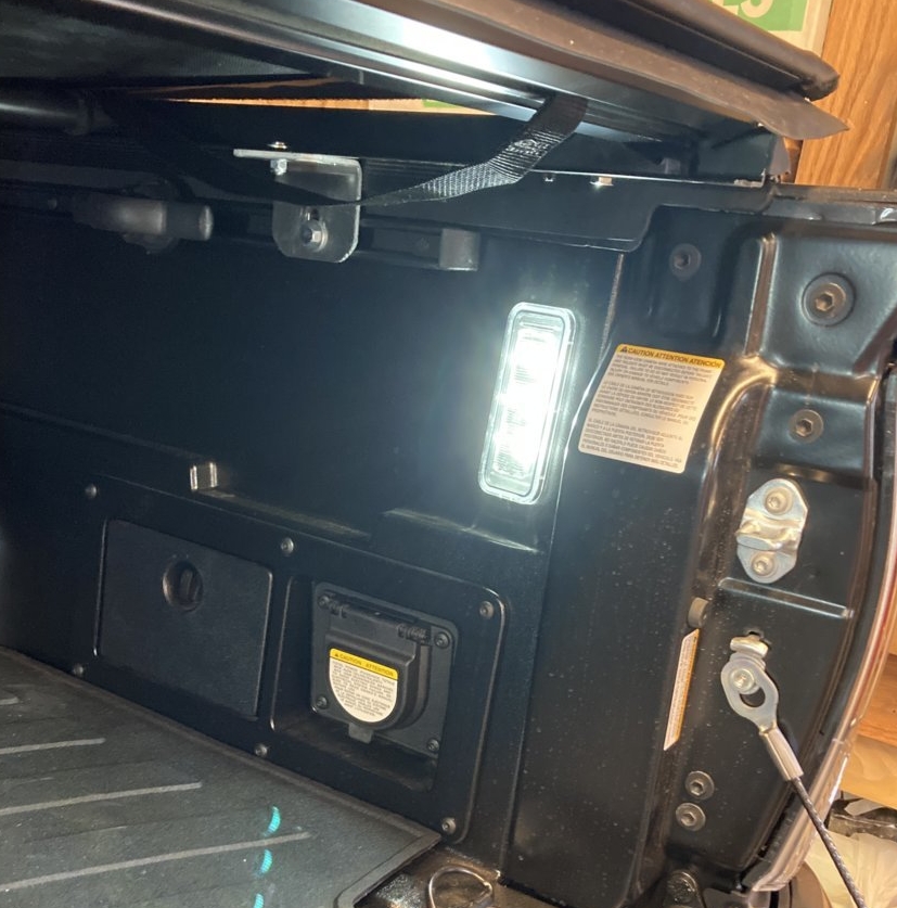

    I'm really been pushing it, I've racked up 71 miles on my new '22 :). Not many mods left, today I added bed lights from Amazon, using the existing prewires. Took about 20 minute total. Especially nice when you have a tonneau cover.

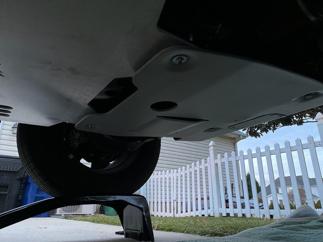

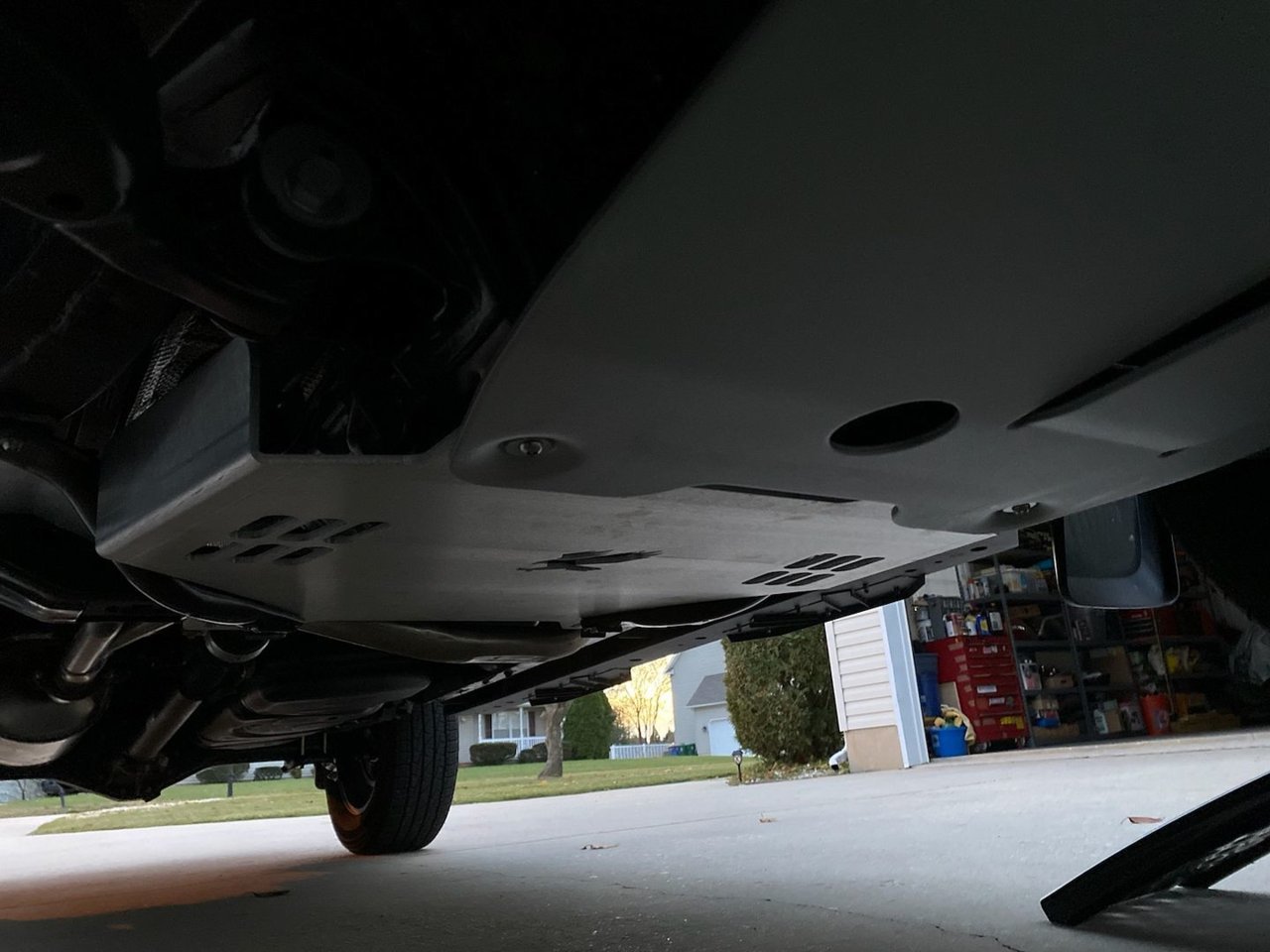

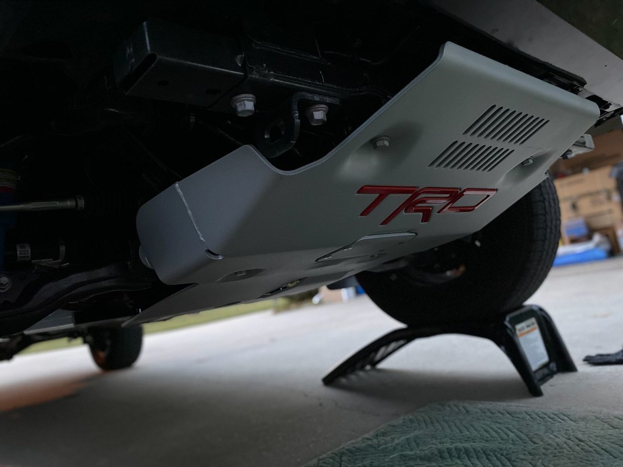

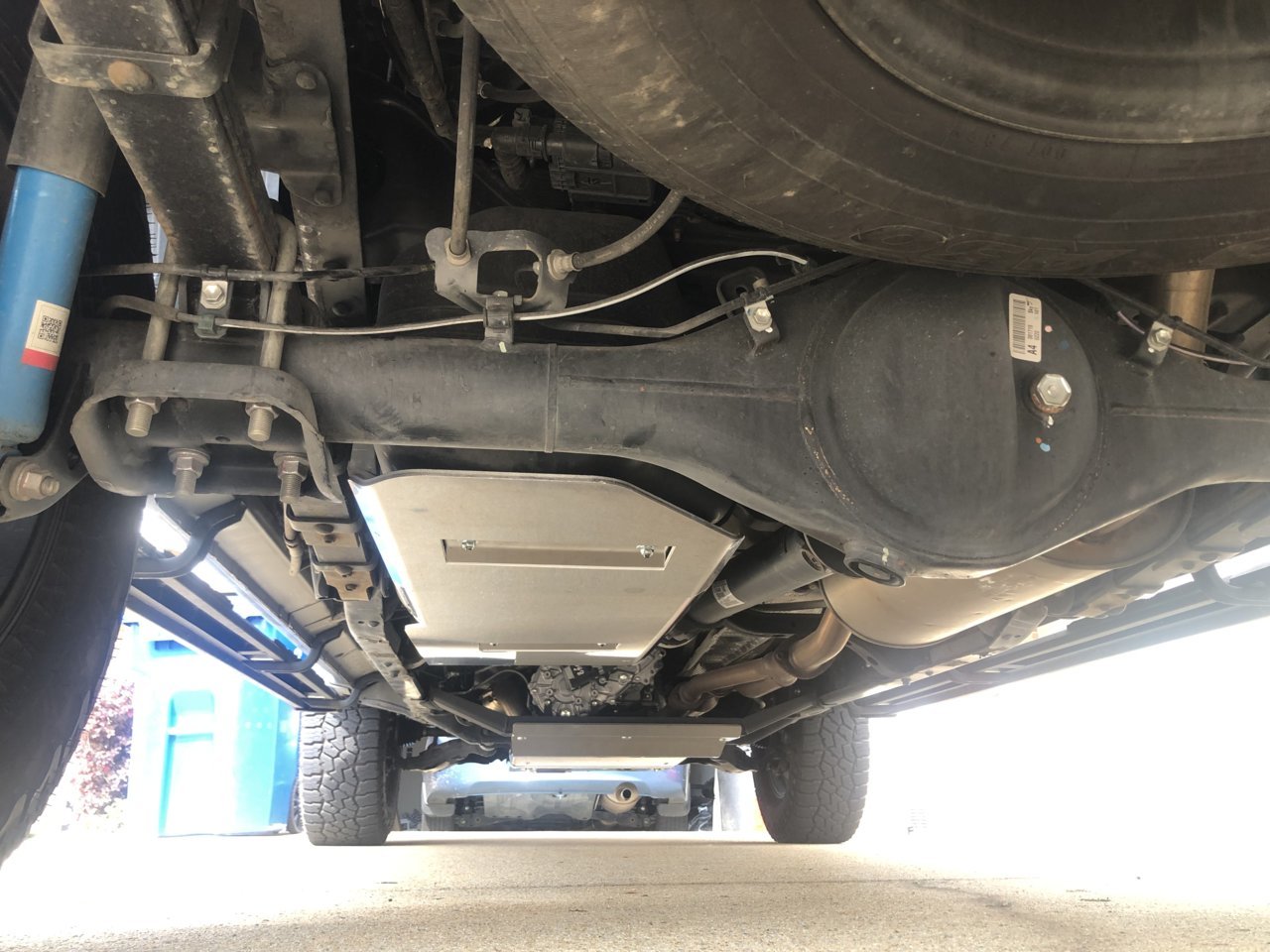

    Added TRD Skid Plate to mine! Married it to the Talon CAT plate:

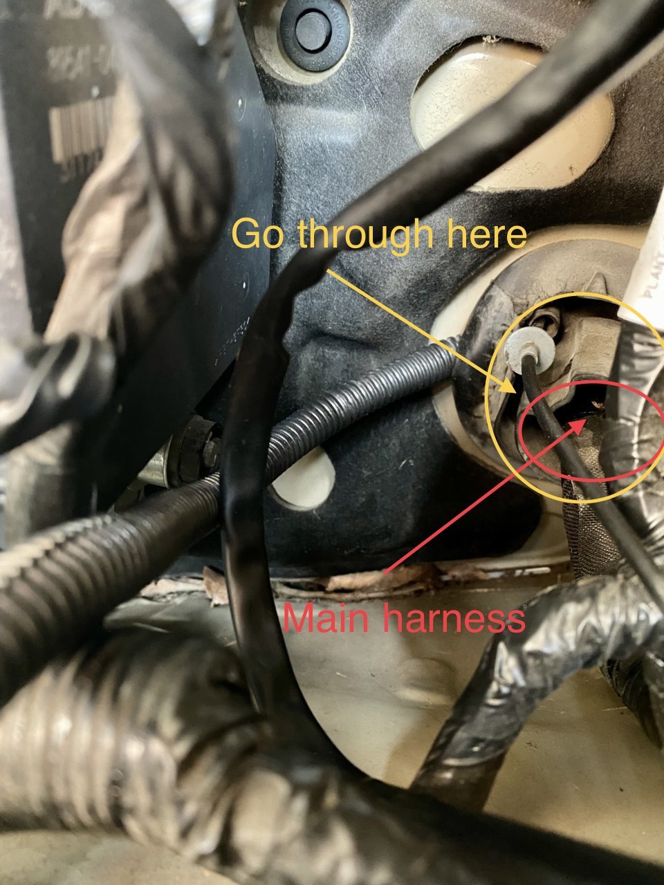

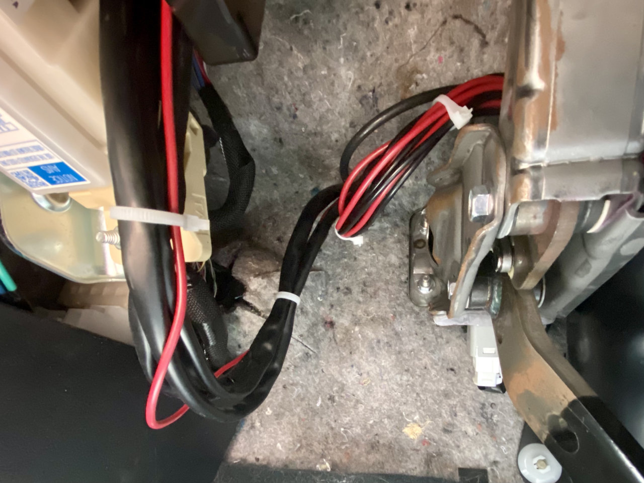

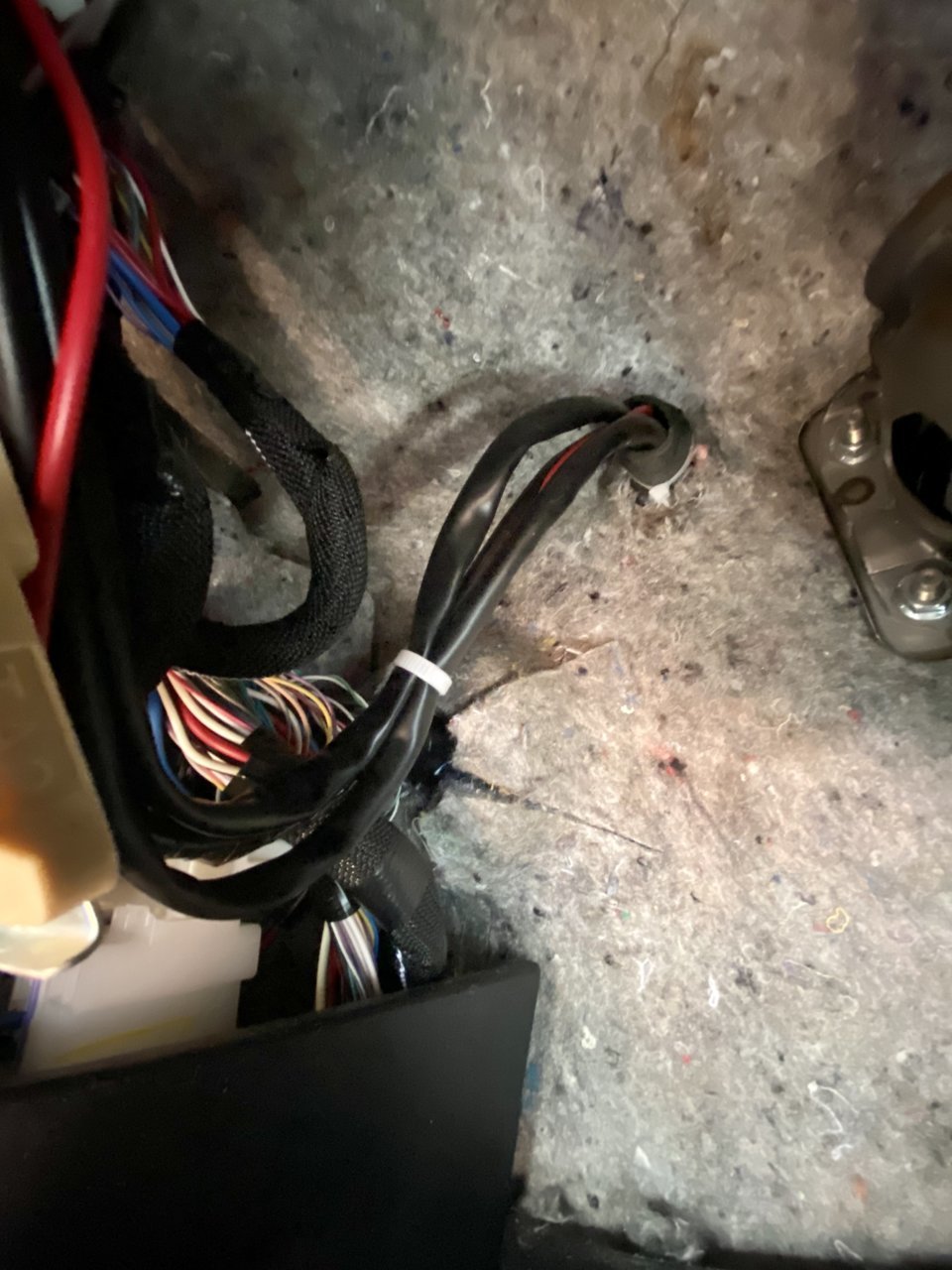

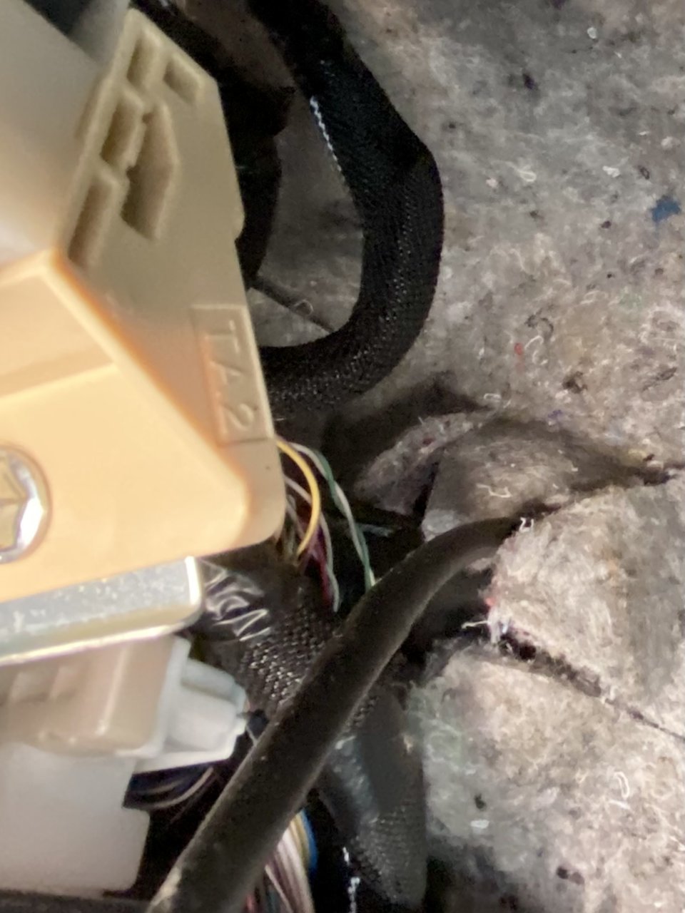

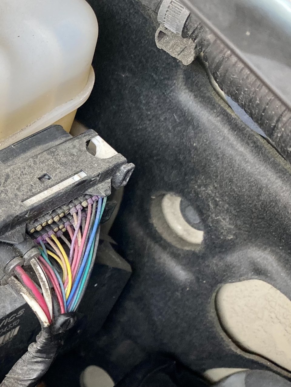

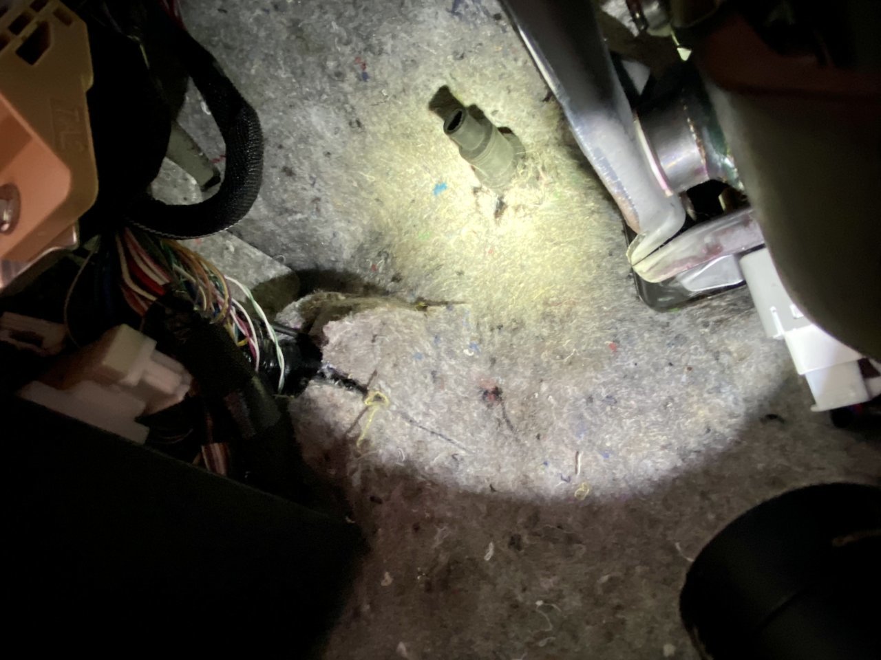

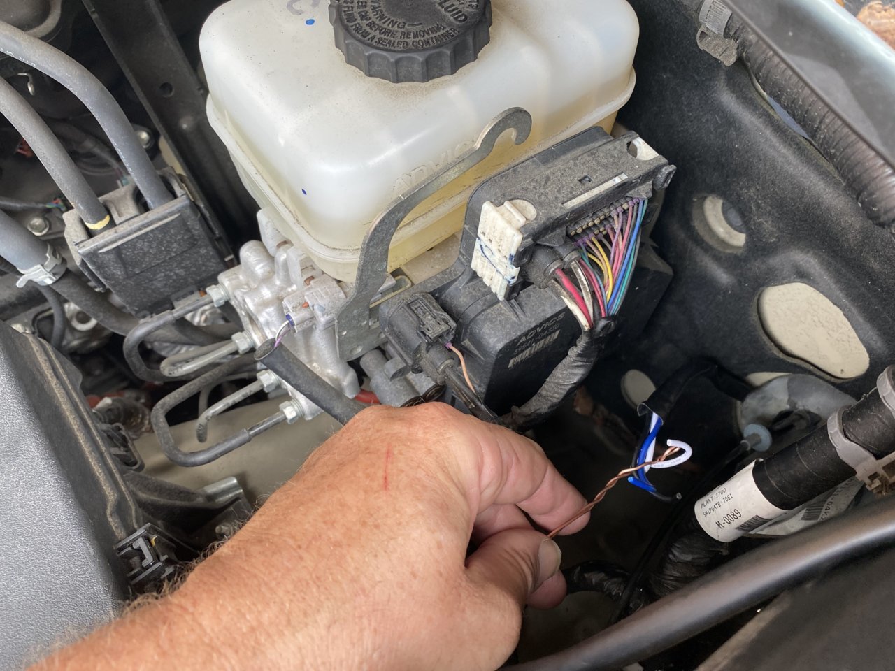

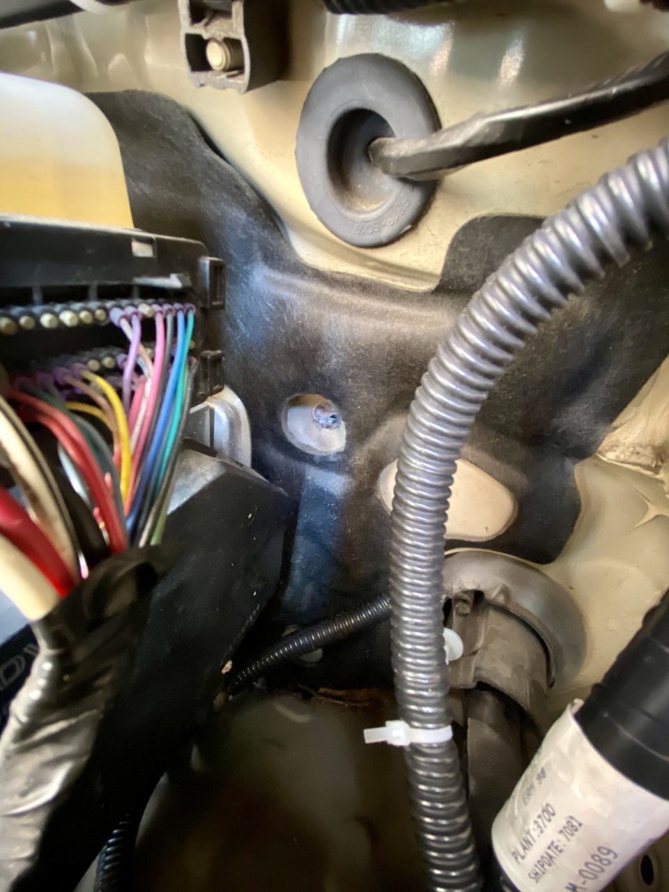

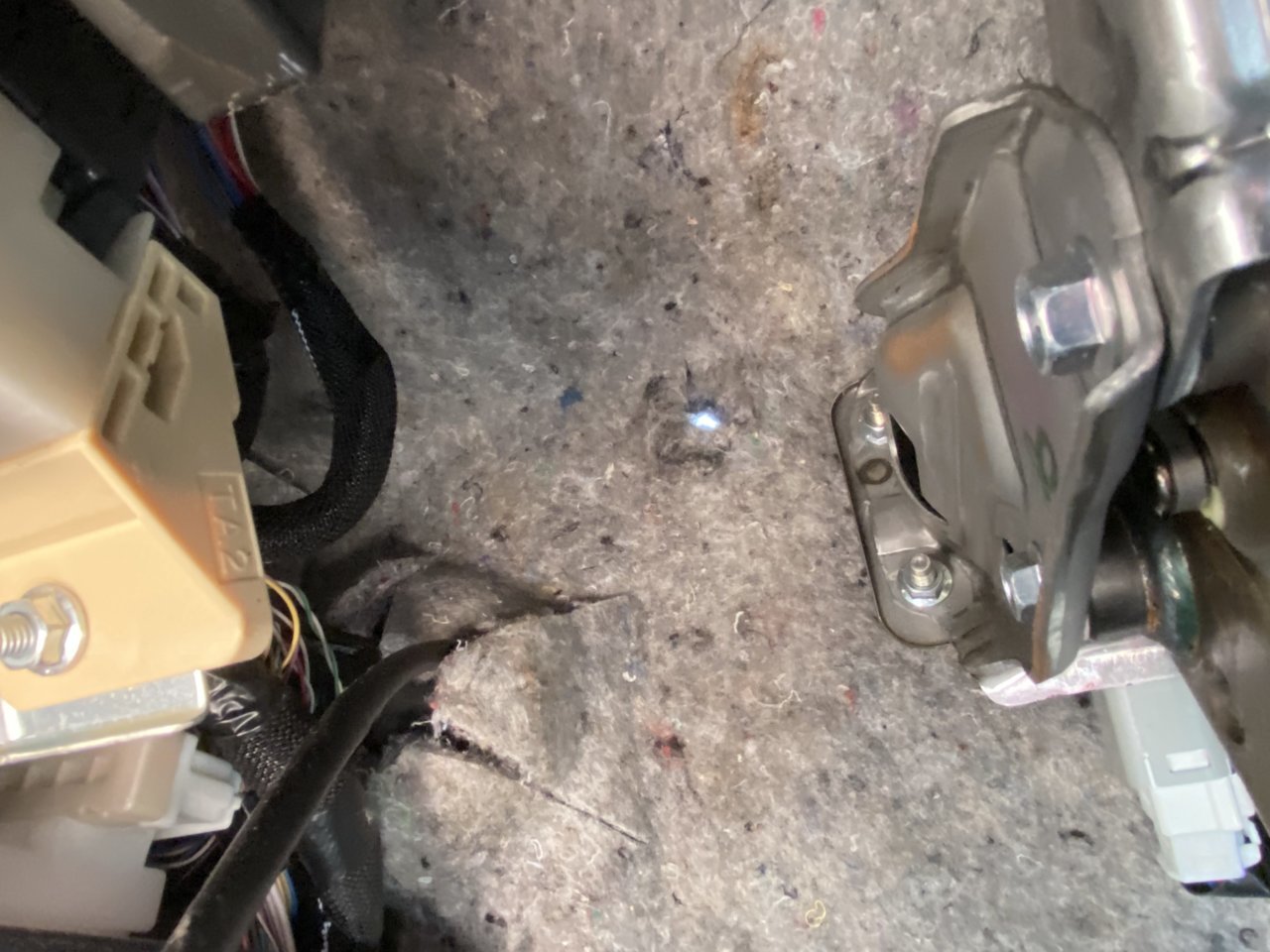

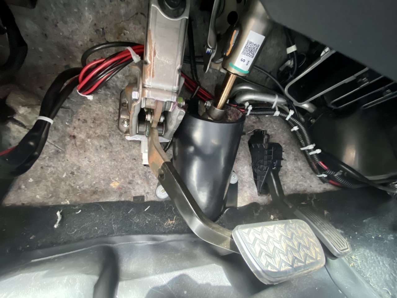

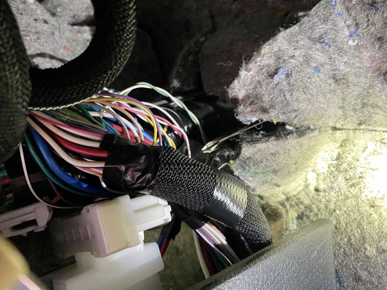

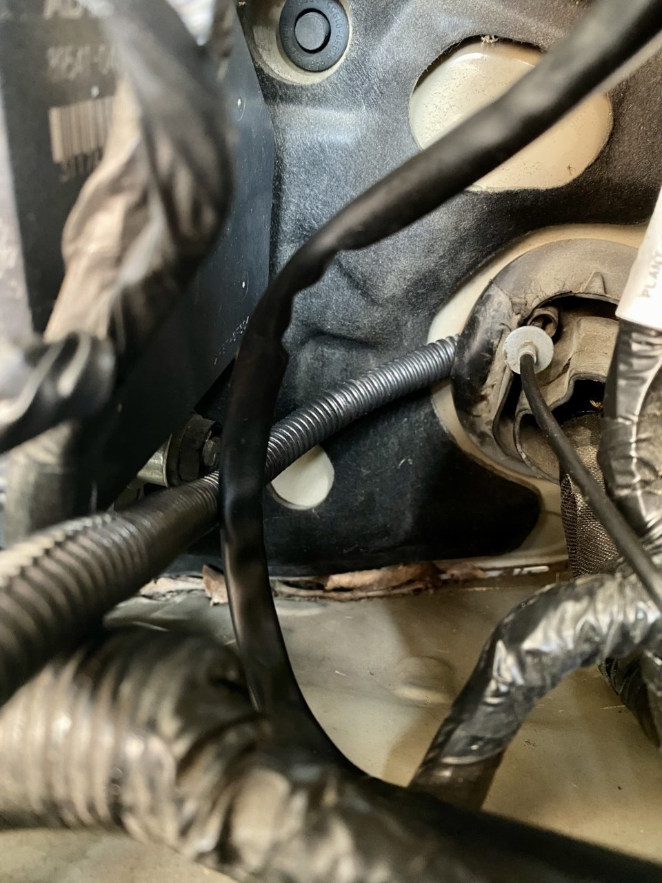

    Please don’t do it like this (or recommend), “the easy way”! I know I’ve said it before but I don’t understand how everyone seems to pass the obvious- there is a perfect solution for everyone and definitely better than pushing the grommet away to go against the sheet metal. Will work for multiple wire bundles
    everyone has the main harness which has an extended rubber sleeve but outside that extended center rubber sleeve (the same area that cable is ran through which we will call the outer perimeter) has multiple ridges/valleys that you can pop your wire through… again multiple ridges that are away from the main harness to pull your wire bundles through. Go inside the cab and light the gromment up and take a peek. Best to pop the hole from the inside and pull your wire in. I say that because I found it best to see each ridge from the inside so you can space apart if you like. And if you want to be extra smear some silicone around the newly passed through wire harness.

    Yeah, the "easy way" is eventually going to result in a ground fault. Hopefully the easy way also includes a fuse before reaching the firewall. If not, it will eventually fail in spectacular fashion.

    good write up, thankfully that’s the spot I’ve run my switch leads through. Getting close to any factory harness with a sharp edge makes me nervous. Any more accessories and I’m going to have to run an aux beam or switch pro. Much easier

    Right and it’s just not proper. I mean bypass the sole purpose of a grommet
    The good thing about using this grommet is you have a buffer against existing wires and can I say it enough… you can pass through multiple bundles in its own spot. :rofl: Hopefully more ppl see these post because I do have to say his detailed how to with pictures is impressive (just wish the “easy method” was also correct)

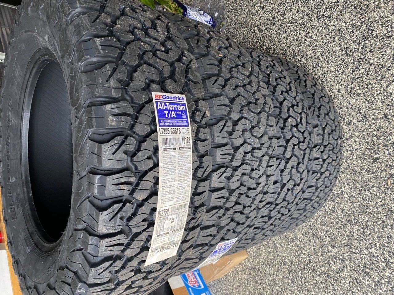

    F15FC7C0-D5B8-4970-920C-1C756D14AFE4.jpg 17x9 method Bahia blue wrapped in 285/70R/17 BFG KO2
