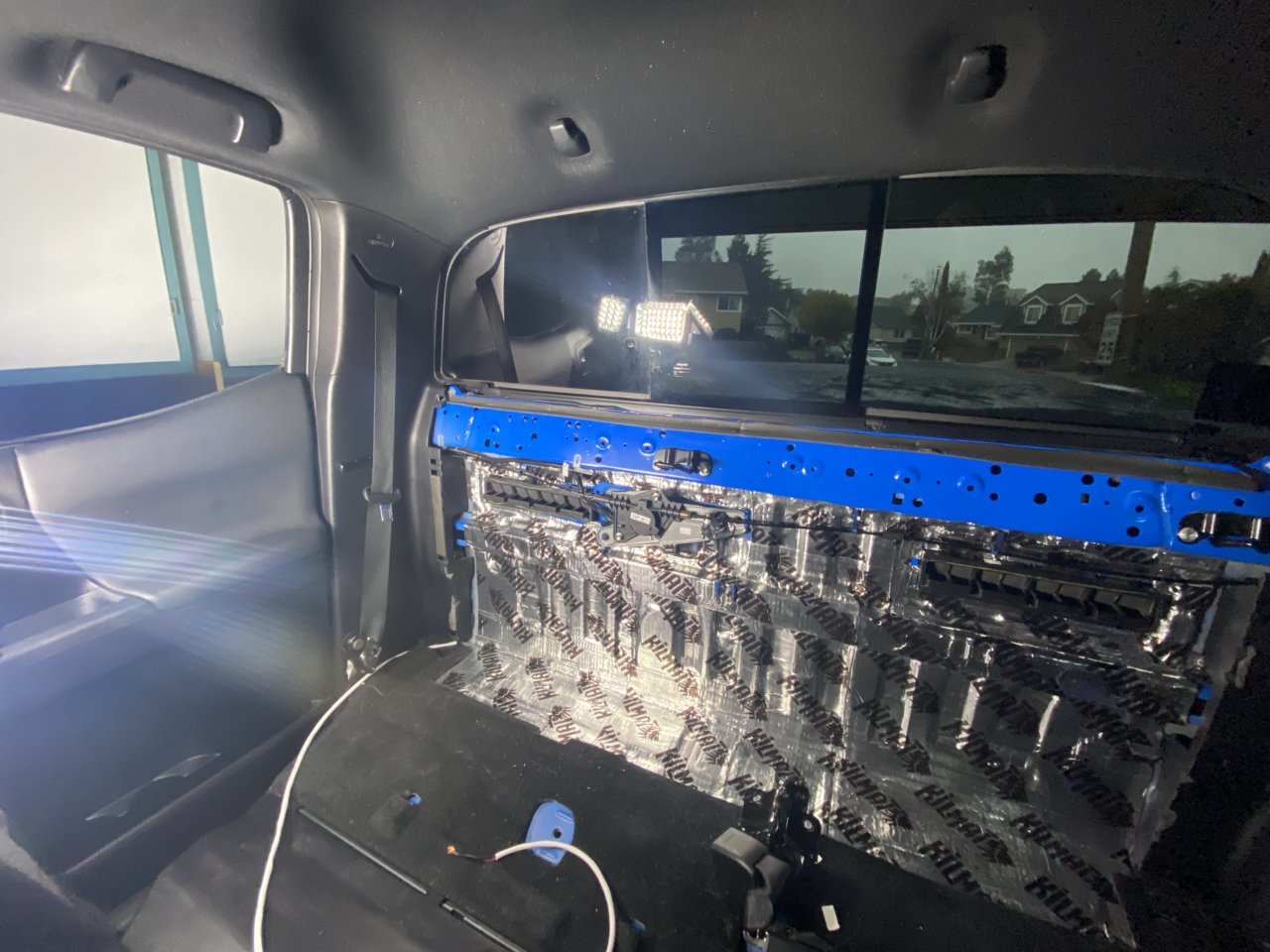

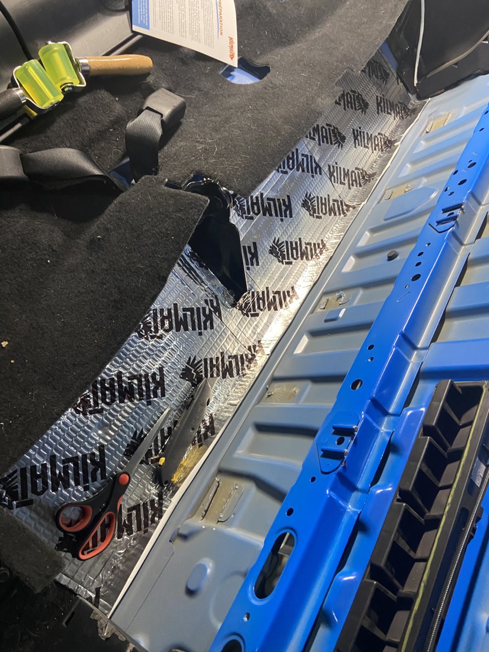

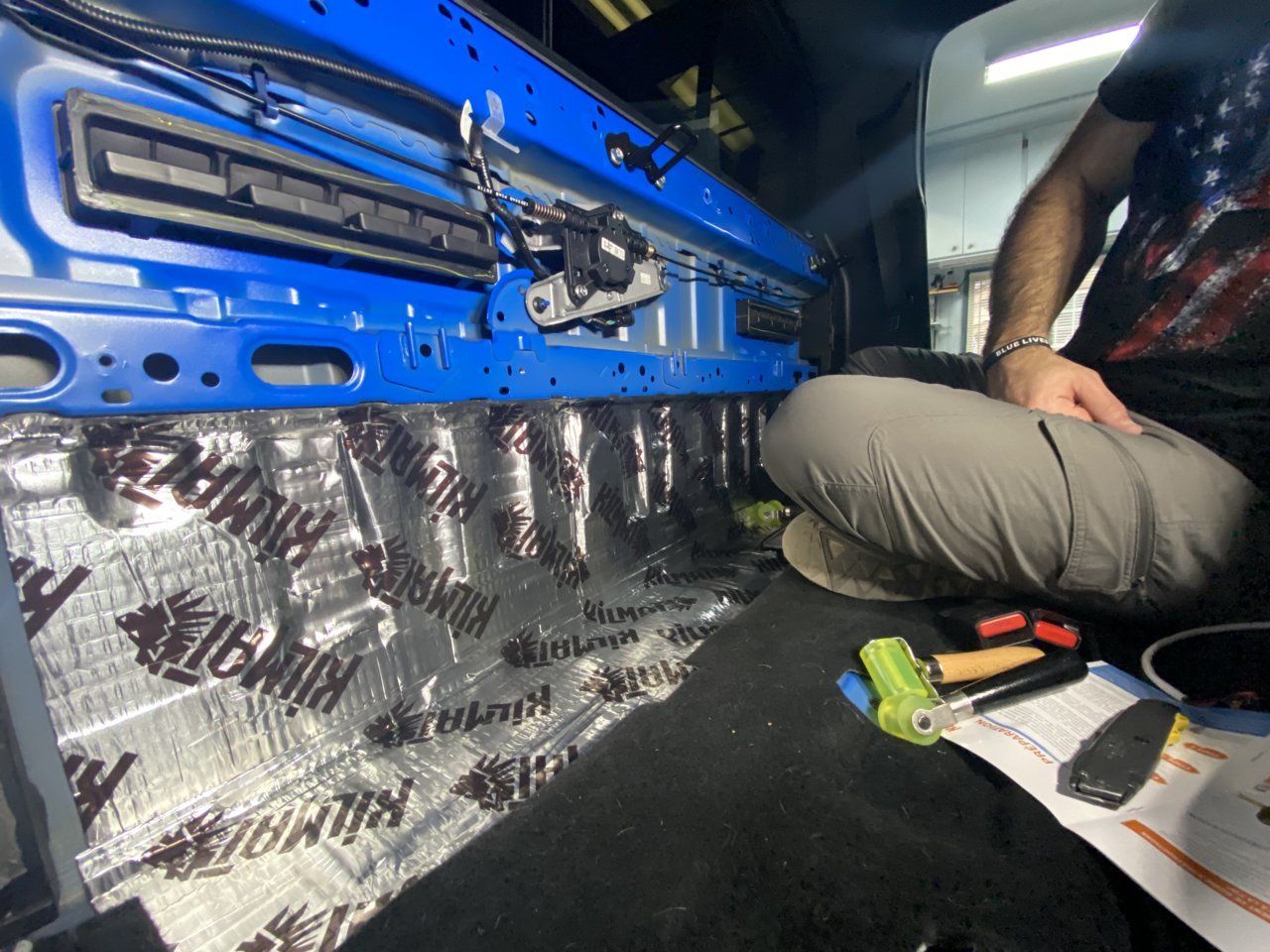

    Well this happened today! What a difference. Just the back wall and it’s so much quieter!

    Oh man thats awesome!
    Details?

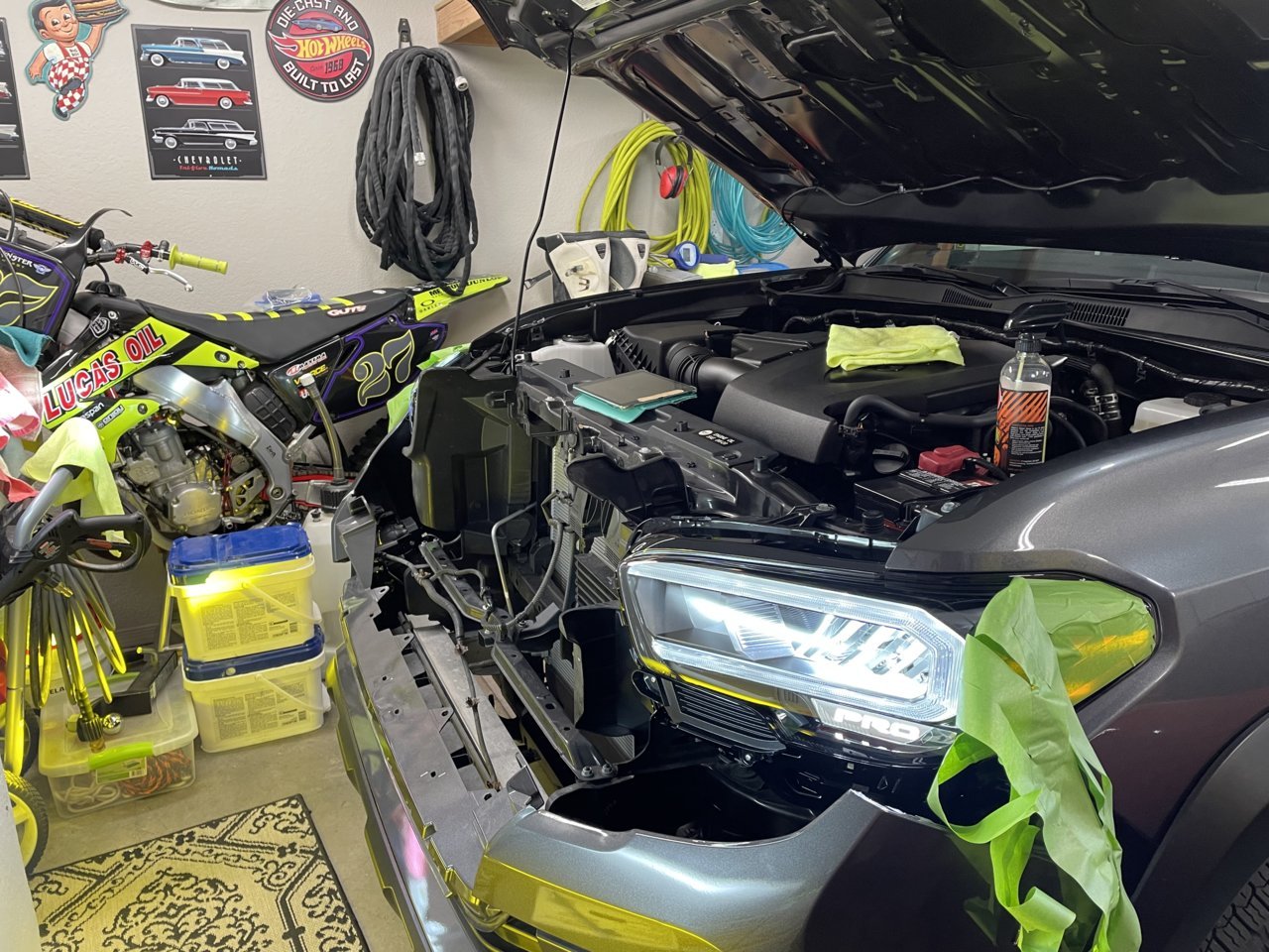

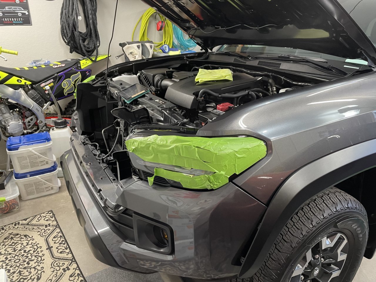

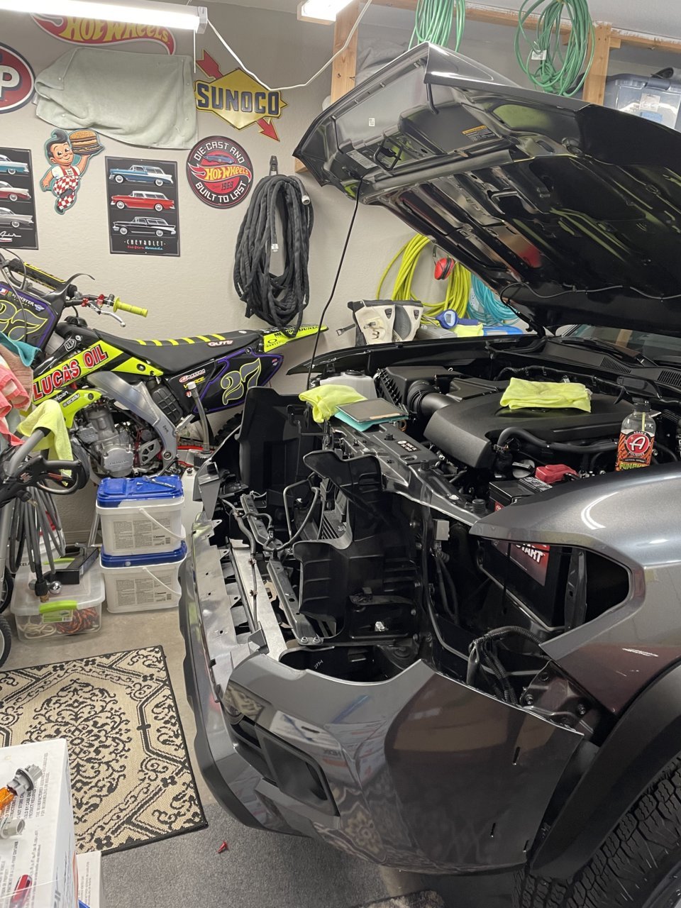

    Made some progress on swapping my oem trd pro led headlights this afternoon. They're installed and working correctly, but the front bumper clip is fighting me where it connects to the front fenders. Decided to walk away for a bit. 90 percent done though...

    They are Bright!
    :thumbsup:
    Defiantly an improvement.
    Applied dielectric Grease at the connections. These are nice, happy with the purchase.

    Same problem. Lemme know if you figure it out. Mine is on but somethings not quite fully connected.

    What problem are you having? Won't snap in or won't stay in?

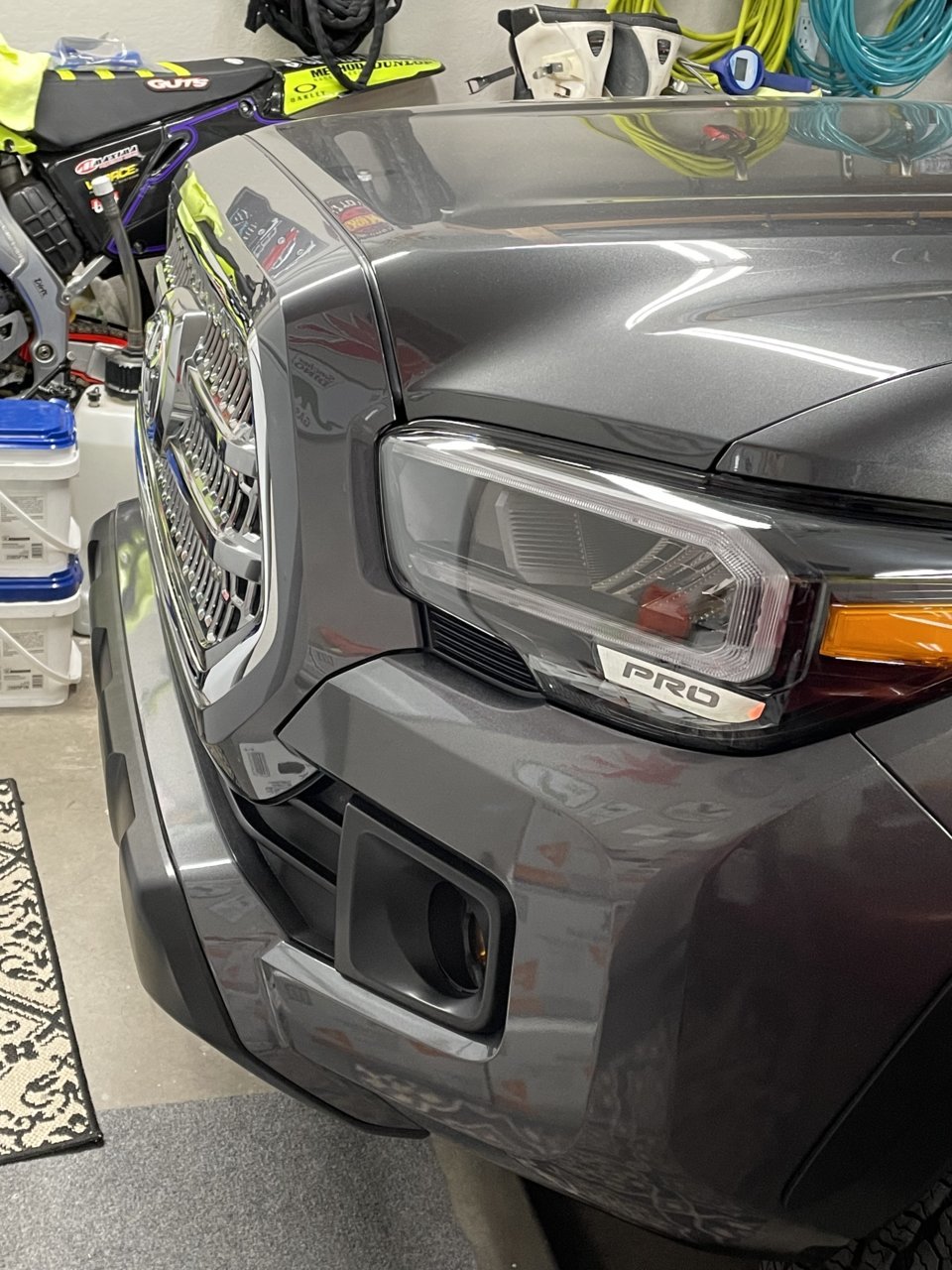

    I ended up prying out the bulky black plastic piece that clips behind the front bumper and rests next to the front fenders. (It's about 5-6 inches long and it's the piece that the side headlight bulb goes through on one end and on the other end there's a red push pin that helps it stay seated to the front fender. (I pulled back on the fender flare to see where it was supposed to line up.) Then the lower portions of the fender flares didn't appear to sit flush, but a quick hand slap seemed to set the clips in place. Then the fender flare bolt and clip secured it completely after tightening those down.
    Not the best picture, but I'll post some better ones later. :bananadead: I think the chrome grill needs to be changed out next...
    Larry H. Miller Toyota, Lemon Grove, CA (Black Friday sale %15 off was $1253.04, no tax, free shipping to my door in AZ.) Sparks Parts has very similar pricing with code CHLOEKUO for 5% off which was about $100 more than I paid last time I checked.) TRD PRO Headlight part numbers: (81150-04300 LH PRO emblem; 81110-04300 RH TRD Emblem) non pro led part numbers in YouTube clip.

    Glad you got it set. I had problems with too much gap and found out theres a little play in the bolt hole that holds the big clip and light in place. Just had to push it up when tightening the bolt and it fixed the gap. Having a blacked out grill and trim completely changes the look of the truck for the better IMO. Lights look great. :hattip:

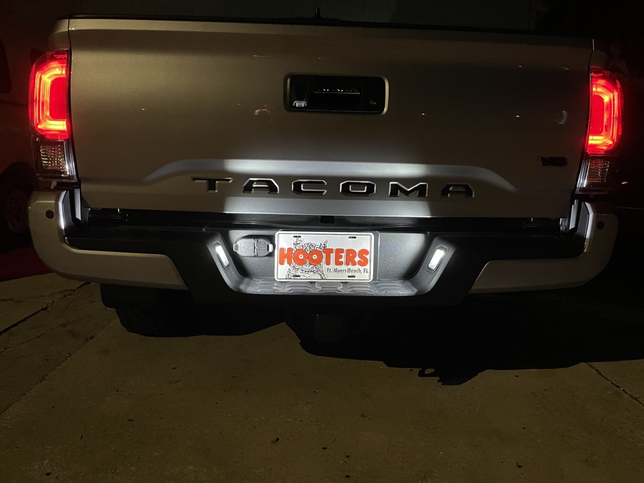

    Thanks dude! Not sure why they look like that in the pic, they're actually EXTREMELY bright and white, especially at night. They're the Diode Dynamics LEDs I'd put in a year or so ago...
