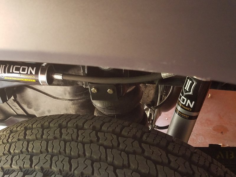

    Thanks man! It went really well. Basically used quick clamps to hold the stock pack together then zip tied it together. Used heavier clamps to bring the AAL and overload spring together with bolt then just went slow and tightened the bolt as I brought the leaf pack in with the c clamps. Cut the zip ties once the bolt was in. The biggest PIA was actually assembling the airbag brackets. They are no drill but use a really convoluted bracket system. Here's a pic of my AAL method:rofl:

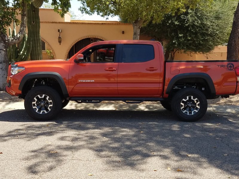

    I put the diff drop on wich was super easy and required no modifications of the skidplates what so ever. It was the toytec diff drop and included skid plate spacers as well. Very nice little kit. I tried to take before and after pics but they didnt turn out. That 1" drop makes a big difference on the CVs.
    I cranked the front coilovers up a little bit and compensated for Drivers side lean. The back sits up about 3/4 inch higher than the front wich is identical to my stock difference. I have a good feeling that AAL in the rear is gonna settle down a little bit too.

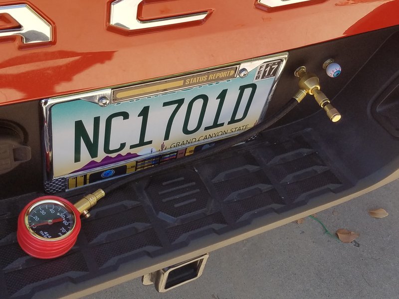

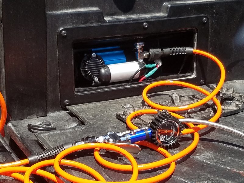

    Ran the air lines to the airbags and tested them out a 60 psi for a short drive. Using the ARB compressor in the bed and tire deflator to adjust the airbag pressure. It would've been convenient to have in cab bag pressure adjustment but that would have required a firestone or airlift compressor wich can't be used for filling tires or lockers. The ARB compressor is allot more versatile.

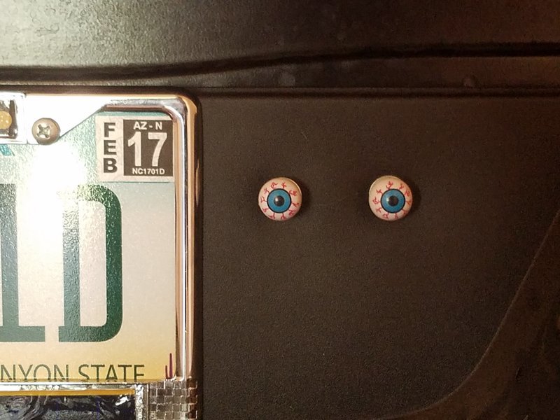

    Last but not least installed some totally RAD eyeball valve stem caps on the airbag fill valves. Probably my best mod to date!

    Found the TNG nerd! Love it!

    darmok and jalad at tanagra?
    NCC1701D, the greatest ship to ever grace the skies!

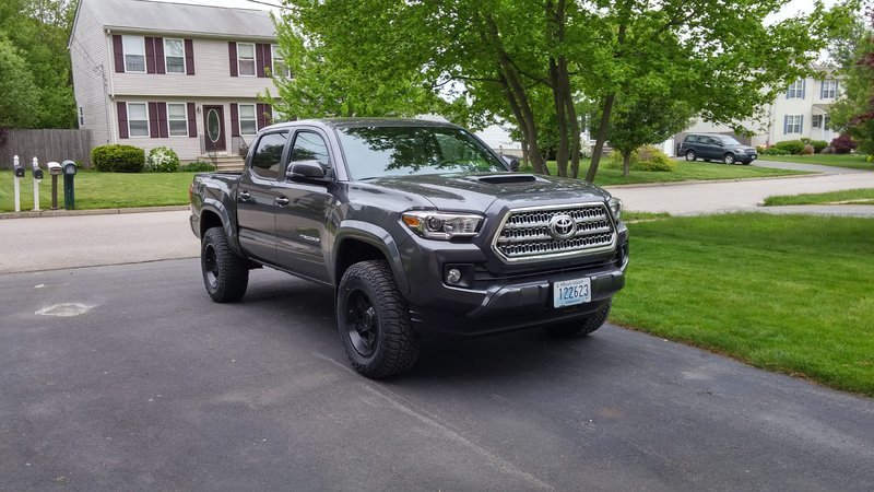

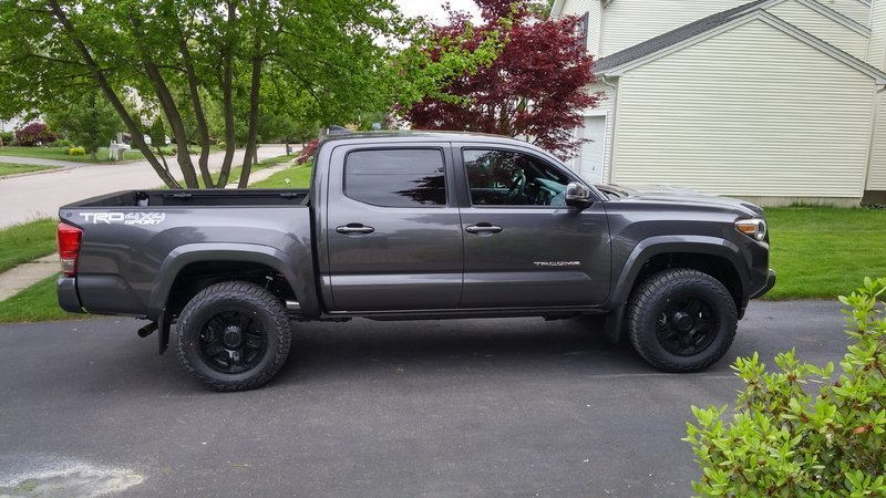

    I'm running Gear Alloy Manifold 740B's which are 17x9 with a -12 offset. Wrapped them with Falken Wildpeak AT3's that are 265/65/17 as well. No lift or change on my suspension. No rubbing or wear anywhere that I can see. The -12 offset really makes the truck have a more aggressive stance IMO. Hopes this helps you out.

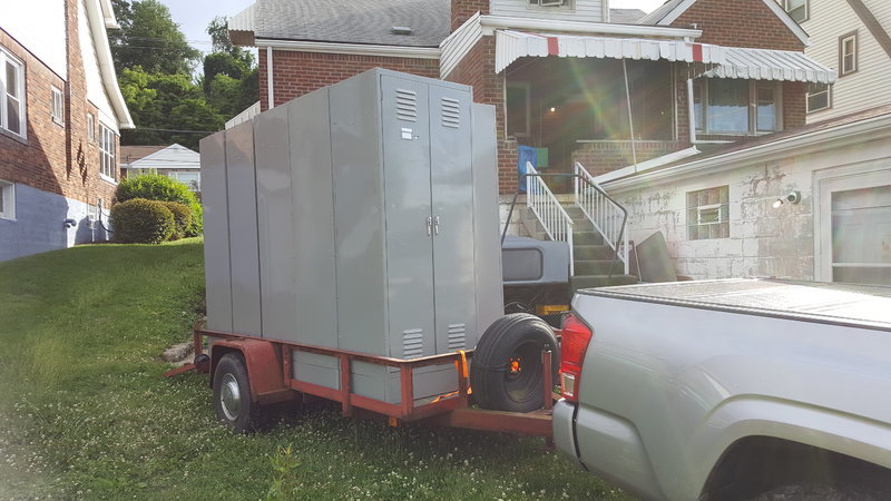

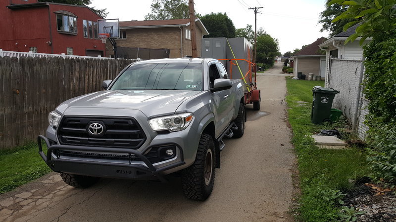

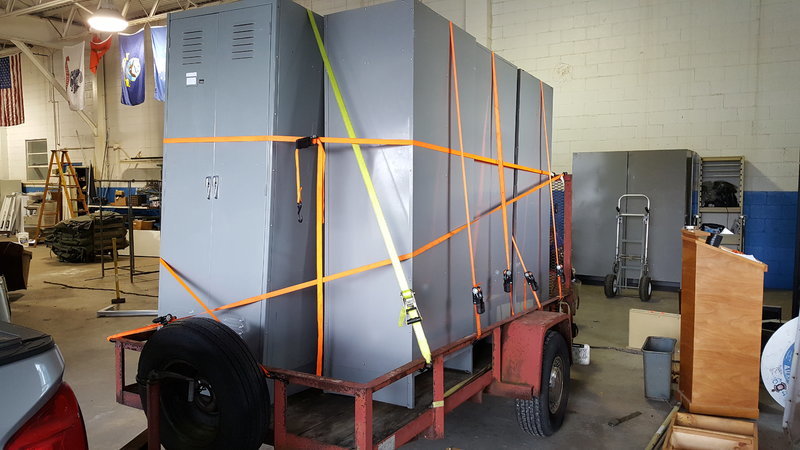

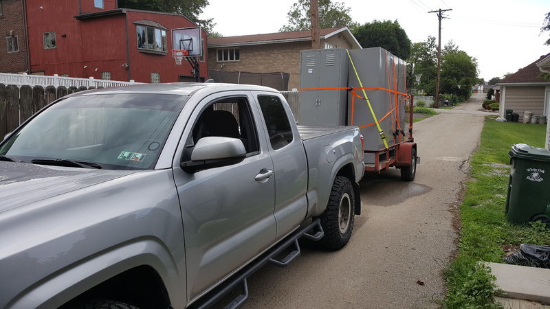

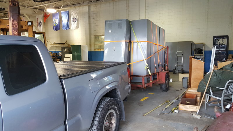

    So the total weight of the trailer and lockers was somewhere in the vicinity of 2000-2500 and the truck pulled it like a champ, went about 25 miles with it on the level and some decent hills! The 5 speed is so nice expecially for engine braking, hardly had to use the brakes! And people say you can't do nothing with the 4 cylinder!! :rofl::smack:
    20160606_181638.jpg 20160606_181629.jpg 20160606_174246.jpg 20160606_174235.jpg 20160606_182605.jpg 20160606_182558.jpg
