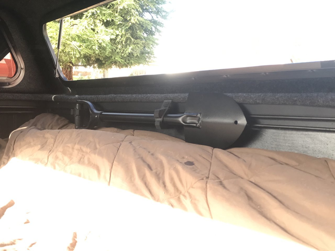

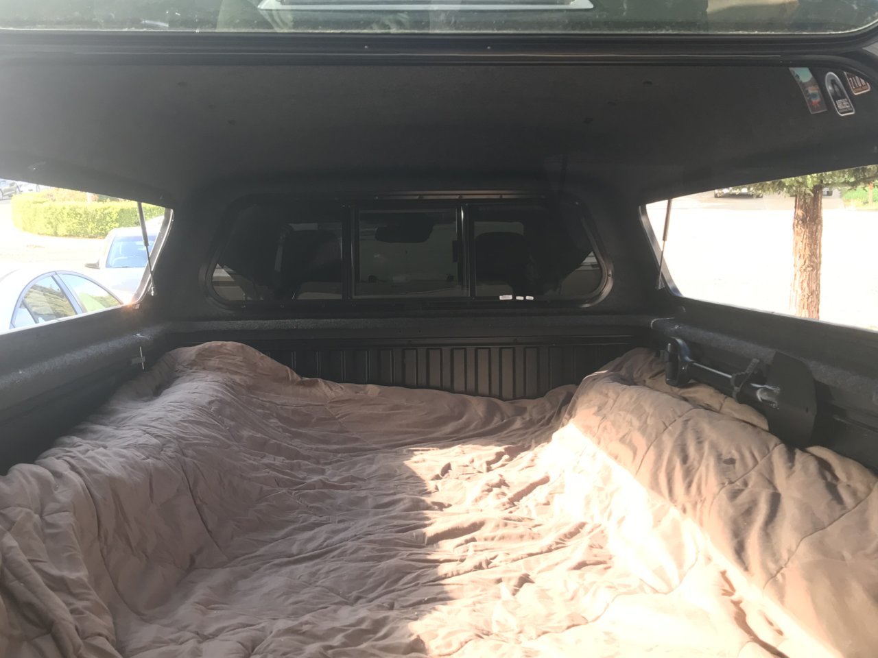

    Prepped the bed for two nights of camping. And installed a shovel with quickfists.. 9D7CF5F9-C908-4E06-8777-63A8D87049D6.jpg 9839A5DC-4EE2-4BC8-BBFE-D8774E14157F.jpg

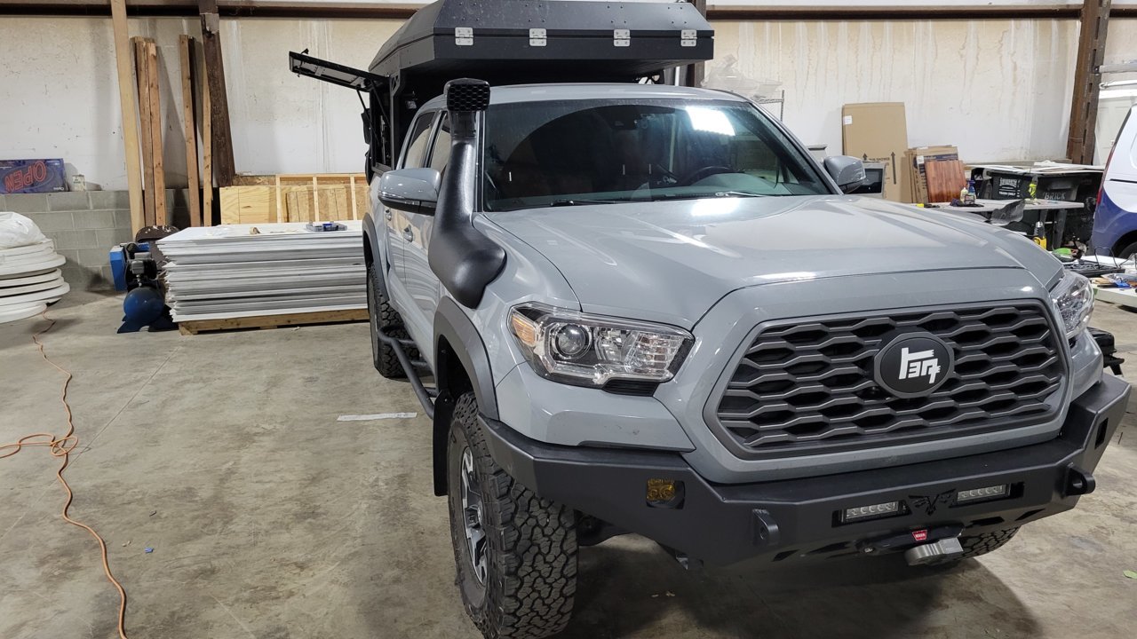

    Finished a few projects. Snorkel, light bar and winch install.

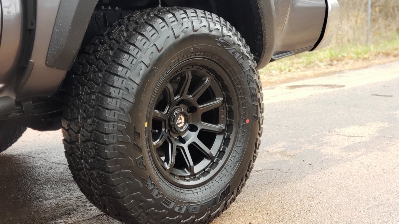

    Wish the camera on my phone didn't suck so bad. They look much better in person.

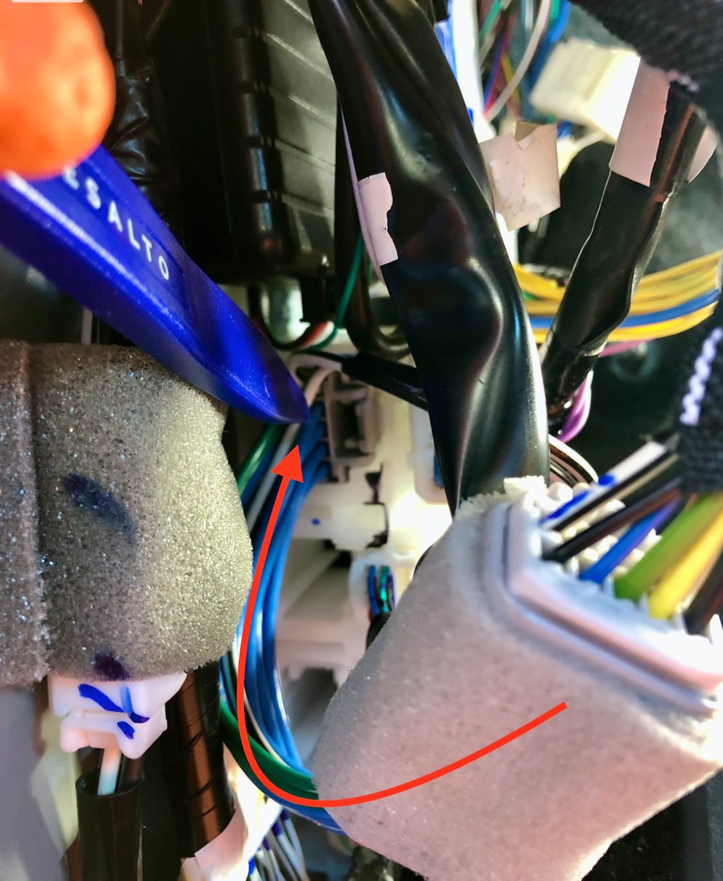

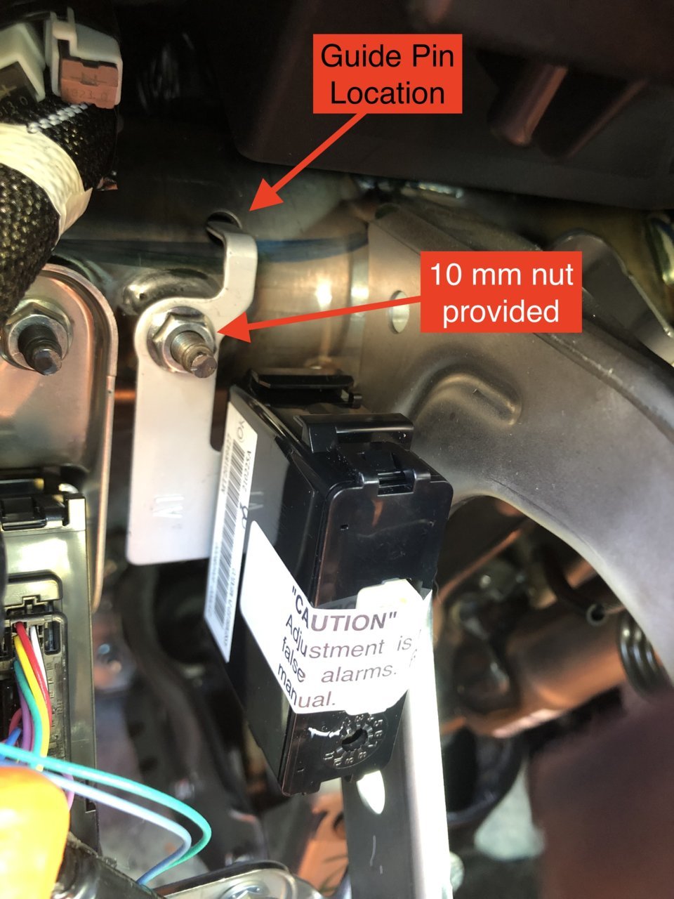

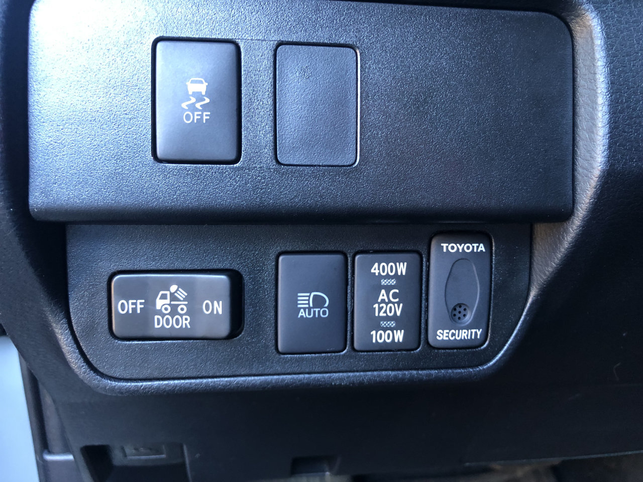

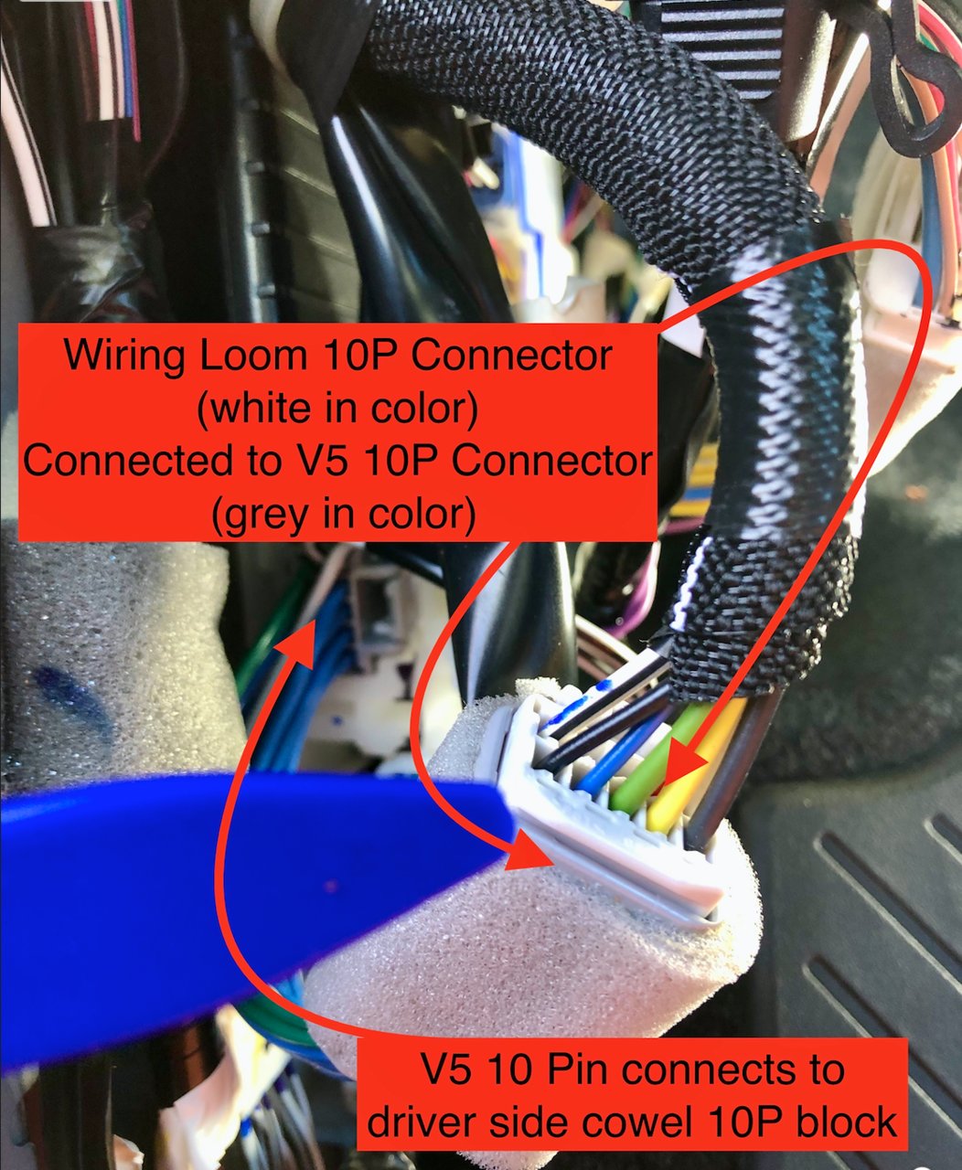

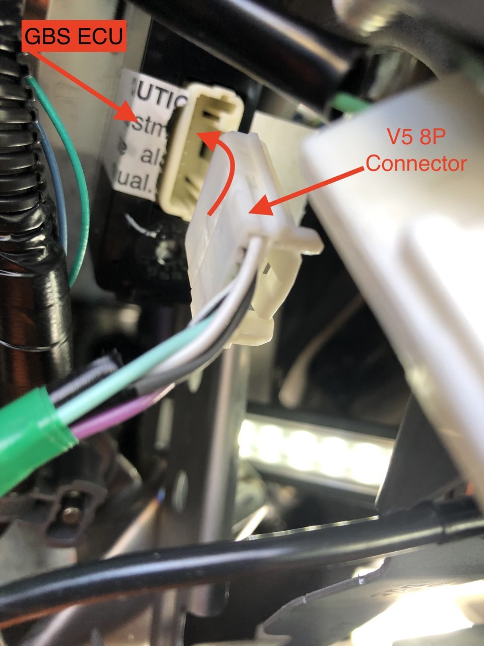

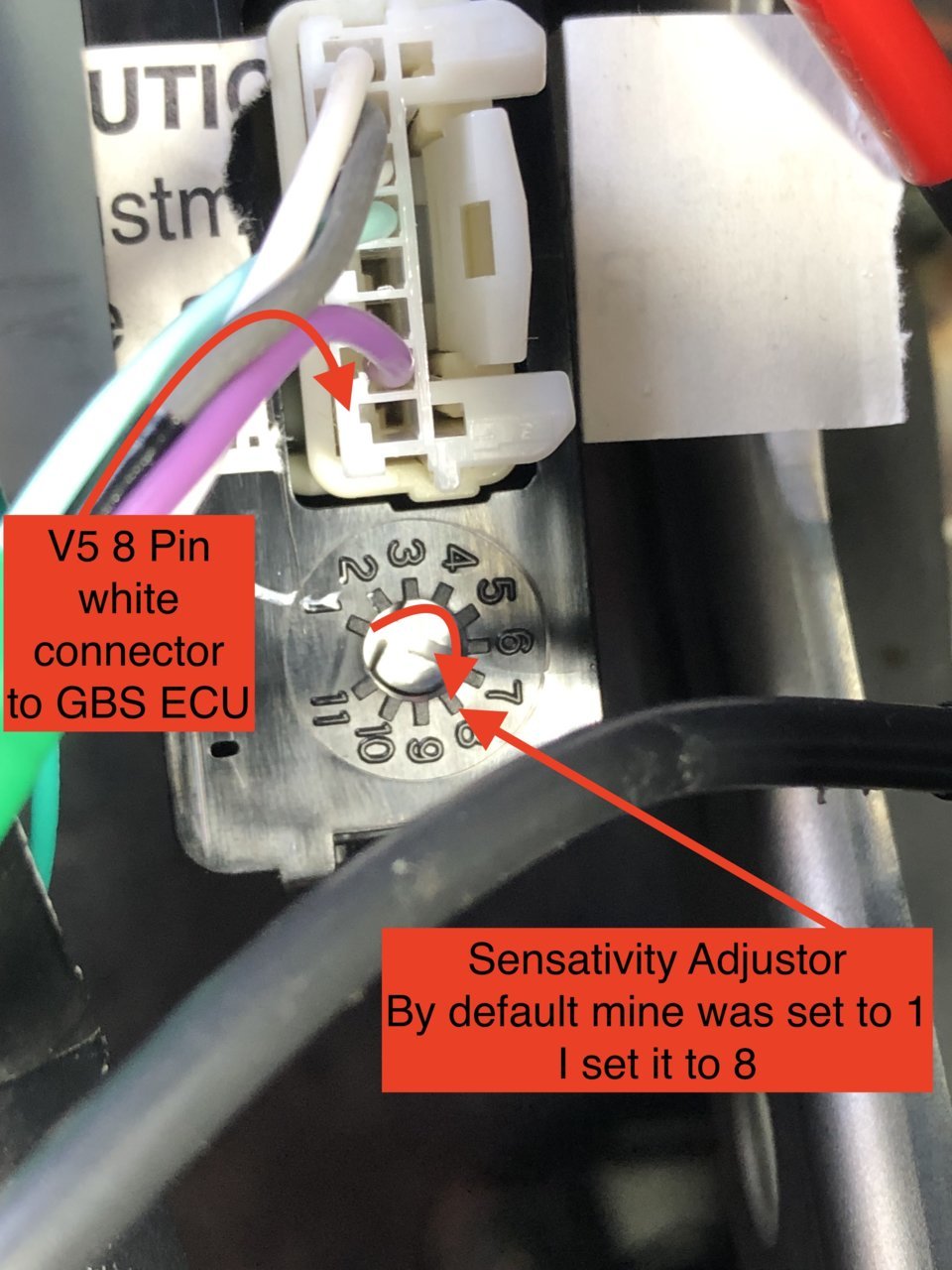

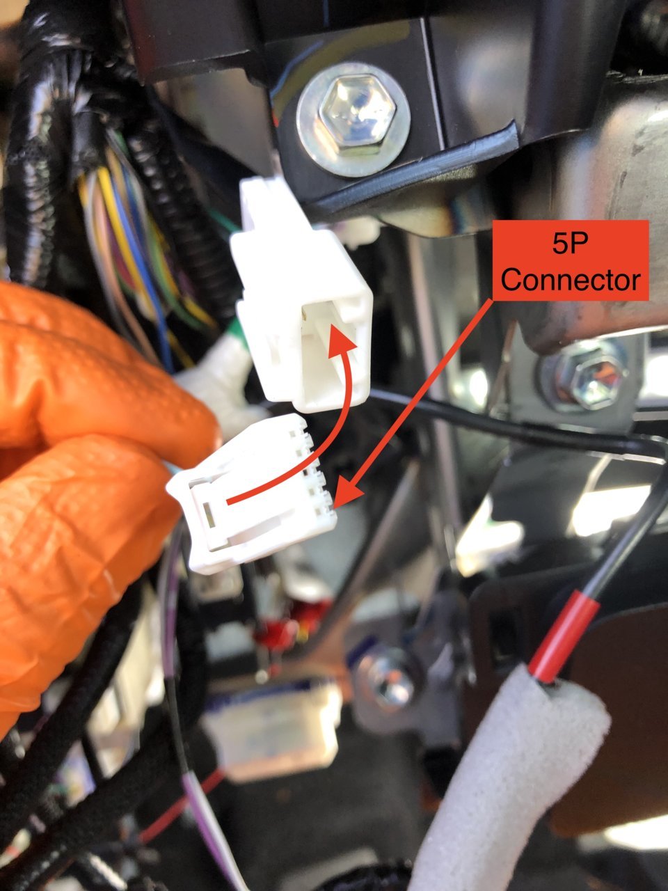

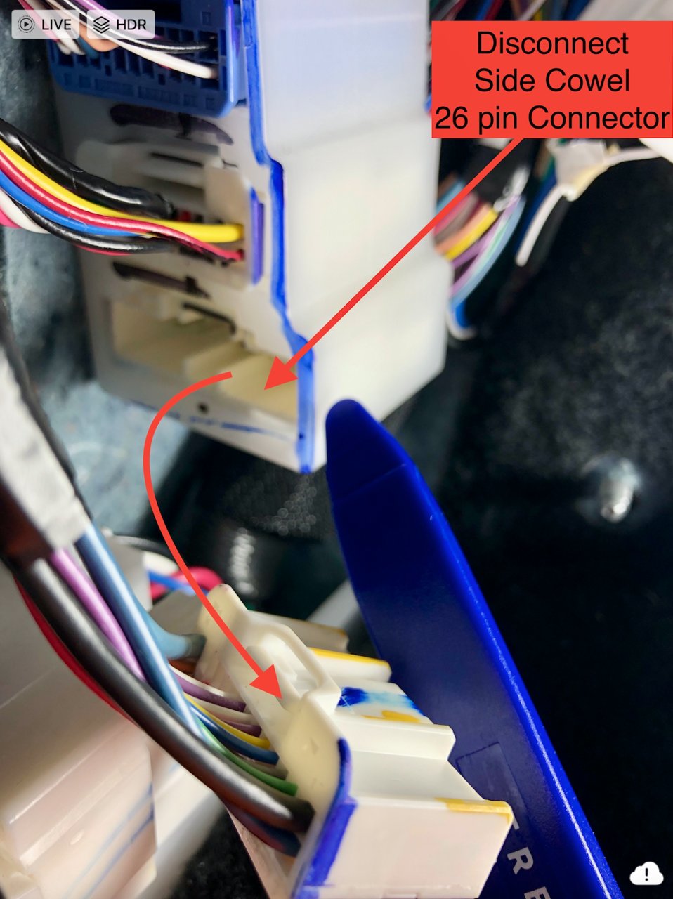

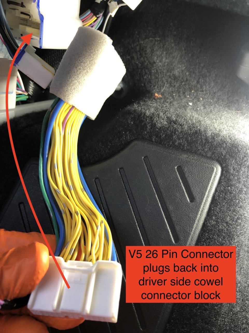

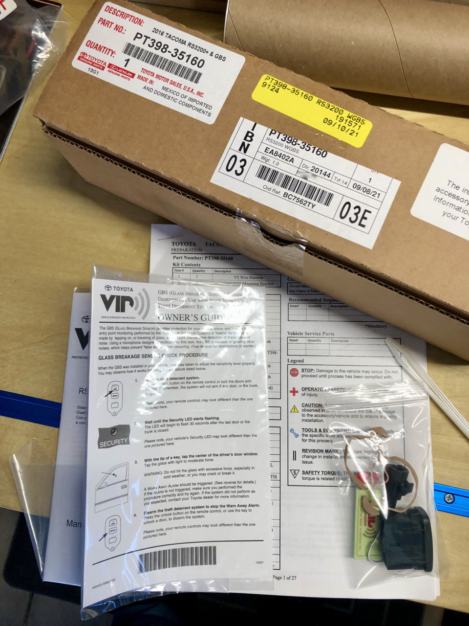

    Enhanced my factory alarm today by installing the PT398-35160 GBS. I have the PDF instructions if anyone needs it. Easy, but don’t be a dummy, disconnect the negative terminal on the battery first. Need: small flat head screwdriver for sensitivity adjustments, 10mm deep socket, nylon pry tool, cutter for zip ties and flashlights. P.S. perfect opportunity to add grease to battery terminal to prevent corrosion.
    You only have to make 3 connection’s, after you plug the sound sensor and the GBS module in. I needed to set my sensitivity level to 10. (The range is 1-11.) Bang on the truck, not triggered. My son parked next to me and revved his V8 GT to the limiter (Roush exhaust) and alarm never triggered. Just barely tap on windshield or any side windows with any object and the alarm is instantly triggered. Very pleased;)5AC8B8D3-984E-40F0-91E0-4C8094250C94.jpg B46B6B5A-BE71-4A34-B406-145C267D2DDB.jpg 32A976B3-122C-46BB-B40C-DDD41C57BDF4.jpg71119B92-BD39-4ADF-AD52-90D0EDF8DCA9.jpg DDD51B2B-11D8-4718-A5DD-DBE9E7122FDB.jpg88F7B09B-29F6-4900-92CD-861B2D0E4ABF.jpg

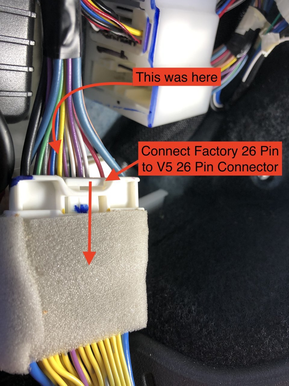

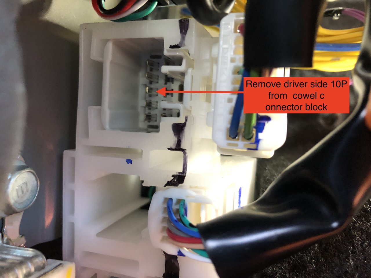

    I installed mine today too after having it for months. I set the sensitivity to 8 and it woks fine. Here are some additional pics for anyone thinking of tackling this themselves. It may seem intimidating, but with YouTube and these posts, anyone can do this OEM mod.
    https://youtu.be/x7keMVmBACA
