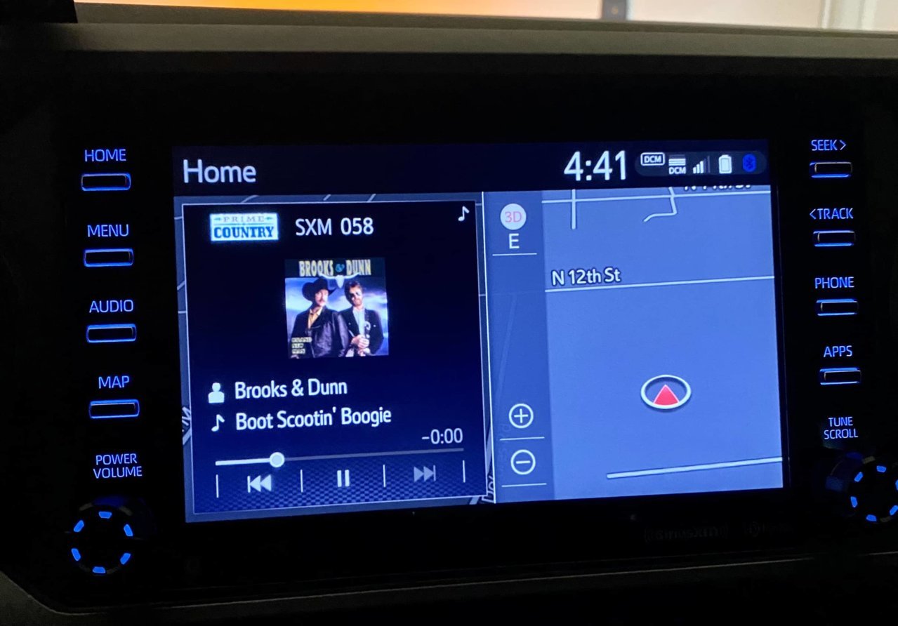

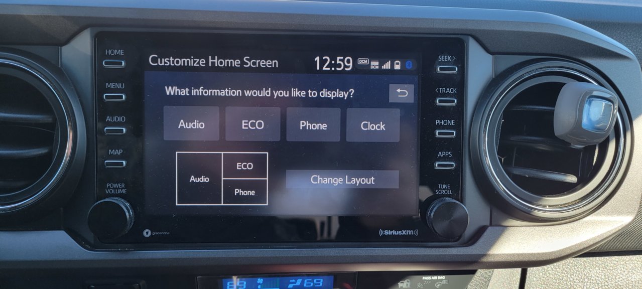

    Is there a trick to get the map on the home screen? I don't seem to have that option.

    I can get the map to display from the map screen while using android car play, but I can't get the map on my home screen. I'm not able to install the toyota app onto my head unit (Toyota told me they were phasing this out), I suspect this is why I can't get it on the home screen.

    you need to have built in navigation. Yours doesn't. That's why it's not available to add to your home screen.

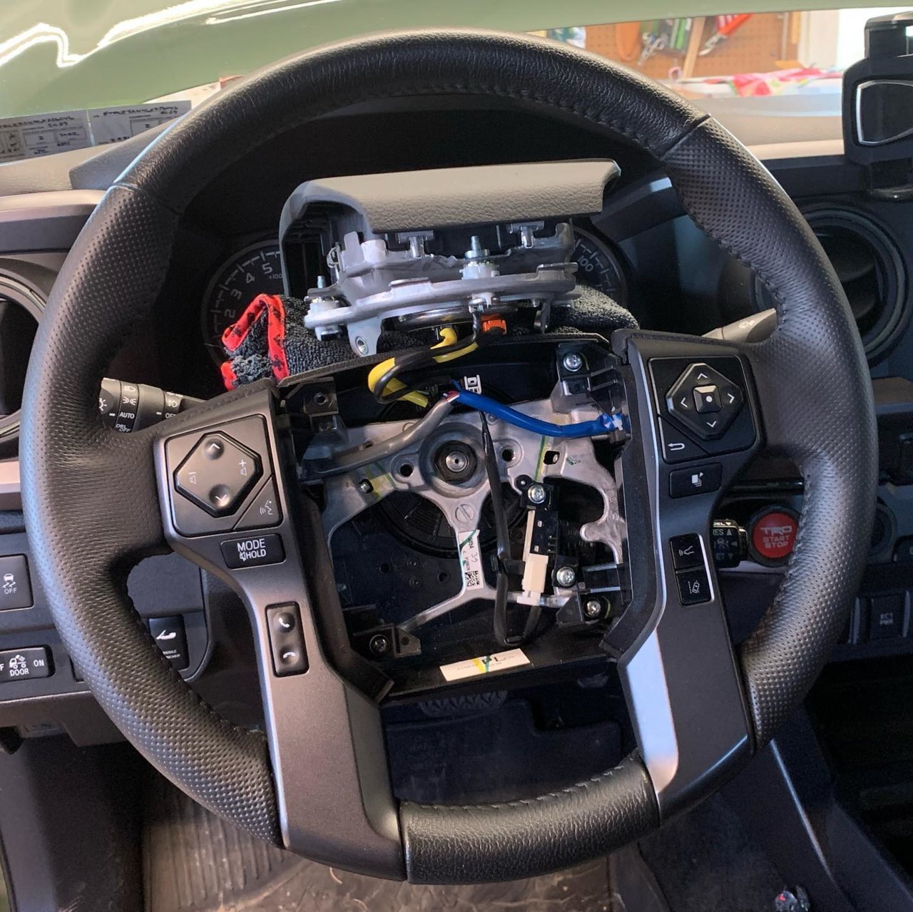

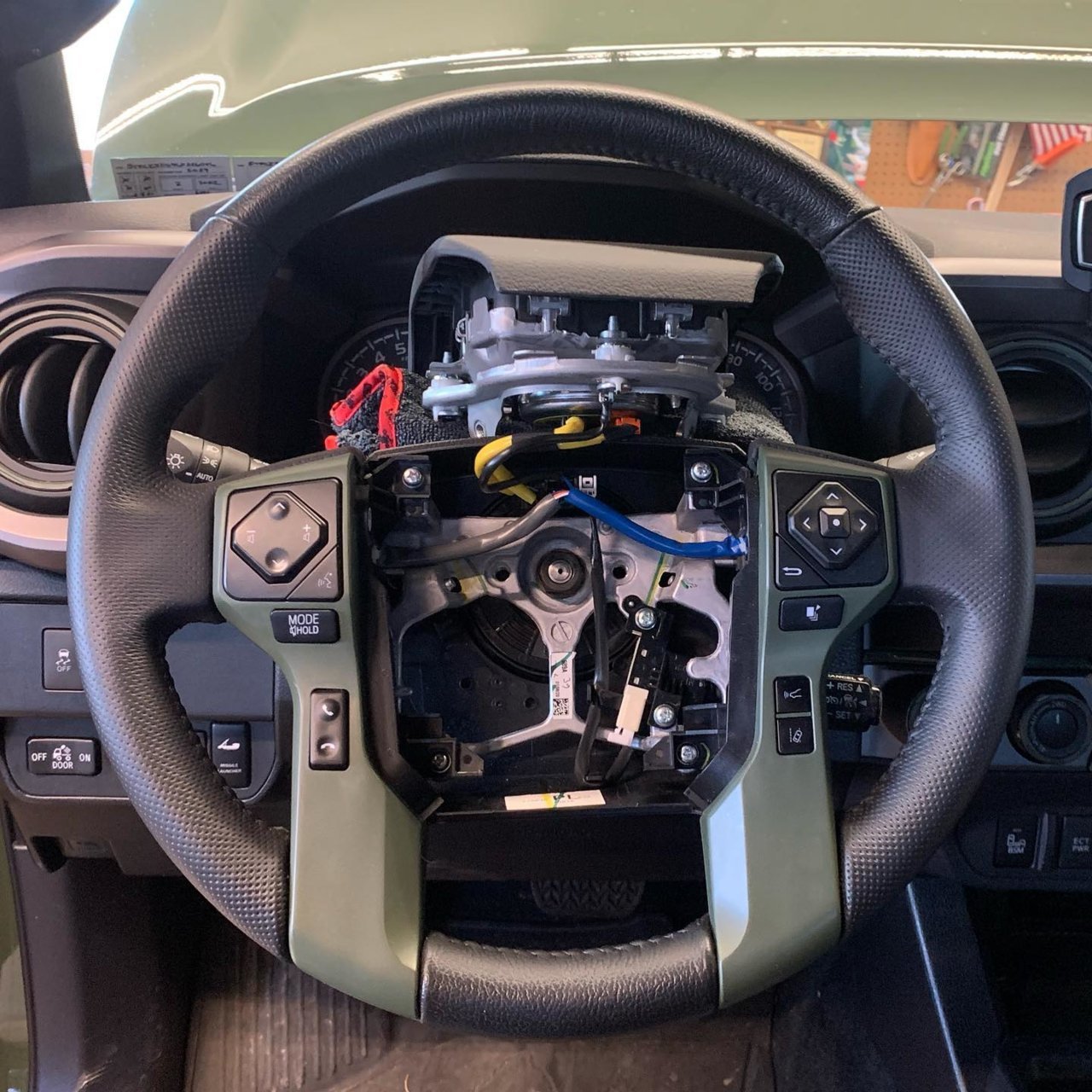

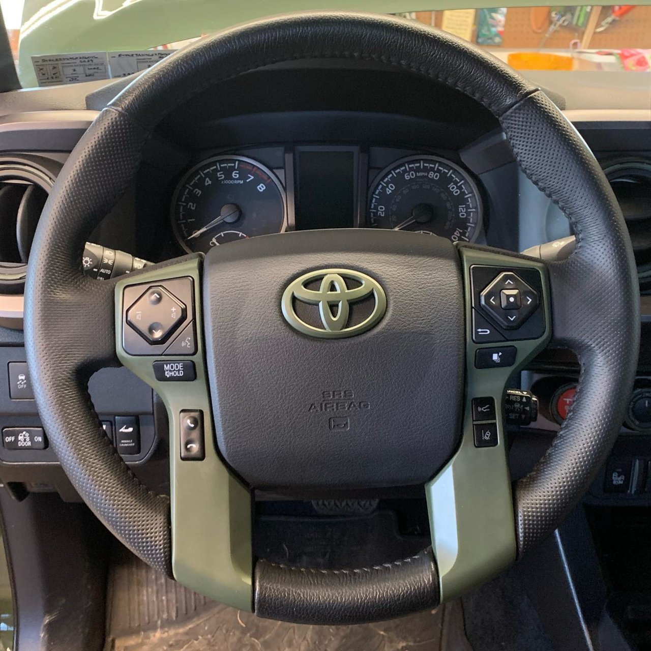

    I got the @AJT DESIGN steering wheel trim pieces installed today. Easy job - forgot to take pictures of removing the trim caps over the air bag screws. A trim tool works well and they popped out easily. After getting the air bag out of the way, it's just 5 screws on each side (2 front, 3 back) to get the old pieces out and then pop in and secure the new ones.
    Remember to unhook the negative battery cable before you play with the air bag!!!
    OEM Trim
    Air Bag loose and flipped on top of steering wheel

    Both sides swapped
    Air bag back in place. Mission complete!!
