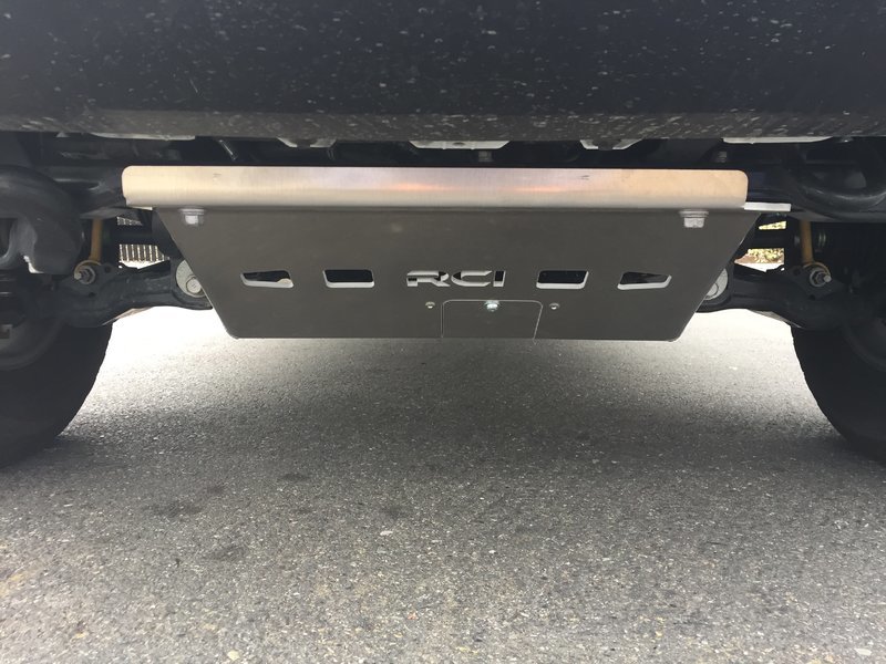

    Bolted on the RCI Aluminum Front Skid. Better protection and easier oil changes.

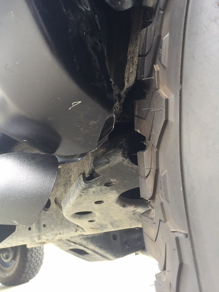

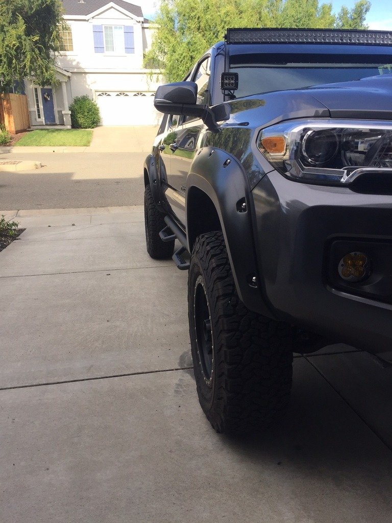

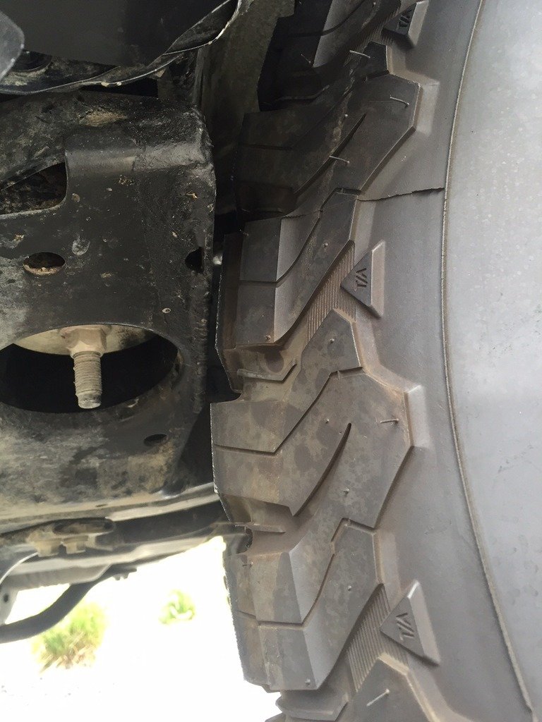

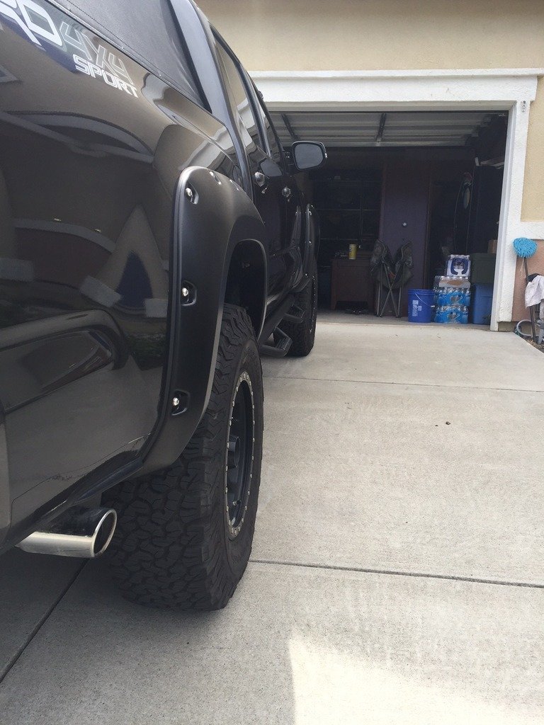

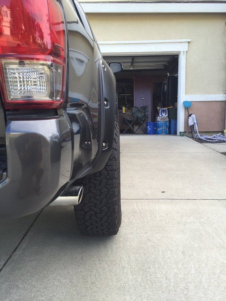

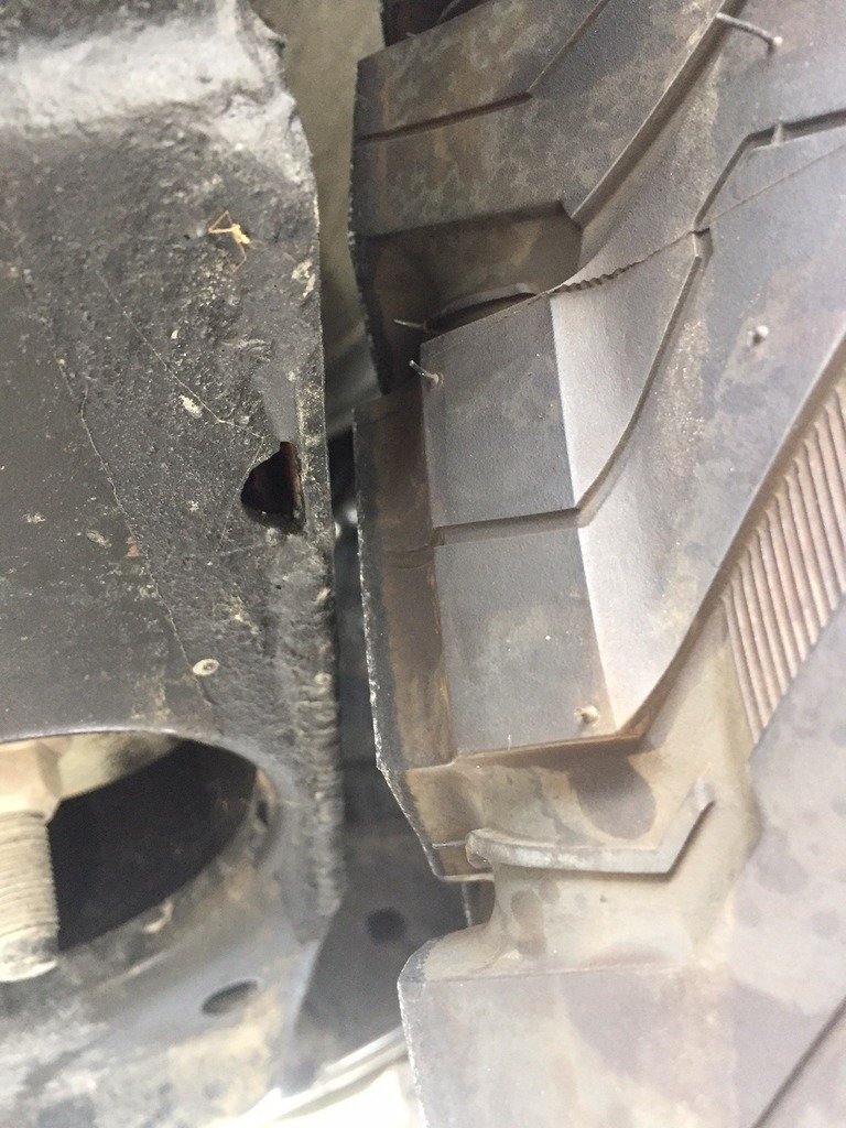

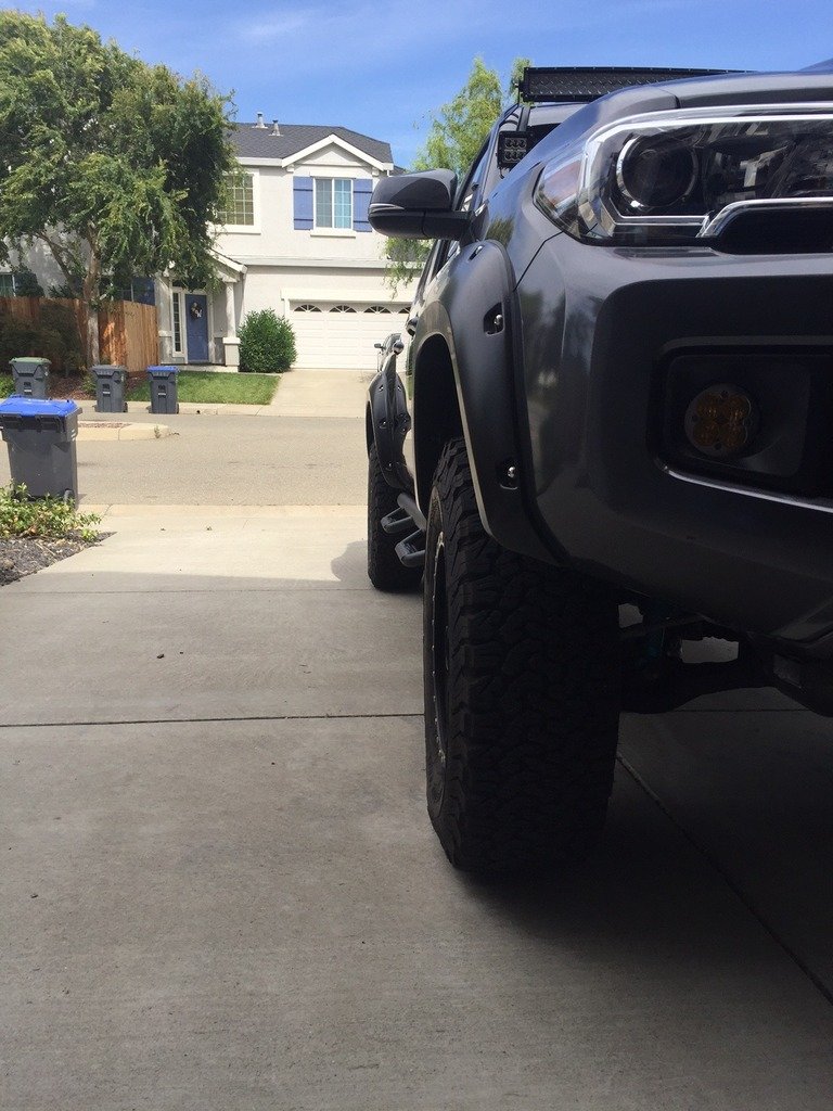

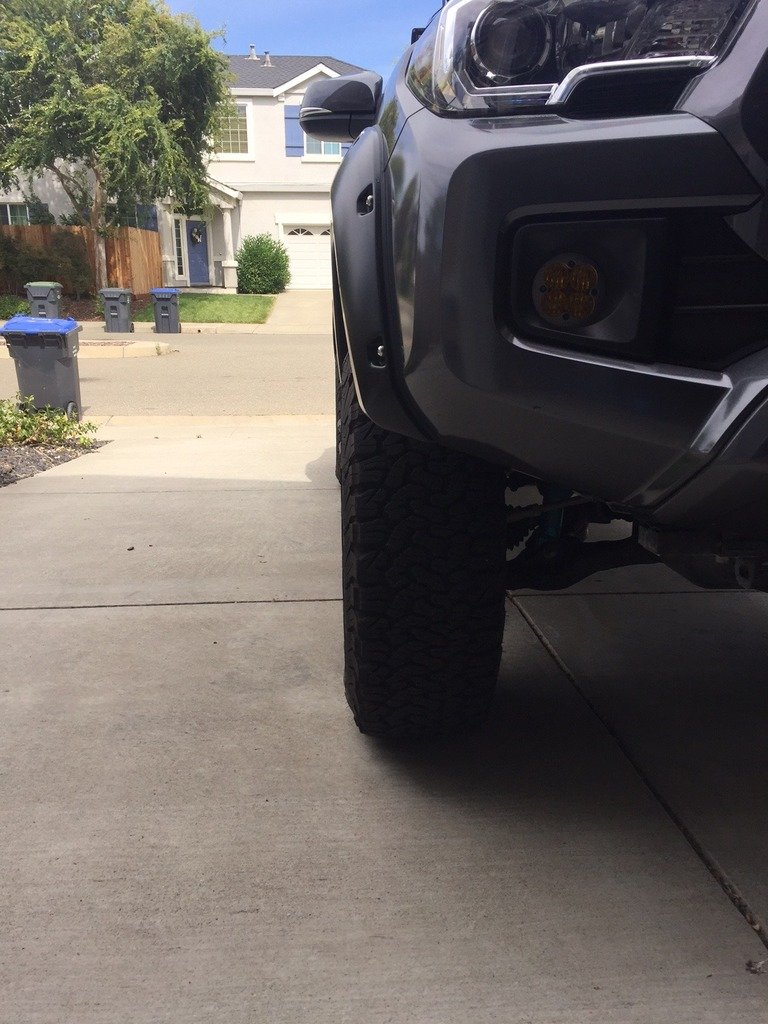

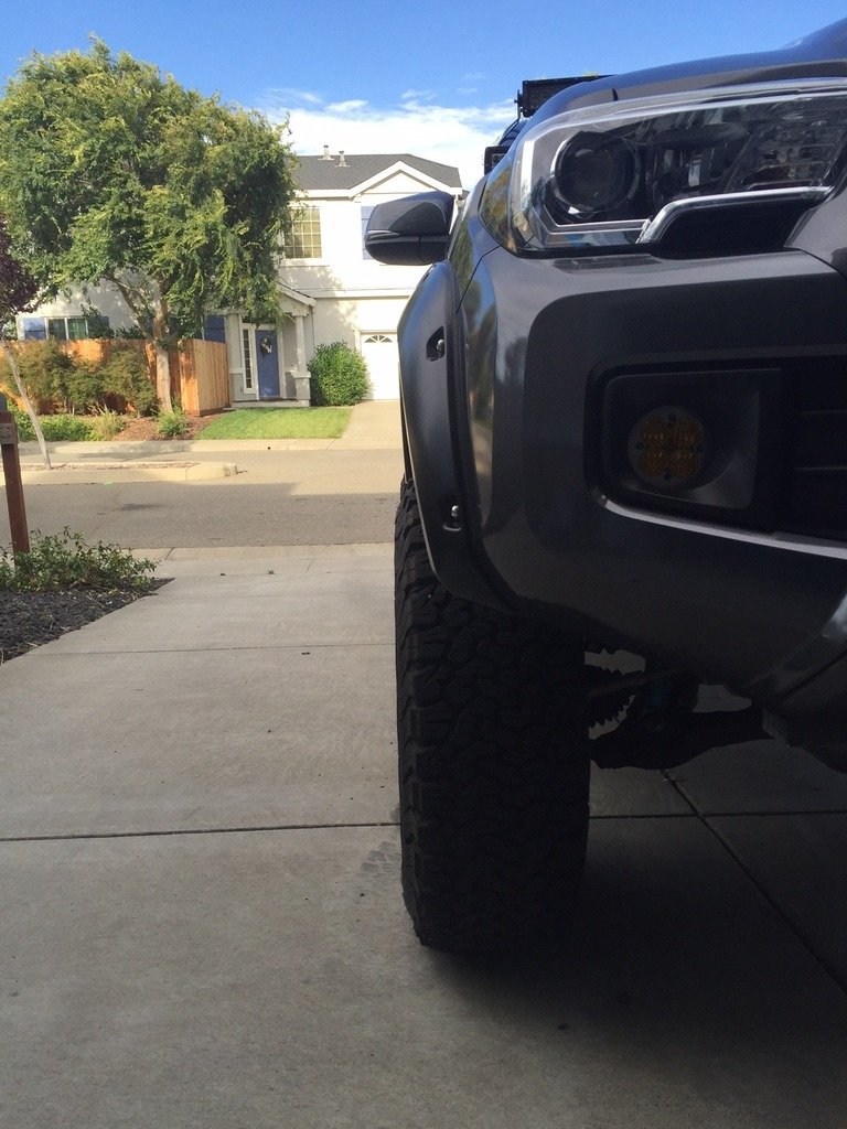

    Spidertrax spacers arrived today and of course i couldn't wait to get them installed to finish the look with the new bushwackers :)
    Before:
    After:
    Had to do some minor trimming to the bottom portion of the front bushwackers... the CMC has already been done but i seem to still hit at full lock forward and in reverse. I'm on kings 2.5's and have the front middle fender to ground at 39" I'm afraid to raise up the front anymore since i already have 11 threads exposed... if anyone has some ideas on what i can do to get rid of the full lock rub please let me know! trying to prevent having to re-do the CMC...

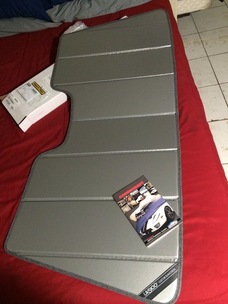

    Bought the same shade....!!

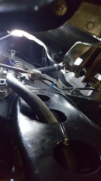

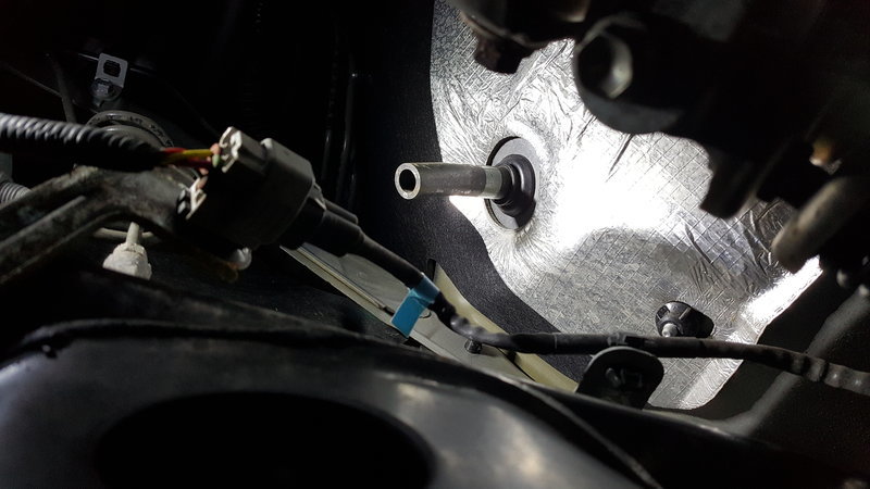

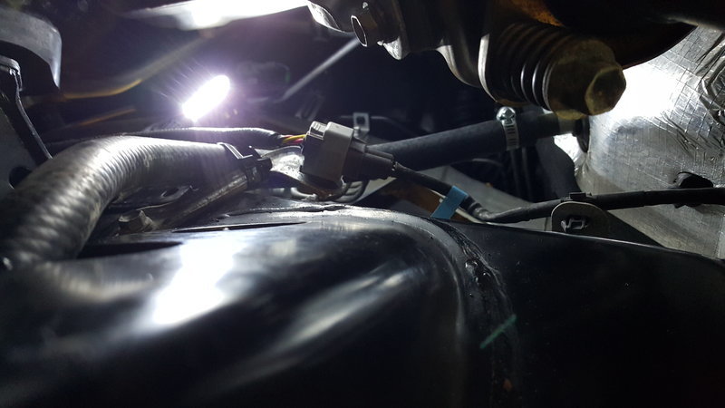

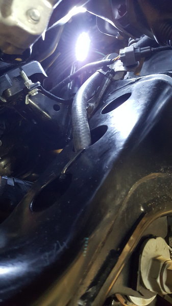

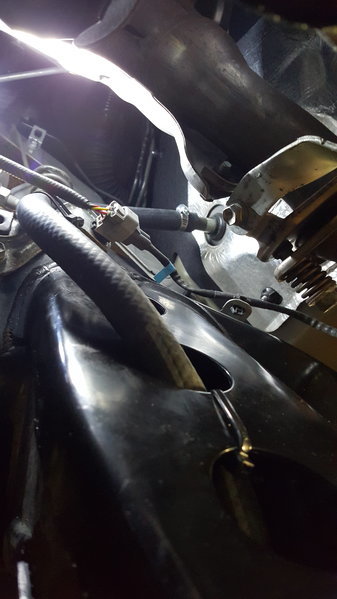

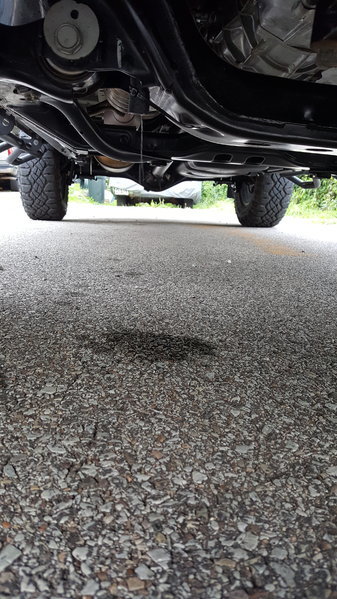

    Had a idea a few weeks ago and finally got around to it! Relocated my air conditioning condenser drain! On my 2016 SR!
    I was thinking how I've seen so many rusty frames in thst spot cause Toyota designed the drain to dump right out onto the Frame, so was thinking of adding a hose to it and run it down straight to the ground! Bought a 2 foot piece of 5/8" ID heater hose and it fits the small tube coming out of the firewall perfect! Attached a little hose clamp and didn't tighten it to much so you don't pinch shut the hose. Just thought I'd share with you guys! Only cost a few bucks and I'm sure it will pay for itself in the long run!
    It works perfectly!!!!
    How it looks from the factory :
    After I added the extension:
    20160610_162641.jpg 20160610_162647.jpg 20160610_162659.jpg 20160610_162714.jpg 20160610_162727.jpg 20160610_162755.jpg 20160610_162758.jpg 20160610_181159.jpg

    ^^^ Gonna try that!

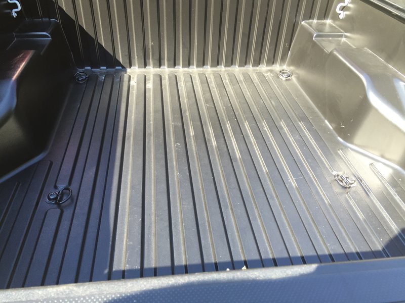

    Finally got around to installing my extra D-Rings in the bed. Put four more in for a total of six in the bed floor.
