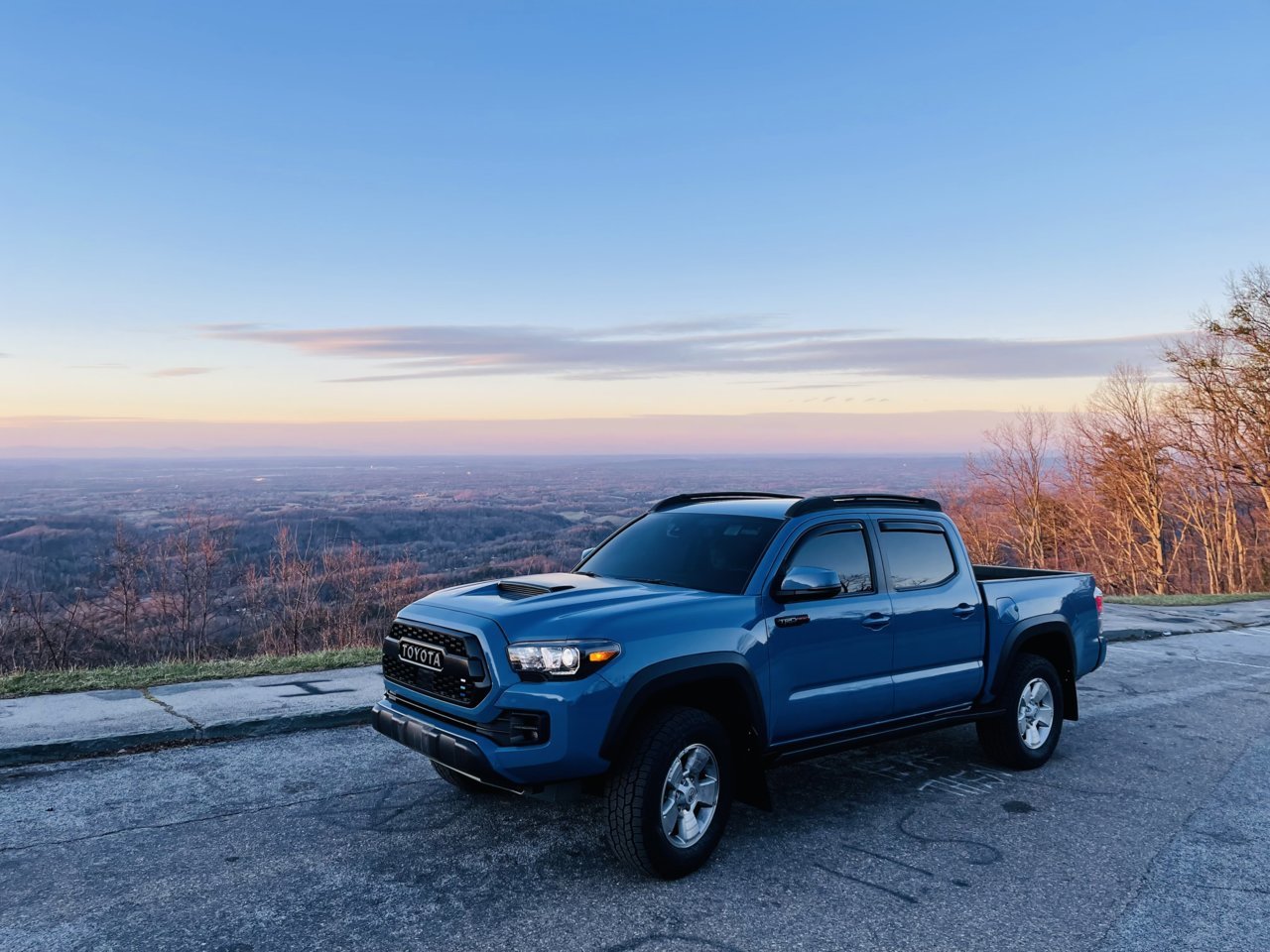

    Got my windows tinted and installed my 4WP rock sliders. Took a bit of effort to get done without help but they turned out great!

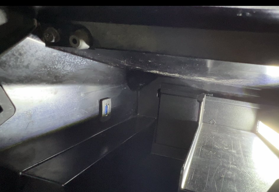

    If people do not want the Air 2 Play dongle hanging in the center console there is an extension for it. I used the extension and mounted it inside the glove box. It requires you to move the factory plug behind the console, plug in the extension, route the extension to the glove box and cut a small square in the inner glove box wall for mounting the USB port. Took about 20 mins and looks way cleaner than a floppy dongle. I should also include that since I have a 2017 the Air 2 Play will not work for me. :annoyed: No real issue for me as I have several USB ports for power and a spot for a new switch. I was so excited to get the air 2 play to work. Well, lesson learned, it's sitting on my desk till I figure out what I want to do with it.
    Here is a link to the extension is case any one is interested --
    https://amzn.to/3rPiUg1
    Pic In the glove box. Also, the extension is long enough to mount in the arm rest as well.
