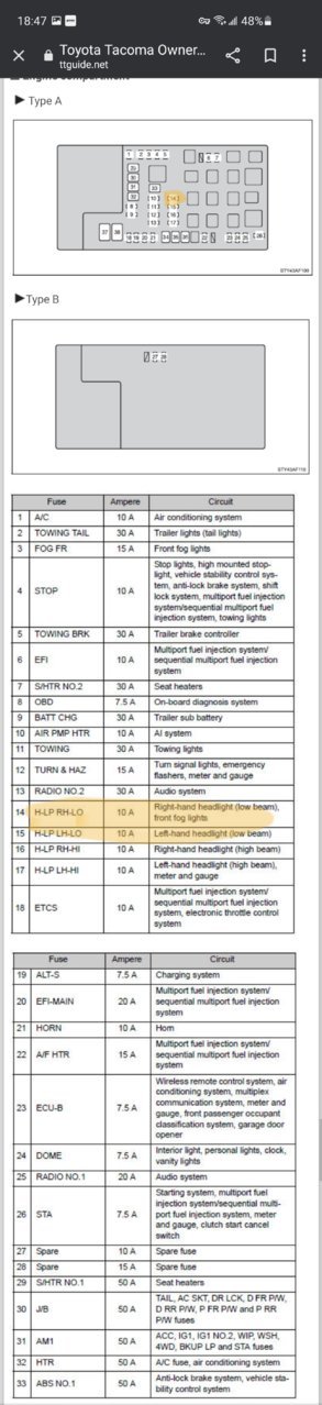

    this is my fuse box schematic. [​IMG]
    its FOG FR i would think but dont think a add a fuse works in that slot. for now i have a add afuse in the H-LP RH-LO slot.

    Bottom left, labeled "H-LP RH-LO", that's the fog fuse.
    ...assuming the table from TTGuide is accurate (but the diagram isn't, for whatever reason.)
    But again: tapping that fuse will not make it so raptors are only on when fogs are. Those are controlled by a relay or whatever they're called, which is the much bigger blue "box" thing you are mentioning.

    when i use that one only turns on with headlights on low if i turn the fog lights off via the turn signal it dont turn off the raptor lights.

    Damn, sorry, I must not remember clearly which slot I yanked the fuse out of. The DRL slot won't work either?

    which slot is the DRL ? i think i have a issue there regardless as my DRL's dont work when i have just that turned on.

    It's the 10A right above the 15A Fog FR
