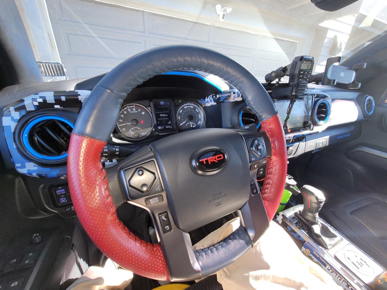

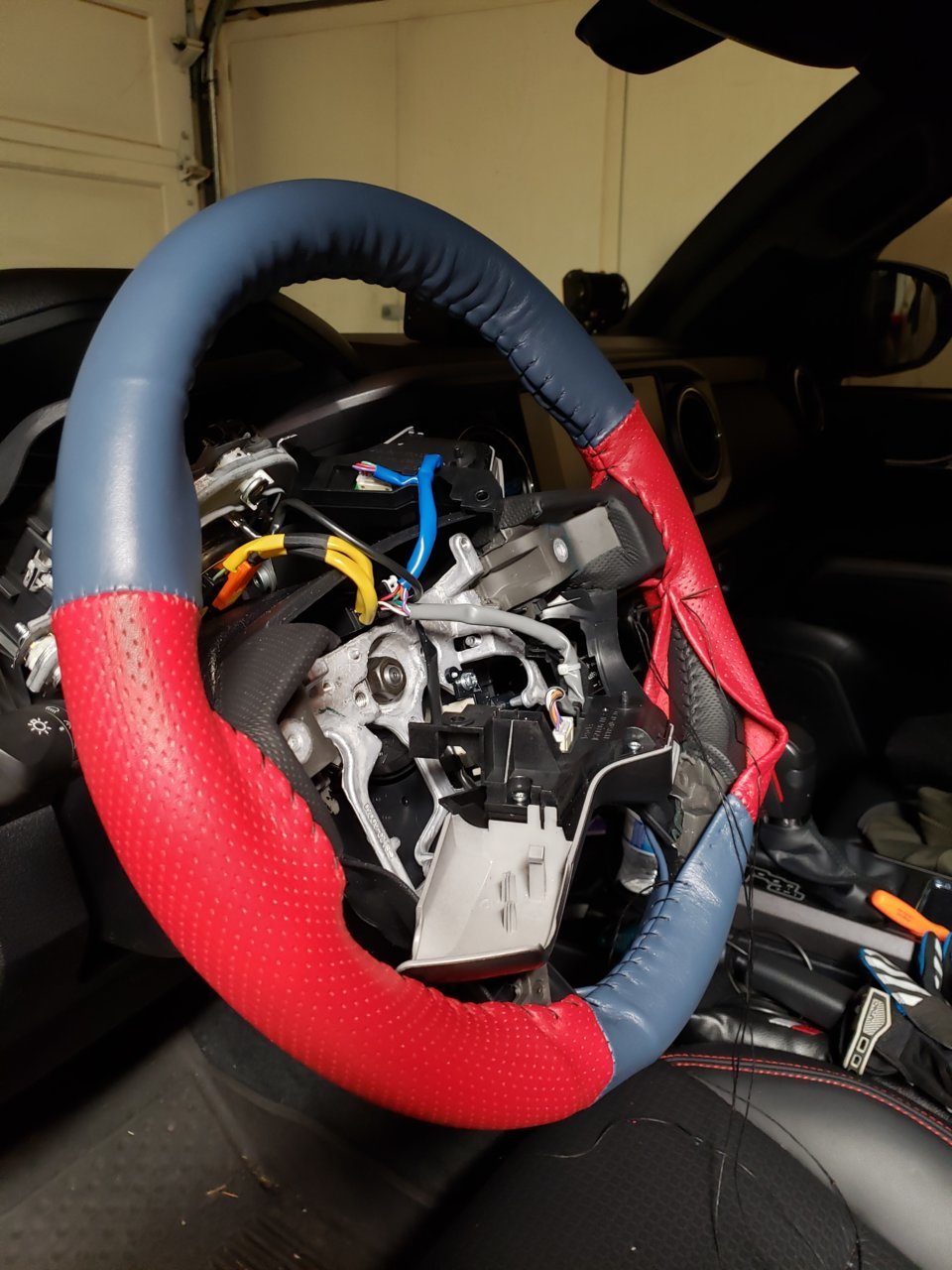

    I've had wheelskins on for a couple of years now and I'm glad I chose them.
    I took the time to disassemble and glad i did. Not hard at all. Just take your time. Patience is the key. The leather is great quality and has a soft feel to it. In time the leather molds into your hands to have that perfect grip when broken in like a baseball glove.
    I've had several vehicles that I kept for over ten years with no wheel coverings and they have worn out and degraded to its rubber layer.
    Overall, I'm very satisfied I did it and the comfort that you get from years of driving.

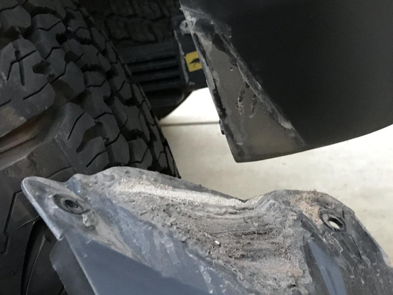

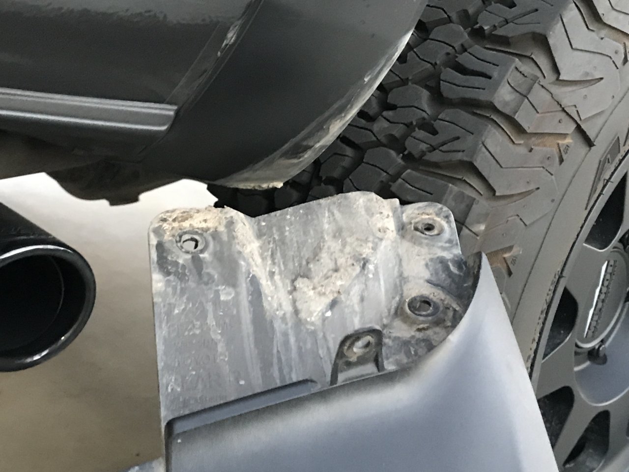

    Cleaned up dried toe jam after 11K of driving.

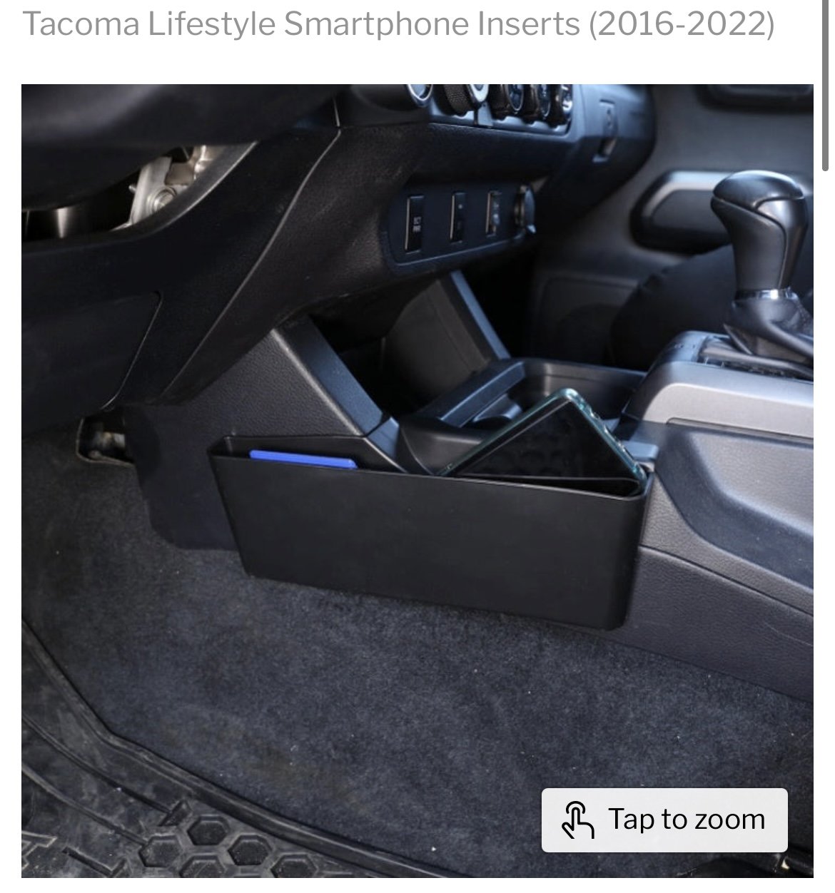

    I have them and find them handy. You may need to use 3M tape to replace what the manufacturer uses to attach them.
    Cheaper on Amazon (pilot and copilot sides sold separately)
    https://www.amazon.com/gp/product/B08TR7VZ2Q?ie=UTF8&th=1
    and even cheaper on AliExpress (again, sides sold separately)
    https://www.aliexpress.com/item/100...&terminal_id=eb34dc960388416699a6729718926693

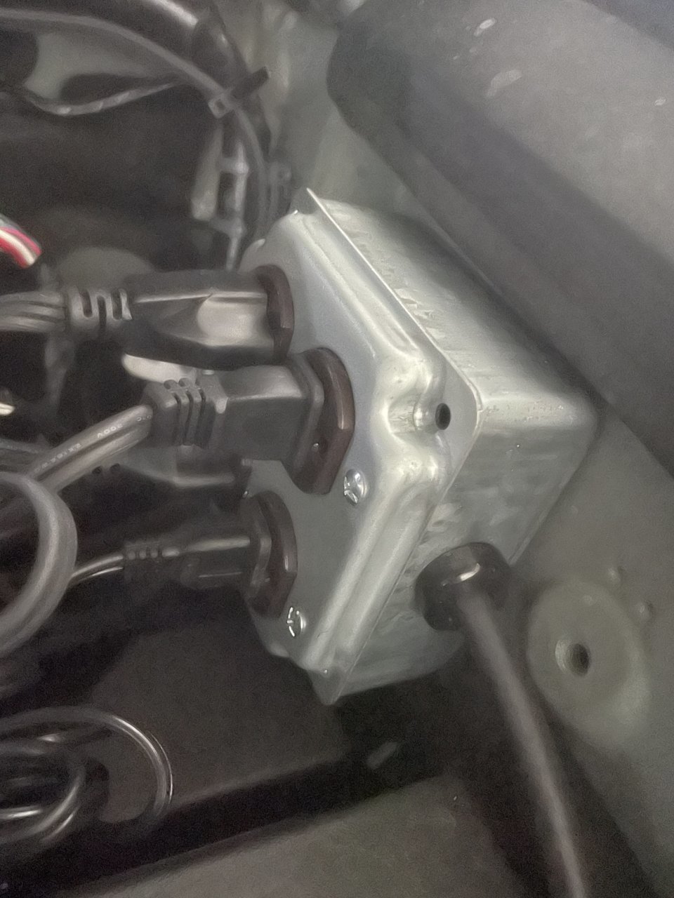

    Finished winterizing my truck. Added my block heater and transmission pan heater, so now I have those plus the oil pan heater and battery maintainer routed to a 4 way outlet box I installed near the fuse box.
    there were some holes in the fender from the factory that just so happened to be the same size as the bolts I took off the factory splash guards I took off when I installed the TRD Pro skid plate. That made finding the right size bolt and washer easy.
    i took the box apart and drilled a hole through it, bolted it to the fender with some blue locktite and put everything back together, then routed the cord out through the front bumper.
    Now when I plug in at work my truck should be a lot happier when I start it up at -35.

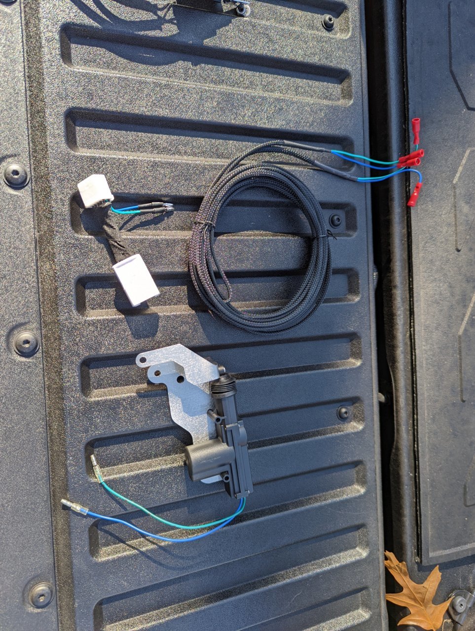

    60° for the first time in 4 months. So I installed my license plate/reverse light bypass harness from FBC, and my R4T tailgate lock. Both were really easy to install. Plug and play.

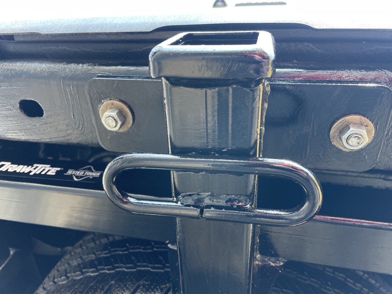

    Installed a DrawTite hitch receiver on my 2017 SR. Perfect fit. Bolted right up. D9DF198B-BF46-478F-B4AF-CEAD01F1961E.jpg 78319BF6-C22A-4B0E-B1D8-0A766D549363.jpg

    That's worth the Ghetto Mod of the Year award.

    I suggest using Velcro to attach those side compartments. That way if you need to remove the top centre console in order to perhaps upgrade the shift knob that has wires coming out of it you can easily re-attach them.
