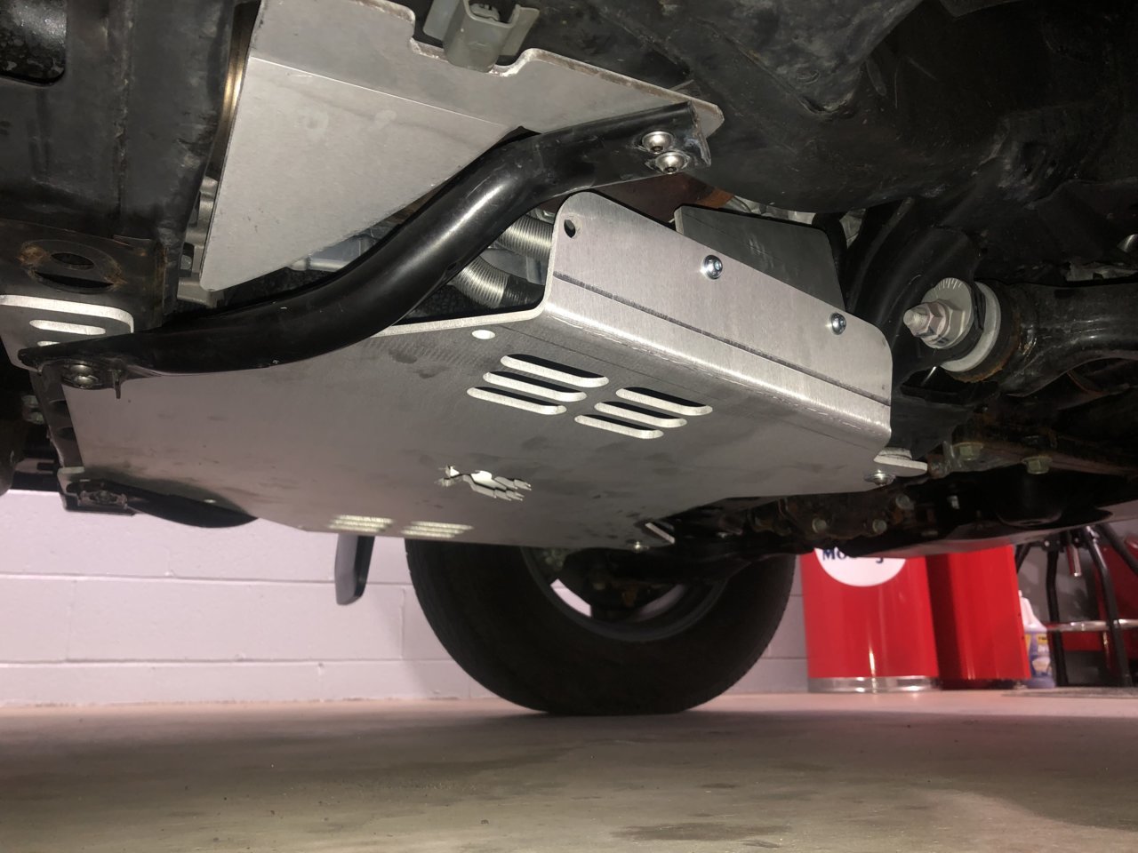

    Hey Edster. Here ya go. Done by myself without ramps, just a tad sore today! I told my wife that she might have to help me with the install, she was adamant… I’m NOT crawling under there! Hardest part for me were the rusted front holes. I used the non security bolts to run through to clean out the rust, very tedious. I put anti seize on the bolts for when it comes time to service the transmission, figured with the heat generated down there I’d rather be safe than sorry with eventually removing the plate. Everything is nice and tight, no rattles. Great peace of mind for sure. A13BEBBF-779B-4A46-BA73-E155C3E3C192.jpg

    That's a little different looking than mine...I noticed the bolts on the bent side...what do you have connected to it that extends?

    Ed,
    They’re little extensions that came with the shield. I’m not 100% sure that I have them on correctly, I’ve seen two different ways to install them from pics here. I have a message in to Shaun to see if I have them on correctly or not. If not it shouldn’t be too big of a deal to switch them around.
    I’ll post up the correct way once I get confirmation.

    Oh, yeah...I see. A little more protection for that open area?
    I see you have the cut-outs for the winglets...I just angled mine so they look a little crooked but I'm not bothered about that...it's underneath the truck! lol
    I still have to order a set of specialty bolts for the adapter I misplaced. I should do that today!
