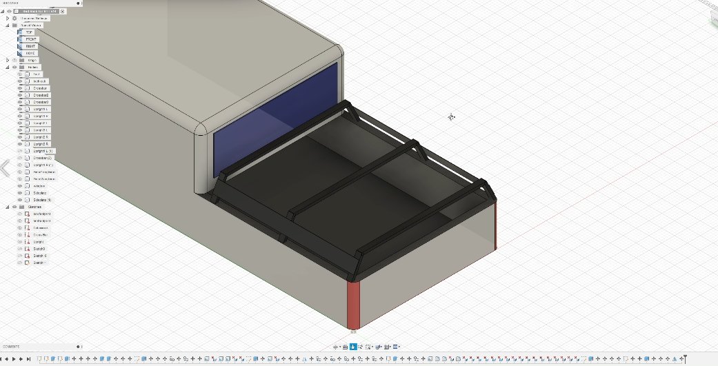

    Ended up designing and fabricating my own bed rack / crossbars. Pretty happy with how they turned out. What do you think?
    Rough Design:

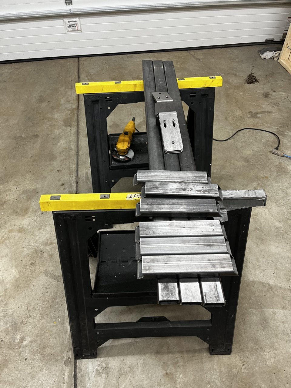

    Parts lasered, bent and CNCd.

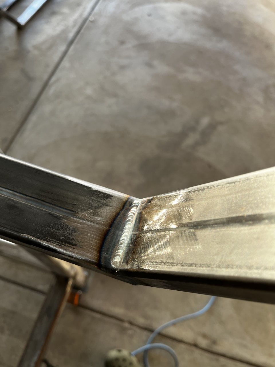

    Welds:

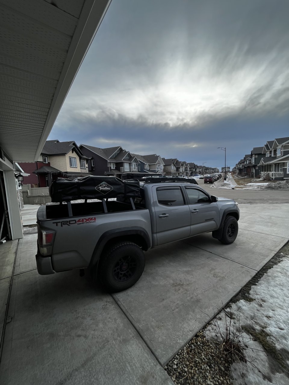

    Painted, completed, and installed:
    Let me know if I should have posted this elsewhere.

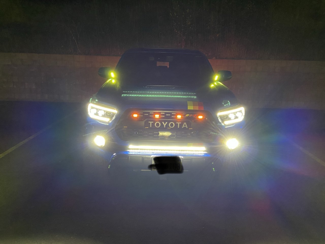

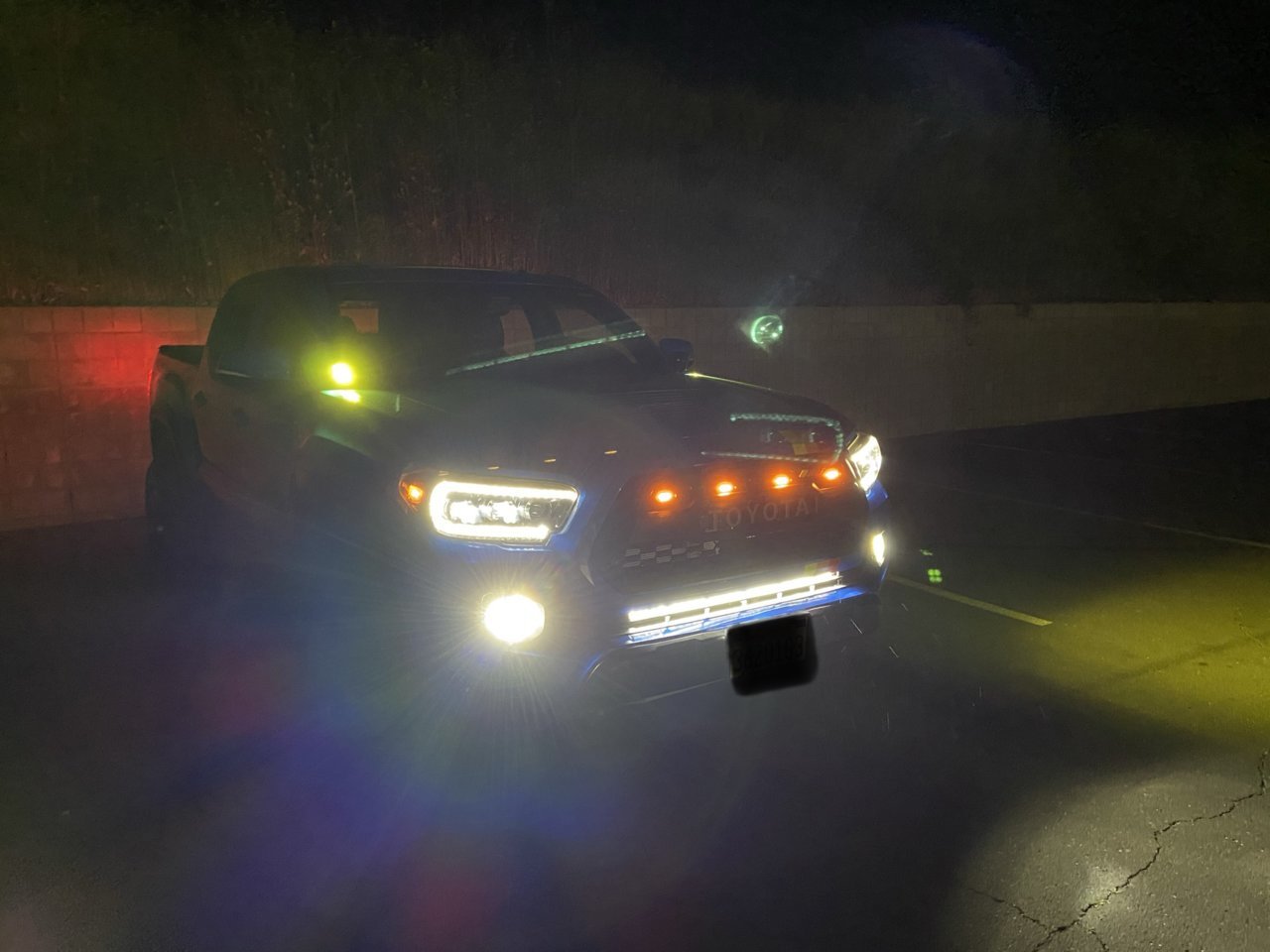

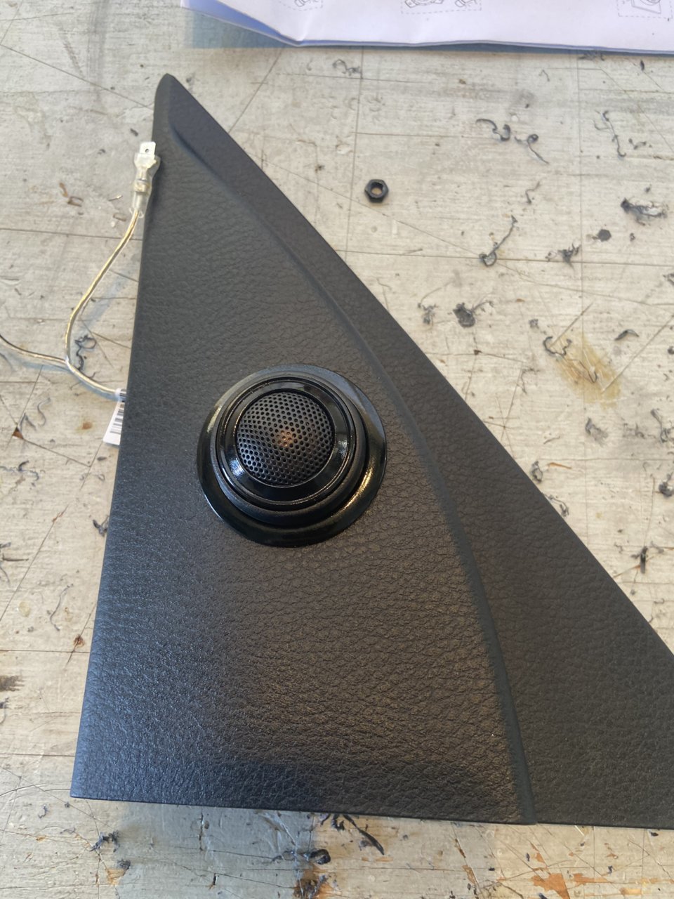

    Well, this all happened today. Finally got around to hooking up the hidden light bar in the grill with the auxito switch panel. Works great. And less than half the price of the switch pros.

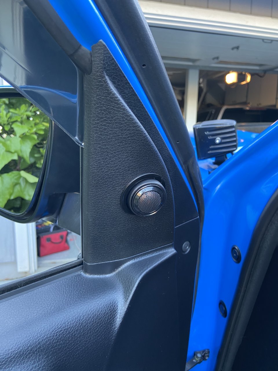

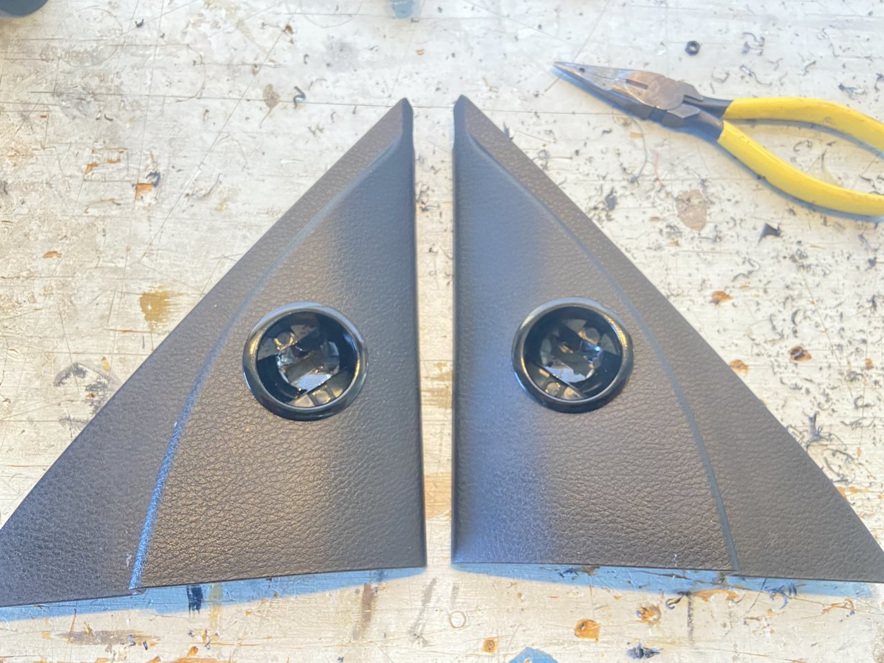

    Also did a little upgrading to the soundstage inside. Added some infinity kappa tweeters to the wings to help balance the front soundstage.

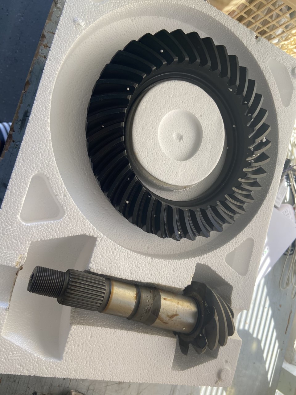

    My Revolution 5.29’s showed up today! Time to book an appointment with stellar built!

    How did you connect the additional tweeters to the stereo?

    I already have infinity kappa 6x9 components. The crossover is mounted to the inside of the door panel. I simply tapped the tweeter output of the crossover. I’m running both sets of tweeters together from the same crossover.

    This mod could be done with the oem system if you wanted. I installed infinity kappa 6x9 components previously with the crossover mounted inside the door panel, and ran a new wire through the door chase and up into the dash to connect the tweeter. So today, I simply tapped the tweeter output of the crossover for the second tweeter. They both work flawlessly and the frequency cross is correct because they’re both kappa 1.5” tweeters.
    however, if you wanted to do this mod with the oem system, you would simply tap the dash speaker wire, and run the additional wire down and into the door (as I did) and place the supplied tweeter crossover in line mounted inside the door. Drill your holes, and mount your speakers.
    been driving around for about an hour and re tweaking the sound in the truck. They’ve made a huge difference.
