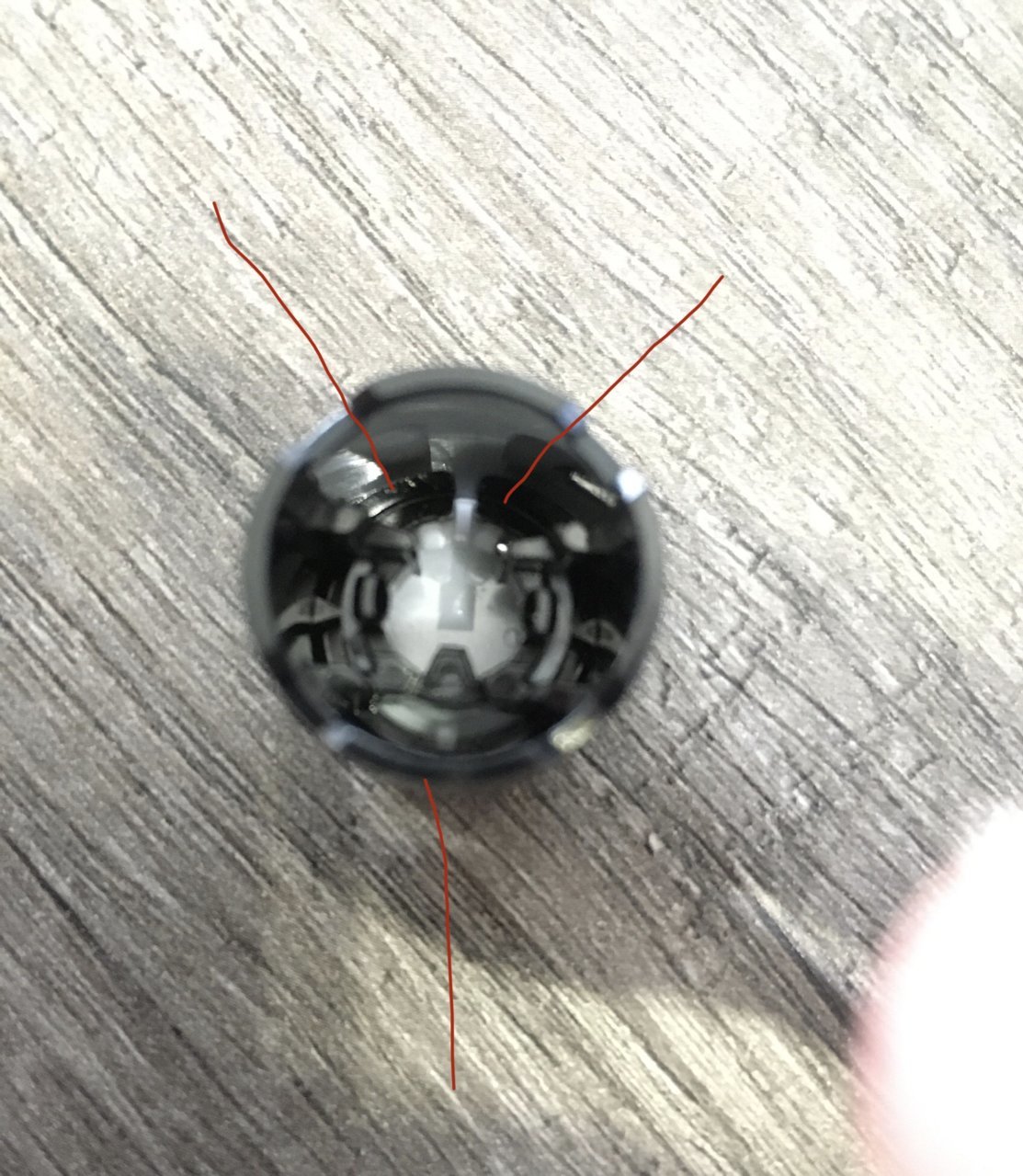

    tell us more! Such as how this comes apart and what you used for paint.
    I would also like to do this and would appreciate any tips/ hints.

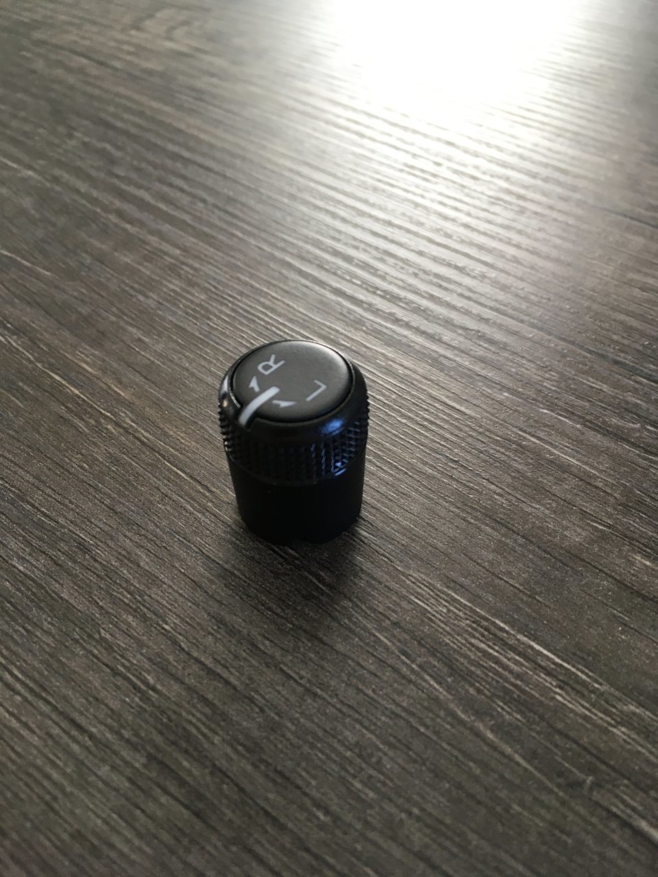

    You bet!
    The knob itself just pulls off of the interior panel of the truck. Once off, you flip it over and you can see there are three small white “clips” holding the two pieces together. Lightly pry those clips toward the center of the knob. Then the two pieces can be separated.
    Before sanding the chrome with 100 grit sandpaper, I taped off the black portion of the knob to protect its finish. When I finished scuffing up the chrome surface, I cleaned it, re-taped it, and sprayed it with satin black Krylon paint. The Krylon I had states it’s specifically made for plastics.

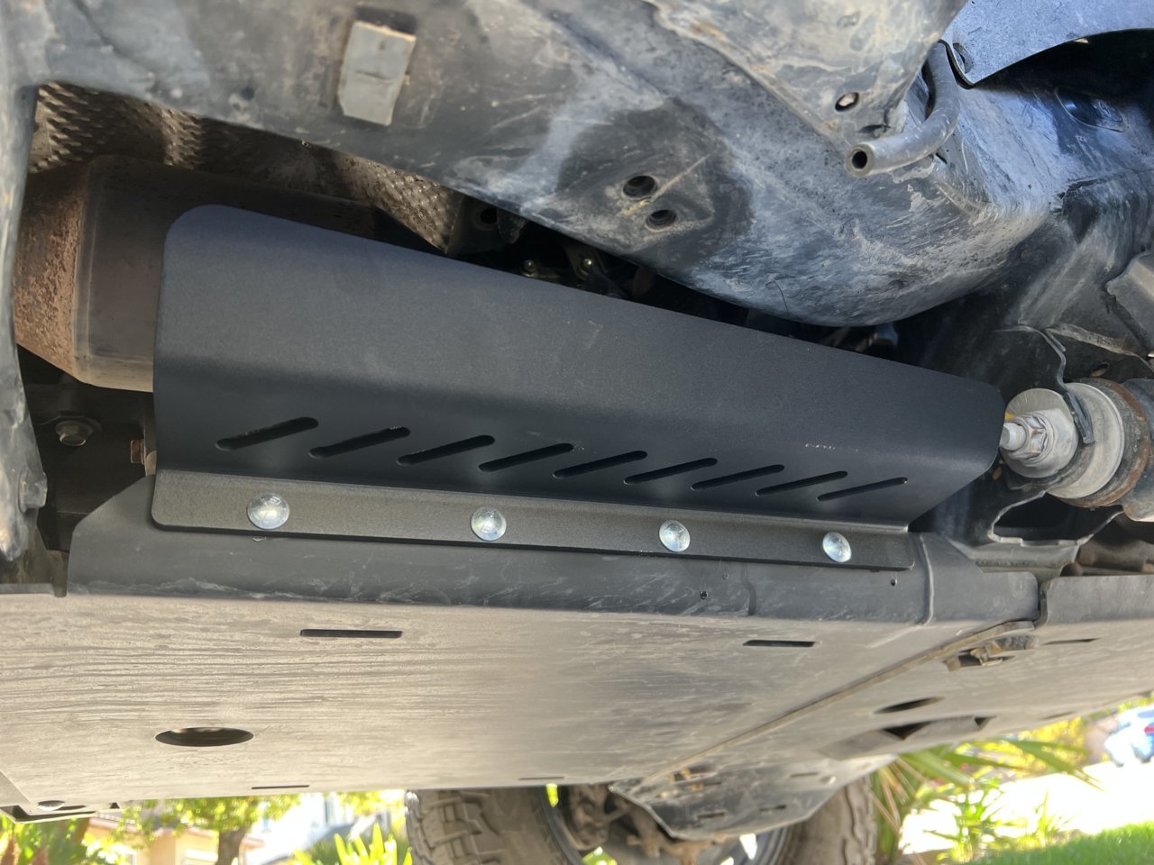

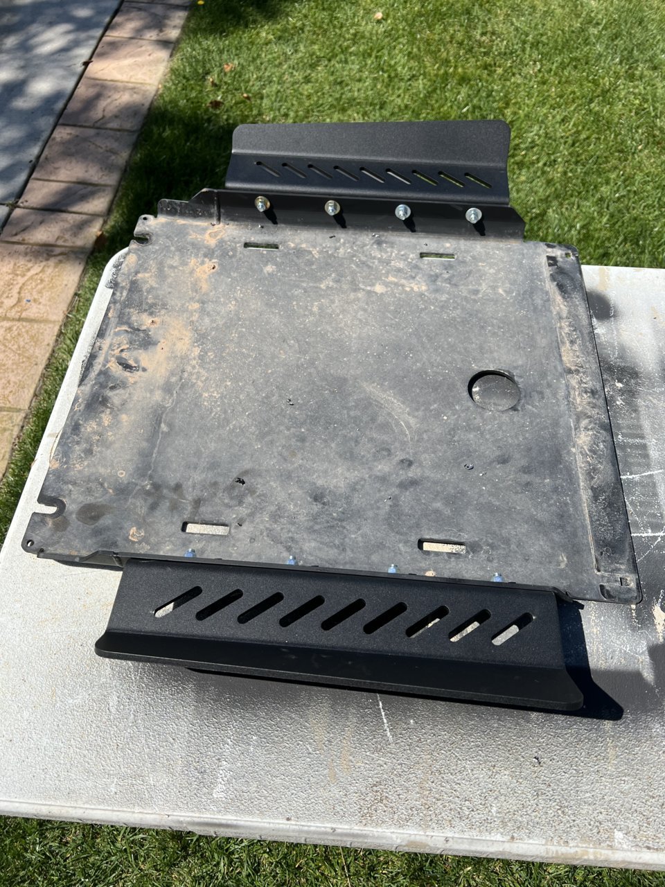

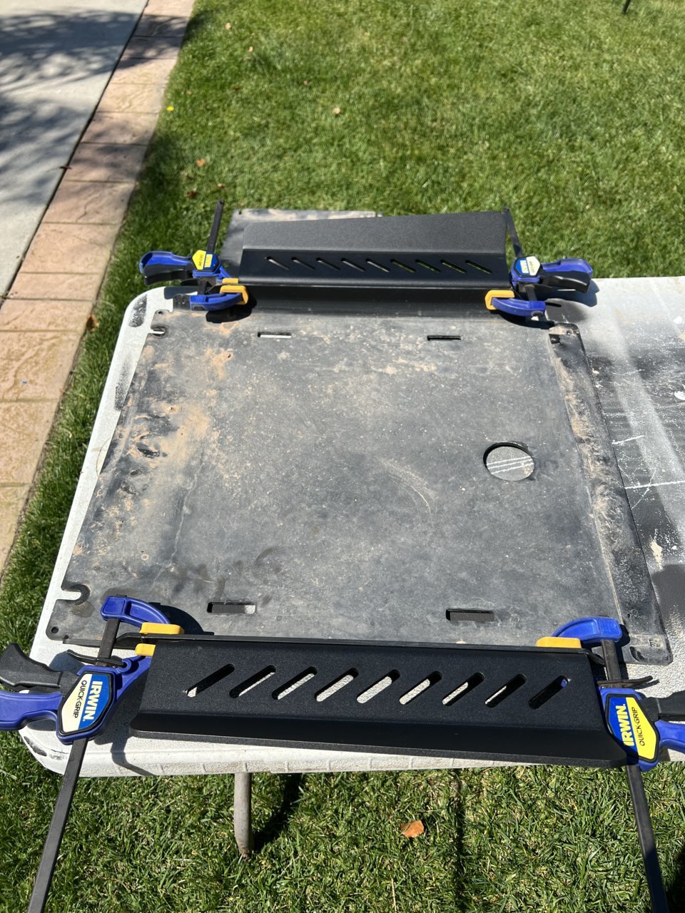

    Installed the RCI Cat protection today.
    about an hour, start to finish. Super simple.
    C40D6B2B-7C7E-4223-947C-AA16339BB7A8.jpg 19E1000B-AF04-4D96-B698-EBF232D38EDA.jpg 12BCDEAB-394E-4CDA-8751-518D5344A6FC.jpg

    awesome! Thank you, looks like I’m doing this tomorrow since I just picked up the Meso chrome delete kit and planned to install it tomorrow anyway.
