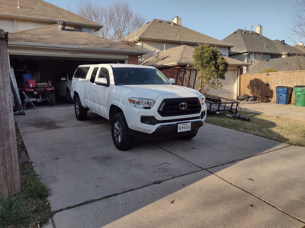

    This week I got new Toyota alloy wheels installed to replace the steel wheels, took off the visor decals, and gave it a good wash this afternoon.
    I really like the tiger stripe effect of the sun through the picket fence.
    Here it is from the other side
    You can see my wife's 2008 Highlander in the garage along with my Honda Rancher 4-wheeler and the trailer I use to haul it with in this picture.
    I bought this truck about a month ago and I'm really happy with it. I've always had good luck with Toyotas starting back in the 1970's.

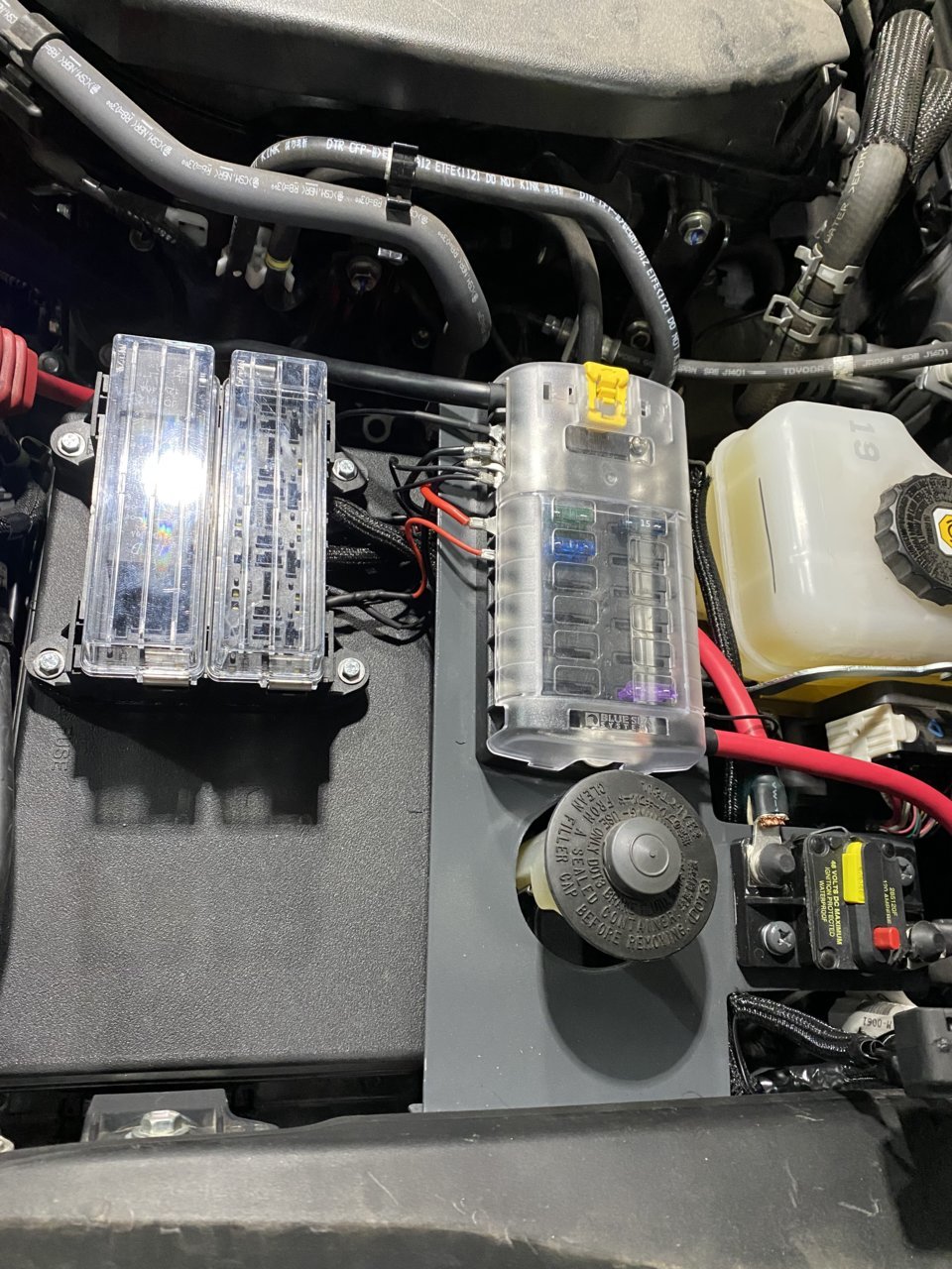

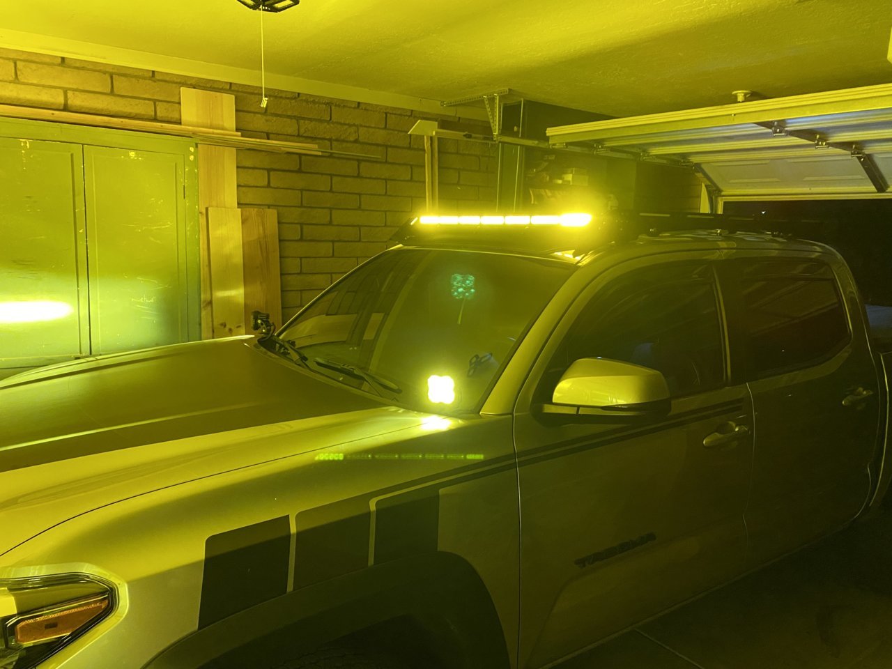

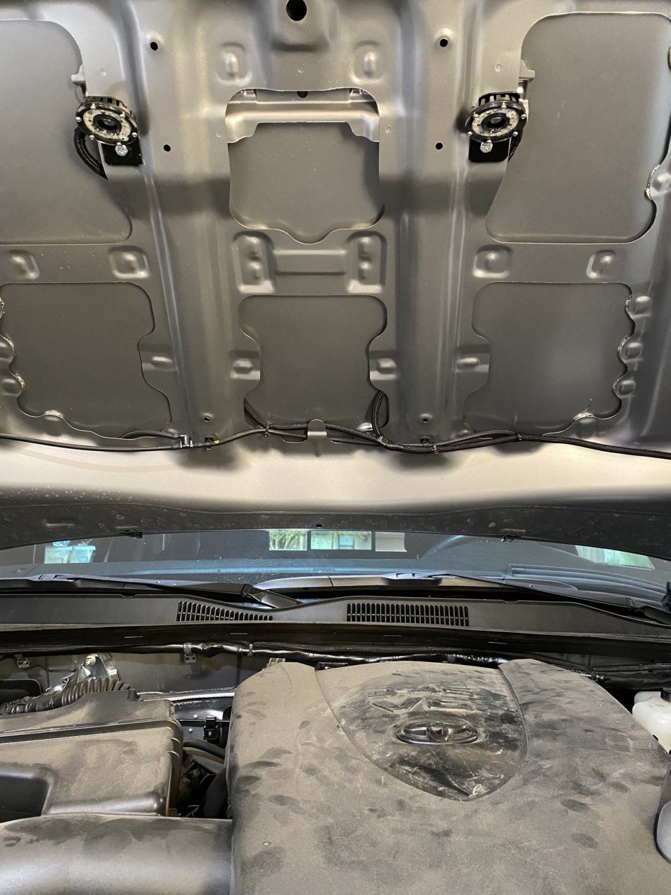

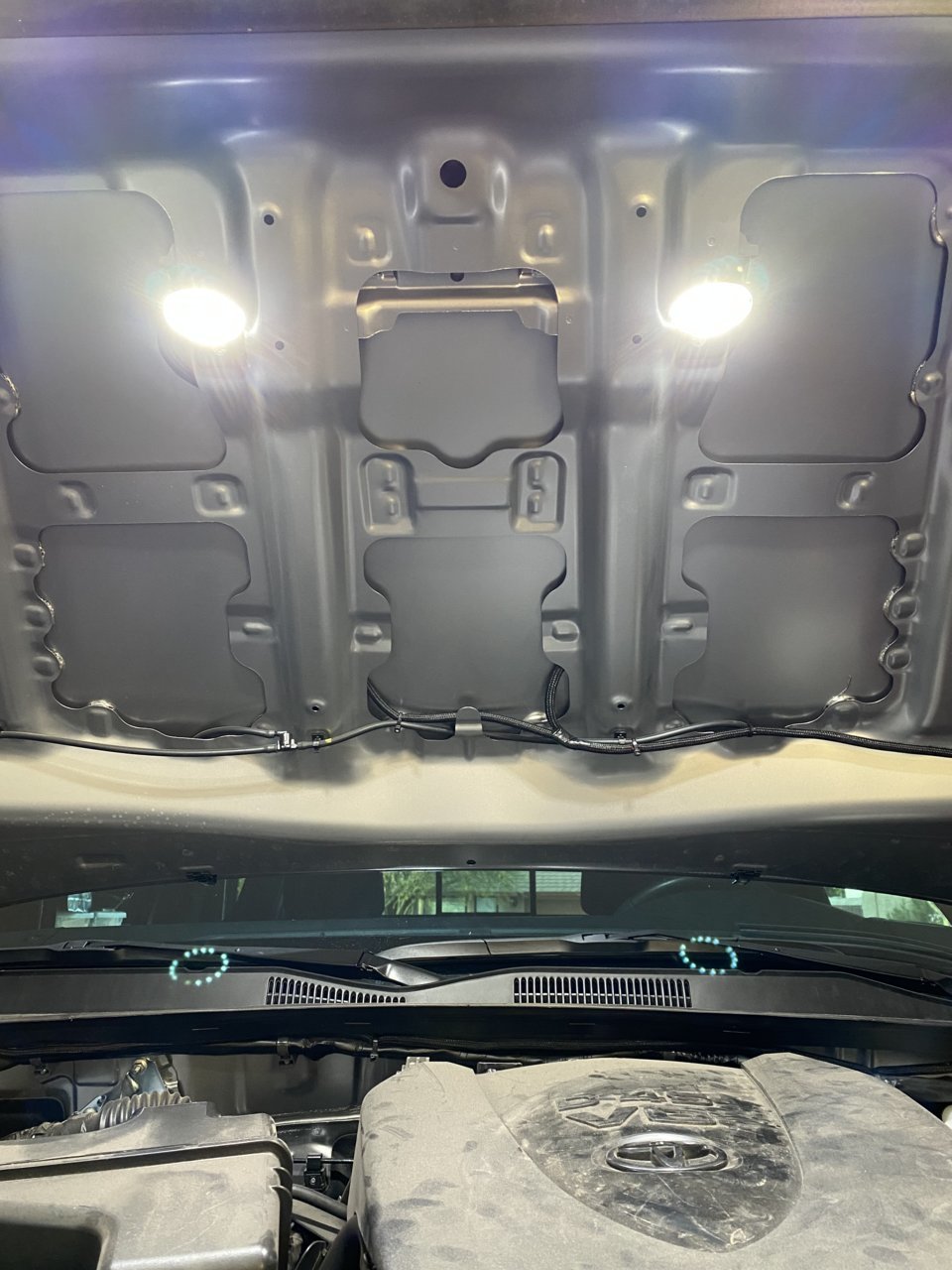

    Finally got the my fuse block and relay block wired up and mounted. Rerouted my light bar, hood lights, and ditch lights, wiring can be a little better, but works for the time being. Relay block is not drilled into factory cover, cut a piece of ABS plastic and used heat set inserts to attach the block and then 3M dual lock to attach to the top of the fuse cover. This way I dont have to drill into the legend inside of the lid.

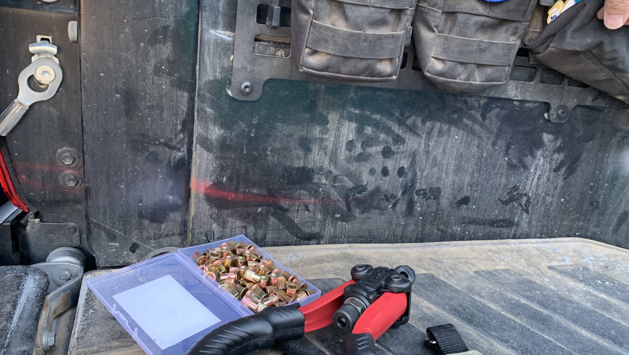

    Just an fyi:
    If you hate(I did) that 2019+ Tacomas no longer have the driver side bed cubby that doubles as an attach point for your MOLLE panels, you can drill and add M6 rivnuts and order a couple of the OEM T30 torx screws to fully secure the panel. Having it float freely annoyed the shit out of me even though it was plenty secure without.

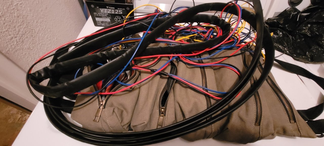

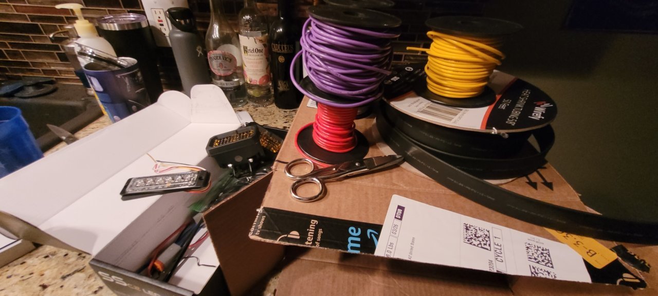

    I have some yellow DD SC2 pod lights sitting around & I also just received my Dunarri Pierce chase light, so I fabbed up a nice little wiring harness for my roofrack. The SC2s will go on my Prinsu above the L/R rear doors for campsite lighting, while the chase light will be bolted to the rear rack rail. The SC2s also have a low-intensity amber backlight, so I’ve dedicated one circuit on my SwitchPro for amber backlighting both simultaneously, while the higher intensity yellow lights will have 2 dedicated circuits, one each for left and right. The chase light will be setup primarily for burst strobe pattern, but I’m also going to see how it does for rear ambient lighting. It’s ridiculously bright, but I can program my Switch Pro to dim it in 3 stages, so we’ll see how it does. I have a BAKflip that covers the cab mounted cargo light when it’s flipped up, but since the Dunarri chase light will go on the roofrack, it may light things up alright. I shall see if it’s good enough to serve dual purposes.
    Many of the roof wiring installs I’ve seen over the years have been utter hackjobs, so I wanted mine to be ultra clean and look as OEM as possible. Keep in mind that all the wiring not in shrinktubing is excess that will be trimmed to needed length under the hood and at each of the three lighting positions. All connections will be done with marine grade hardware and individually shrinktubed as well. I’ll post up the finished product once I’ve had some time to install everything.
