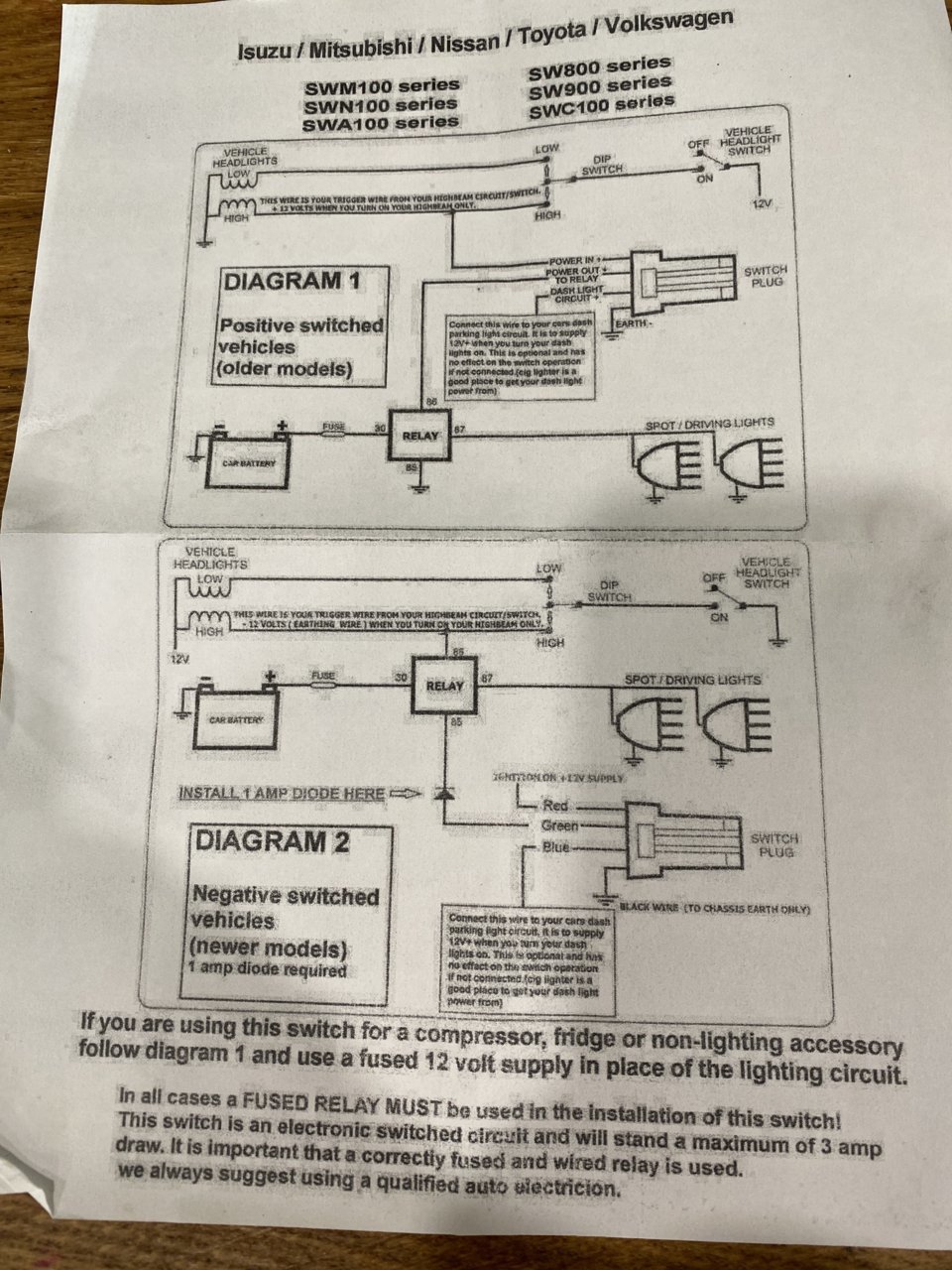

    Maybe this can help:

    That’s what I turned up in my googling, but I was wondering if there is more to it than that.

    Let’s just say I have some already wired, and no diode. But no problems. Knock on wood. I’m using Kyle’s piggyback harness but I don’t think that matters. It just seems strange and I guess I overlooked it.

    Based on the diagram, it looks like it's a safety mechanism to prevent 12v+ from entering the relay from the wrong terminal. In a negatively switched setup, the switch is connecting the 12v+ to ground. If the switch connected to (85) were to malfunction it could send 12v+ into the relay and short it out (maybe, I'm not an electrical engineer). It could possibly blow not only the 12v+ main fuse going into the relay but also the fuse on the trigger line as well (86). With the positive switched setup it's not necessary since (85) is connected directly to ground. Just like a fuse, under normal circumstances it should never be necessary for the proper functioning of the system but when one thing gets messed up it is there to keep the angry pixies going in the right direction.

    As long as your relay has a diode or resistor built into it, you're going to be okay. The Diode is there to prevent a voltage spike when the electrical field from the coil collapses. Most relays have these built in (either a resistor or diode. They serve the same function for the most part). If you look at the diagram of the relay, you will see a diode (or resistor) in line with the coil.
    If you want to be super safe, putting an additional diode won't hurt but with a decent relay, isn't necessary.
