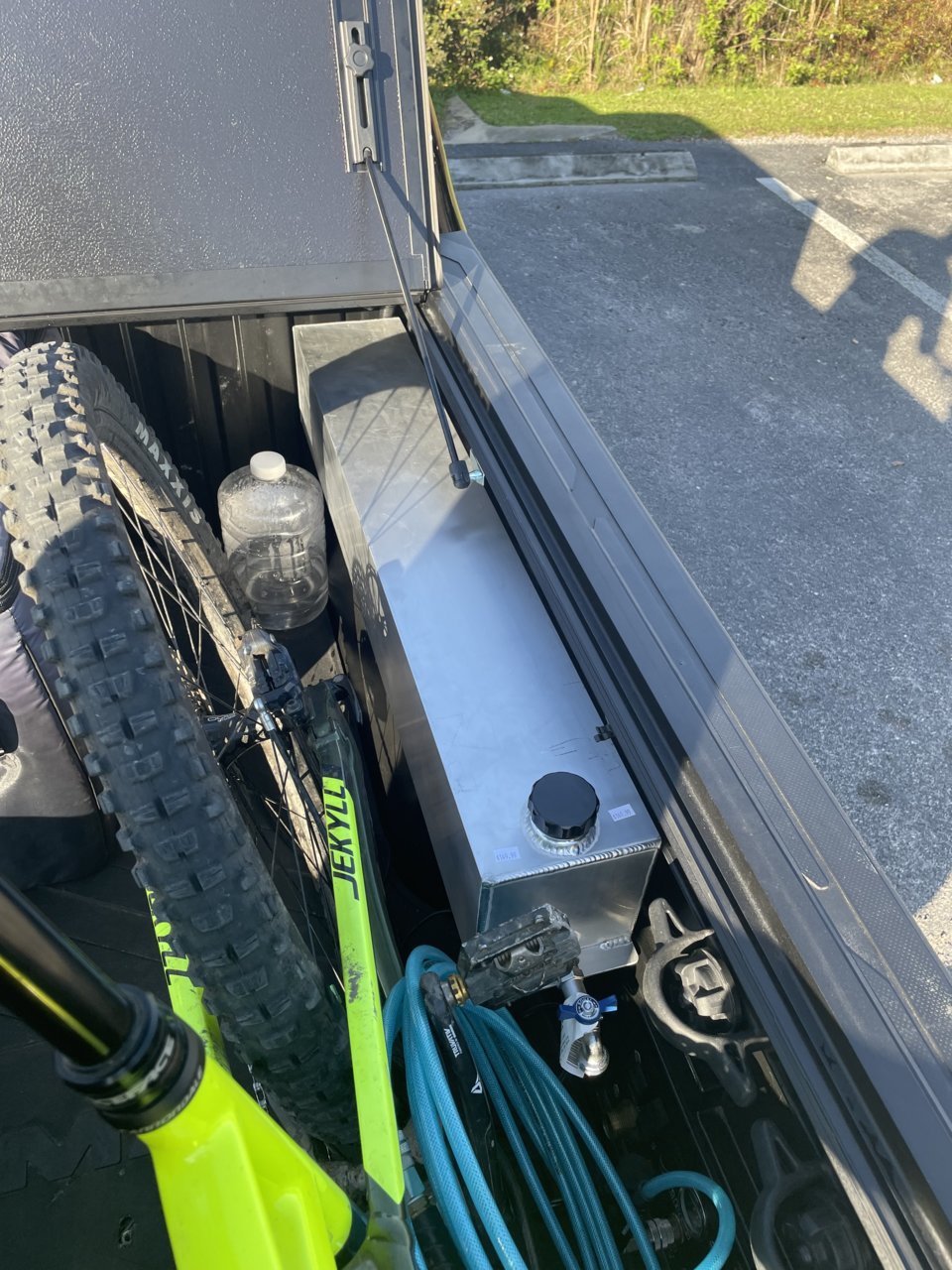

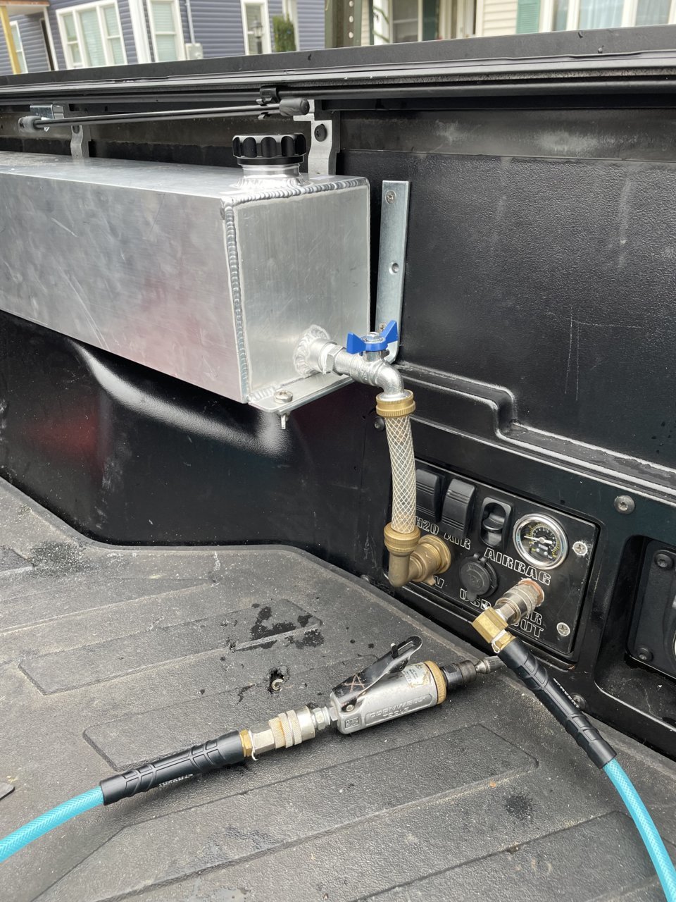

    Looks good. The Viair 2.5gallon tank fits above the spare if you want to get more capacity. I have a similar setup. It was super useful that my brother built a CNC machine last year and we have a 3D printer. I printed 2 parts that install inside the passenger side cubby and these parts have threaded brass inserts for the plate to bolt to. The plate is 1/8" aluminum that I painted black and had the CNC cut text out to make it look professional. Viair compressor bolted between the driver side bed and quarter panel. Boat water pump is directly under the bed. 5.5 gallon water tank comes from a hunting supply store in northern florida. Tank attaches with 2 wing nuts and slides into a bracket that was CNC cut.. Blue Sea Systems fuse block directly behind the plate, being fed from a 50A circuit breaker near the battery. Firestone airbags with a pneumatic switch.
    I am thinking about creating a kit if there's enough demand.

    I would consider, if tank is under bed.
