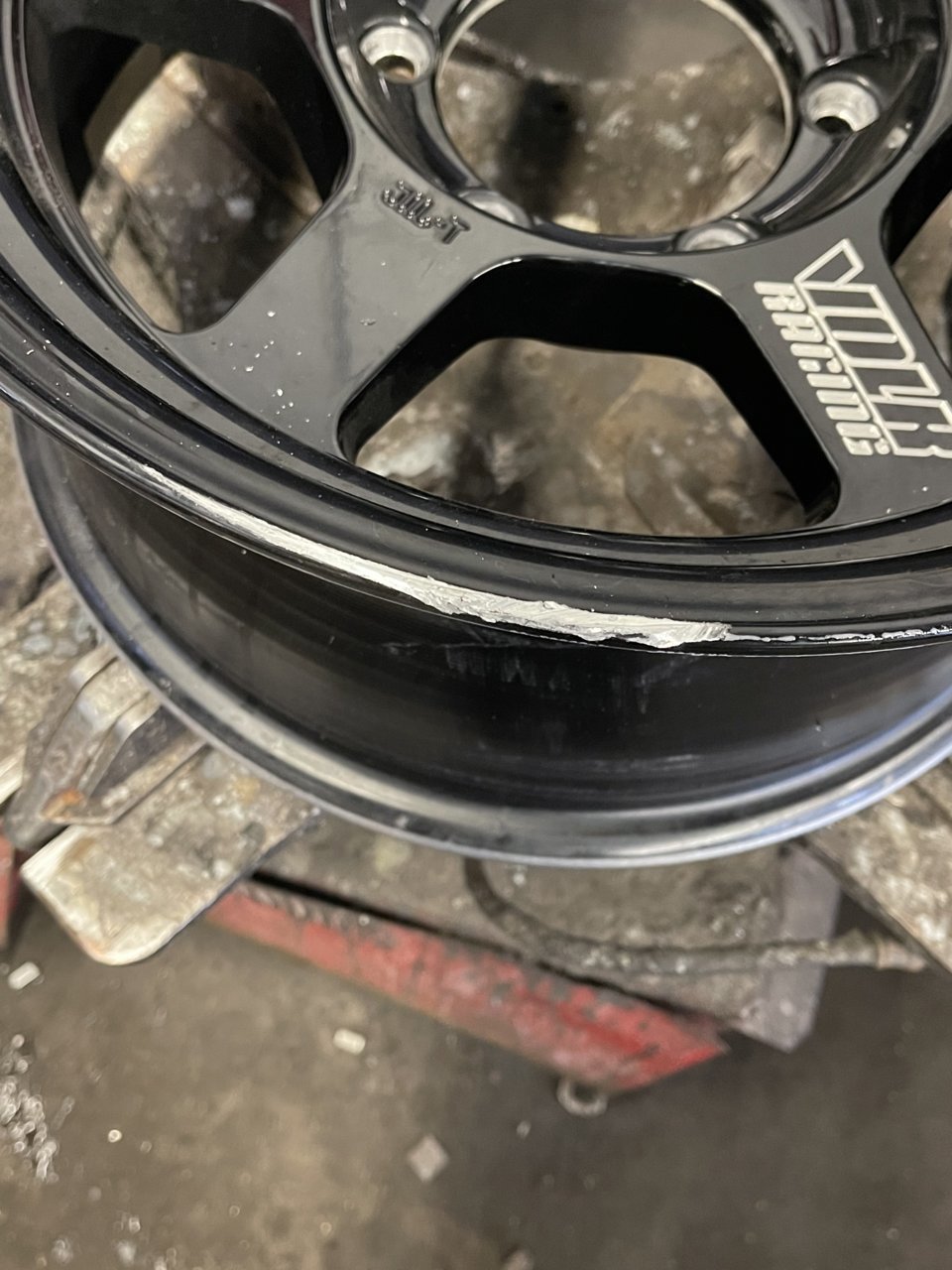

    Look for a mobile wheel repair guy or take to a shop. In most cases they can sand it and repaint it and you can't tell the difference. A valet accidentally clipped a curb in my M3 and the cost to replace the wheel was $1300. A mobile repair guy was able to make it look new and was about $150.
