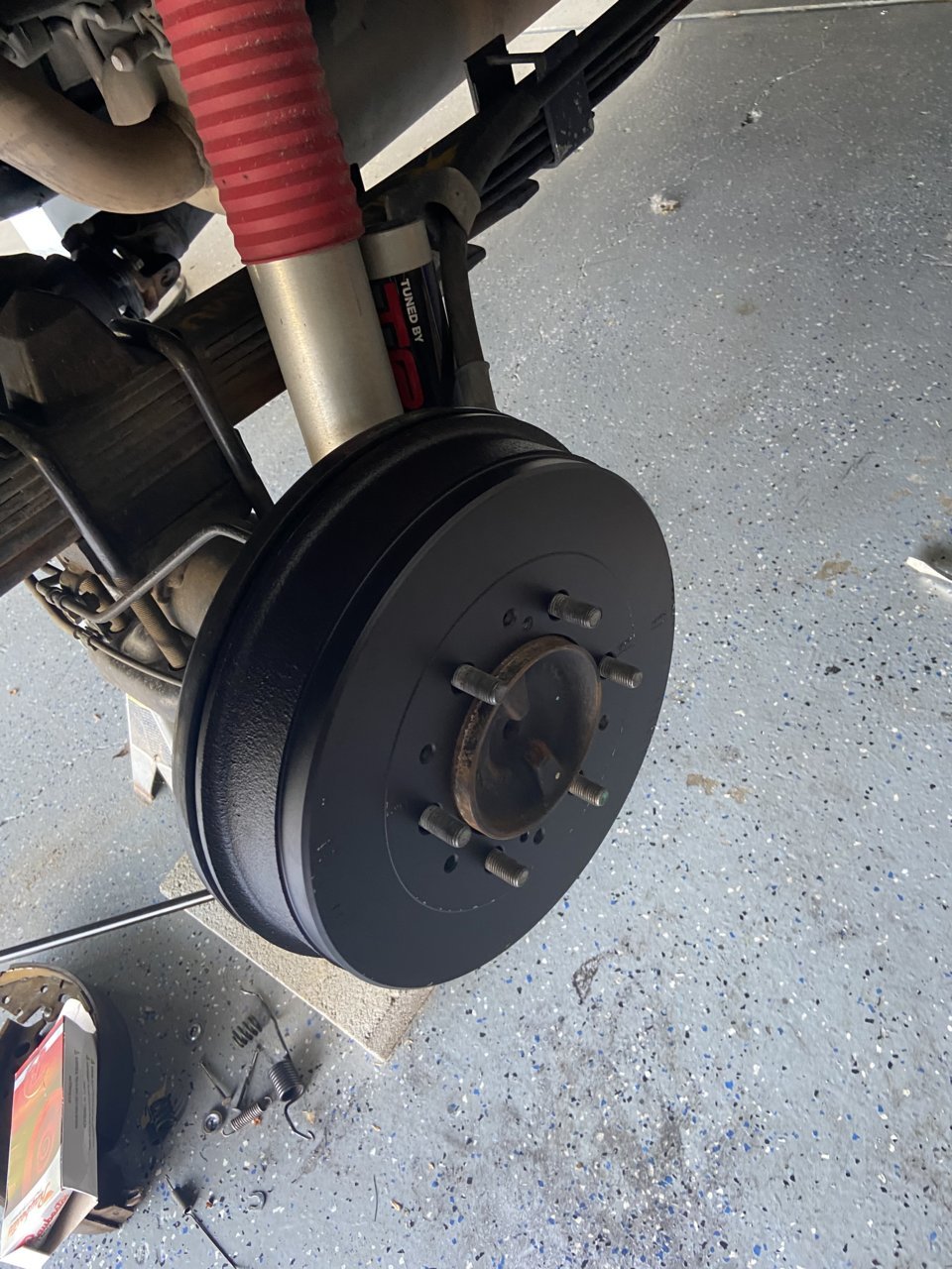

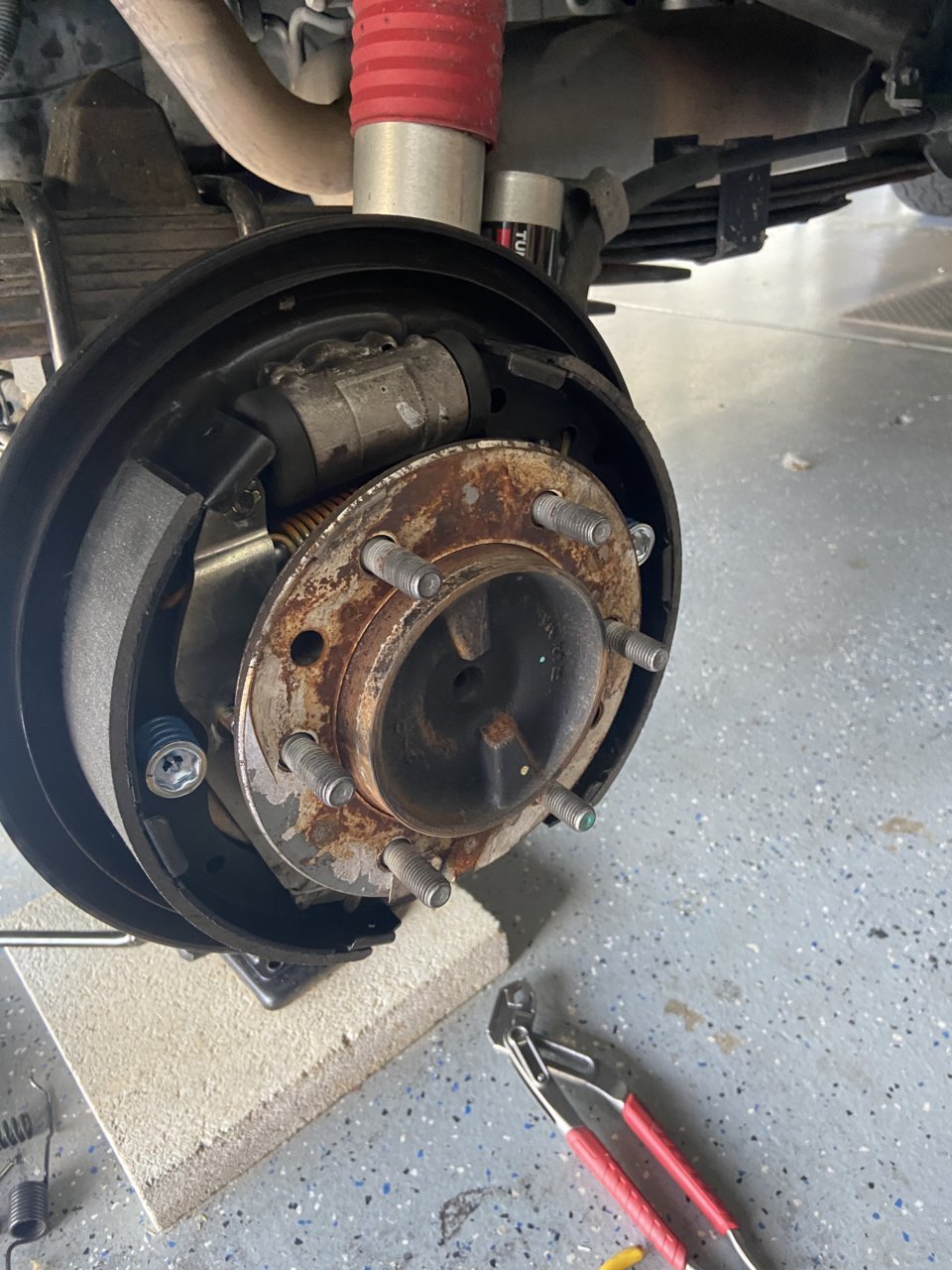

    That will adjust the star wheel on the drums (move drum shoes closer to drum hat) not the parking brake itself.

    Correct, and in doing that the shoes should not have to move as far to contact the drums.
    Shouldn't that help the parking brake also?
    And then a little adjustment on the E-brake cable under the truck or on the. E-brake handle its self

    I don't know about the tacoma, but the parking brake usually has a separate set of "shoes" or pads. It's been a while since I've done it, but some have a clockwise or counterclockwise adjustment on the cable itself.

    Yea Ive had a few cars like that.
    In his pic it looks like one set of shoes.
    Could always put the rear axle on stands, spin the wheels by hand and adjust them till they drag a little.....

    one set of shoes per side. I adjusted the star wheel out as far as I could and still get the drum on before. But it just doesn’t want to hold like it used to.

    VHT HIGHT TEMP engine enamel. Flat black. Hit the center of the rotors too. It did come out nice. Thanks.
