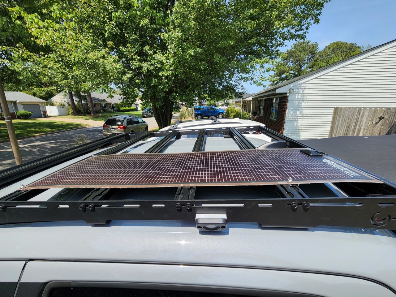

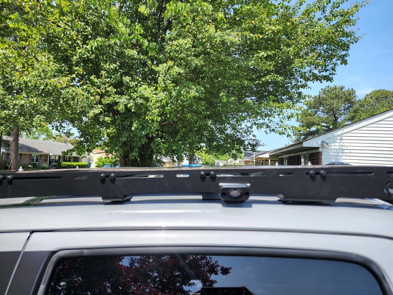

    Installed a low profile 14Watt solar panel to my roof rack. 20220501_120404.jpg
    It's a stick on solar panel I attached to some kydex and bolted to the roof rack. You can see how thin it is.

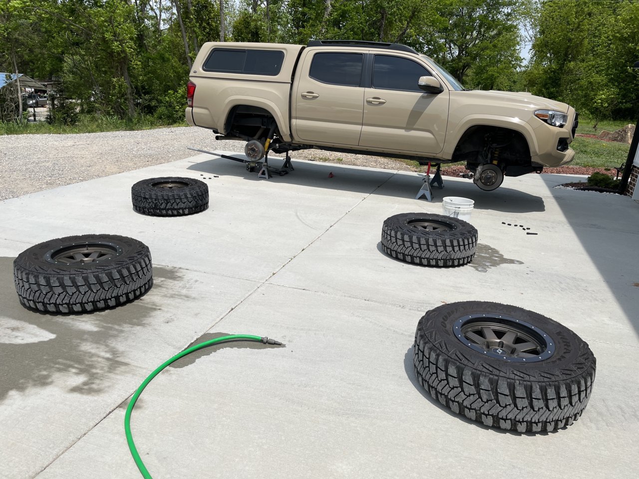

    Tire rotation

    i dig the low profile look. What rack is that? Im looking at various options now and one of the purposes of a roof rack for me will be to add solar.

    It's a Prinsu double cab rack! I have plans in the future to add a water port and awning.

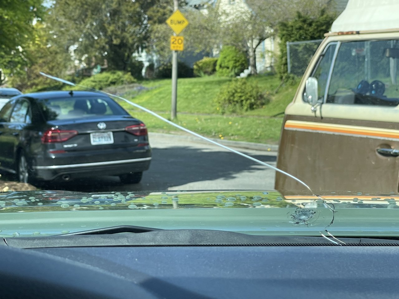

    Keep us posted on the install- i’d love to upgrade mine

    I had to replace mine after rock damage too lol- word of advice….Measure the gap at top of windshield to body before you have it replaced and be damn sure its the same after install. My first replacement was a hair bigger on the gap and it howled like a banshee when driving it. I mean awfully. This is what i’m referring too:

    Prinsu definitely seems to be the most popular option on here. How’s your wind noise since installing the rack?

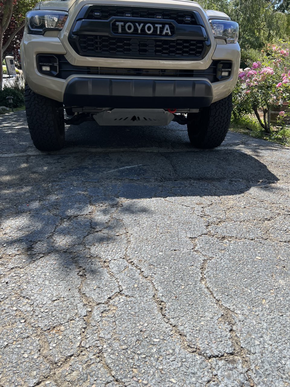

    I’m so jealous of your concrete pad…..here’s what i deal with lol….

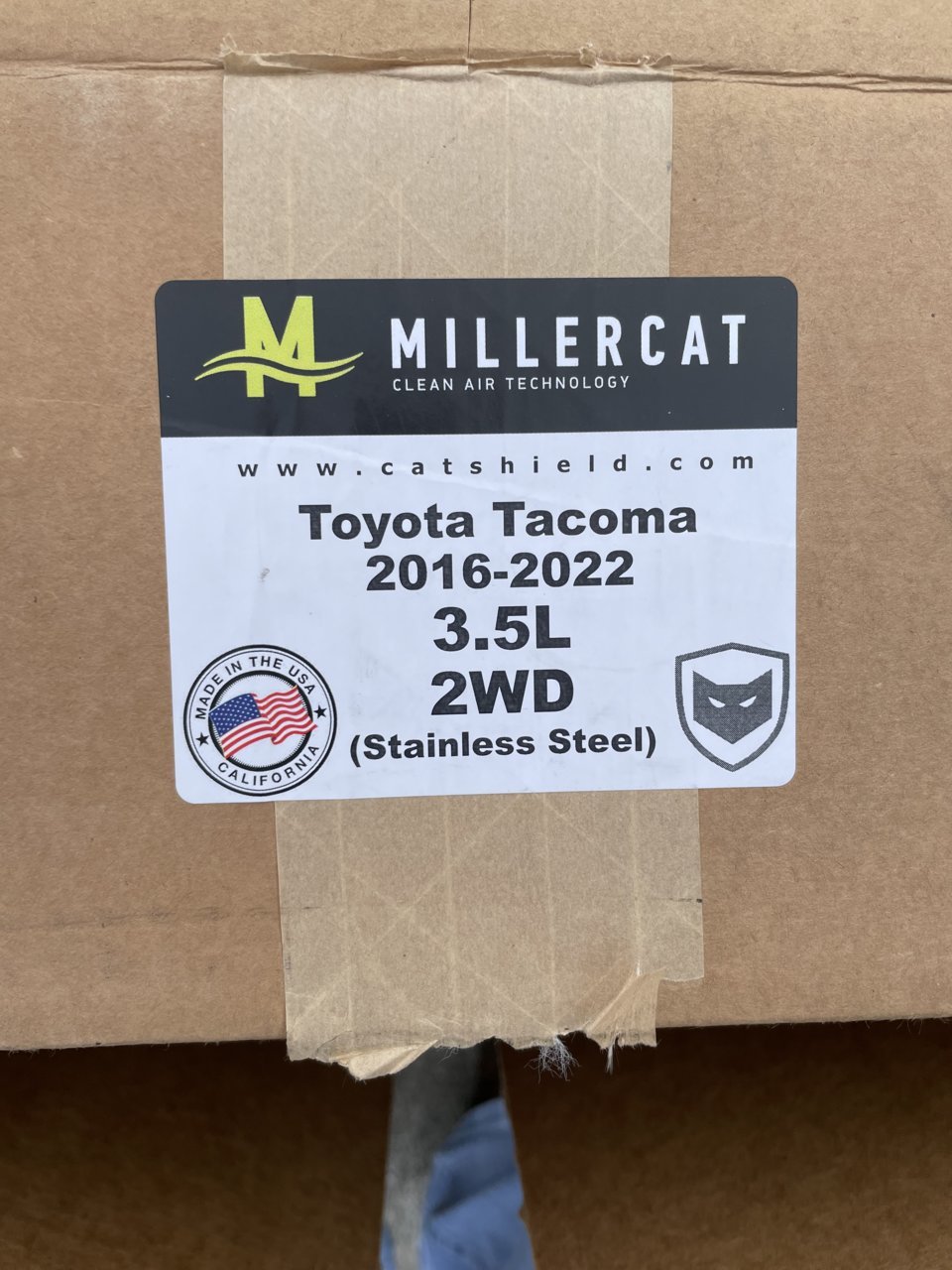

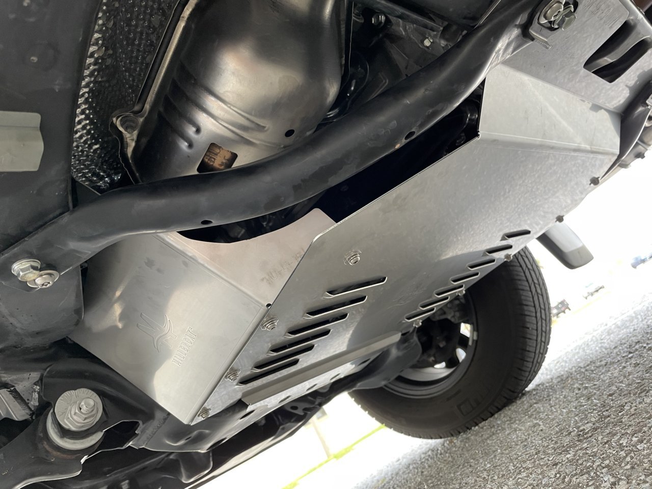

    Today I decided to try two mods. I installed the MillerCat converter shield in stainless steel. No problems.
