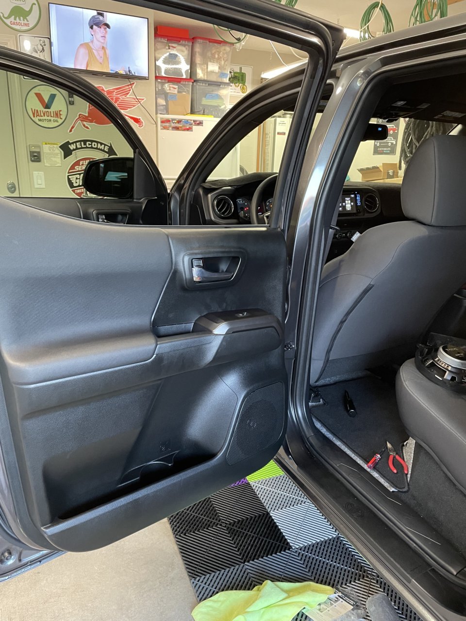

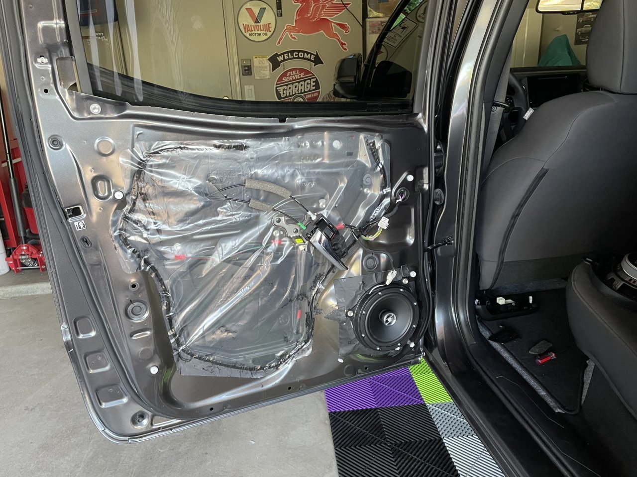

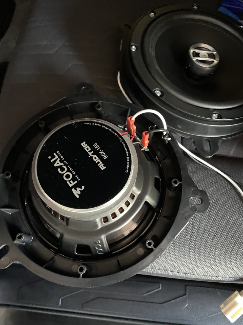

    how hard was it to take the door apart?

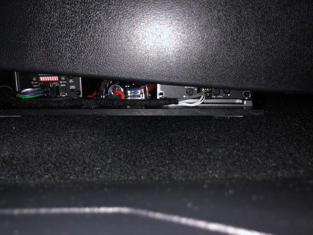

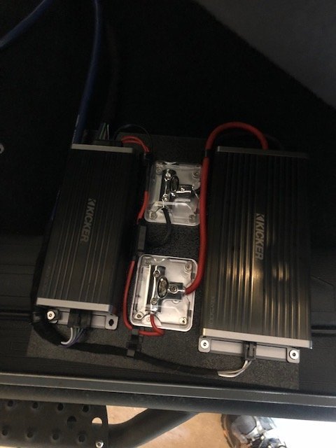

    Amazing how small high power amps are these days. This is my old school system in my other truck. Each amp is bigger than both of those. Lol

    MGMDesertTaco Come on, live a little...

    Not hard at all, 2 screws and push pin. The door handle just pushes out, but be mindful of the cables. Putting it back together is another thing. The clips on the top left of the panel like to fall back into the door cavity and the white circle clips need to be pulled with pliers and attached to the door panel before clipping the panel back on to the door itself. The door panel just hangs on metal below the window and clips in with a bunch of plastic clips.
    Extra clips can be bought from Amazon.
    https://www.amazon.com/Rexka-Mouldi...ander+c-hr+yaris+scion+xd,aps,102&sr=8-1&th=1
    https://www.youtube.com/watch?v=6zGxEbiarPc

    easy. one screw in door pocket/handle, one behind handle. sharply pull bottom to release clips.
    important to remember to full seat your handle actuation cable. fully. if you dont you will be unable to open your door and have to snake tiny pliers in there.

    I hear ya I was going thru some old gear in my attic a couple weeks ago and came across the old Precision Power amp I had in my 82 standard cab pickup. I starting wondering how I ever found room for that, an electronic crossover and 2 10" subs back there haha.
