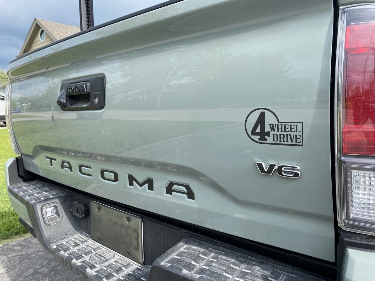

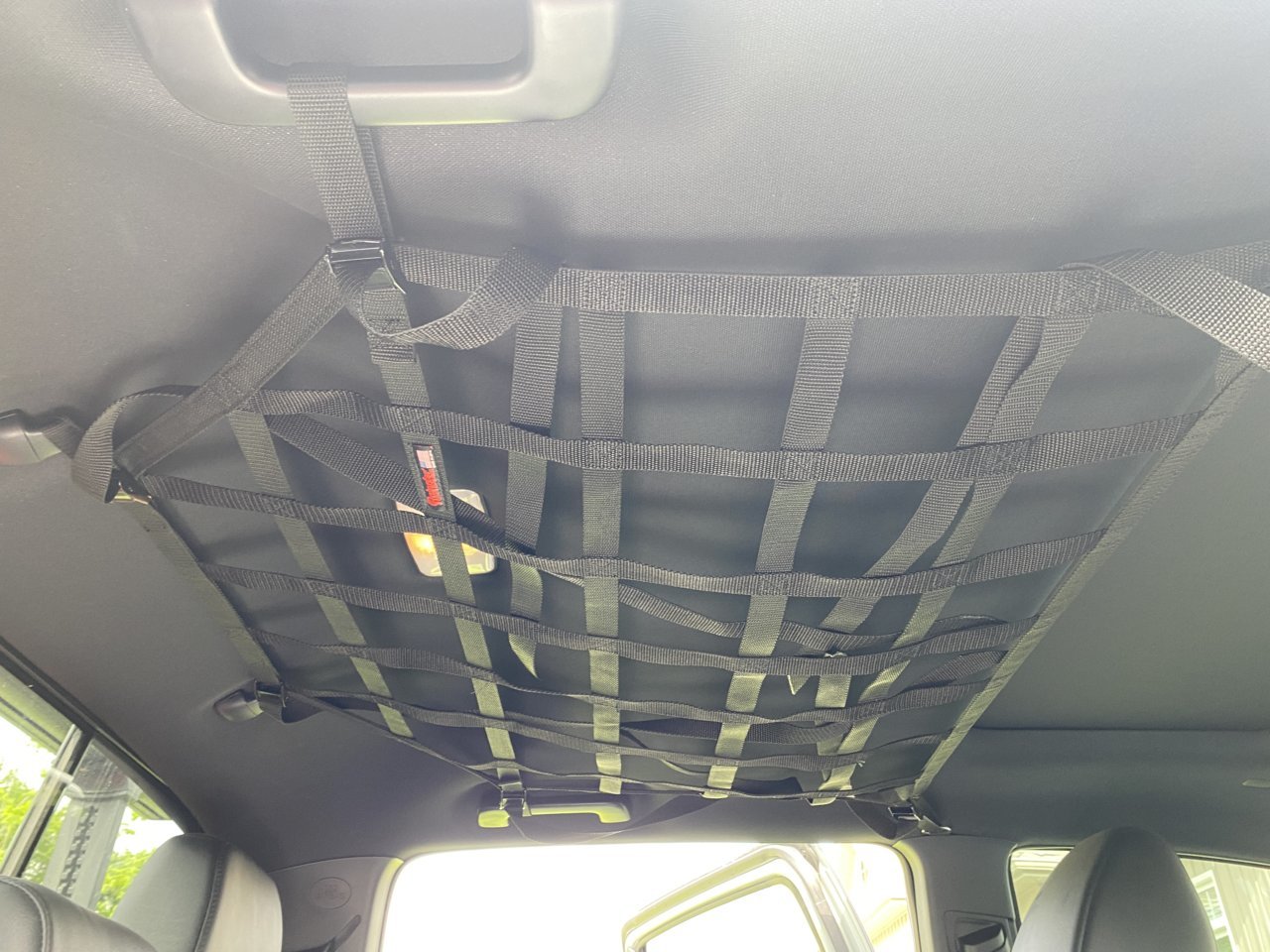

    Installed tailgate and old school Toyota 4wd decals today. Also installed my Raingler attic...don't be fooled by the short video, it's a bit of a PITA to install! I also need to trim the straps...they are way too long.IMG_5819.jpg IMG_5821.jpg

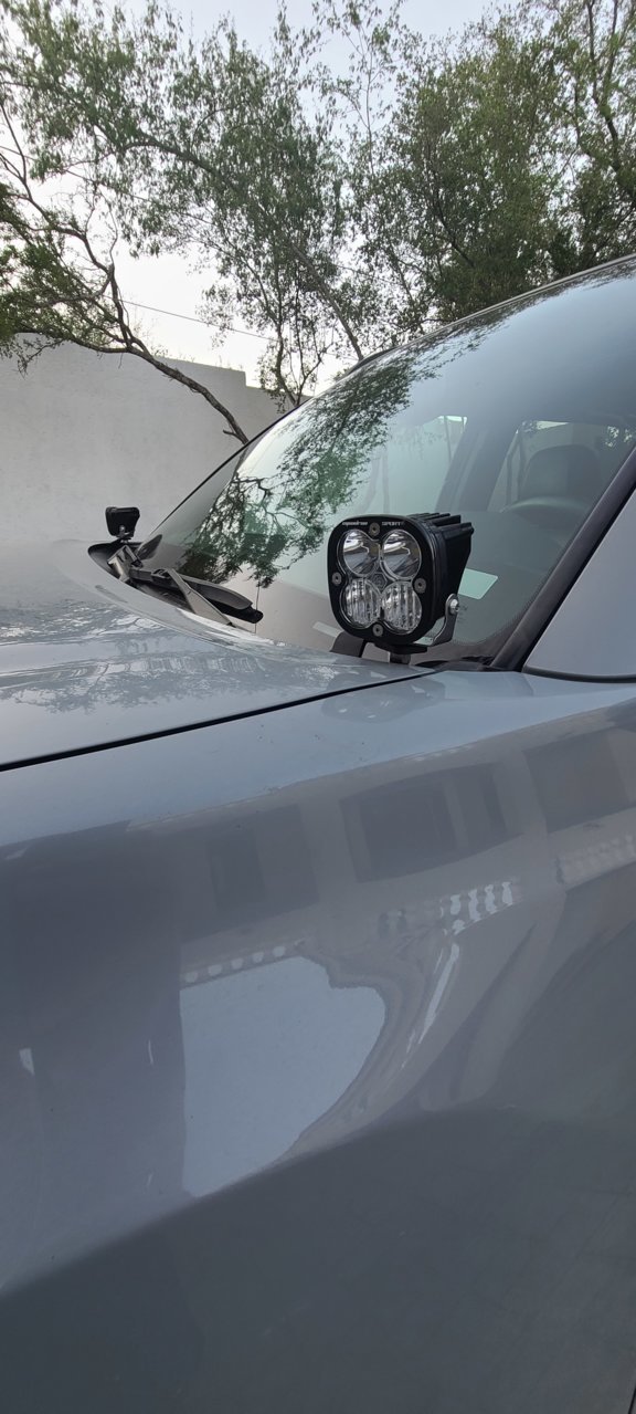

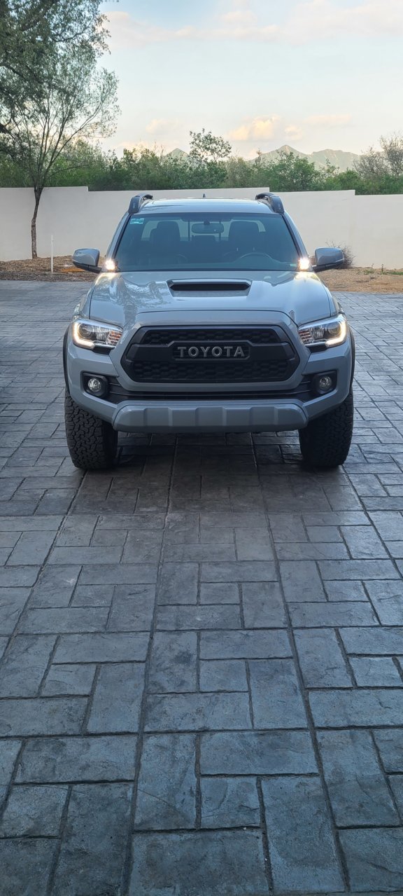

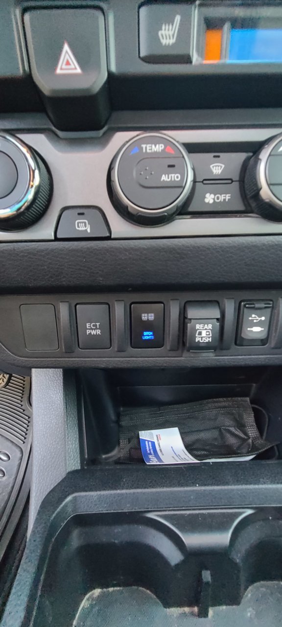

    Baja Designs Squadron Sport ditch lights and some Cali Raised low profile mounts. 20220526_194057.jpg 20220526_194837.jpg Being a noob, and dumm, I ordered the small OEM switch without realizing it. Found a video on here from 3 yrs ago (Thanks MESO) of an easy way to access the switches in the center. Saved me ALOT of time and cursing.

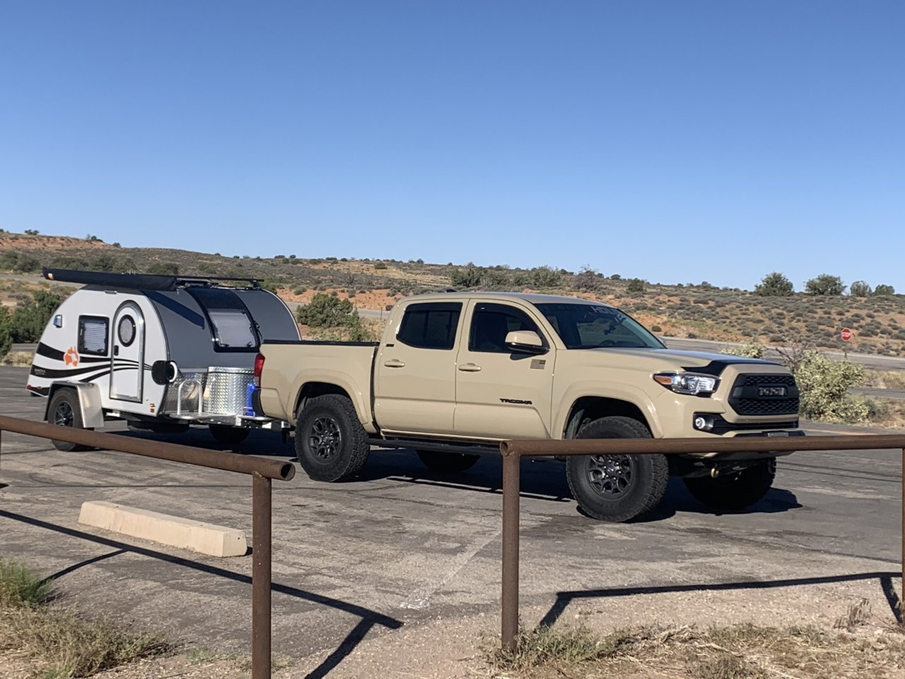

    Love the tear drop! got a picture of inside?

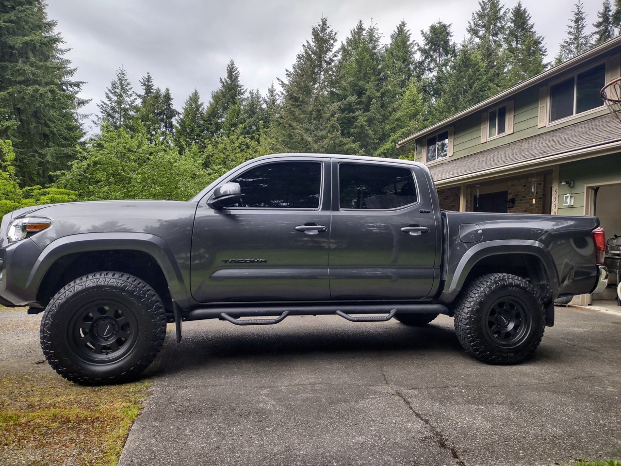

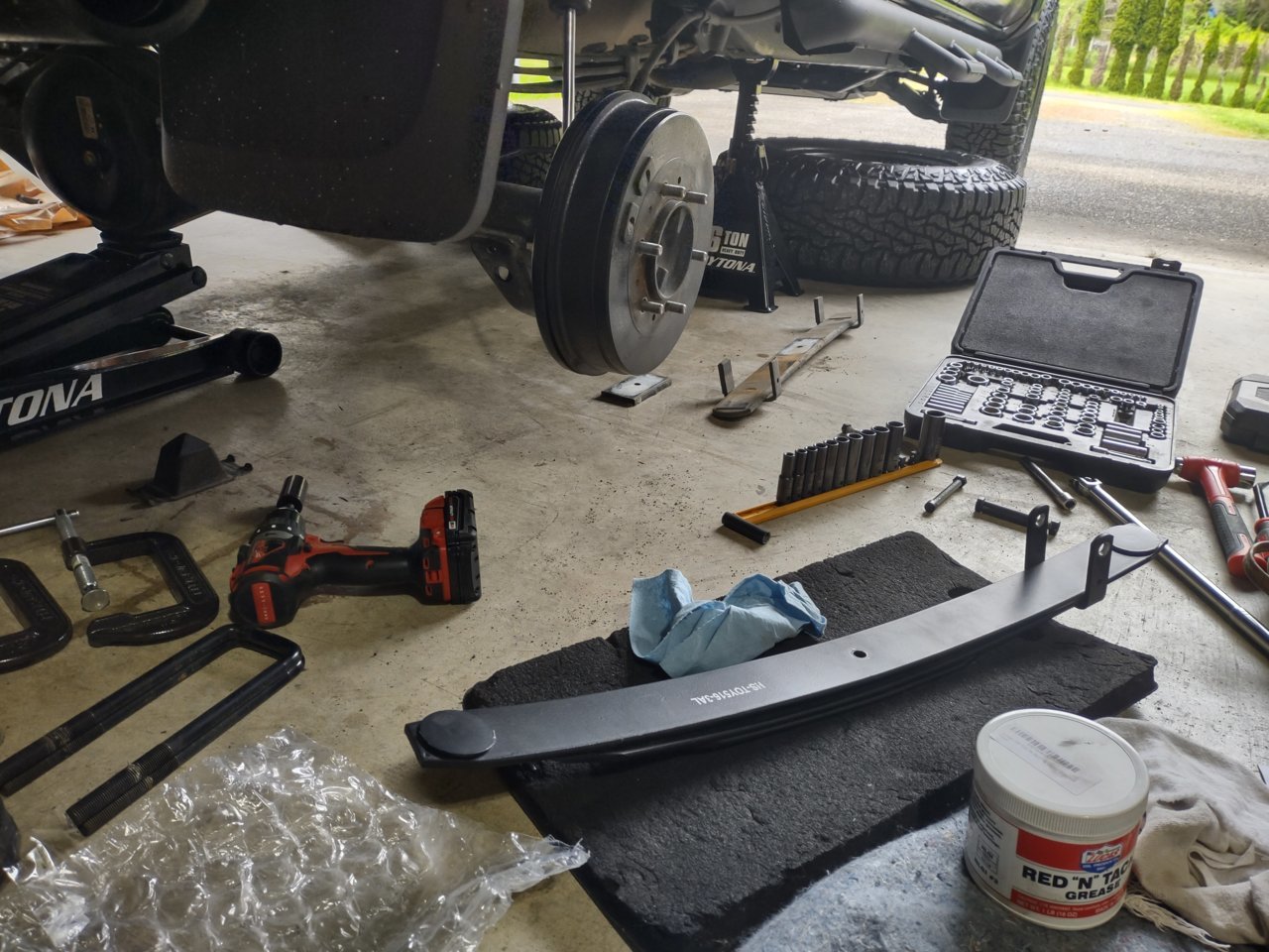

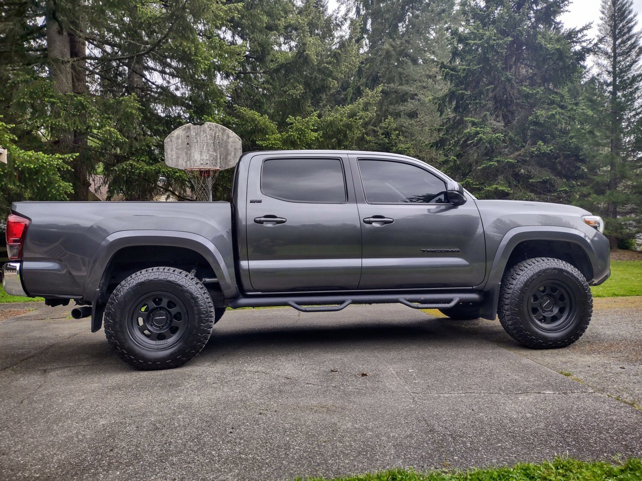

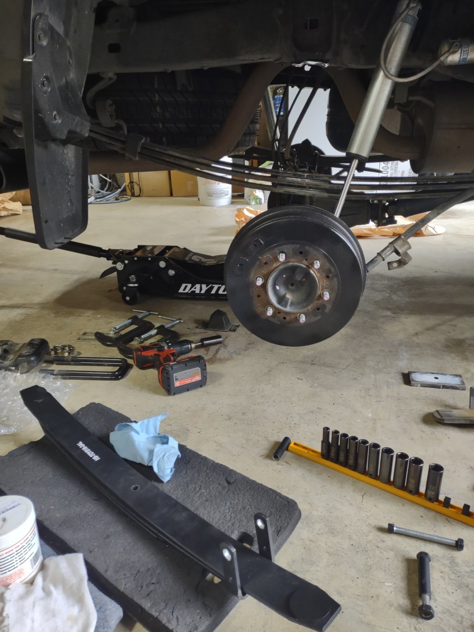

    Upgraded from 1" block to Headstrong 3 leaf AAL in the back. Thought I'd save a couple bucks and reuse the long U bolts from the 1" block kit. Big mistake. Just about snapped the bolts trying to get the nuts past the spot they torqued to with the blocks, if that makes sense. Then I almost couldn't get the nuts back off. I'll never try to reuse U bolts again. Lesson learned.
    Luckily I had a friend that was able to come pick me up, drive across town to a place that makes custom length U bolts and take me back.
    I have it how I want it now, I like the stance with a little rake. 1.5" lift front and back. Have a 1degree pinion shim installed which eliminated all my braking vibes. I'm really happy with the ride quality with the HS AAL, too.IMG_20220526_104206455.jpg IMG_20220526_104147228_HDR.jpg IMG_20220526_153633523_HDR.jpg IMG_20220526_153657111_HDR.jpg

    I have the HS AAL and couldn’t agree more about the ride quality. Nice looking rig BTW!
    Nice articulation too without the overload leafs! :thumbsup:
