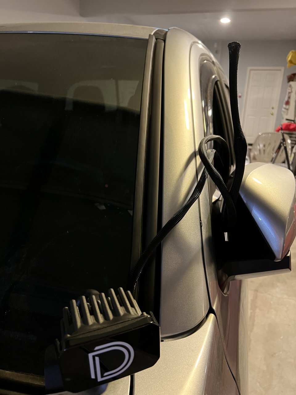

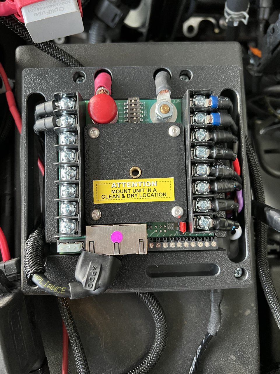

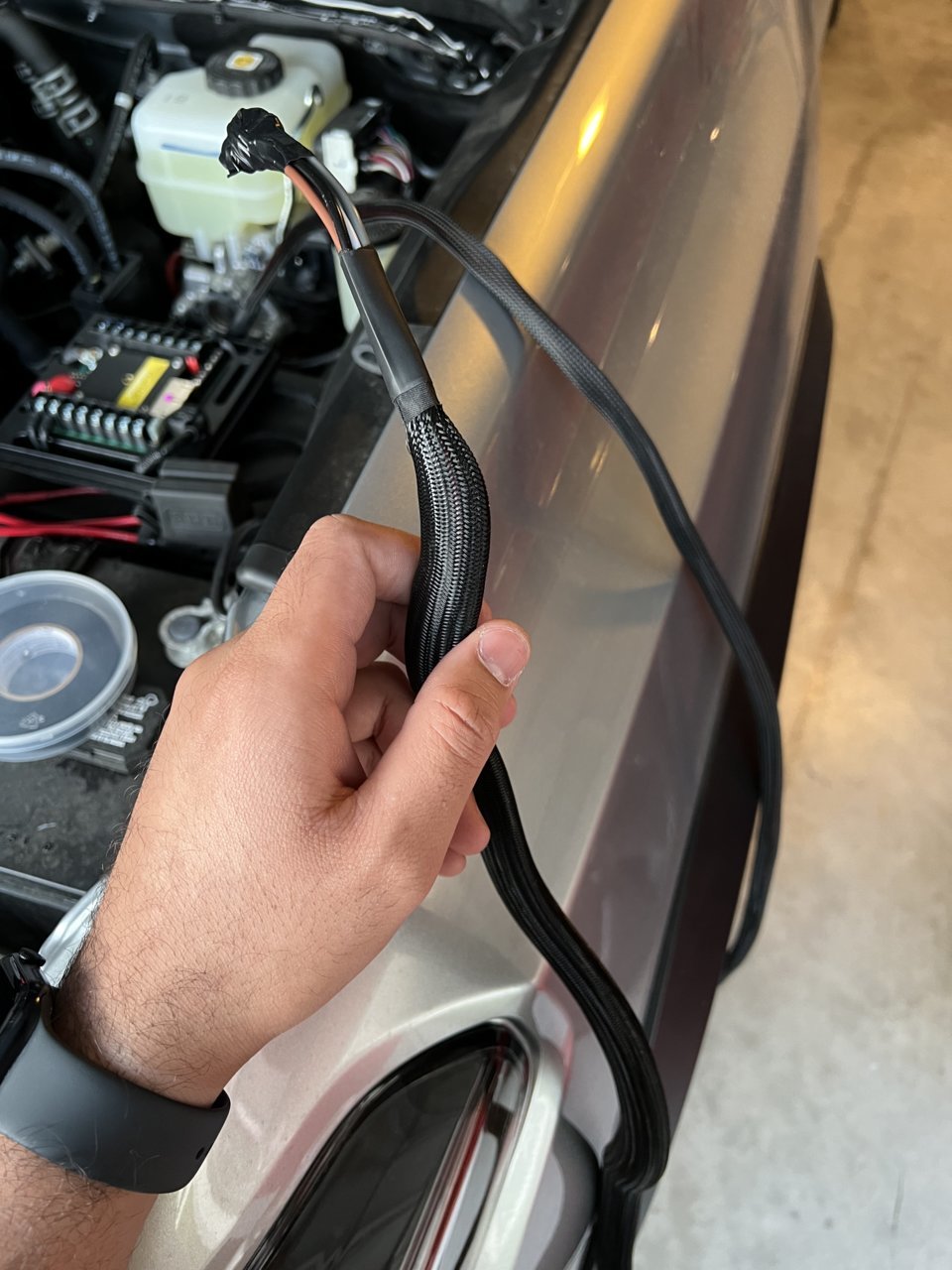

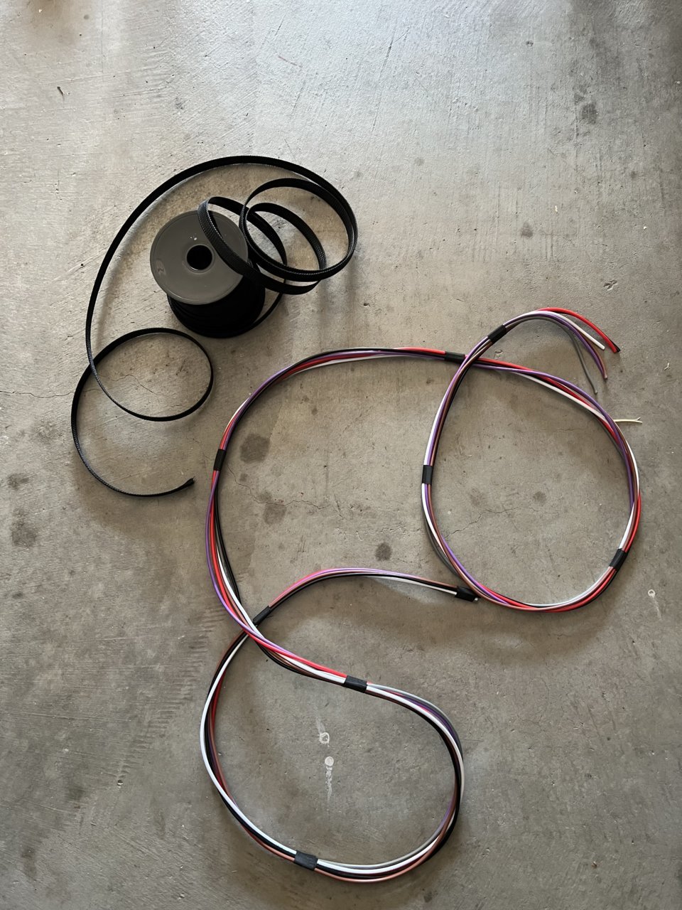

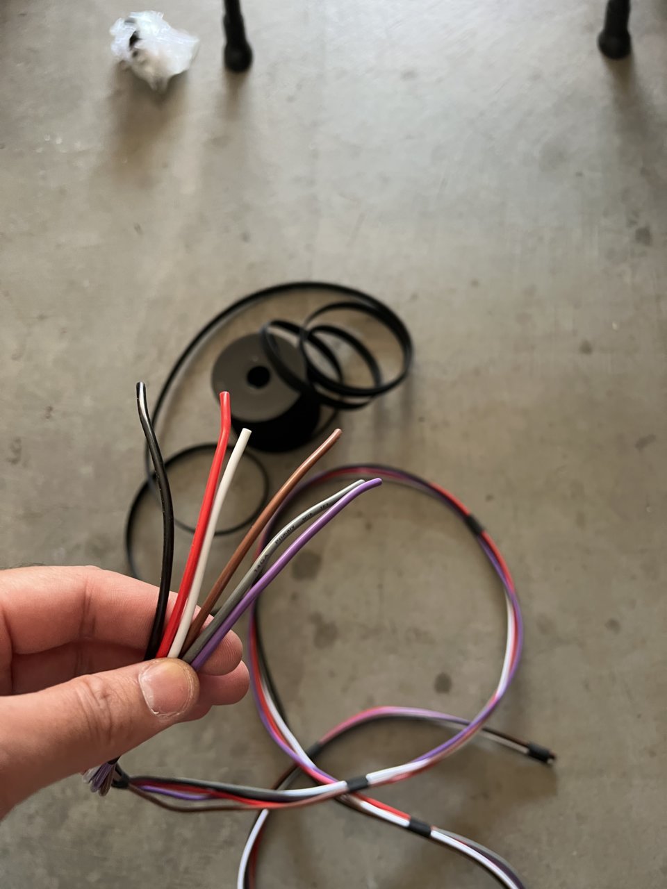

    Worked on my harness from the SPOD to my roof. Terminated it at the SPOD end, loomed it, tested it and installed the KC wire hider. I’ll cut the other end of the harness to length, run it thru the wire hider once the VHB cures and terminate it in a 6pin deutsch one of these days, but I forgot to order the crimp tool from Amazon. I’ve wired it to 3 switches on the SPOD which will control the light bar, side light pods and chase lights. Now just anxiously awaiting my roof rack to come in..

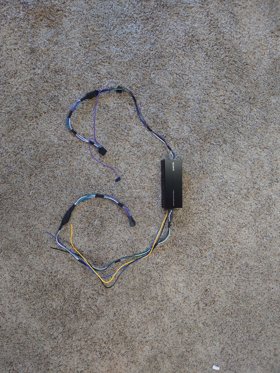

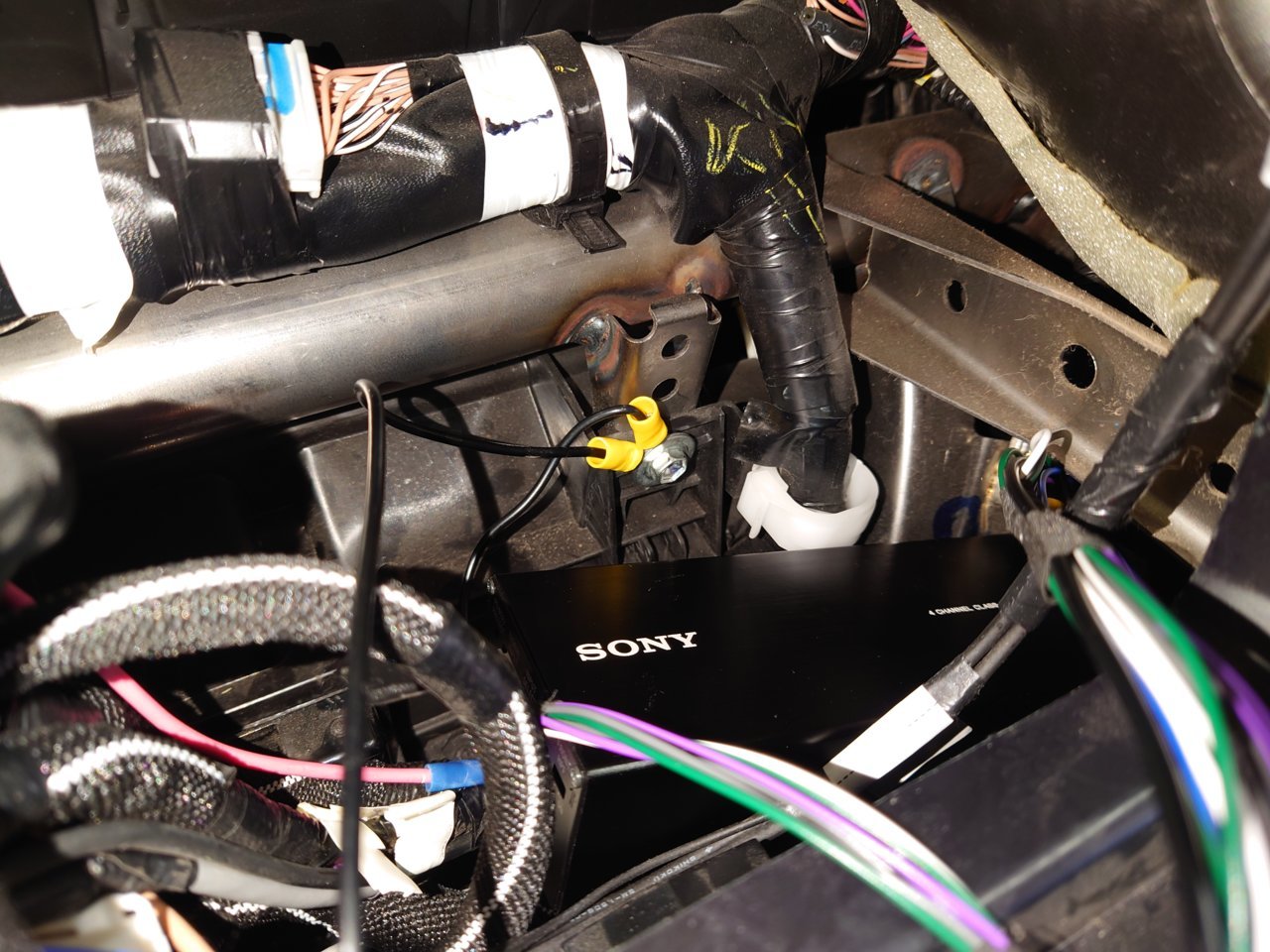

    Is your amp running all the speakers? Can you add a sub?

    Even if you bridged the 2 rear channels it wouldn't be enough power for a sub. You'd be better off adding a kicker hideaway sub and using the Sony amp for your door speakers. If you want my advice, ditch the factory radio for something better. That's my next step.
