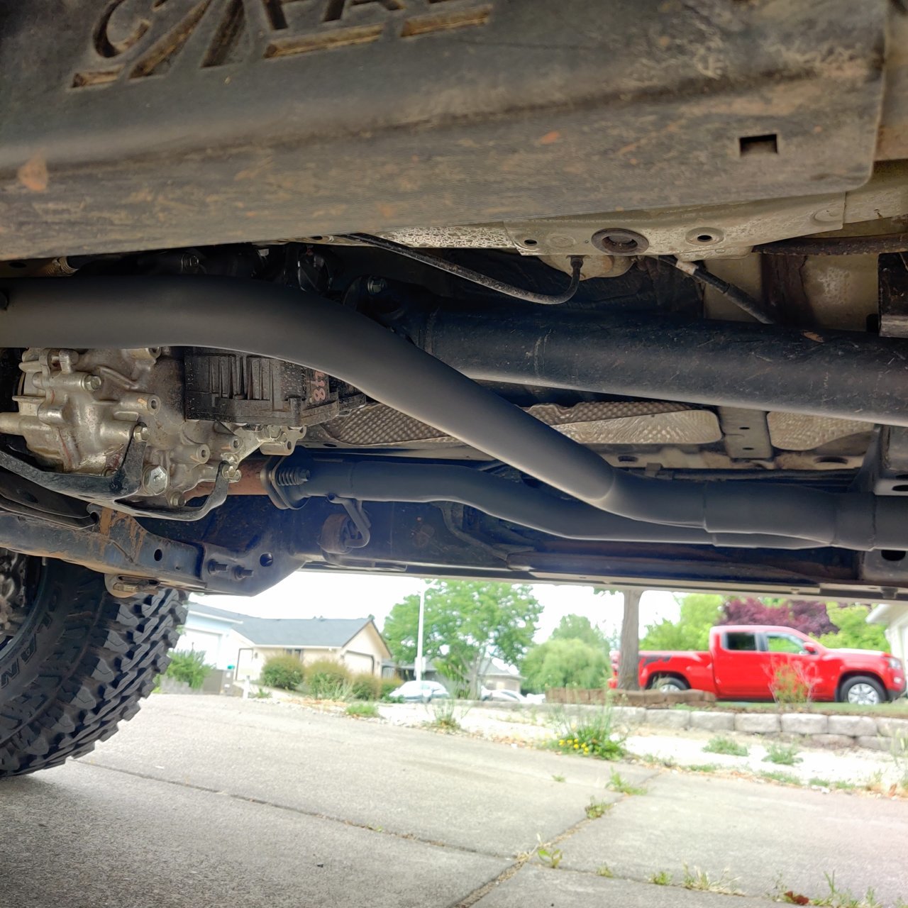

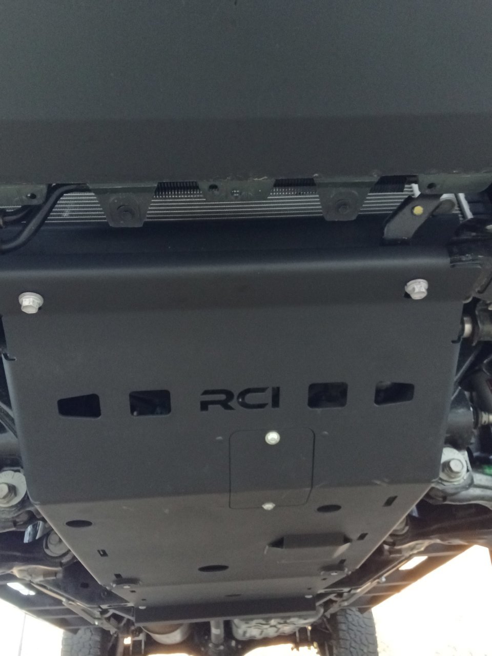

    TRD skid plate! Feeling so mainstream and trendy with this one :D nice piece for sure though.
    definitely not my favorite install. It’s not hard but it’s awkward holding that thing in place even on a jack. Thankfully I’ll only need to remove it every once in a while.

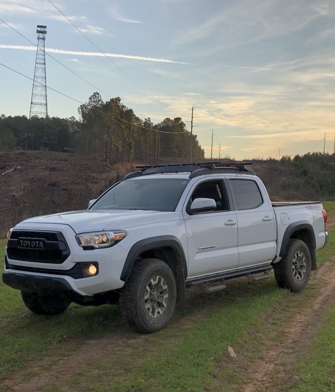

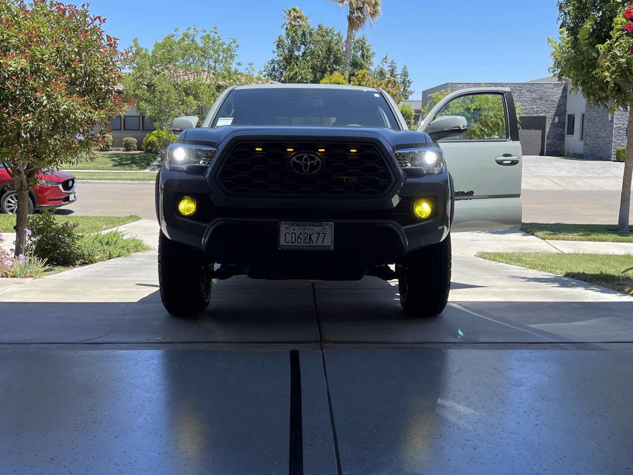

    Finally got around to installing my "silly" raptor lights. Actually, they really do serve a purpose. I wired them to come whenever the truck is running instead of just when the headlights are on. My thinking is, when my headlights are on I'm already pretty visible. I wanted something to make me more visible during the day. But, I also like the way they look! Hardest part was running the wires and making them neat. I'm a little OCD like that. Getting the red power wire into the fuse box through that little opening took some time. Also installed amber LED fog lights and made myself the "TACO" sticker.

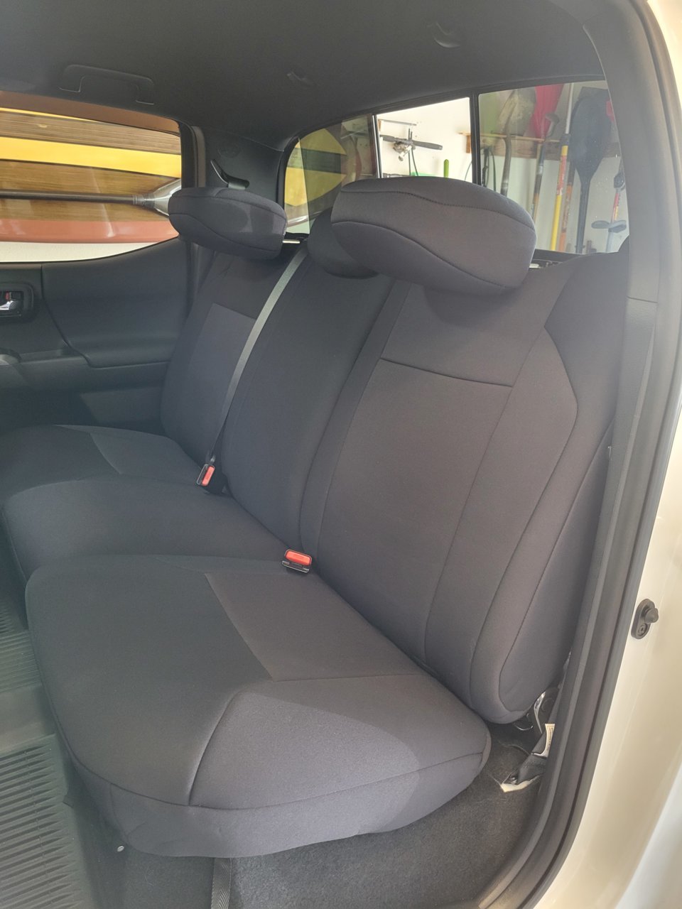

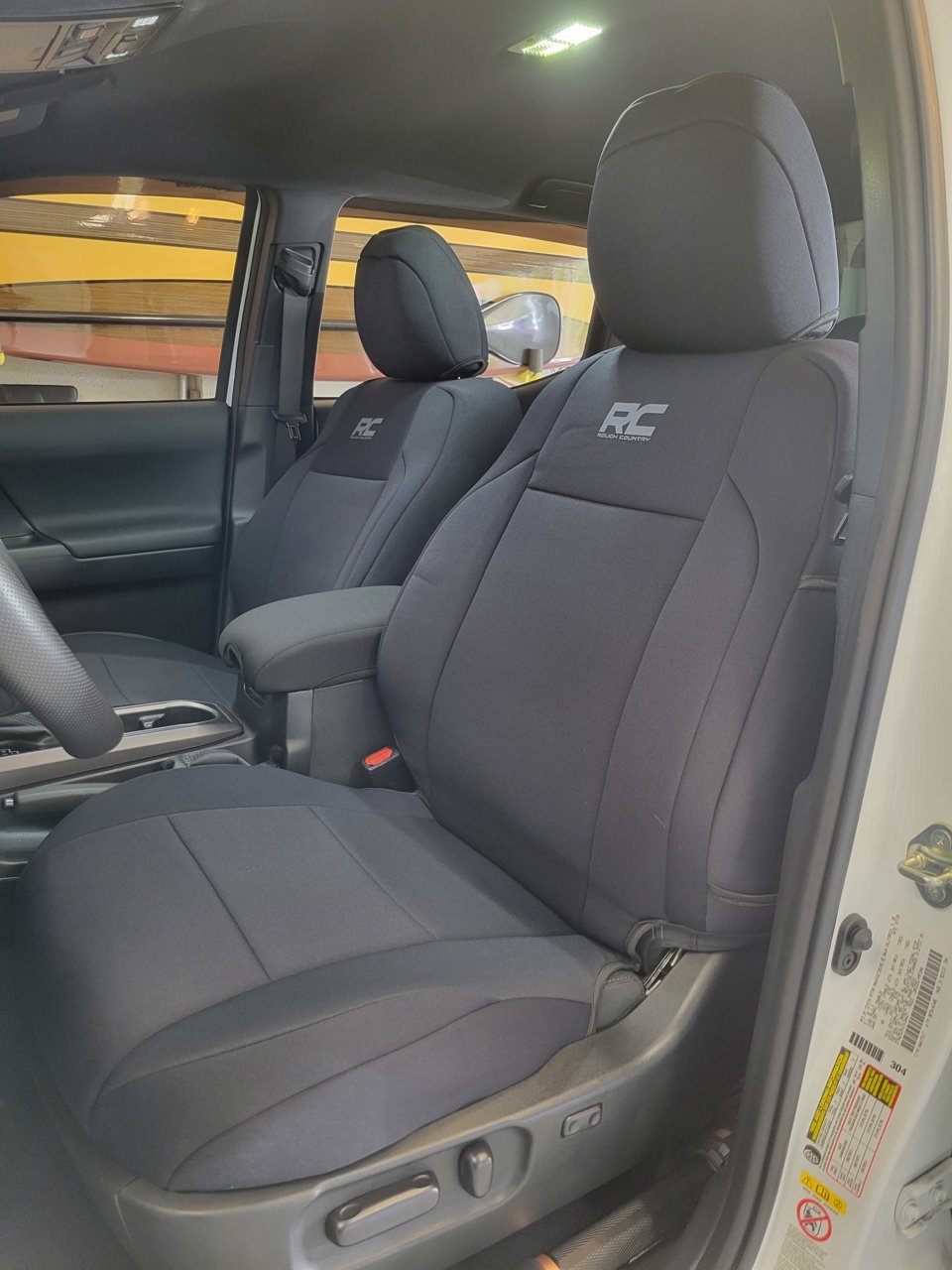

    Cashed in a few old Amazon gift cards...
    Rough Country Seat Covers and generic armrest cover.
    This was NOT as easy an install as expected. To make it easier, I did unbolt the seats but left in the cab.
    About 1.5 hrs to install.

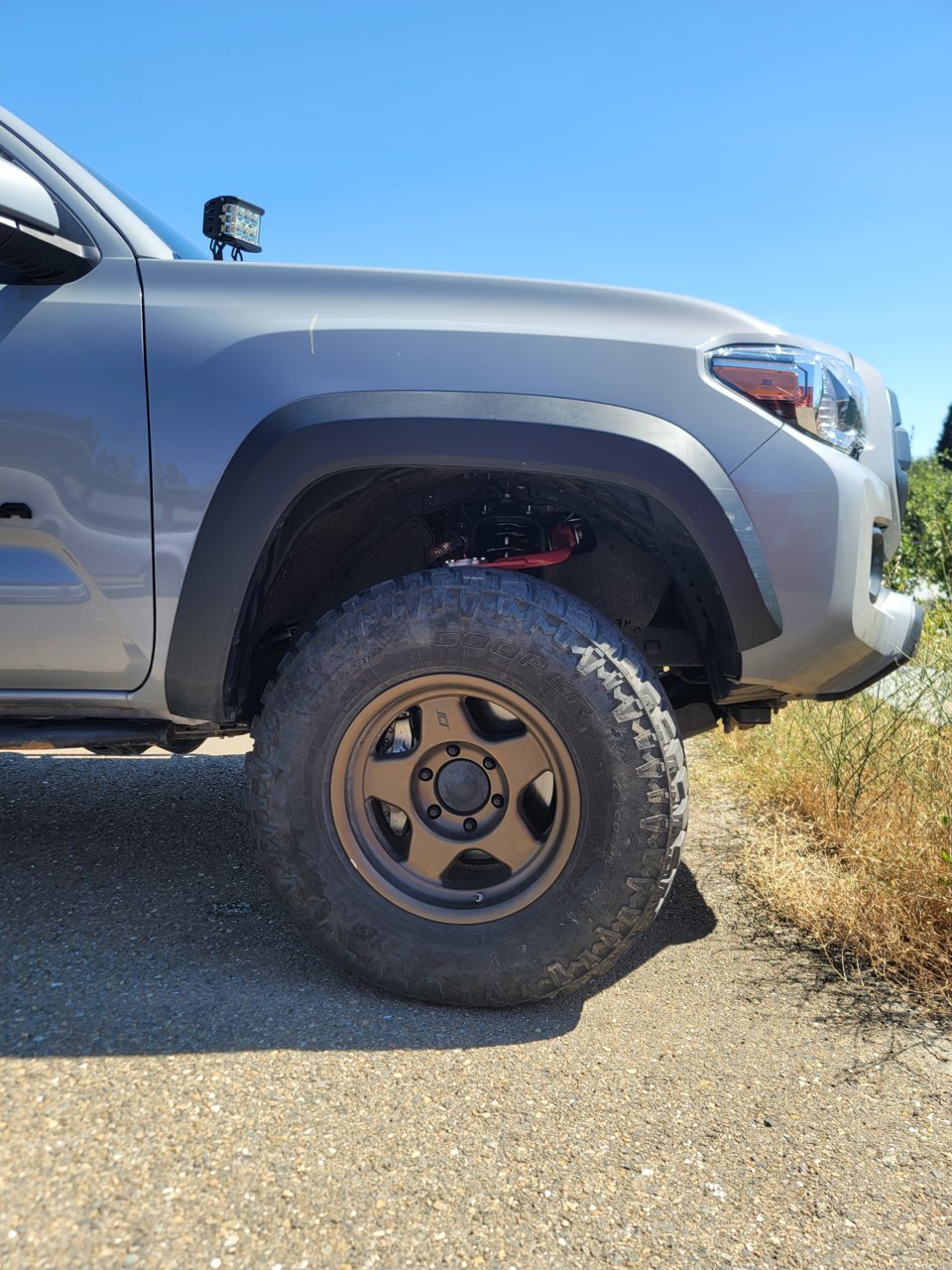

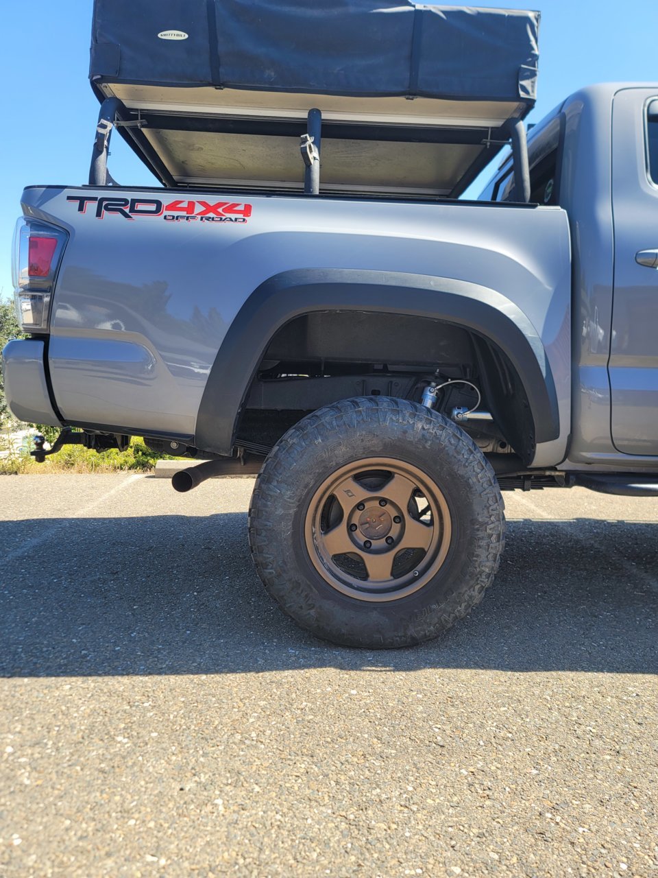

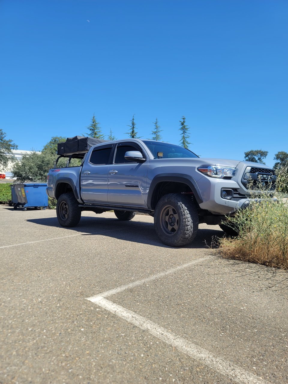

    SPC UCAs, OME 2in (Heavy Duty) Suspension Lift, and an alignment.
    Before
    Driver Front 35" Passenger Front 35 1/2"
    Driver Rear 35 1/4" Passenger Rear 35 7/8"
    After
    Driver Front 38" Passenger Front 38 1/2"
    Driver Rear 38" Passenger Rear 38 1/2"
    Before
    Rear Suspension Upgraded, Front Stock (crazy rake)
    After (front and rear upgraded) - pre alignment so caster is off and camber is a bit out of whack.
    Next month I'm going to throw some 33s on it. Trying to decide if I go with Falken Wildpeak pizza cutters in 255-80-17 or 285-70-17 KO2s to match my trailer. Leaning toward the 285s.

    What did you tie the raptor lights into? I'd like mine to come on when I use the remote start during the winter. I don't think anything comes on(including headlights) until you get in and use the start button.

    Love the Leitner :thumbsup:

    Lookin' Good!
    I'm thinking about getting seat covers for my Sport. My wife's 2017 Elantra will need them first.

    See the pictures for the location. I just tried the remote start and the raptor lights do come on. This one only comes on when the truck is running. So, the raptor lights are always on.74C4D193-32AB-44FF-9635-AD5C0B78070A.jpg

    Is this the only location for the 10amp?
    What if I only want it when the headlights come on?

    No. You can tap into the headlights so they only come on with the headlights if you want. That one is also a 10a. It’s the lower left one. The one I circled in red.033246D3-B570-464D-9B64-A2F1443C1FD0.jpg
