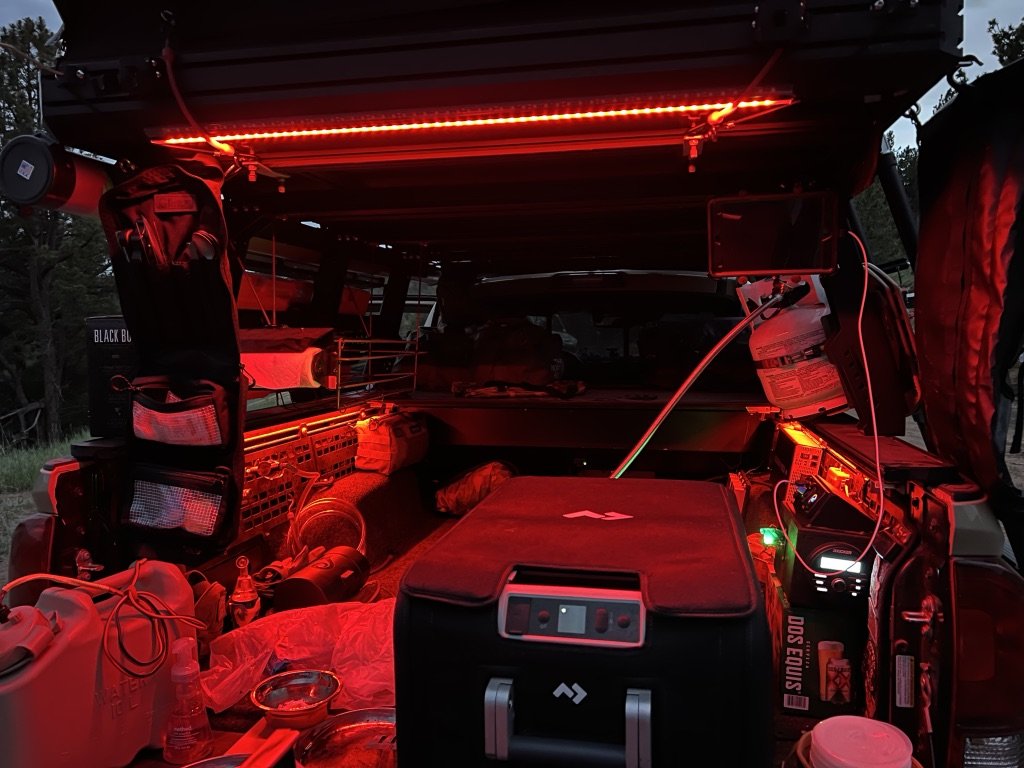

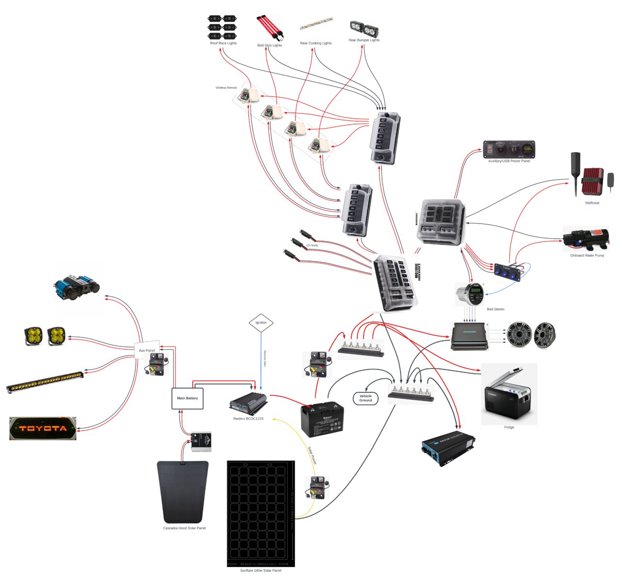

    I redid my auxiliary power setup with a new larger solar panel, relocated and replaced the old second battery from an AGM under the hood to a new LiFePo4 battery to the bed. Added the last bit of electronics that had been on the TODO list for awhile. All LEDs are on 4 wireless relay boxes, and can be controlled by 4 buttons on a single remote/fob. Everything is working great and with the new bluetooth unit on the battery, I can see all the charge data with the Renogy DC Home app.
    Parts list:
    SolidRemote wireless relays
    https://www.amazon.com/dp/B01JGDV8UM
    LED strips
    https://www.amazon.com/dp/B07MXXDWDM
    https://www.amazon.com/dp/B07MXY16HZ
    Baja S2 white lights x2 (rear bumper)
    https://www.amazon.com/gp/product/B07MF9SG6V?ie=UTF8
    Baja rock lights x6 (roof rack)
    https://www.amazon.com/Baja-Designs-39-98049-Rock-Light/dp/B073V7KMZL
    Blue Sea Systems Panel Mount Circuit breakers
    https://www.amazon.com/dp/B0051P01BW
    Blue Sea Bus Bars x2
    https://www.amazon.com/dp/B07BS1L8LG
    Mictuning 6-Way fuse block x2
    https://www.amazon.com/MICTUNING-6-Way-Holder-Vehicle-Marine/dp/B07VYWM9XC
    Mictuning 6-Way fuse block w/ status LED
    https://www.amazon.com/dp/B08QRZDM7B
    Mictuning 12-Way fuse block w/ status LED
    https://www.amazon.com/MICTUNING-Way-Fuse-Box-Holder/dp/B07W11R366
    Switches
    https://www.amazon.com/dp/B08MYMXP5G
    https://www.amazon.com/dp/B08MYLVZFK
    https://www.amazon.com/dp/B08MYQ8M73
    Switch panel
    https://www.amazon.com/dp/B09X9GMM3L
    Blue Sea USB/12v panel
    https://www.amazon.com/gp/product/B07PP1V3L5?ie=UTF8
    Seaflow Onboard Water pump (rear left cubby)
    https://www.amazon.com/Seaflo-Diaphragm-Pressure-Caravan-Marine/dp/B00DLKT4OO
    Kicker 2 channel marine amp:
    https://www.amazon.com/gp/product/B0794CFZCK?ie=UTF8
    Kicker 6.5" 3 way marine speakers
    https://www.amazon.com/gp/product/B07BNXLKT6?ie=UTF8
    Kicker marine media head unit
    https://www.amazon.com/gp/product/B08668VXDM?ie=UTF8
    Renogy Smart 100ah LiFePo battery w/ self heating:
    https://www.amazon.com/dp/B08XV9BQL6
    Renogy BT-2 dongle for battery app connectivity:
    https://www.amazon.com/dp/B0899932YC
    Renogy 1000w Sine inverter:
    https://www.amazon.com/dp/B07VC5RTK7?ref=ppx_yo2ov_dt_b_product_details&th=1
    Sunflare 180w Xplor series solar panel (on top of the RTT):
    https://www.sunflarexplor.com/xplor-series
    RedArc BCDC1225 DC/DC Charge controller
    https://www.amazon.com/REDARC-BCDC1225D-Dc-Dc-Charger-12V25a/dp/B077JPHCRV
    Cascadia 4x4 Hood mounted solar panel
    https://www.cascadia4x4.com/collections/vss-system-hood-mounted-solar
    Victron 75/15 Charge controller
    https://www.amazon.com/Victron-SmartSolar-Charge-Controller-Bluetooth/dp/B075NQQRPD
    12 volt SAE plugs
    https://www.amazon.com/dp/B07XLK4CH3
    Junction box for the SAE plugs
    https://www.amazon.com/dp/B07WS4X1ZQ
    Power Studs that go inside the junction box (epoxy to the bottom)
    https://www.amazon.com/dp/B07HXYZ1WZ
    Dometic CFX 35
    https://www.amazon.com/Dometic-CFX3-35-Powered-Cooler-36L/dp/B085MM9B2D
    WeBoost OTR 2nd gen:
    https://www.amazon.com/weBoost-477154-Booster-Networks-Carriers/dp/B08WYQND57
    Rhino Rack rack mounted antenna pivot mount
    https://www.amazon.com/dp/B07B66Q59S
    These all run off the main battery w/ relay aux panel and switches in the dash:
    ARB Twin under the hood
    https://www.amazon.com/dp/B0050DI9YQ
    https://rogue-offroad.com/GTFO-Expe...le-Compressor-Bracket-2016-Tacoma_p_9141.html
    Baja Squadron ditch lights
    https://www.amazon.com/gp/product/B073V6Q8DY?ie=UTF8
    Baja S8 30" light bar
    https://www.amazon.com/gp/product/B07M6L8LJ6?ie=UTF8
    DBCustomz Grill w/ LED
    https://dbcustomz.com/

    This made my OCD VERY happy.

    Outstanding work. I've been looking to go from AGM to a LiFePo4 as well, but didn't want to mount it under the hood. your setup looks ideal. Any more info on the components you used, or a more detailed writeup anywhere? That battery is much smaller than I would have expected. I can see some of the component model numbers in your illustration, but not all of them. Mostly interested in which battery and solar panel you used.

    holy electrical batman! This is terrifying to me! I wish i had that skill with electronics/wiring
