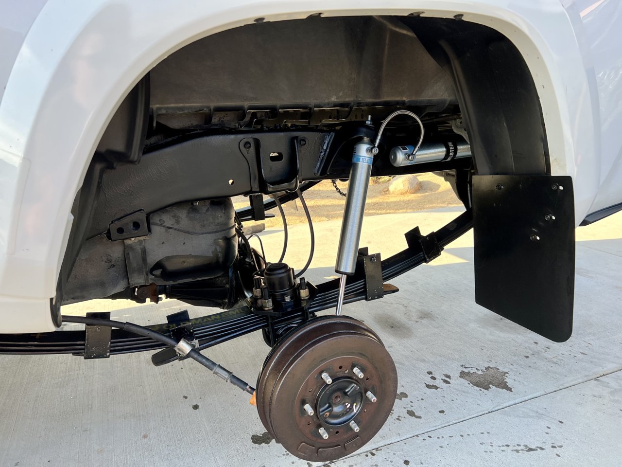

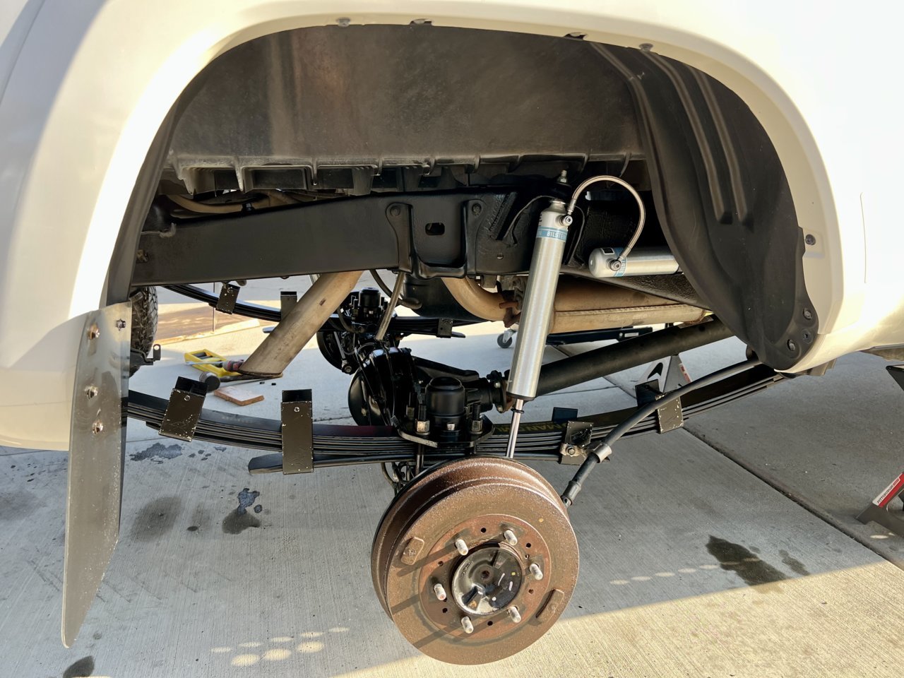

    Pic angles are deceiving. The u-bolts come just shy of half of the bump stop. I don’t want to trim any yet because the medium leaf may go back in shortly. But I did lift each side to stuff the tire until the bump stop hit and the other sides tire come off the ground with a forklift. Even gave it a couple bounces for good measure to make sure there was no contact.

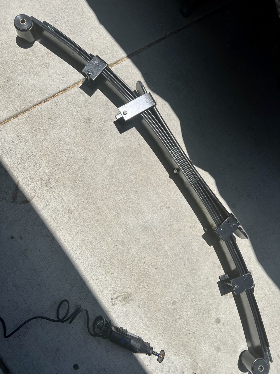

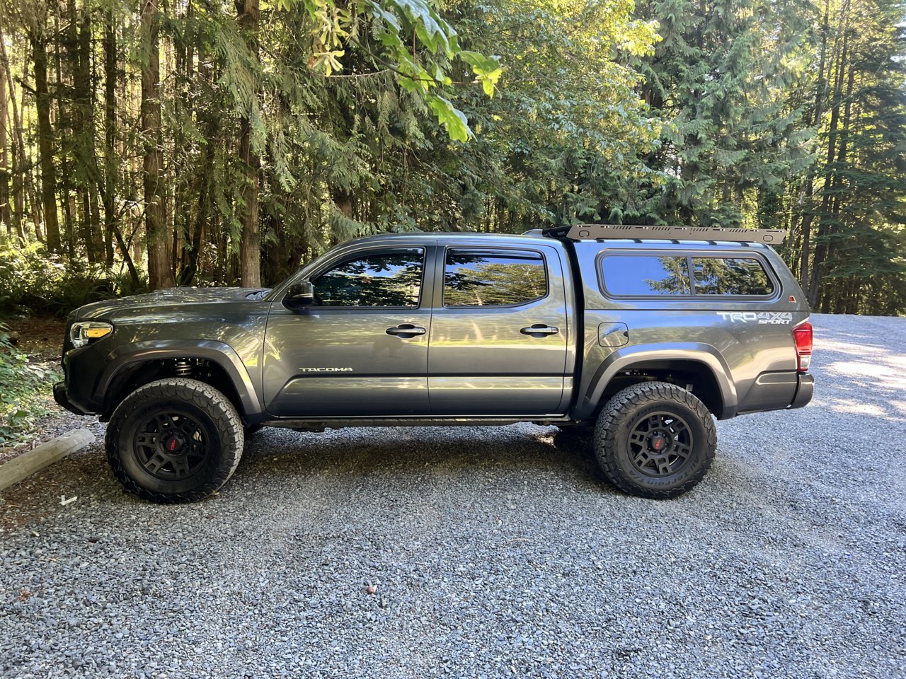

    Upgraded to option 2 on the rxt’s and went with 285/70/17 ko2’s. 6D0BC38C-7C30-4662-B206-FEAAE9DA289B.jpg

    That's an okay test for flex, but the Superbumps squish up flat as a pancake when properly compressed. If you hit something big enough to impact them you're going to be feeling those bolts and you're not going to have a good time, but hopefully they will work for now. When you do settle on a height, trim them about 1/4" above the nut, or about equal with the thick part at the base of the bump stop. :thumbsup:
    EDIT: Like this is what you're going for to avoid metal-on-metal contact.

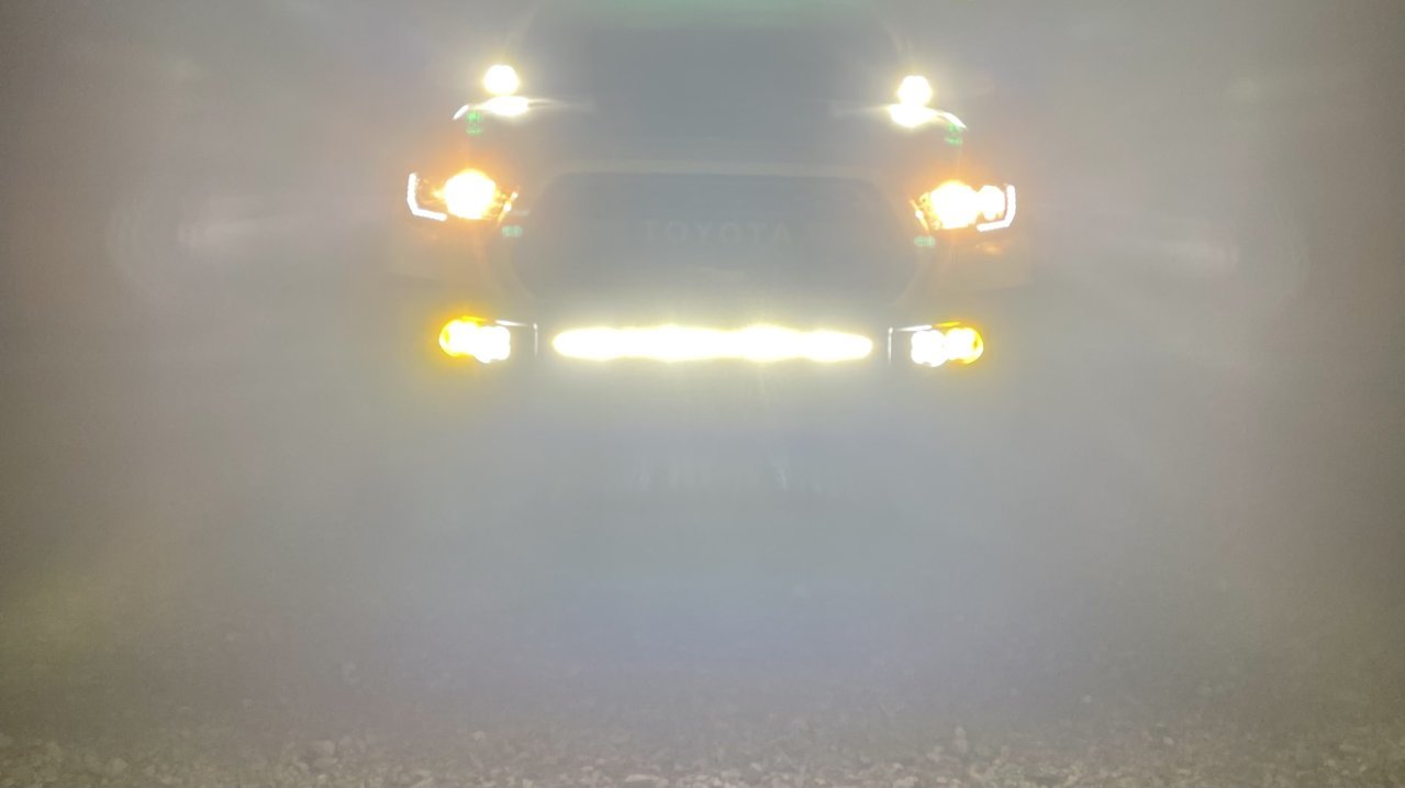

    Got everything wired up and running around 1AM last night. I can’t even see the truck from the front , in person. The DD lighting is Alien abduction bright. :alien::alien::alien::alien::alien::alien::alien::eek:

    This looks awesome! What suspension kit are you running?

    eibach 2.0 coilovers for about 1.5” lift up front with icon rxt leaf pack option 2 in back.

    Yep! That’s what I did when I was first running it with the HD Dakar. Not wheeling it until I decide for sure if I need that leaf or not. This was the full pack with trimmed bolts.
