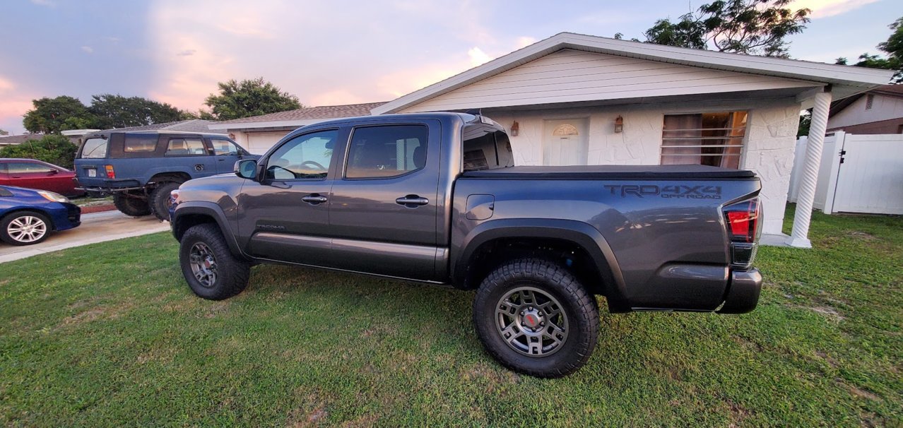

    Swapped out my bed side decal for one in matte black. Getting the adhesive off from the original decal is a giant pain in the ass.

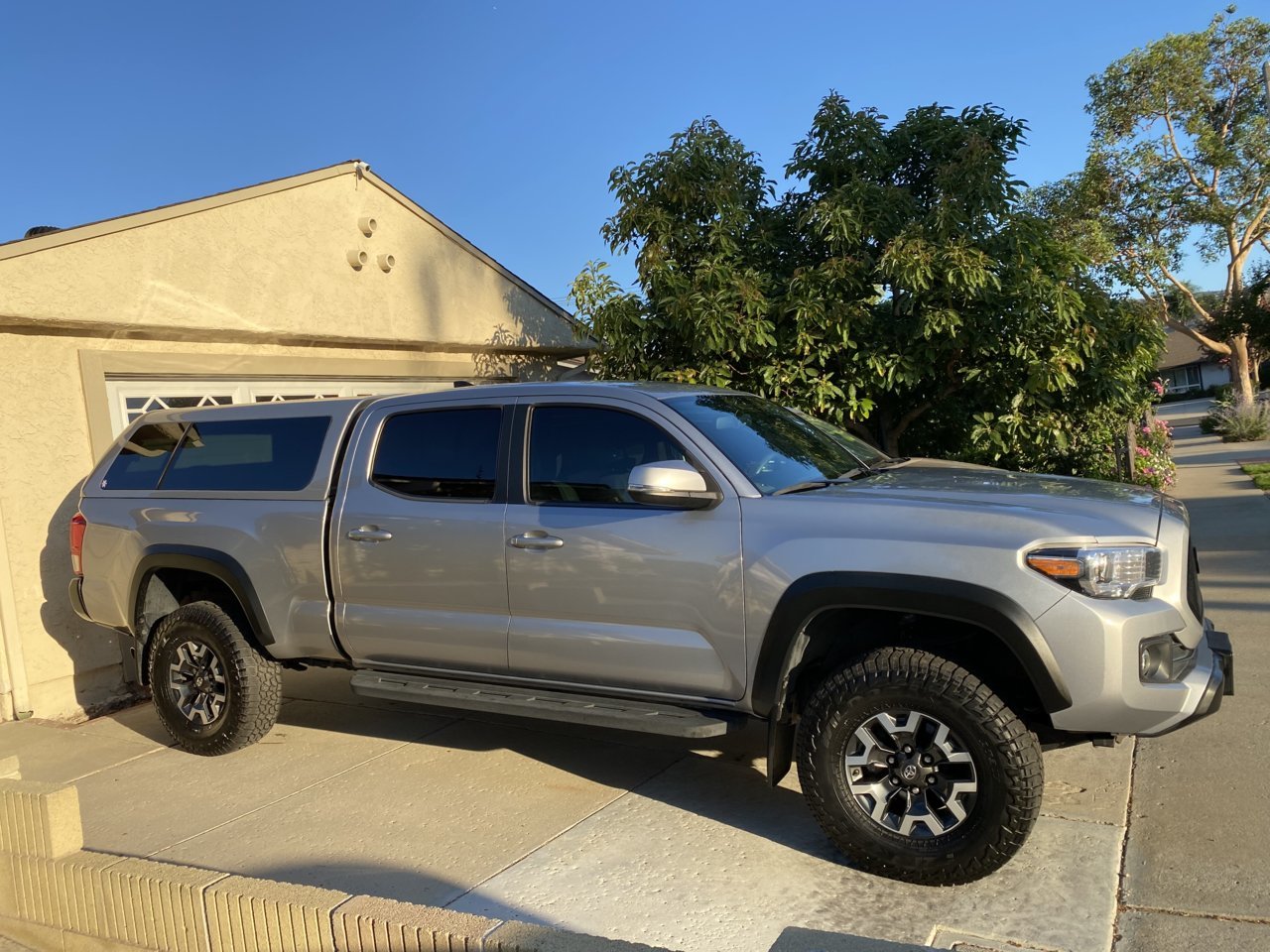

    Just beware those emblems will burn into your paint if you live in the sun

    What. What. What burns into your pain? I want to do this mod but I need some clarity on this, I live in Florida, am I at risk?

    it’s like when women put a heart sticker on and go into the tanning booth. The underneath of those stickers will show up for years after you take them off

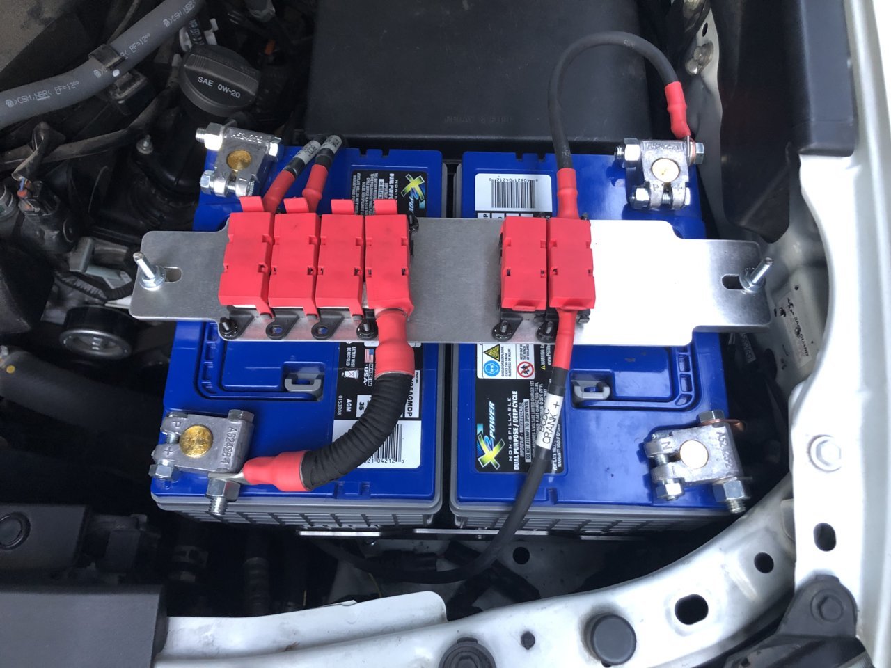

    Finished my custom dual battery setup. The battery tray is from Slee — it has a side support bracket to help distribute the weight of the two batteries. From what I understand it’s a cure for the cracking that happens there.
    Outside of the tray everything is fully custom. The setup utilizes an over-the-tie-down bracket for modular Bussmann fuse holders. They are rated up to 400A each! It’s a very clean solution for higher-amperage distribution since you can get bussbars for them and just utilize a single feeder cable on both batteries.

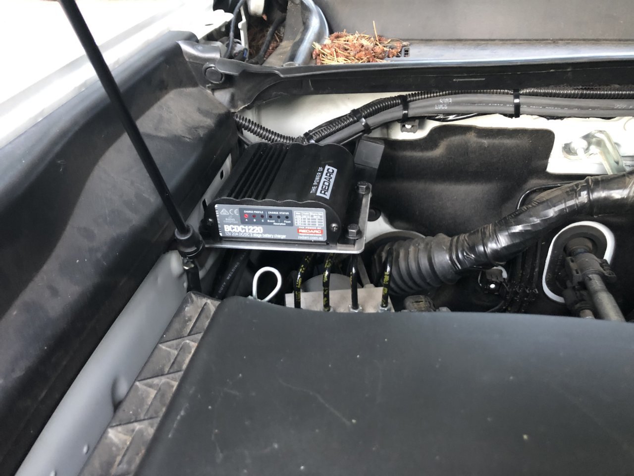

    The brains of the operation is a RedArc BCDC 1220. I mounted it on the passenger side utilizing some un-used threaded holes.
    Project took a couple of days, but I was crimping each cable myself and taking my time to make sure I didn’t blow myself up. Glad to have that done.

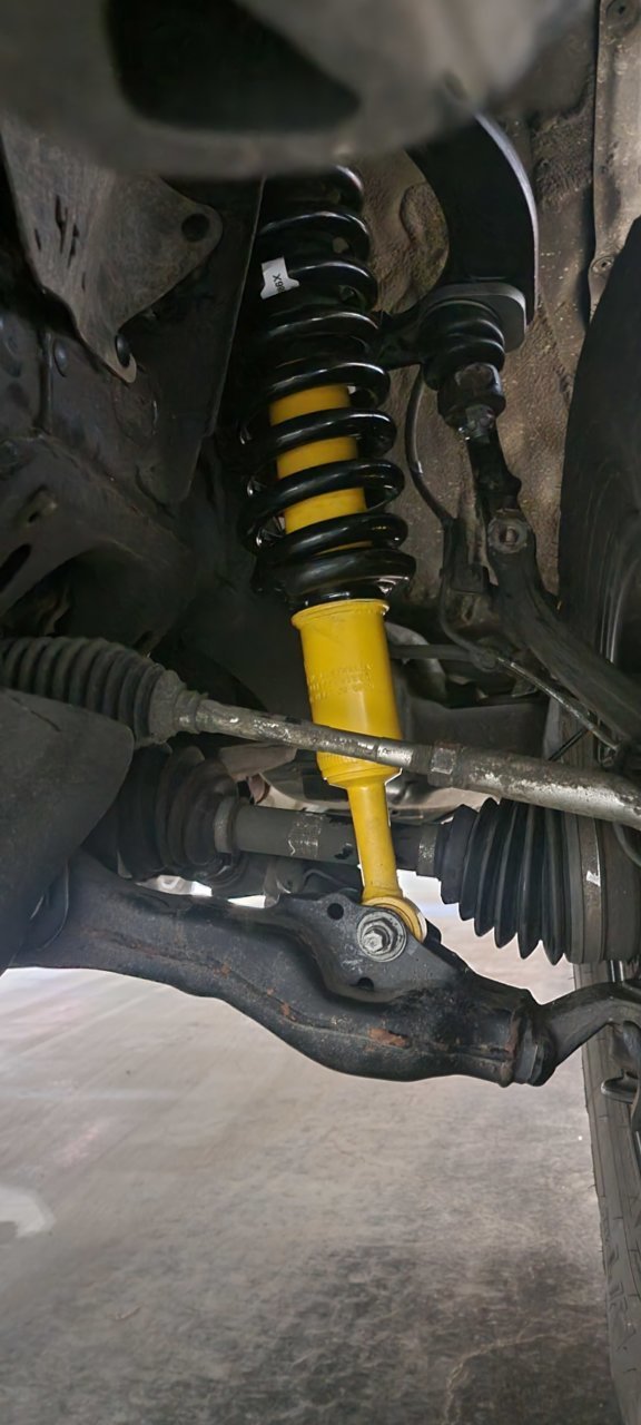

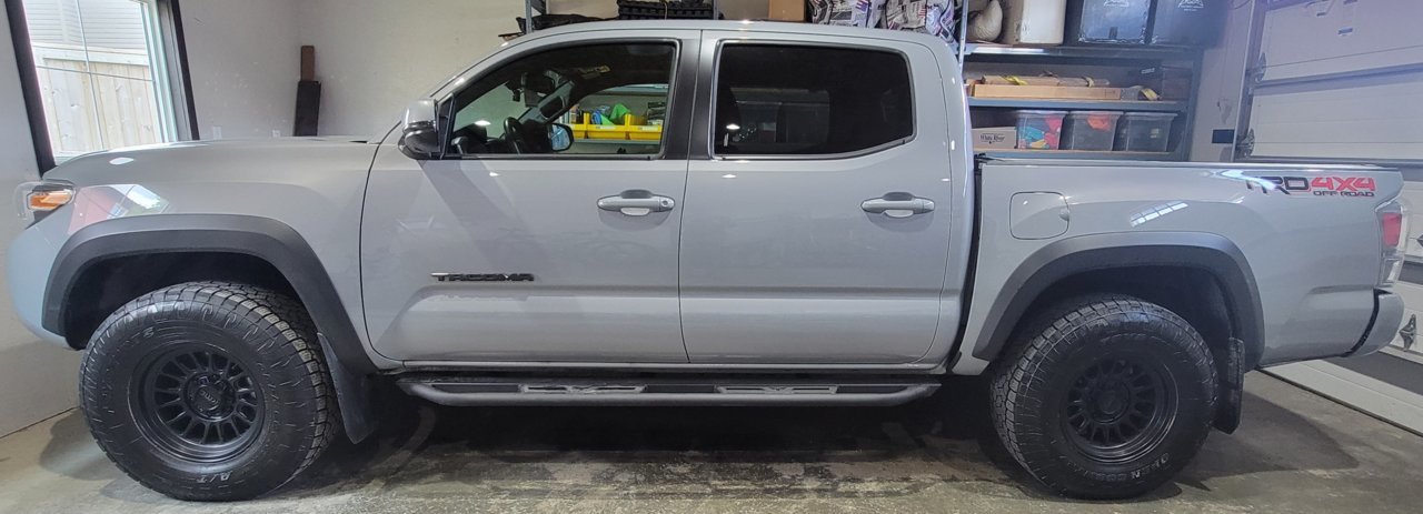

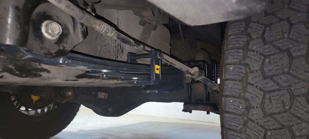

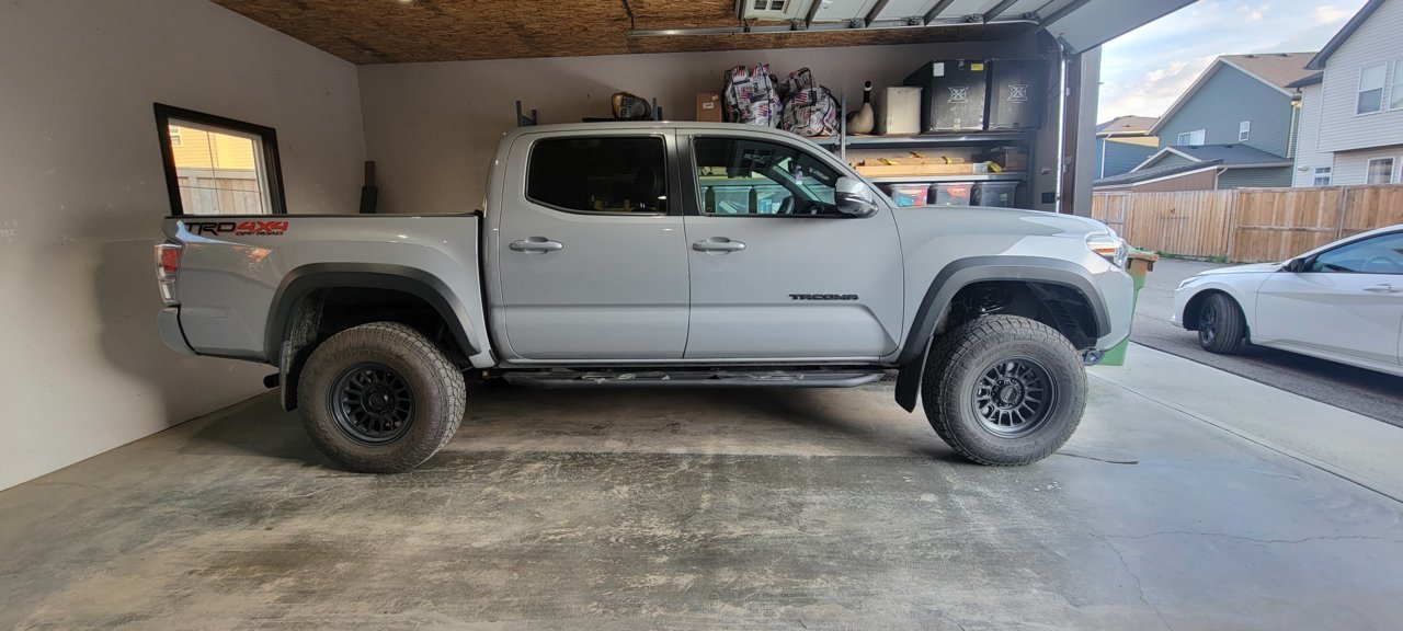

    OME EK2301B1 lift kit
    Before
    After
    Rides better than stock imo. Was nervous about going 886 with no armor in front but it really feels more stable now

    Haha :) so you're suggesting I get the original off quickly so it doesn't leave a mark?

    Do I see a little interference between brake cable and leaf spring?

    I’m actually curious about that. I wonder if long-term it could leave a big rectangle. I’m definitely all-for the removing badges movement, but I was sad when I put on my secondary badges and saw they left a mark years later when they needed to be peeled off.

    Yikes, your right. Might try to move that a bit.
