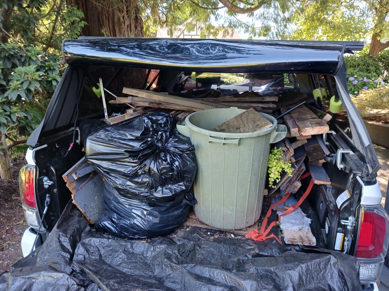

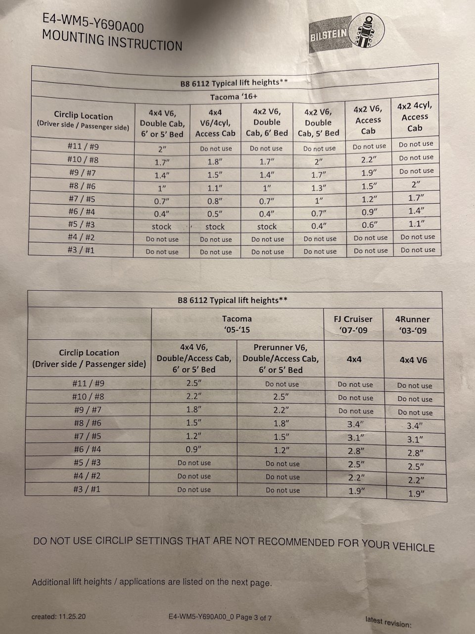

    Swapped out the front OME coilovers with Bilstein 6112’s. Was sitting pretty “Bro” when I first dropped it but whipping around hitting all the bumps and potholes it settled nicely!

    Those 6112s look different. Are they new models? What settings do all those ring clips give?

    They’re the new 11 position, same overall height just more adjustment.
