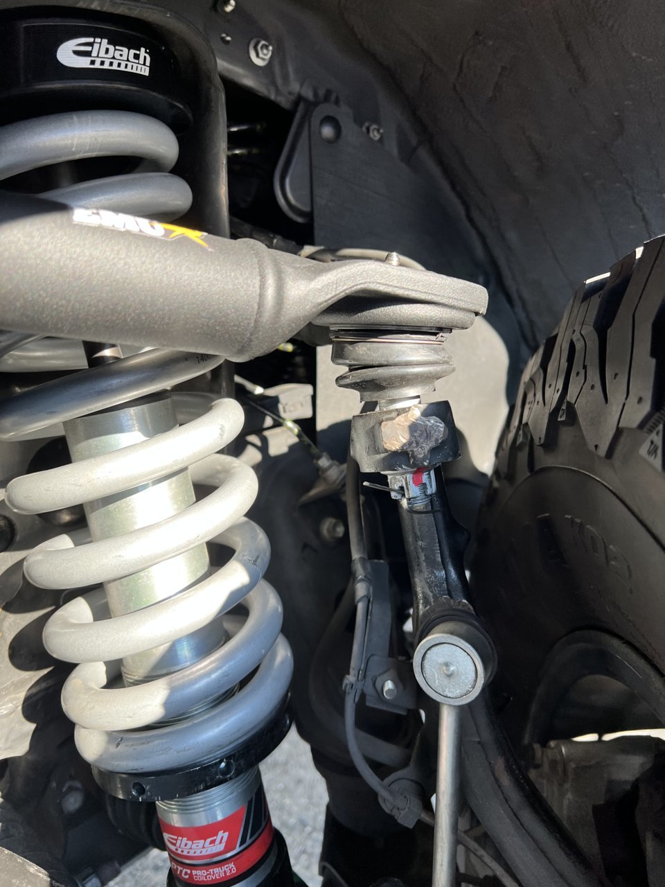

    Just had some uca’s installed. Noticed the drivers side boot on the ball joint isn’t flush with the spindle. Is that normal? Everything is tightBA3FCAA3-E3B7-4C5C-AFD5-357F3F1033D6.jpg

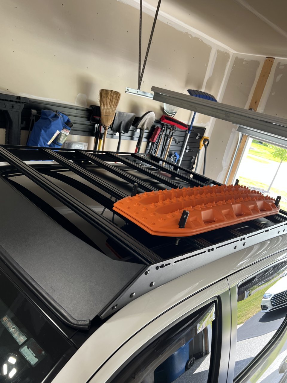

    yes. I just used the prinsu maxtrax mounts on mine. Fit was perfect.

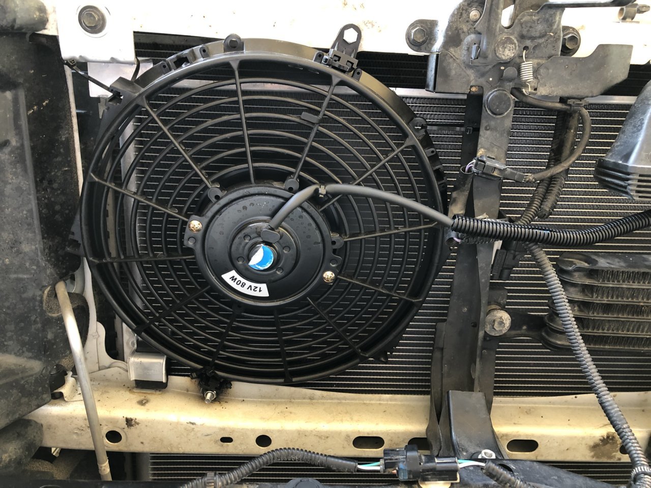

    Here’s a better link to it but yes:
    https://static.nhtsa.gov/odi/tsbs/2019/MC-10166026-9999.pdf
    Installed it myself and hooking the fan up to a manual switch saved letting Toyota tear apart my dash as described in that TSB. I used one of these- bought 2 but the 12” fans only fit on the left side of the condenser- saving the second one for a spare or for our RV. I suppose the 10” fans would fit tighter, but 1 12” fan works very well:
    MOSTPLUS Black Universal Electric Radiator Slim Fan Push/Pull 12V + Mounting Kit (12 Inch) Set of 2 https://www.amazon.com/dp/B077YD2Z9Q

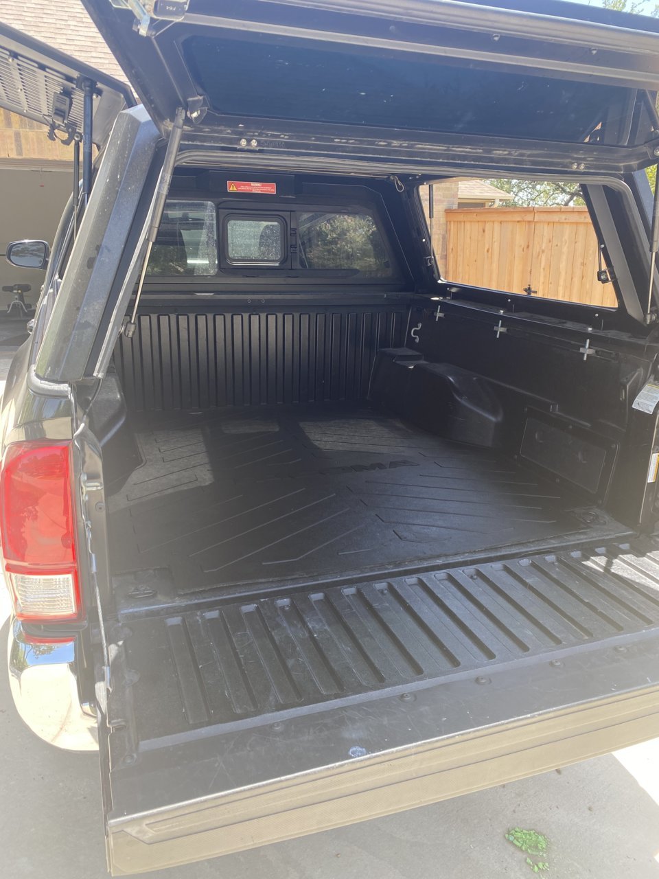

    Got a bed mat.

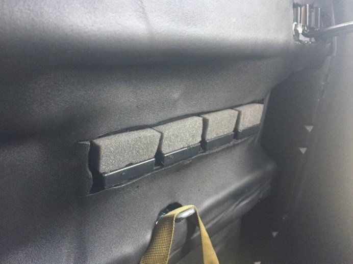

    I put foam in my vents when I removed the jump seats, added soundproofing, and put the utility panel in. The foam cut the decibels down more than the soundproofing.
    Pictures and idea stolen from @jerzsubbie : https://www.tacomaworld.com/threads...ots-of-pics-links.533421/page-5#post-19791252
    You can also stuff a pool noodle up between the bed and the cab. I didn't do a decibel meter check after stuffing, but it seems quieter and the noodle was all of 2 bucks. I bought an orange one.
