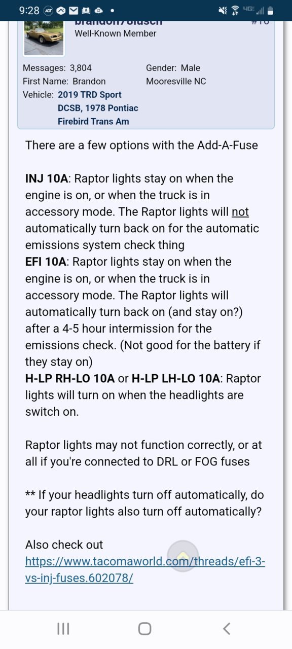

    Screenshot_20220720-212846_Chrome.jpgtry another fuse. I did the same thing with me. The first fuse location caused that issue for me. Try the other two . Also don't forget to add a fuse to your tie in line as well.

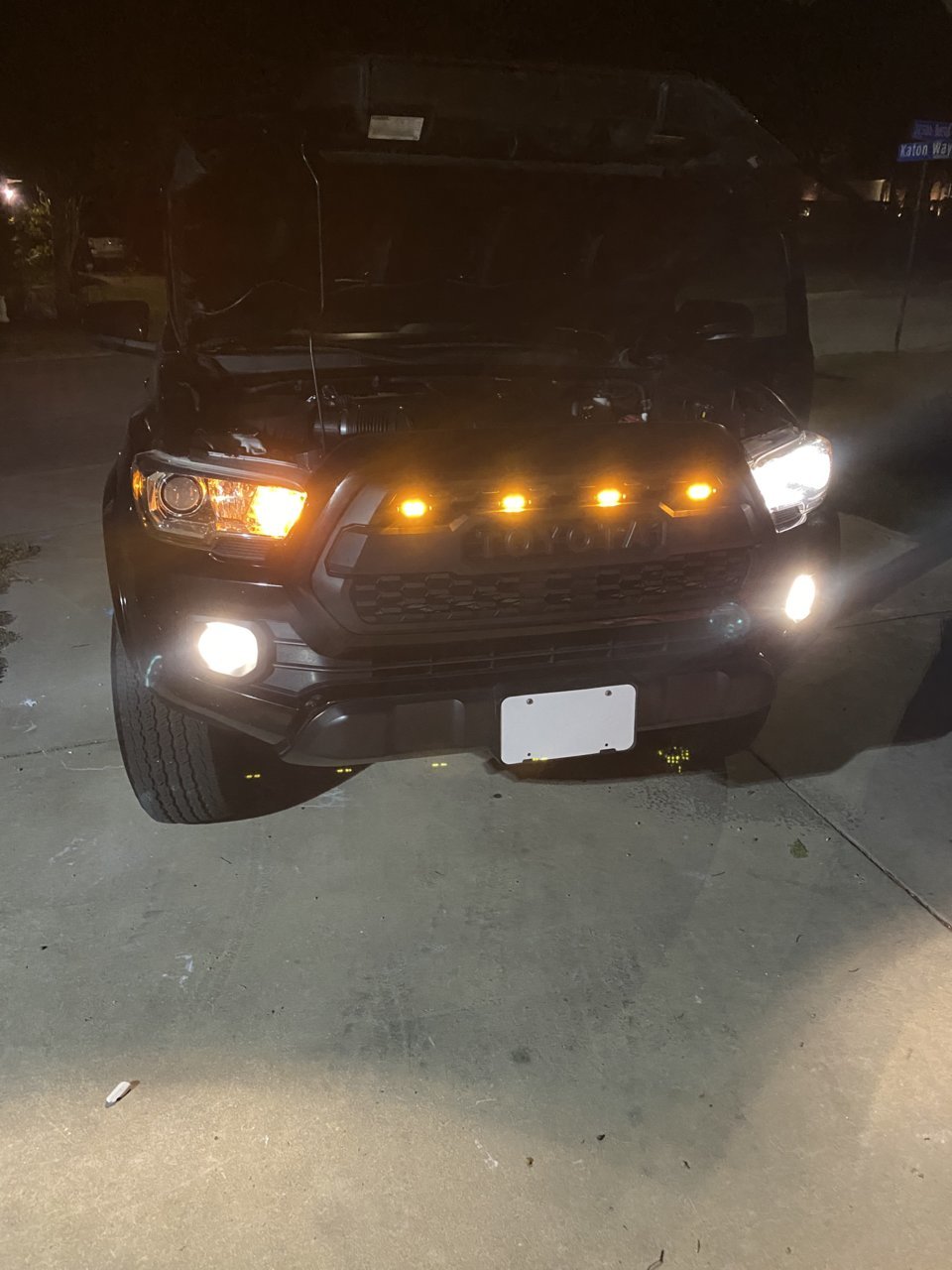

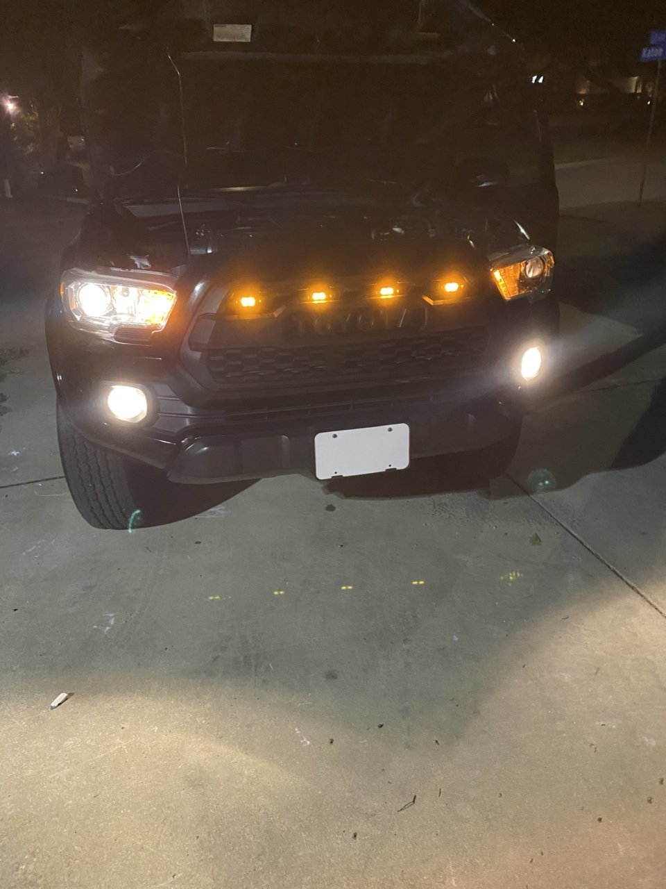

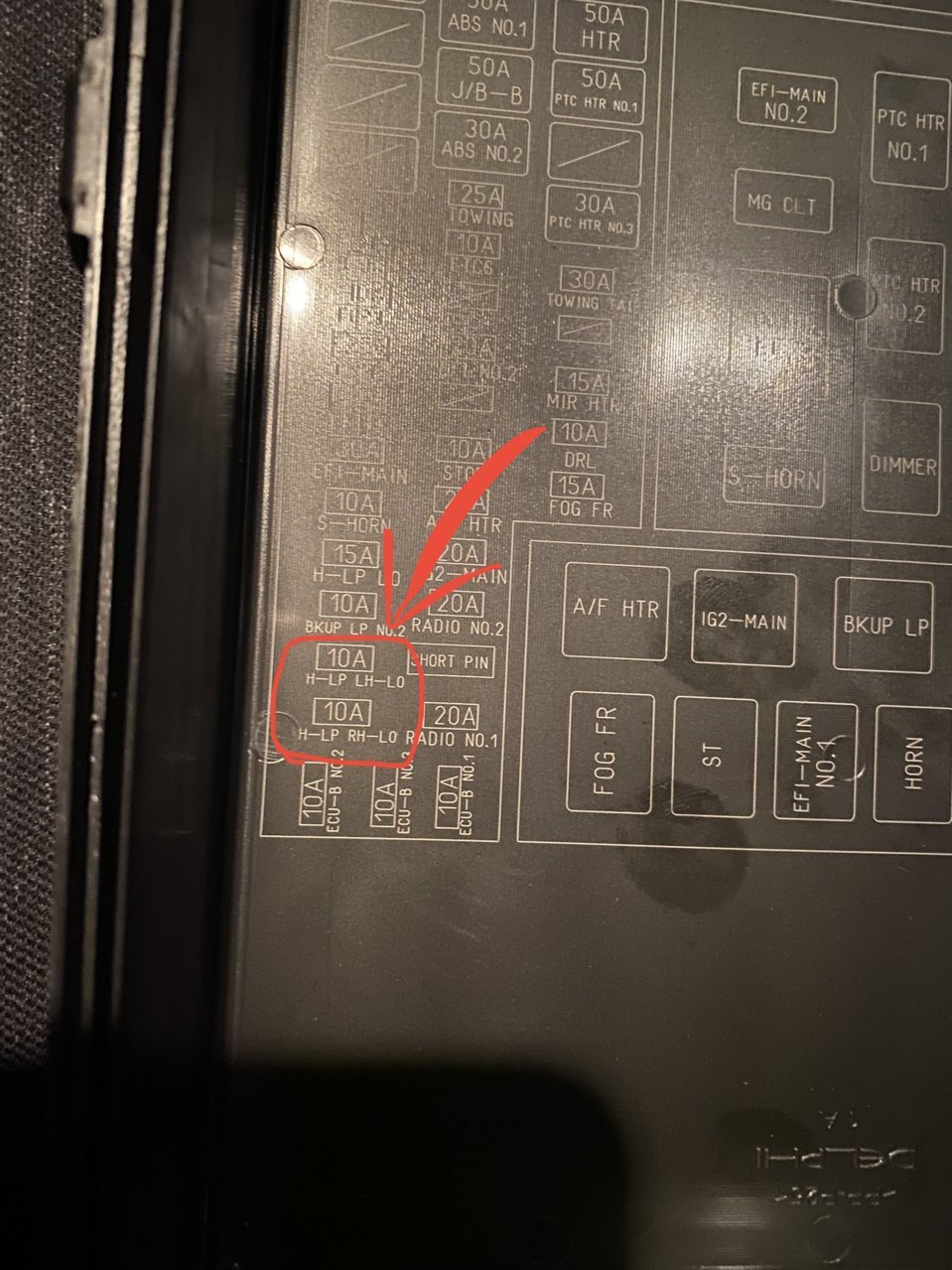

    i swapped it to the other headlight fuse and it didn’t fix it. The issue just followed to the other headlight.
    These are the 2 fuses I’m using:

    The one thing I did not do was add another fuse to the tie-in line. It only has the 15amp fuse in it. I bet that’s the issue.

    The add-a-fuse should have 2 fuses, so I think you found your issue :)

    20220803_215731.jpgyou probably forgot the second fuse

    that I did. The problem now is the 10amp factory fuse does not fit all the way down into the 2nd slot on the add-a-fuse. The little pins are too short.

    Tried the 10a INJ slot?

    When I used that slot the truck would not turn over. Again, it's probably from not having a 2nd fuse in the add-a-fuse.

    Correct I didn't use the factory fuse either . Can almost be certain the extra fuae is the problem. Just run to the store in thr morning get a longer fuse and you eill be set before you leave the parking lot
