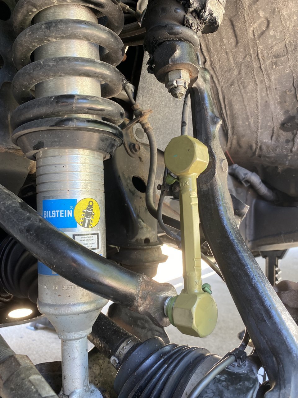

    Changed out the driver side hub assembly and installed the TTX Sway Bar Links. Really impressed with the TTX line of chassis from Mevotech. Only thing I can say it buy some 1/4 grease zerks, the ones they came with are junk. I also redid the driver side inner axle seal, it was leaking after I installed the ECGS bushing. Took it for a ride, still have some vibration in the steering wheel, put it back on the lift and shook down the front end again. Looks like Inner tie rod ends are on the menu now. 223’000 miles - I have nothing to complain about.

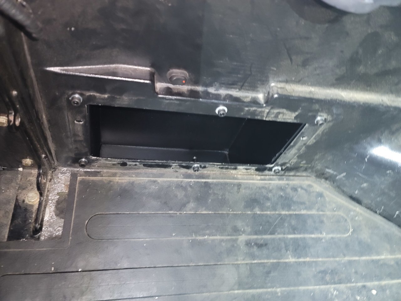

    Phase 1 of custom bed side cubby done.
    Hardware is temporary. It's not perfect but looks like it will work.
    Only concern is the strength of the fiberglass be. Time will tell.

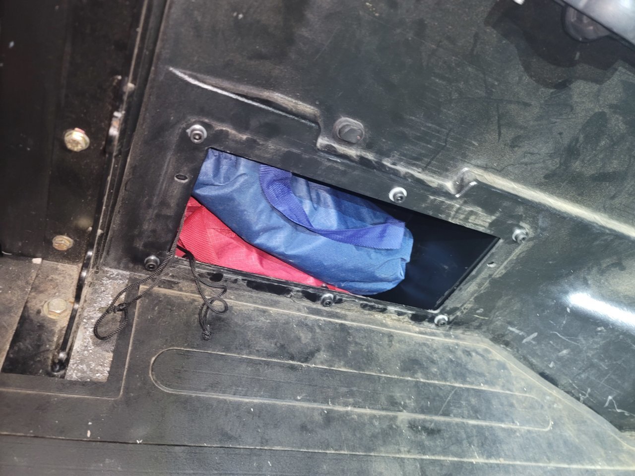

    Holds:
    Two small camping chairs.

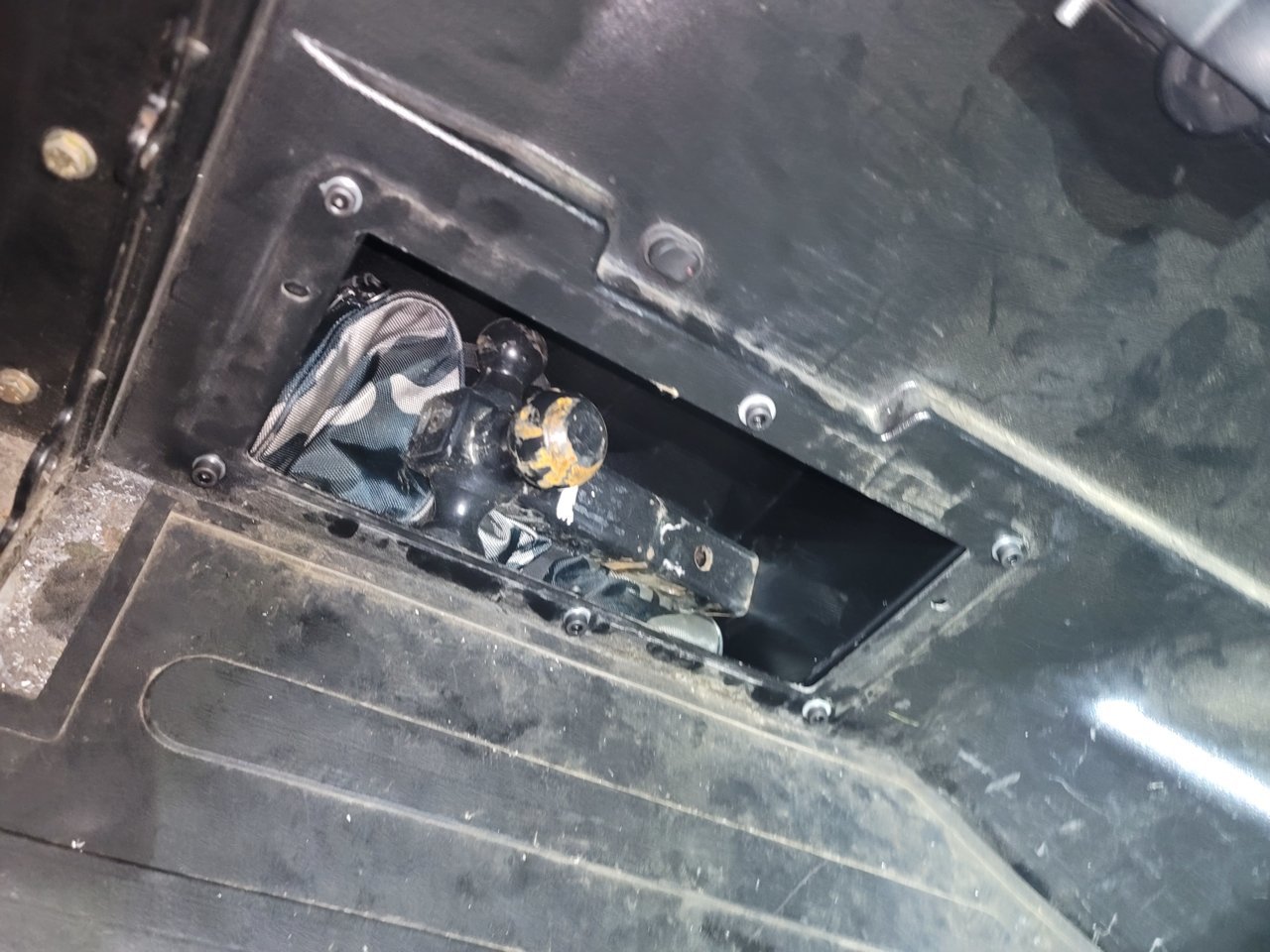

    Bag full of bungie cords and ratchet straps along with a three ball hitch.

    That's a good bit of storage. Plans for a door/cover?

    Nice looks like the tuffy boxes i bit the bullet and have them on both bed sides great extra storage i have a viair 300P hard mounted in one. Yours looks a little bigger too nice work

    Thanks. I was looking at the tuffy boxes just didn't like how the top was angled down or the price.
    I did this for right around $180. Still no door but same idea as the tuffy.
