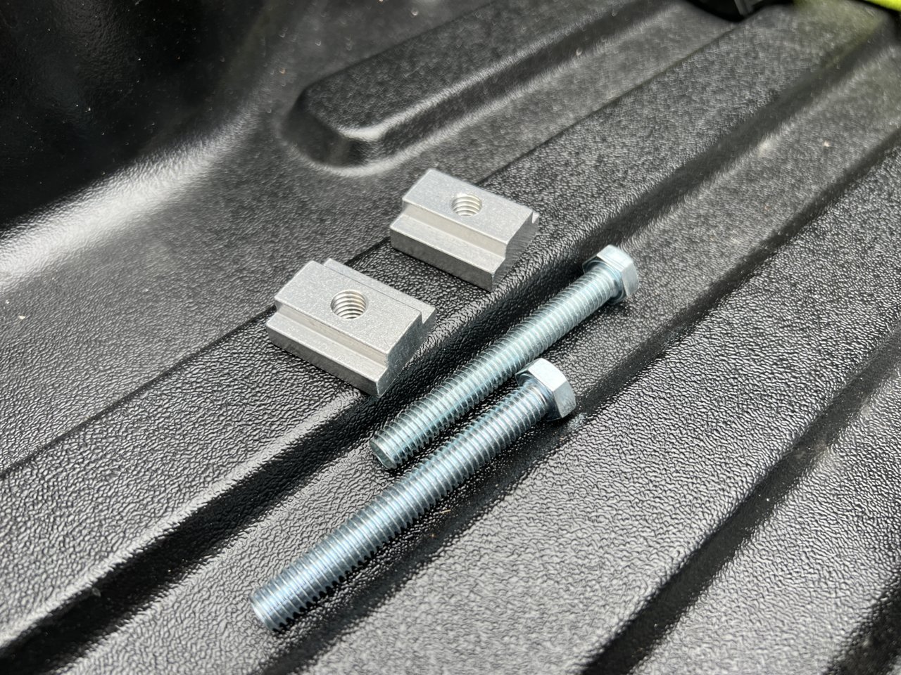

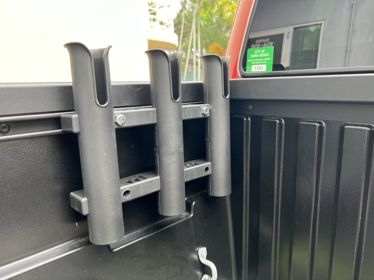

    Put on a rod holder via the bed rail. Bought some cleats from Amazon and 2.5” hex bolts. Had to drill out the back end of the rod holder but very simple

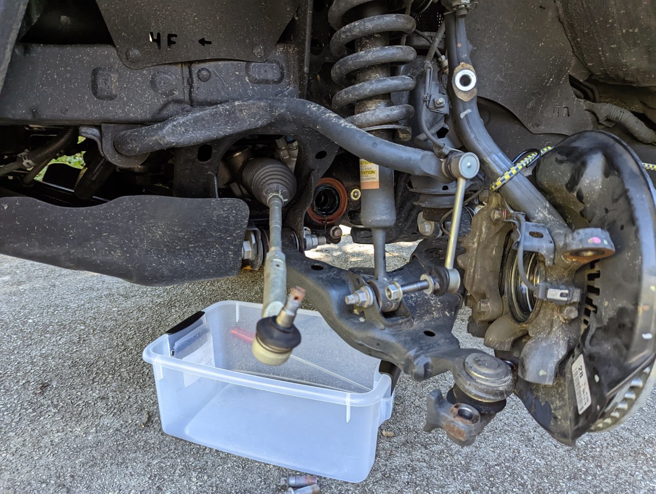

    clamshell bearing install. now im ready for my lift

    How did you find out you needed it?

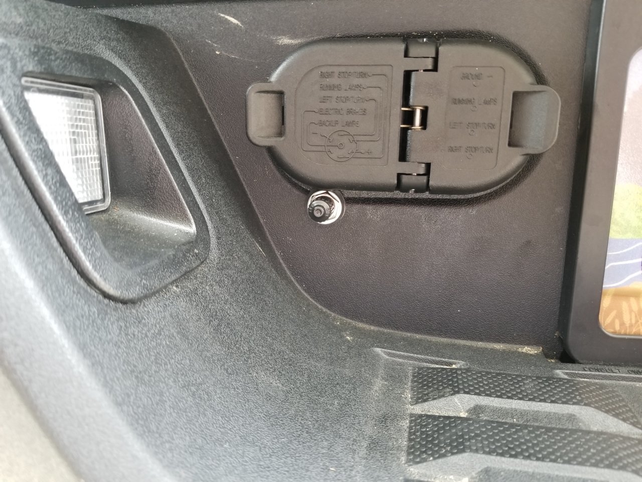

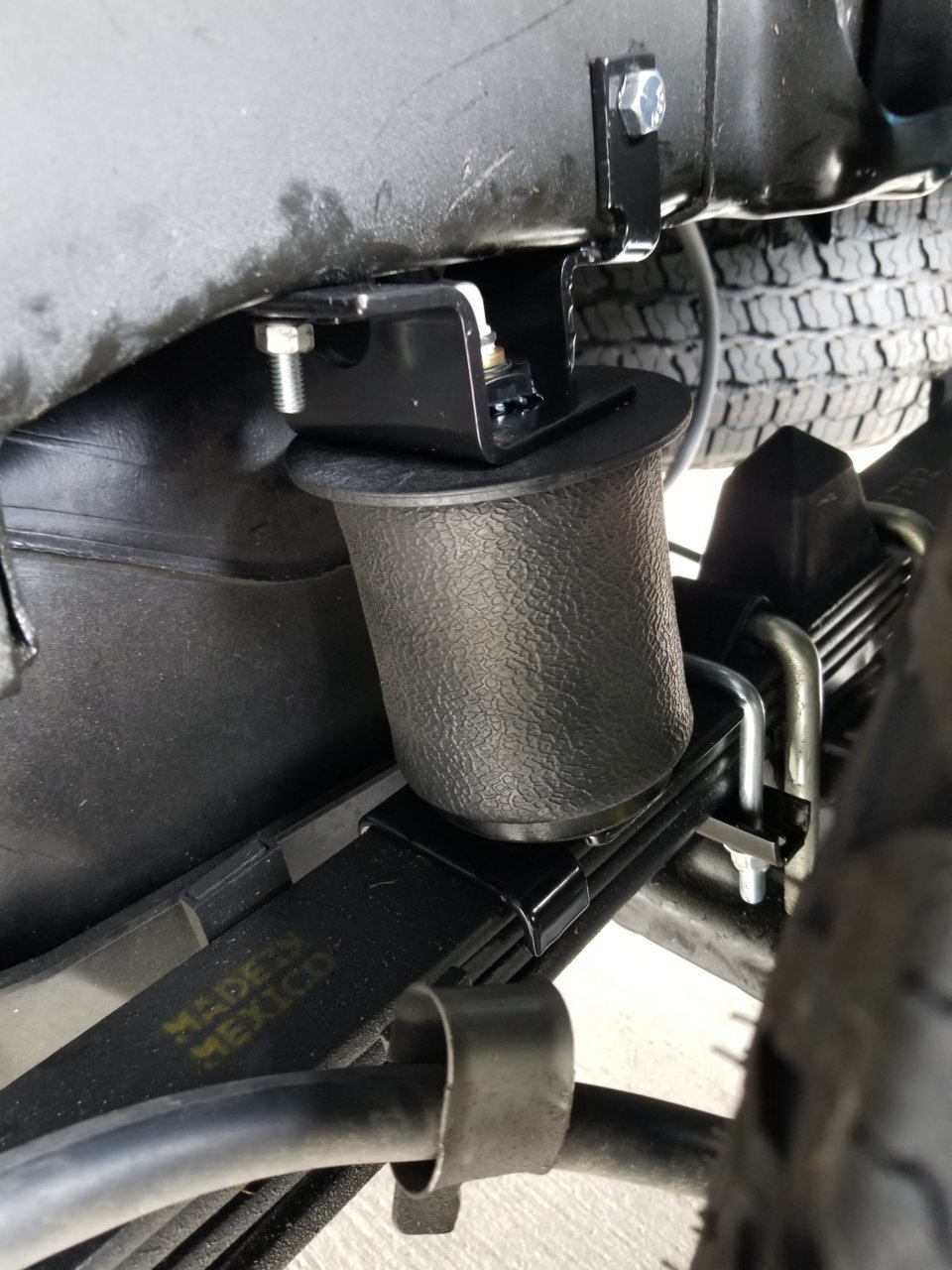

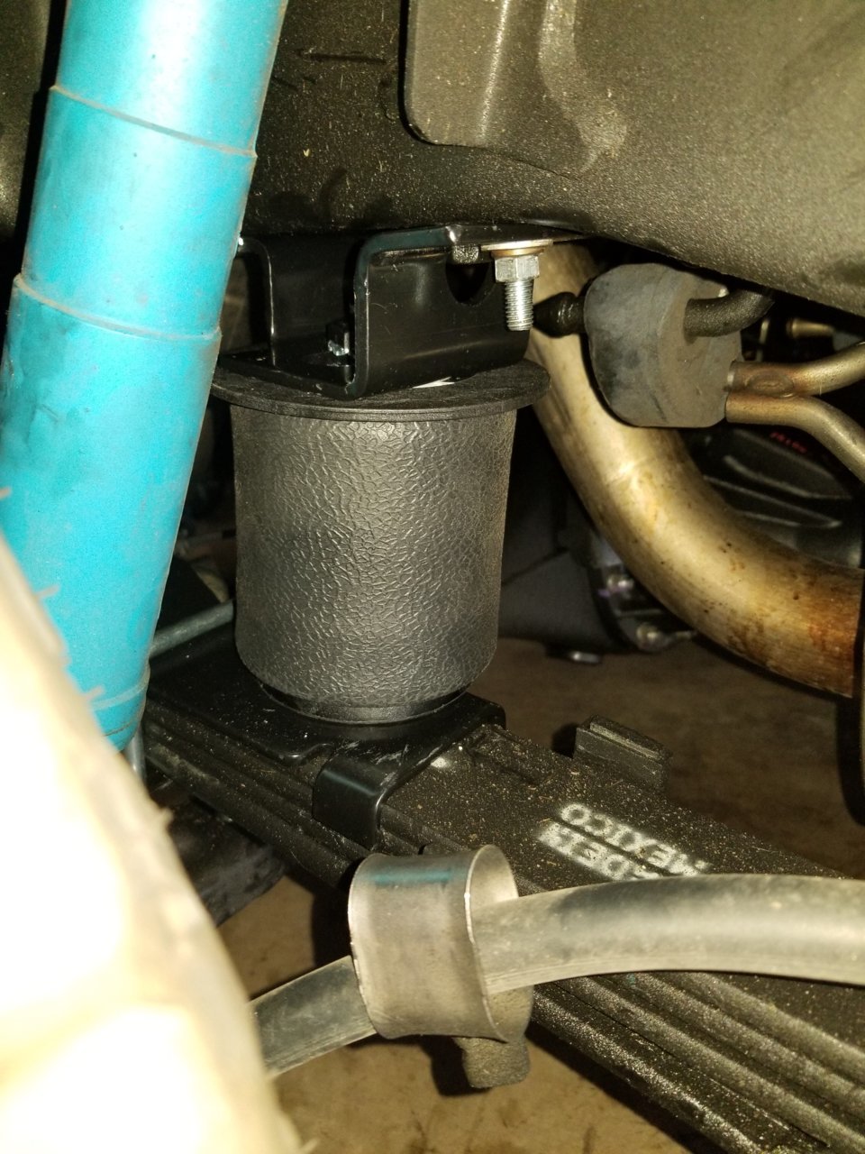

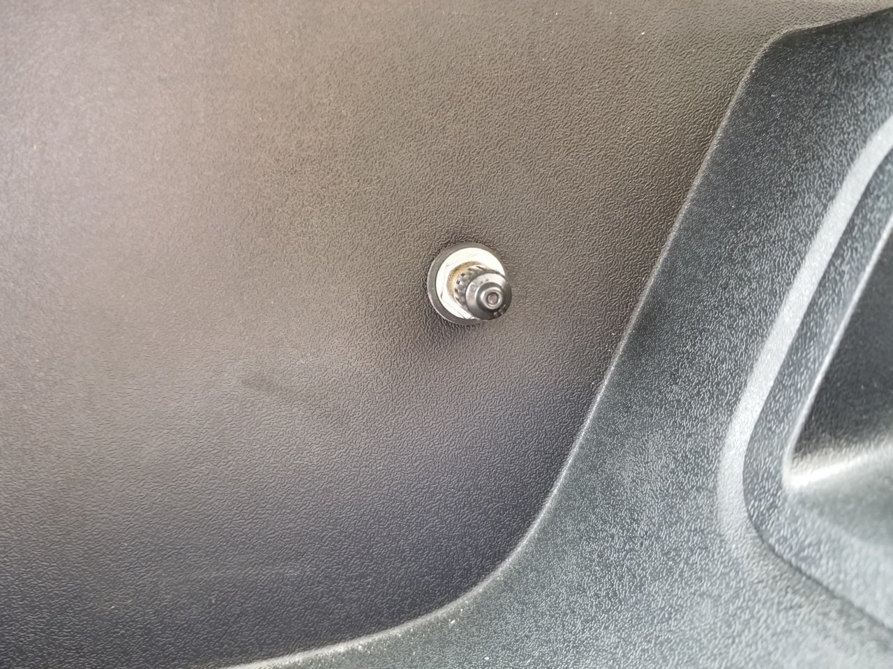

    Added the Air Lift air bags I got from the forum. Everything went easy except the bolt on driver side that the gas tank blocks. Tricky but eventually got it in. Installed, tested and sitting with 5psi in each now. Just need to connect trailer with load to see how they level out a load. Btw....the Schrader fills that I mounted to the sides of license plate are not perfectly level to each other but used existing holes on backside of bumper to limit drilling through 2 surfaces.20221001_105555.jpg 20221001_105654.jpg 20221001_105708.jpg 20221001_105713.jpg

    I didn't, I just wanted to be able to replace it on my time instead of finding out I need to and being worried its going to send bits of metal into my diff. I have the lift ready to go. I just need to install it

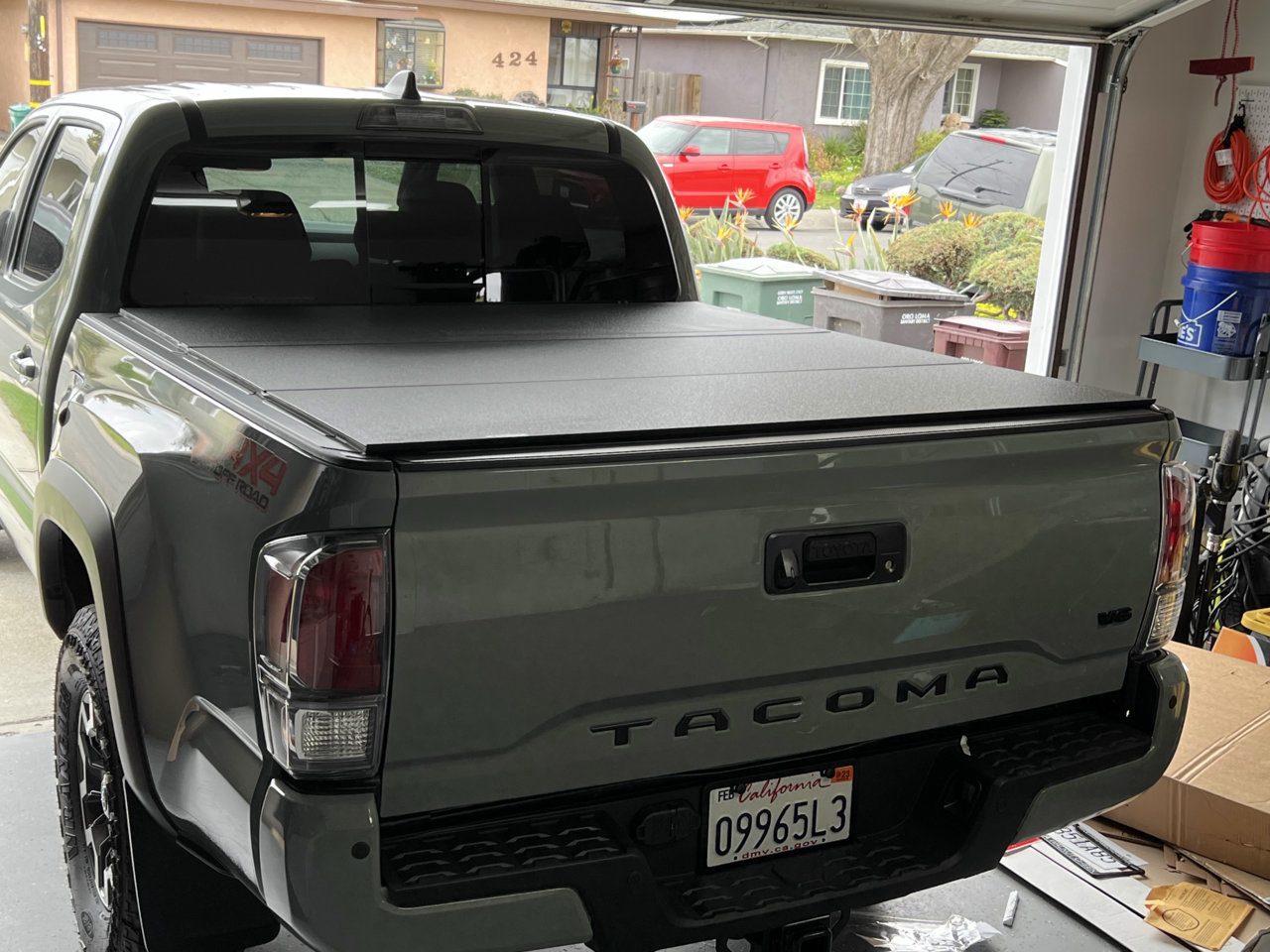

    Been a little busy the last couple days. Good thing about waiting 10 months for your ride to arrive....10 months of saving up for mods:
    >VLED Reverse light license plate mount
    >DiamondBack HE bed cover. Used part of the OEM rail cleats to secure DB Tray.
    >Total Chaos bed stiffeners.
    >FBC Harness Solutions harness for license plate light disable when in reverse. Eliminates glare in reverse camera from license plate lights. High quality harness with OEM connectors. IMG_4577.jpg IMG_4580.jpg IMG_4579.jpg IMG_4582.jpg IMG_4583.jpg IMG_4580.jpg
