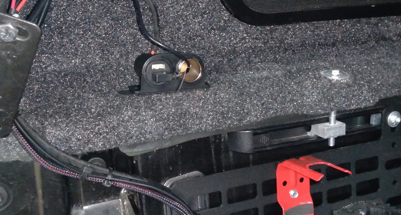

    Installed a 12v/USB receptacle in the bed for my rear facing dash cam. I've been meaning to do this for a long time. It was previously plugged into the 120v bed outlet and I would turn the converter on every time I drove the truck to power it.
    Now the camera will turn on automatically with the ignition. 10 gauge wiring back to the battery going through a relay that's triggered by the 10A INJ fuse.
    It's just mounted with velcro for now, good enough for a Monday. If it stays put I'll just leave it as is. I would like to find some blank covers for the unused holes, though.

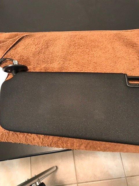

    removal of visor stickers:
    heated the visor up with a small space heater, or
    can use an iron by covering sticker with old tshirt
    worked a corner up -fingernail-enough to start peeling slowly,
    after sticker gone glue residue left so,
    put a clean piece of t shirt over spot and ironed it for 15 - 20 seconds,
    one sticker had more glue so re ironed with clean piece of shirt a couple more times till it looked good,
    the glue will stick to the t shirt when heated......I had 7 decals on my visors

    what did you use for the camera mod?

    Nilight waterproof automotive relays
    12v dual USB power block
    Add-a-fuse from O"Reilly's and some #10 THHN from Home Depot. I already had plenty of insulated butt crimps and misc. stuff lying around.
    Made a harness with this: 1/4" expandable PET braided sleeving and some cloth tape.
