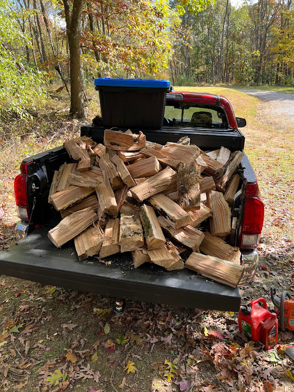

    Used it like a truck after cutting and splitting some wood. Based on the amount of squat compared to the 1,100 pounds of concrete I had in it before, I'd guess the firewood tips the scales at about the same weight.... lol

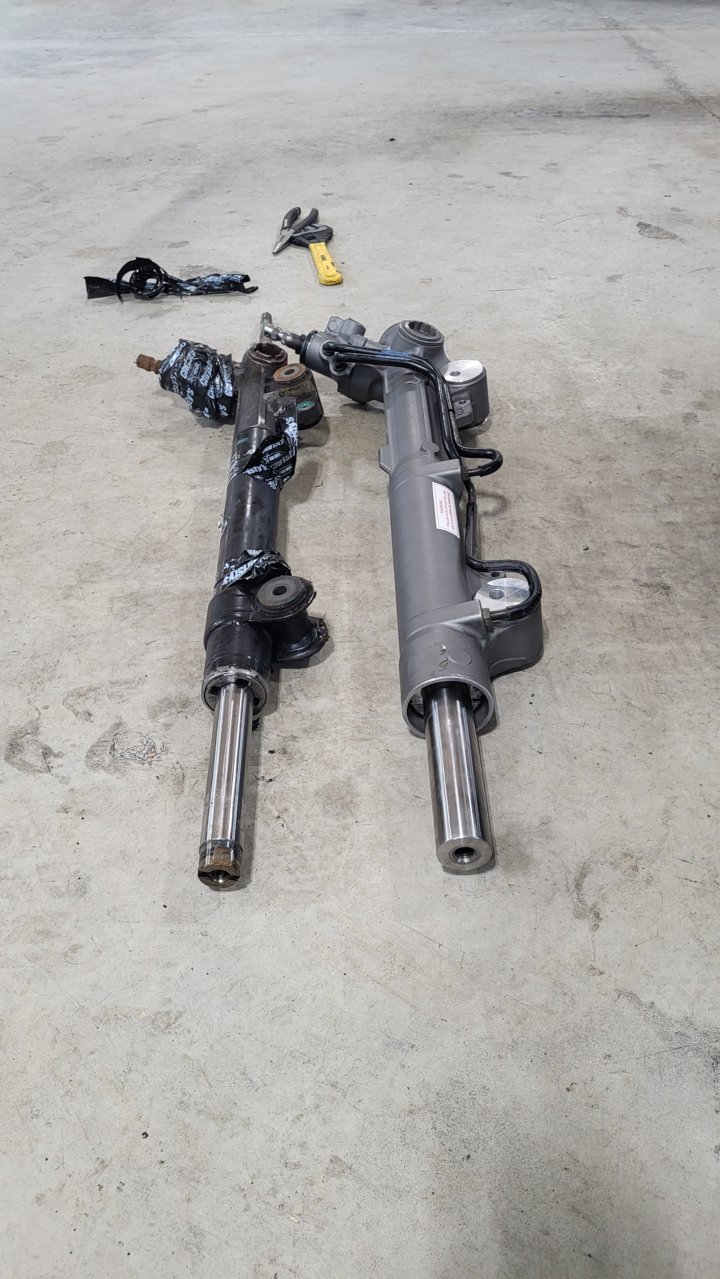

    Tundra rack, bout an hour more of work tonight until its driving.

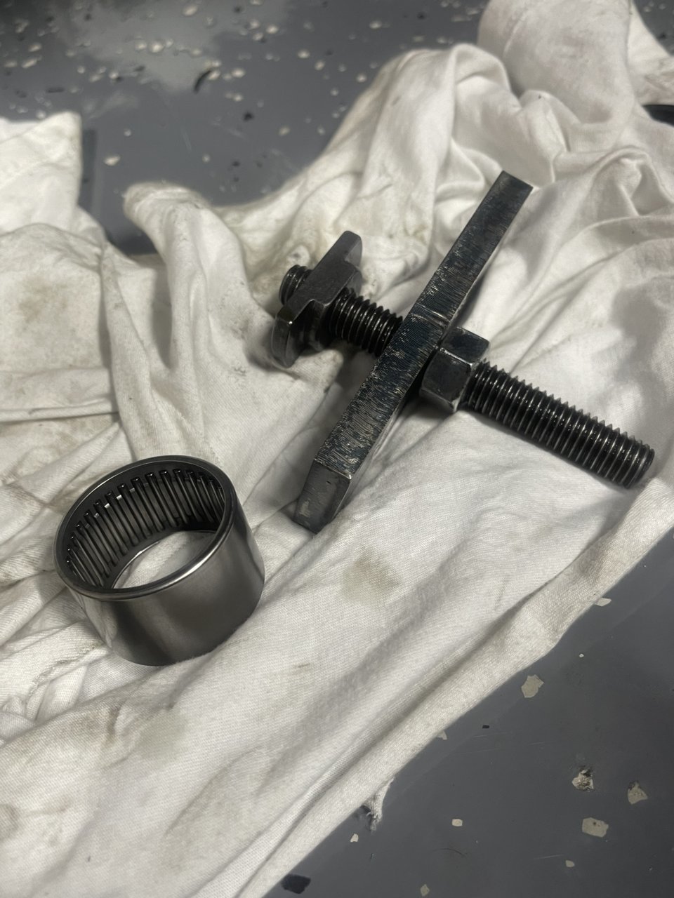

    Pretty smooth! I’d been putting it off but I figured ‘why not’ while I have the time.. worst part is getting the axle out. A big flat head and a mini sledge made easy work of it though, it just took me a while before I tried that option lol. I also had the bushing in the freezer all day to try and help with install, not sure if it actually did anything but it went in fairly easily.

    The piston-rod looks like one mm or two bigger diameter, and the whole unit looks bigger, will you need to replace the pump as well to enjoy any improved benefits of the tundra rack? Is it from Same year tundra as your truck?

    Rod is 8mm bigger, housing is way larger/beefier, and this one has been modified to work in a Tacoma/pressure has been bumped up a bit. Stock pump still, and has more turning power so far on the first drive. But, will eventually get a high pressure pump to go with.

    Thanks for posting. Could you let us know if you had to modify the steering shaft at all.

    Yessir, made a new one out if solid bar stock about 1.5" shorter

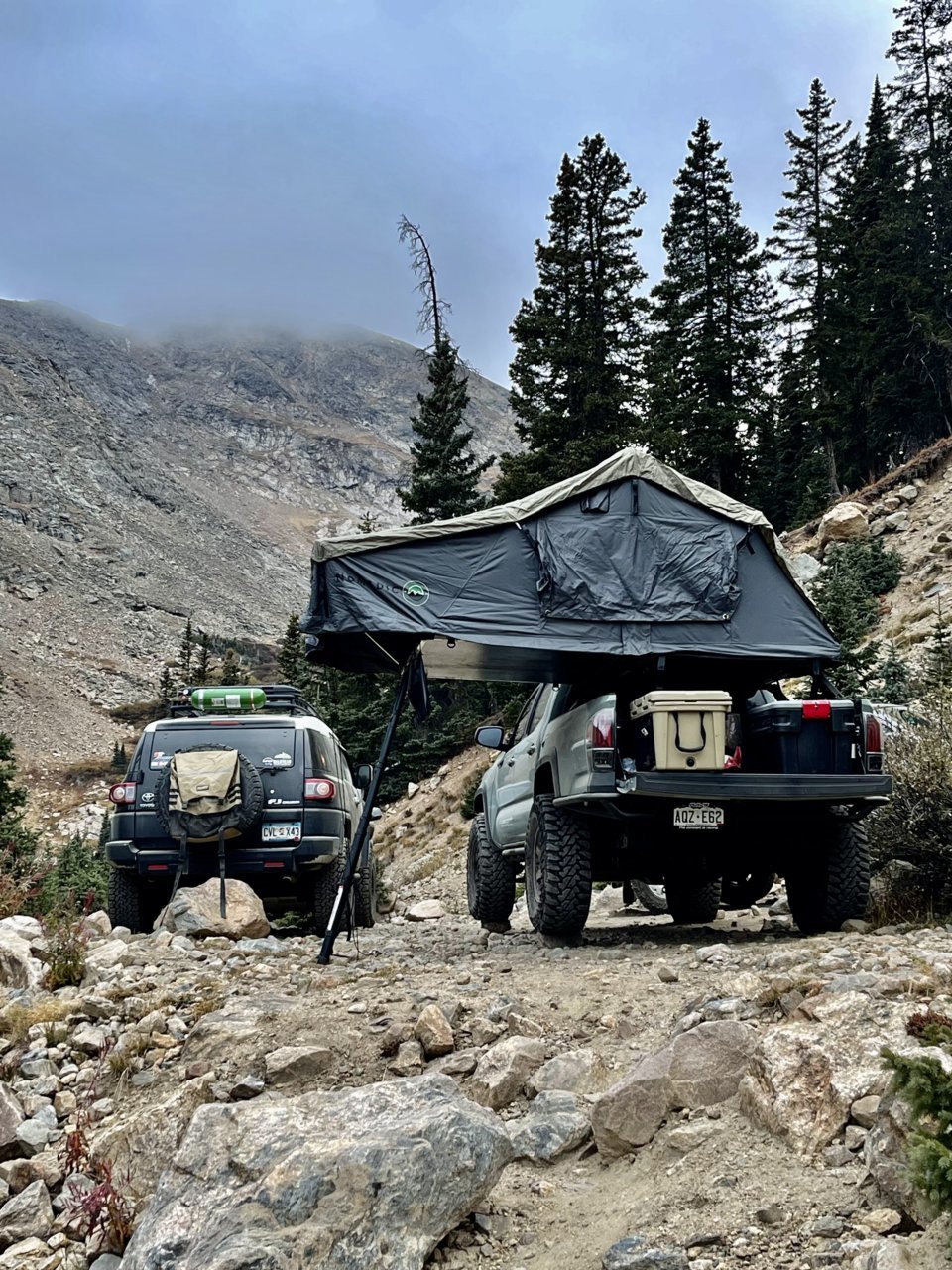

    Quick weekend campy trip out in the Rockies

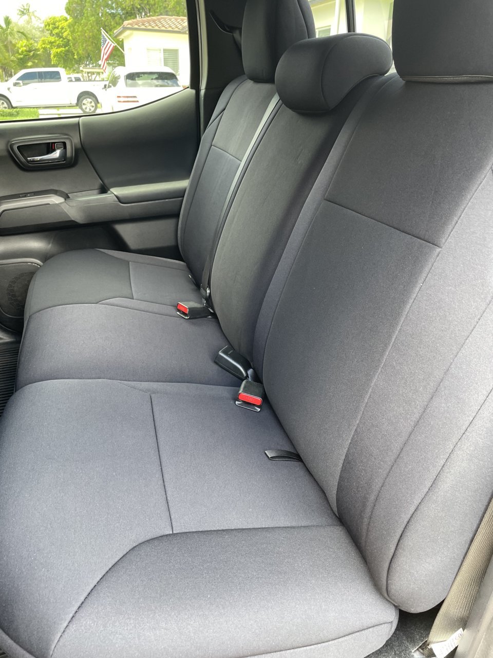

    Upgraded my seat covers to the Rough Country neoprene covers. They fit great and look good.
