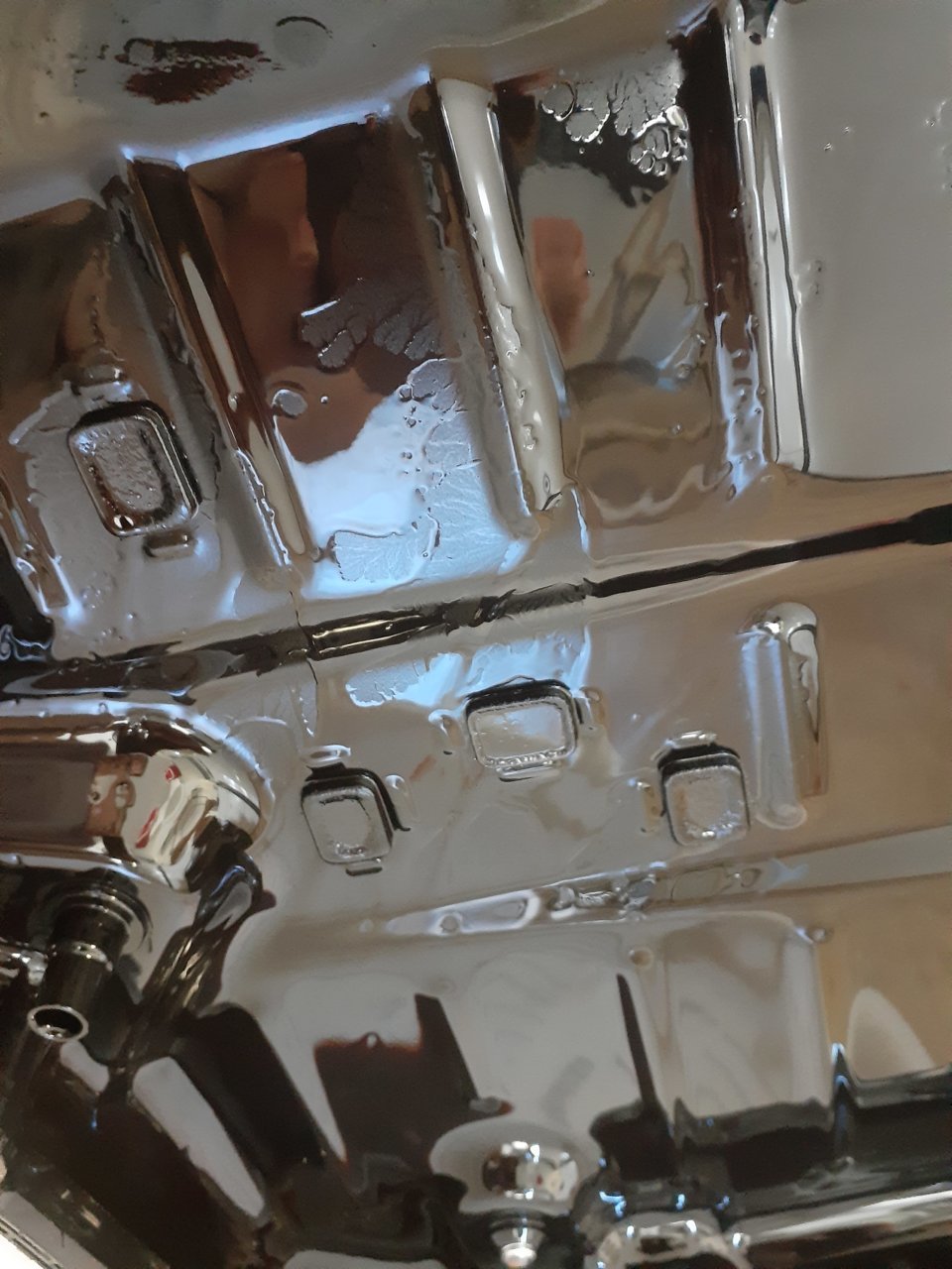

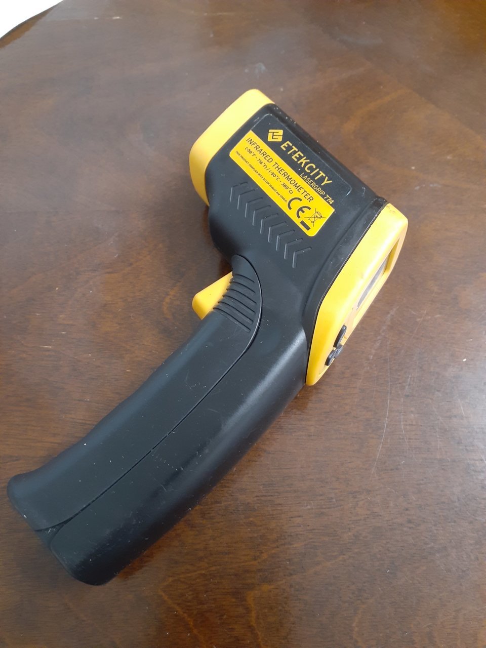

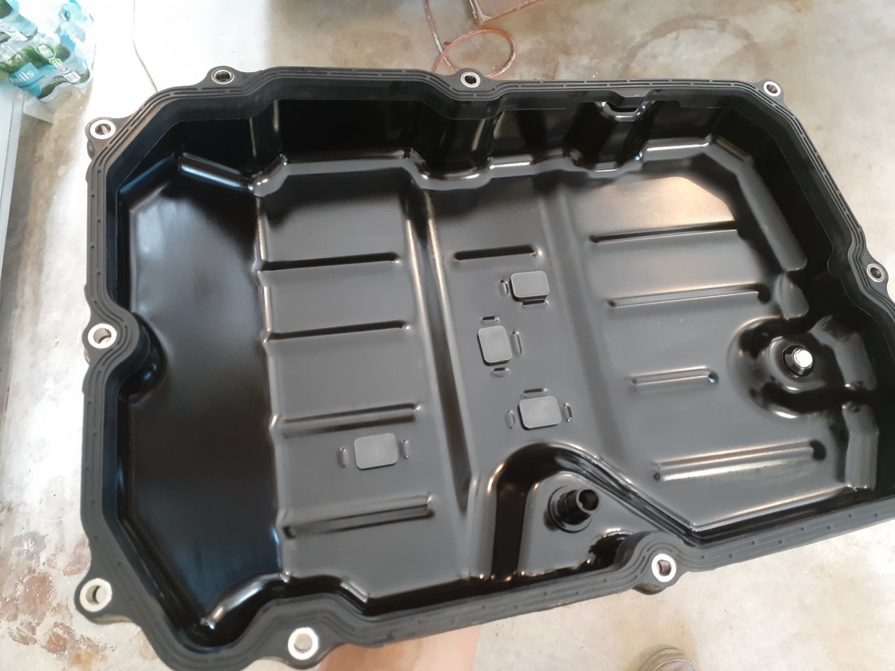

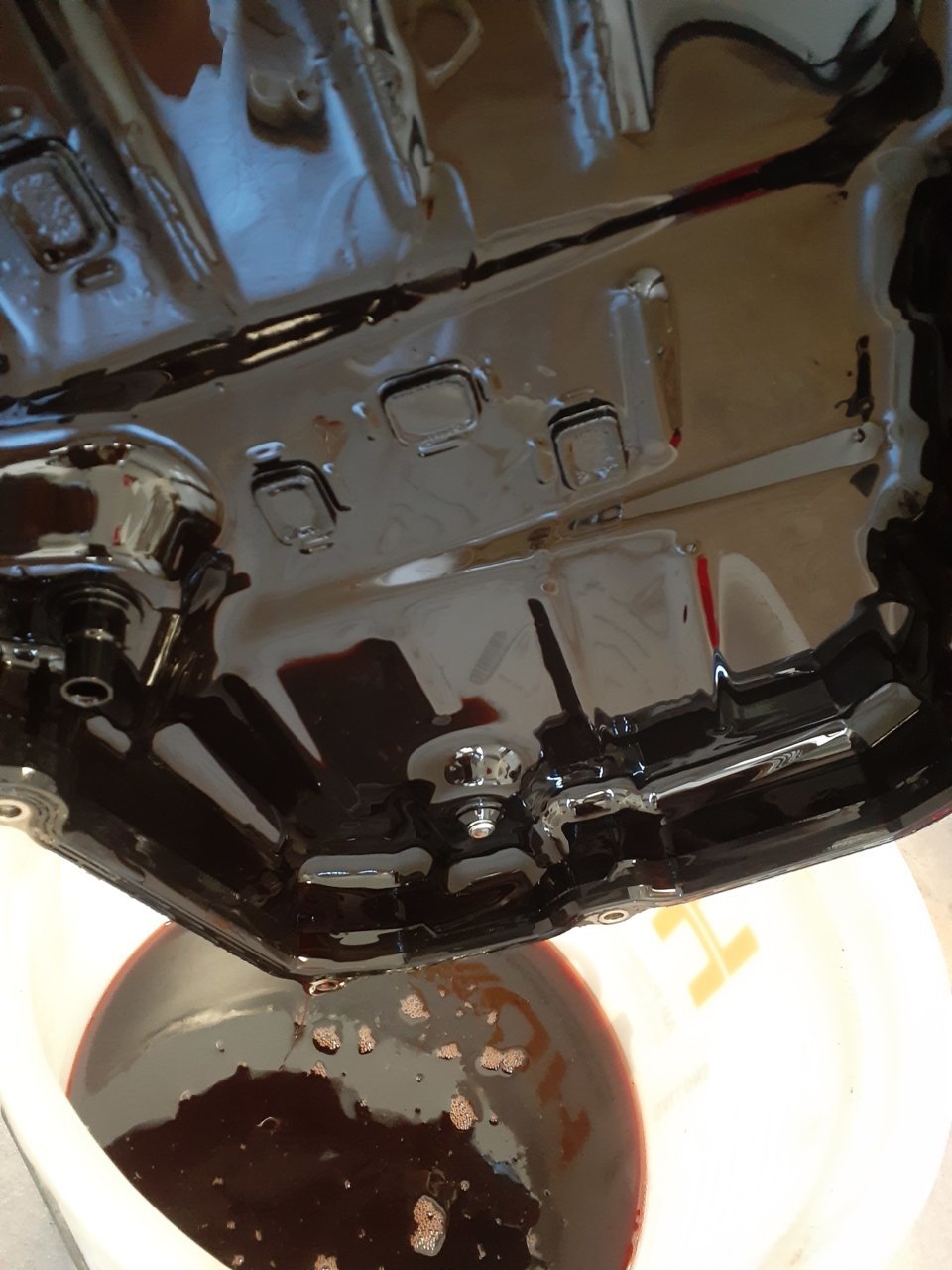

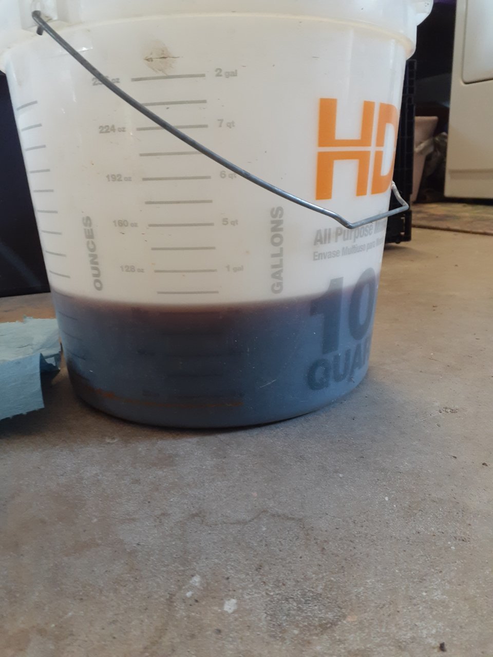

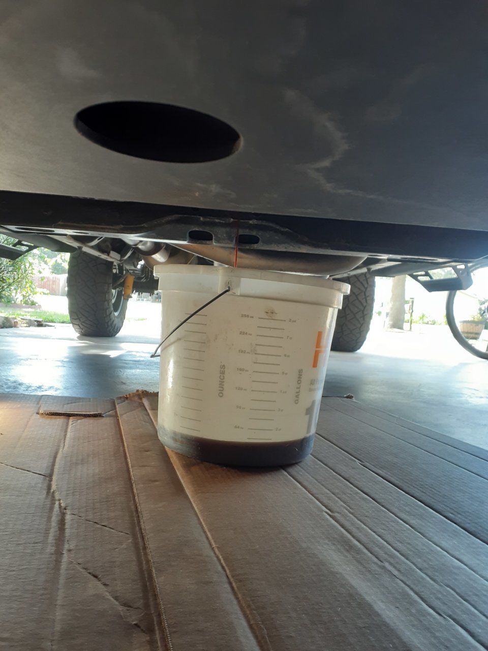

    Transmission fluid change, amsoil. Removed pan, cleaned magnets, cleaned inside pan, and emptied and reinstalled screen filter. Installed new gasket on pan, and replaced 5mm Allen overflow nut with a drain bolt.
    Obd II port lacked a pin in location 13, so I used laser temp gauge and this was easy. Ambient air was 86° today, truck was in garage all night, started it up and since instructions stated that it takes about 10 minutes to get trans oil temp above 95 I laid under truck for 10 minutes checking temps every minute in 6 different locations of trans pan. Pan area under screen filter port heated quickest with an average temp 1 or 2 degrees hotter than the pans corners. All areas of the pan eventually reached 98° then I pulled the overflow plug. Oil streamed out as expected for what seemed like 2 minutes then finally started dripping , I replaced the overflow bolt at that point. Checked the temp after tightening bolt to 15 lbft, and was 107°. Victory.

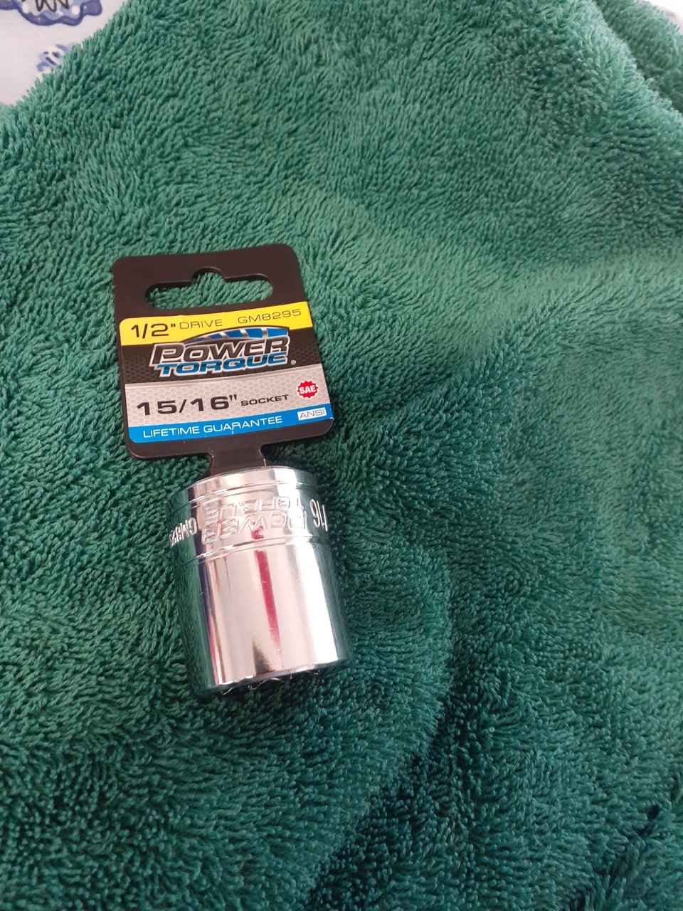

    I had to jump on the bike to O'Reilly's auto parts to pick up a short 15/16 socket, either I lost mine, or forgot how to use my deep socket in that tight space, didn't want to get fluid temps up right before the fluid change, this was the first bolt I dry loosened before removing any fluids, haha luckily.
    Thumbs up to the TW write up on this process.!!

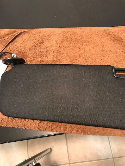

    removal of visor stickers:
    heated the visor up with a small space heater, or
    can use an iron by covering sticker with old tshirt
    worked a corner up -fingernail-enough to start peeling slowly,
    after sticker gone glue residue left so,
    put a clean piece of t shirt over spot and ironed it for 15 - 20 seconds,
    one sticker had more glue so re ironed with clean piece of shirt a couple more times till it looked good,
    in real life you can not see the spot in photo

    Ah, I see, a fellow Home Depot quart bucket fan for fluid changes lol. Way better than any oil pan I’ve ever used.

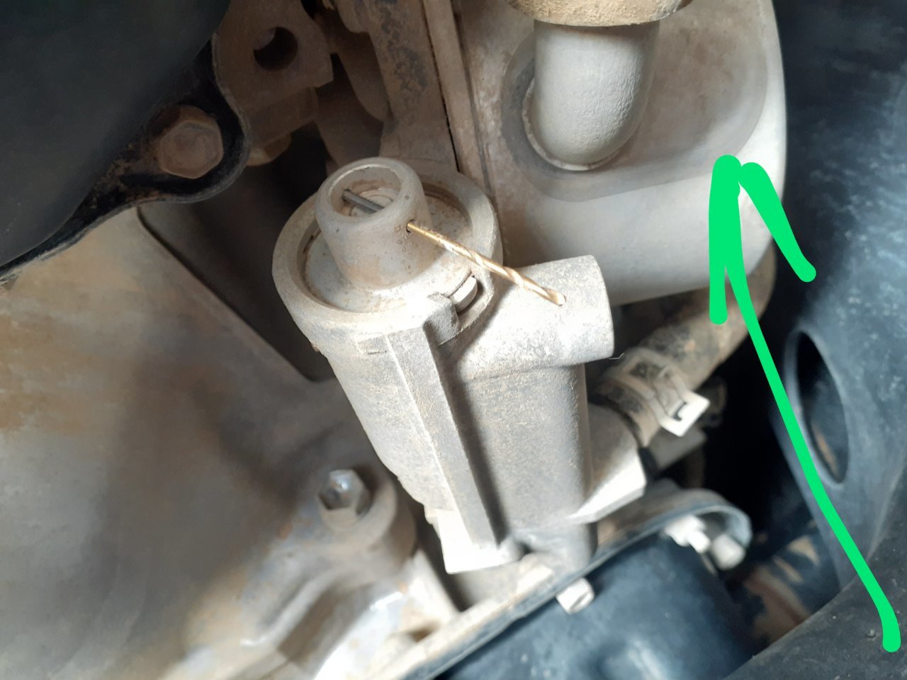

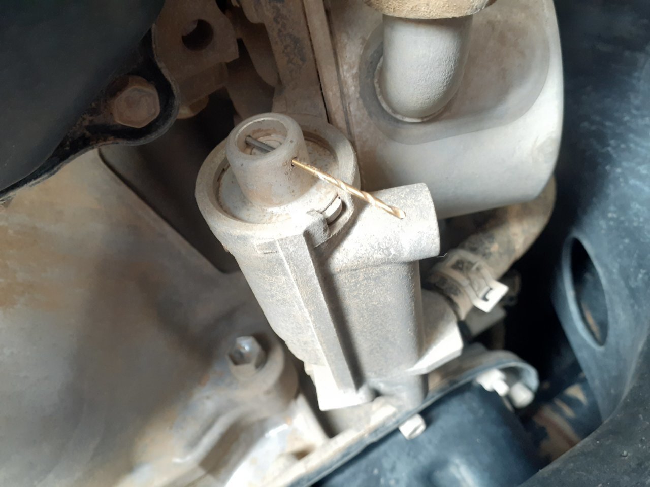

    What’s with the drill bit??

    Pins the thermostat open on the trans so the fluid circulates fully through the trans cooler.

    That, disengaged the thermostat on the transmission fluid heater. The car care nut recommends this. Drill bit removed prior to truck leaving the garage.;)

    Heater. That round thing in the pic is a trans fluid heater. Right here, bad angle but it is round.
