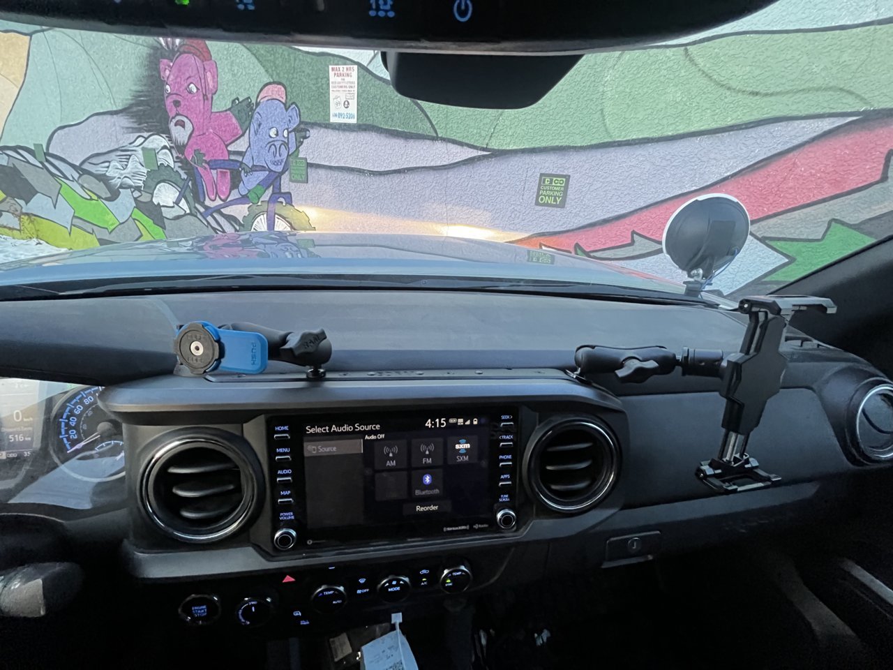

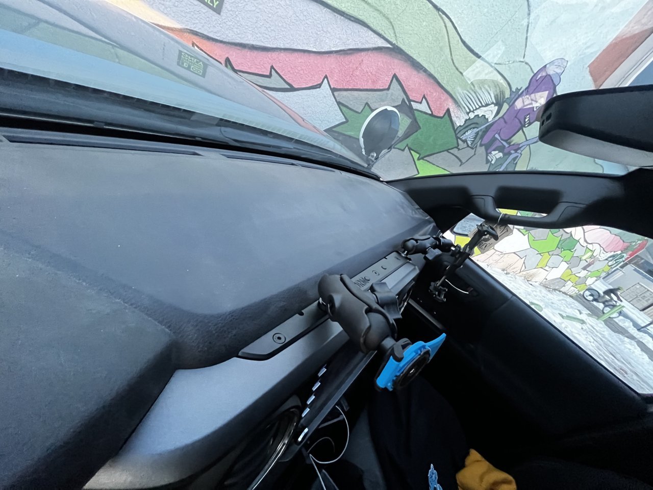

    I bought one of the Boomer Dash Ram Mounts and got it installed with some Amazon’d threaded ram balls, ram arms and an el-cheapo tablet holder for whatever device the passenger is using. Super easy to install and mounts up nice and clean.

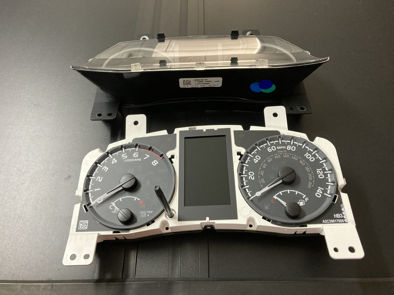

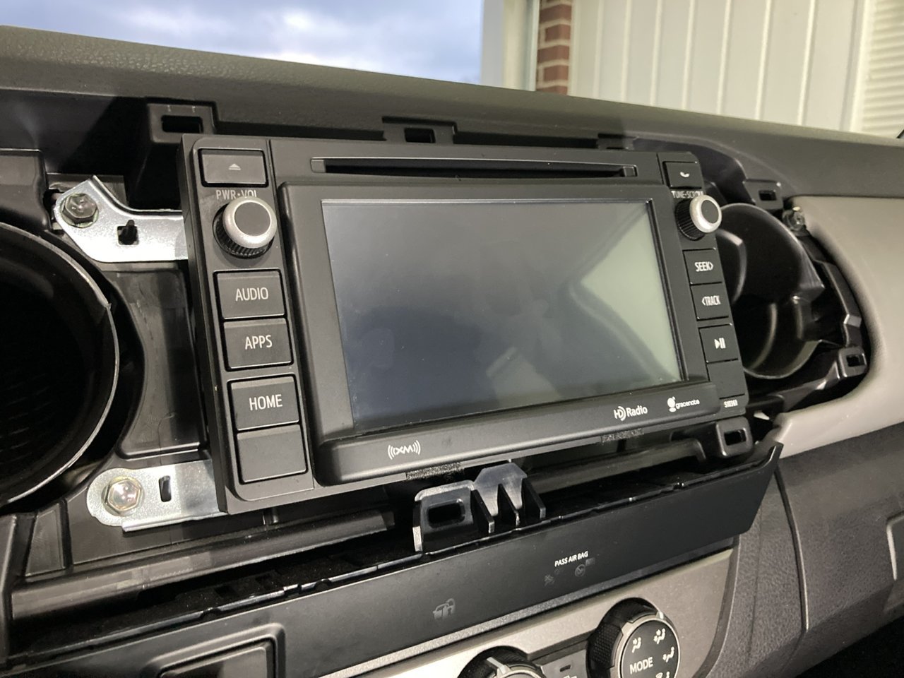

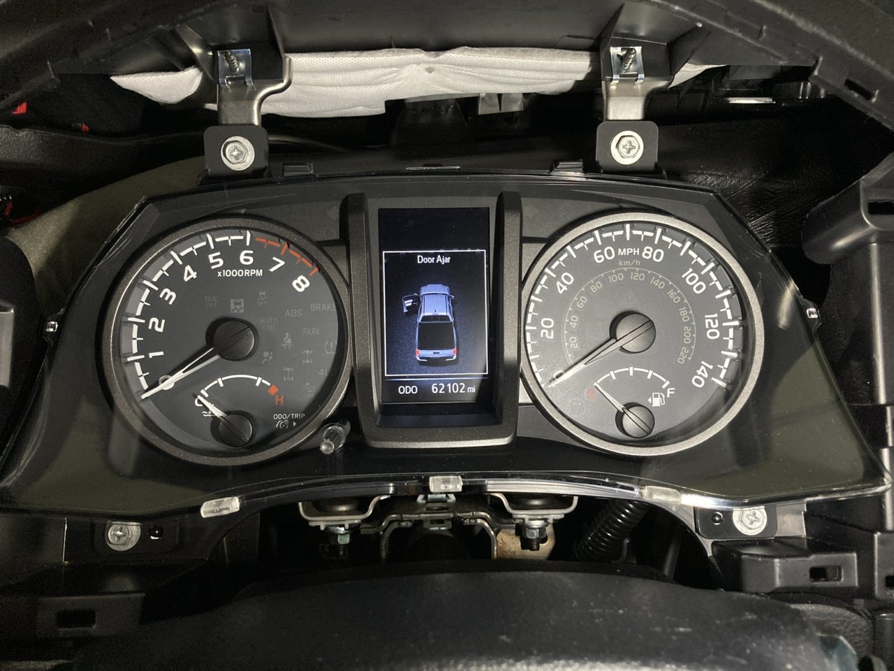

    I eventually got tired of looking at the scratched instrument gauge cluster in my truck, so in an effort to start fresh I got a new gauge cluster and the Screen ProTech kit. I also added the protector for the gear indicator and the radio touch screen.
    A few things to note:
    -This is pretty simple to do, and there’s a QR code you can scan with detailed instructions if needed.
    -Take your time, especially when pulling the dash pieces out. The plastic tabs can break if you’re not careful. I used a trim tool to gently pop it out.
    -I found it useful to position the steering wheel extended out and all the way down, plus putting the blinker and wiper sticks in the down position. This allows for more clearance getting the cluster in and out.
    -There are 4 screws that hold the gauge cluster in, plus 2 electronic ports and 1 plastic tab on the back. They’re pretty easy to disconnect.
    -To separate the cluster glass you need to remove 8 screws on the back with a T15 bit. These were torqued pretty tight from the factory so be careful not to strip them out.
    -I managed to get most of the air bubbles out but there are a few small ones that should clear out in a few days.
    Hopefully this may be of help to anyone considering doing this. I’m just glad I don’t have to see that terribly scratched glass anymore! And yes, I did find the Taco easter egg hidden behind the instrument cluster.

    You got a link for that tablet mount? Looking for one just like that. The only other I like so far is the tackform one. Thanks!

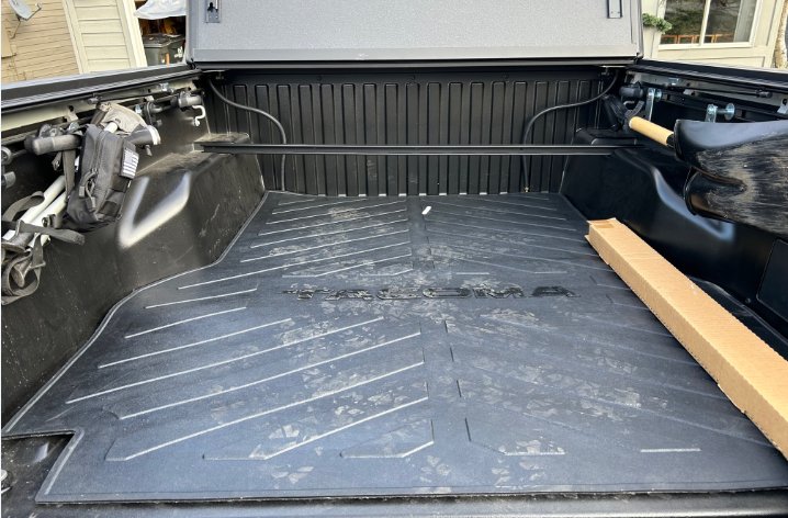

    I received my Cyber-Monday OEM accessories:
    • Bed mat ($119)
    • Front bed rail (2nd gen) ($27)
    The parts guy didn't want to help with the bed rail since it was a 2nd gen part. The holes line up perfectly. However I can't install it for a while as I need to take the tonneau cover off (normally a 5-minute job) but I blew my shoulder out last week so I only have one good arm.

    Nice write up. I struggle with the clips to the right of the steering column. From the looks of it, you might as well have replaced the head unit while you were there. :spending:Is that the entune premium?

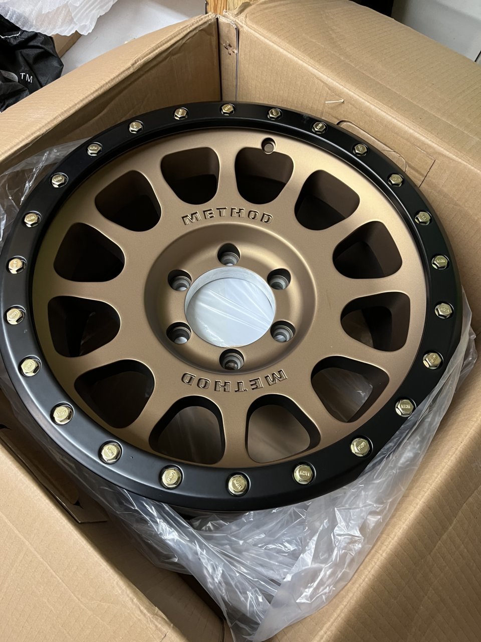

    AE22C54F-3296-4767-BCE3-7367345D8DC2.jpg Picked these up today. They look so much prettier in person.

    That’s wild because they look so good in that picture. Very nice.

    Always loved these wheels
