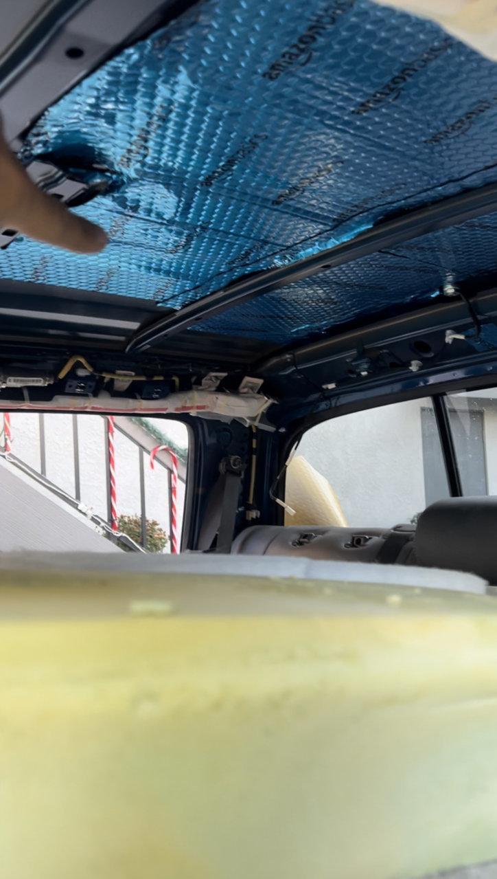

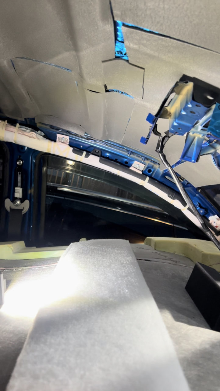

    Sound deadening the roof. I found the roof rack too noisy. Hoping this helps

    Wish I had your skills! A quiet cab is my dream....

    It isn't too difficult Peel and stick the deadener and roll with a roller. It cuts easily for trimming.
    Put mine in my cab in the garage using a garage heater to warm it up just to make is easier to shape.

    what’s steps did you take to drop the headliner?
    any tips?
    I will be doing this soon and not sure where and how it’s clipped to the roof.

    I watched a few videos. Most are 2nd Gen based tho. I need to replace a few clips I broke.
    Best 3rd gen video I found, but only for the back half.
    https://youtu.be/rFYvxA_tdw0
    This one is well documented and had a blog in the description
    https://youtu.be/QIdhPrb06t8
    I had to work around the headliner which was annoying. Just lay the front seats down to get more space.
    If you have the auto braking/smart cruise control type features, remove the plastic next to the rear mirror before dropping. I cracked that slightly unfortunately.
    The liner is fiberglass or similar. My hands were very itchy and I had a cough afterwards. Gloves and mask might be helpful.
