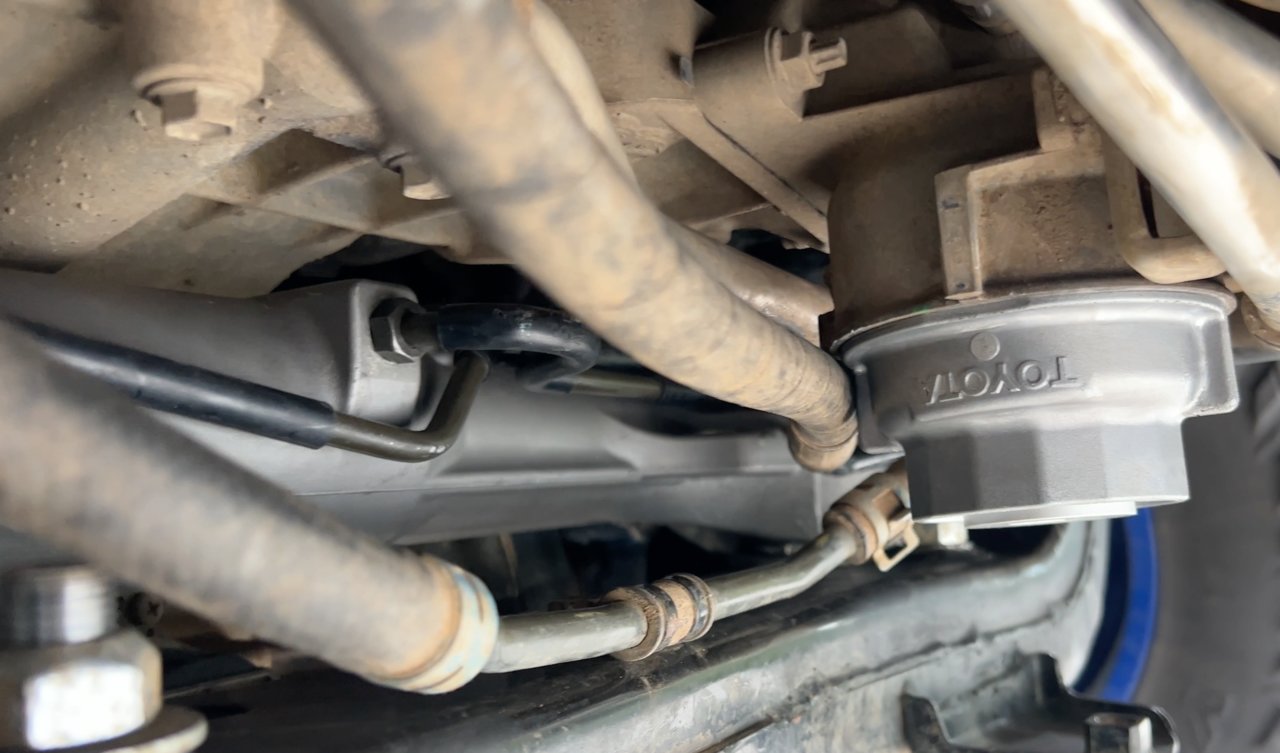

    Hi- could you please share the link for the OEM Toyota metal oil filter housing and cap you upgraded to? I see so many on Amazon, but hesitate to order. I’m assuming it should also work on my 2020 OR without doing any modifications??

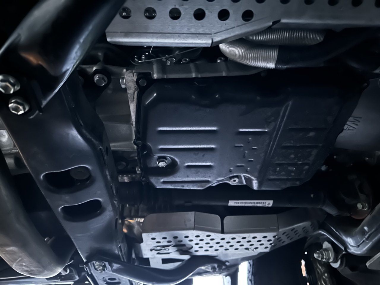

    installed the cali raised cat guards. had to jack the drivers side up like others have mentioned to get the guard in, passenger side was a breeze. torqued the cross brace bolts to 24 ft/lbs and the tranny subframe bolts to 30 ft/lbs. picture isn't very good as it was just starting to get dark when i finished...

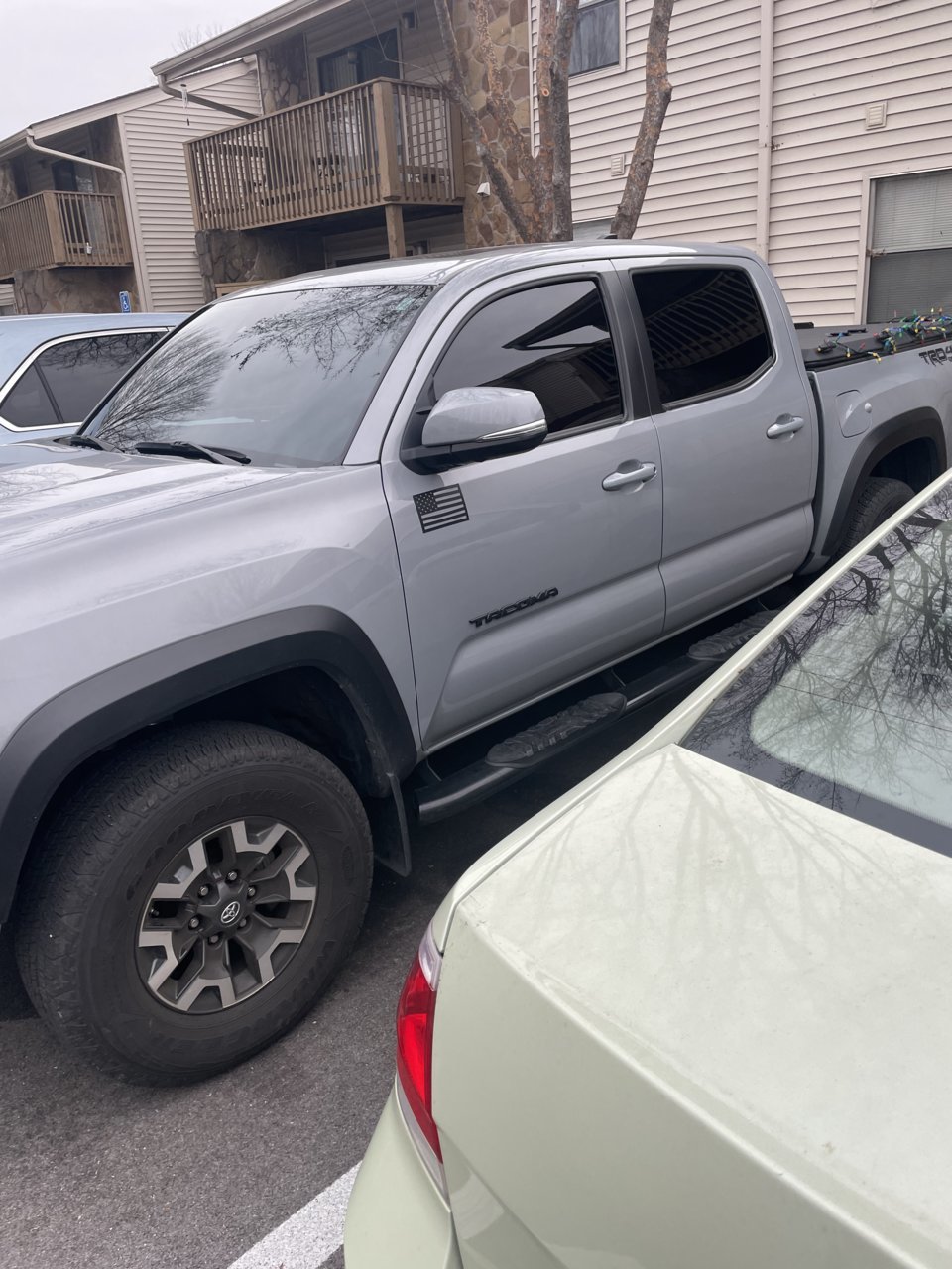

    Got the truck tinted finally

    Nice. What level of tint did you go with?

    5% two fronts
    45% windshield
    20% over factory rear.
    used llumar comfort ir plus

    Fr pass door handle replace, Tyger step rails and soft bed cover, DDSS3 fogs, TRD skid, OR front tow hook, SokieTech hood struts, fr seat covers (neoprene), metal oil filter housing, magnetic oil plug, Cyclone under hood lights, Blue Sea Systems 5025 Fuse Block ST Blade 6 Circuit with Ground and Cover, Blue Sea Systems 60A DC Panel Mount circuit breaker.
    Toyota PN: 15620-31060
    $32USD last I checked on Amazon
    Filter housing is metal and the above noted part is the cap, which was plastic when I bought my ‘18 Sport new. I paid about $19USD for it in Sep 2018. It’s gotten stupid expensive.
