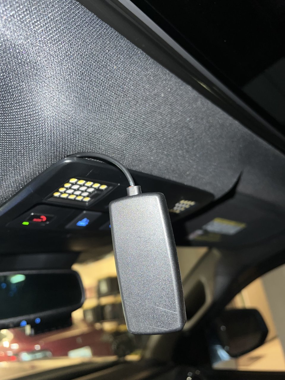

    Here is where I mounted my interior antenna. It is completely out of the way.IMG_6088.jpg
    I'm not who you asked, but I've had the weboost for over a year. My two cents:
    We only use it on trips, so it's not often. So it's pricey for something not used much. If there is no cell signal to amplify, the weboost won't help. That being said, we have enjoyed having it especially during the long trips we were usually able to pull a signal down despite our cell phones not working. The # of bars displayed during use is NOT an accurate depiction of signal strength. Literally no help if you are standing outside the truck. The internal antenna only throws about 36" and does not seem to penetrate the windows if they are rolled up. The spring on my antenna is rusting and that irritates me. Had I known the finish would not last, I would have sprayed it with Rust Stop before installation.
    YMMV

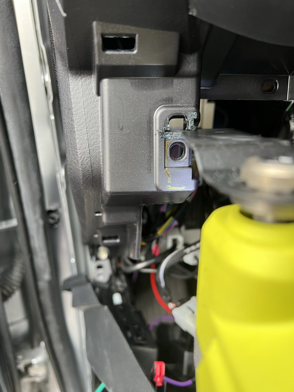

    Installed the Rough Country Speedometer Calibrator. Can’t believe how easy it was. For once, the how-to videos weren’t lying. There are a number of things that nearly all men habitually and compulsively lie about. For example, how big their penis is, how long they last in the bedroom, how much they can bench, and how long it takes them to do maintenance on their vehicle.
    Most You Tube instructional videos drastically underestimate the time needed for any given job. “Hey guys, don’t forget to like and subscribe. Today, we are gonna remove and replace the transmission on a 2021 Toyota Tacoma. Make sure you have about 2 hours set aside for this job.”
    Anyhoo, i give two solid thumbs up to the Rough Country Speedometer Calibrator.
    Here is the data from my before and after tests. Stock tires were 265/65-16. New tires are 285/70-17.
    Before speedometer numbers with the 285/70-17s (speedometer speed = GPS speed):
      • 51=54
      • 55=58
      • 65=68
      • 75=79
      • 85=90
      • After installing the RCSC:
          • 55=54
          • 65=64
          • 75=73
          • 85=84
        I would have taken more pics but the job was done so fast that i forgot to take more pics. I left the USB cord sticking out and tucked it behind the kick panel just in case i decide to change the settings in the future but for now, I’m happy as a puppy with two peters.

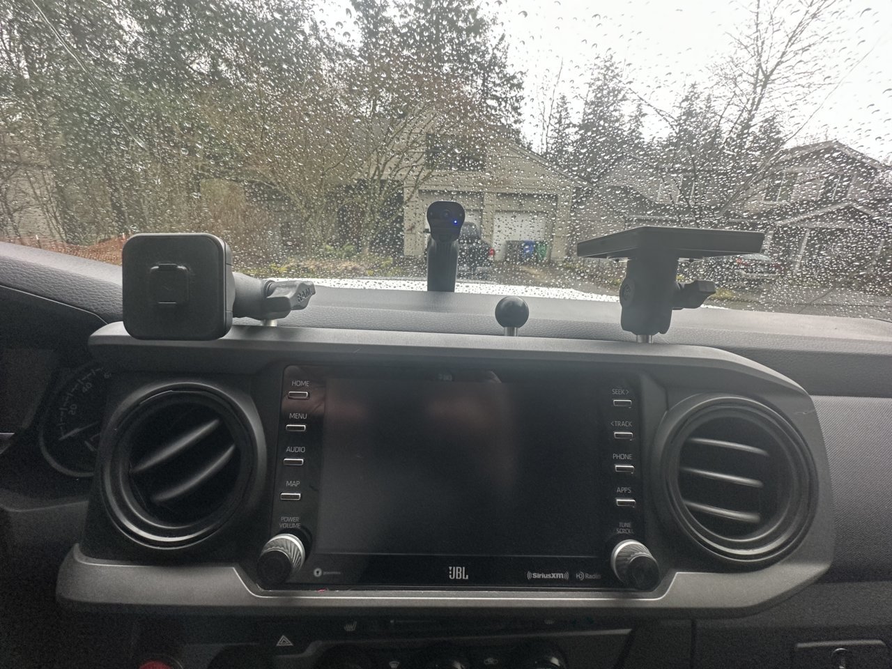

    I installed the Ring Car Cam last week and removed the FitCamX. I need to a better job centering it on the dash but otherwise I’m happy with the install. Also, it’s super easy to download videos using the Ring app and you can access it when you are parked. One really nice thing about that is it allows me to check on my pup, if he is hanging out in the cab.
