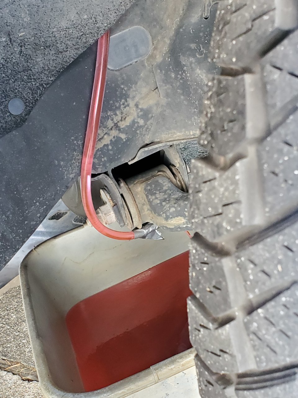

    Changed out the coolant, Toyota made this easy.
    Remove the passenger wheel, pop the top plastic clip out and gently fold the splash shield down.
    And find this handy block drain.
    A long extension and a 10MM socket.
    And some 5/16" ID hose, it fits the radiator drain too. If you leave the radiator cap on when you drain the radiator (before draining the block) it will siphon the fluid out of the recovery bottle too.
    Didn't spill a drop.
    :yes:

    Nice job and some great tips. You make it look easy.

    Same at the 2nd gen Tacoma.

    It was! :thumbsup:
    I was expecting a pipe plug block drain like old engines had - you always got coolant everywhere but the drain pan.
    This job was a breeze.

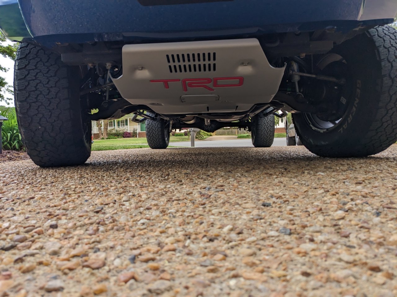

    Totally unnecessary, but nice upgrade!

    Curious what you paid for it? I paid $382 shipped. Cheapest I could find.

    I want one too and I have no use for it aside from looks of upgrading the stock one lol.

    Wait for a Toyota parts sale and take the time shopping around different dealerships online (it's crazy how wildly different the prices of parts are from one dealer to another...even in the same city). I'm sure others have found better deals but I got mine around Black Friday with free shipping for just under $280.
