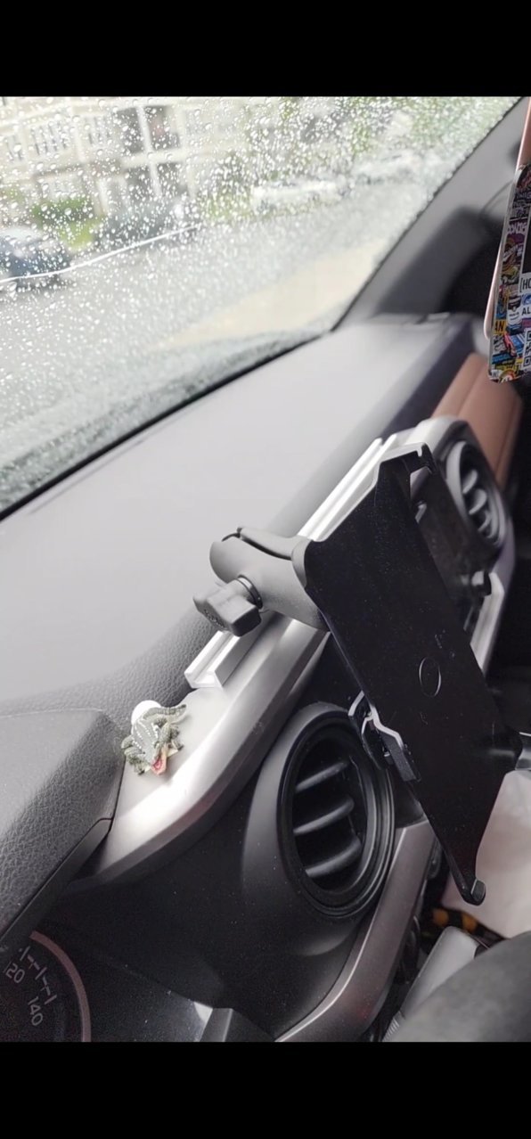

    I couldn't justify spending the money for the bulletpoint phone mount when I already had so much RAM stuff sitting around, so I used $12 of Amazon t-track and some aluminum flat bar to make this low pro phone mount

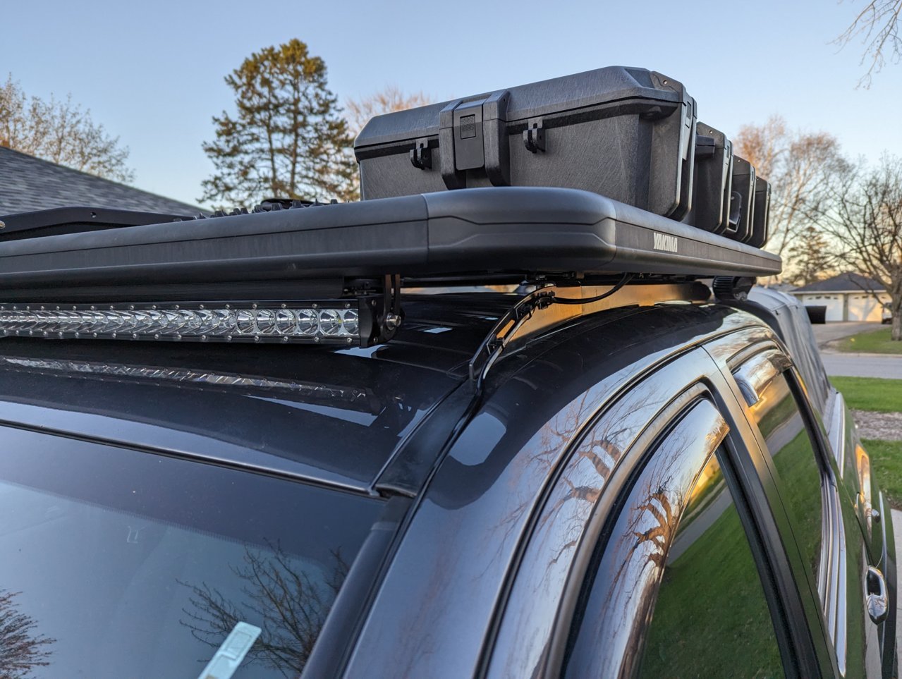

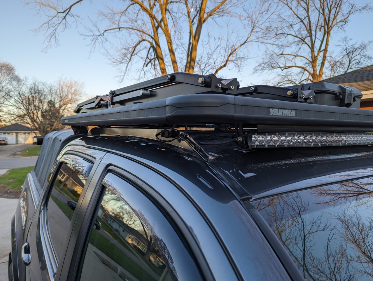

    Replaced my Yakima towers with an ARB roof rack mount.
    The roof rack is over the max weight limit of the Yakima towers when I put 2 bikes on it so I figured since the ARB mount uses all 10 roof bolts it might support more weight.
    Though the rack is still basically attached with 8 m5 bolts, I'll just make sure to not have bikes on my roof when I go off roading.
    I also got really lucky because the ARB mounts are just over an inch lower and the shark fin just clears the rack.

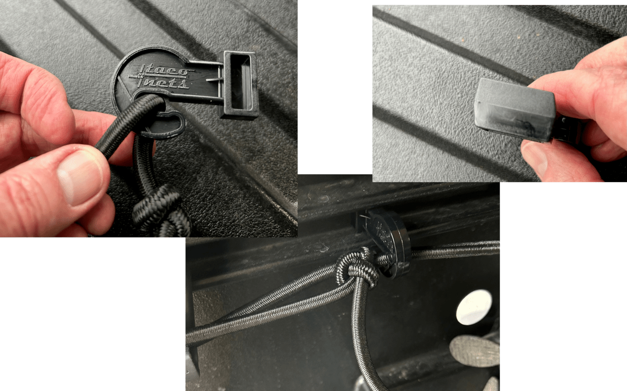

    I picked up a cargo net with special hooks that fit right into the bed rails. Just loop it on the net, put into the bed rail slot, and turn 90 degrees. Pretty slick!
    The brand, TacoNets, say they are a small US business (not sure where manufacturing is). Link below for the long bed; short is sold out. Don't be me and get the wrong one with the wrong hooks. But the owner 'hooked' me up with the correct Toyota bed rail hooks. So good people running TacoNets.

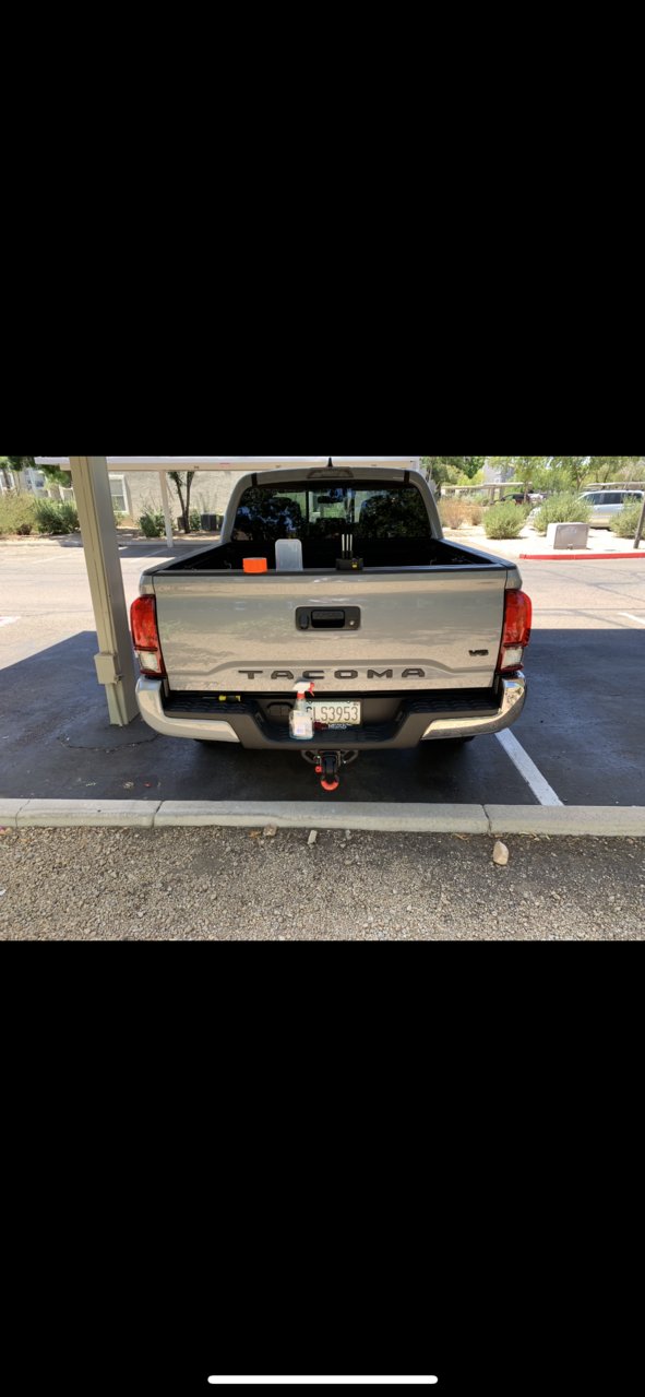

    Nice truck! I had the same problem back in 2019. There were no color-matched bumper shells on the market yet. I think just white and unpainted. I ended up buying the raw bumper shells and taking it to MAACO to be color matched. They charged me $85 bucks to color match with the cement paint. I've got an old photo I took while installing it. I always intended to post about that but never did!
    4 years later the paint still looks great!
