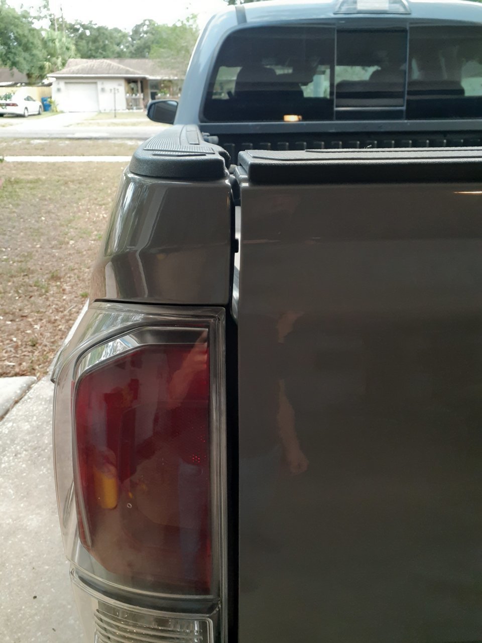

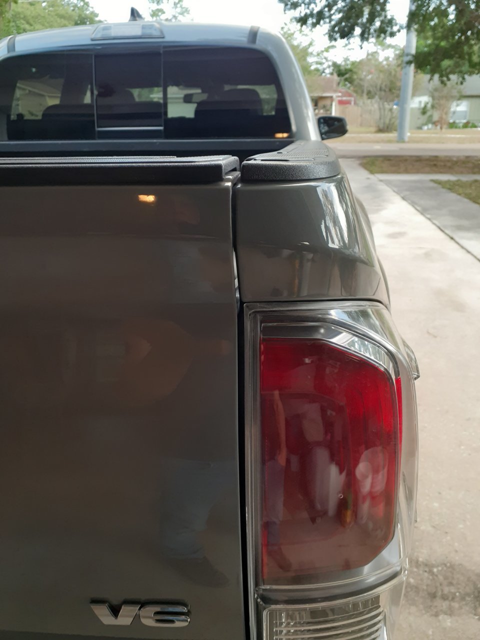

    I think im too late, right side is already tighter than drivers side. Crapola.

    It may be but a stiffener may draw it back in…just a thought. I put stiffeners on line knowing I was getting a canopy and wanting the extra insurance against issues. There’s a thread about bed cracks I’ve been monitoring lately. Maybe try drawing that gap closer with a ratchet strap and see if you can close it up a bit then that should tell you if stiffeners would be able to do the same.

    Very nice! I’ve been looking at that sale too. I really hope this works for you. I’d really give the ratchet strap thing a try…even if it’s just during installation to hold everything where it should be.

    How does this work? I don't have a ratchet just one of those pull with your fingers tight straps.
    I suppose I could improvise tie that little strap I have and then using a screwdriver put it in one of the straps and twist it.

    The All Pro ones I have installed actually talk about a specific way to tighten up bolts if there is a gap present when theoretically there shouldn't be. Tighten from the bottom to the top. I'm assuming that means that you can pull in a bedside that has started leaning out. Perhaps you want to consider one of the brands that go up all the way to the top like total chaos or All Pro.

    I would attach the a strap that you can get some pressure to get it back to where it’s suppose to be. I would attach the strap to the upper most corners by the tail lights and gently apply pressure. Then with the bed where you want it, locate and drill the stiffeners in place. Something like below

    No problem! It would give a good idea of the amount moved and see if you can get the bed to the spot you want it. Also, would help you keep the bed there while installing the stiffeners.

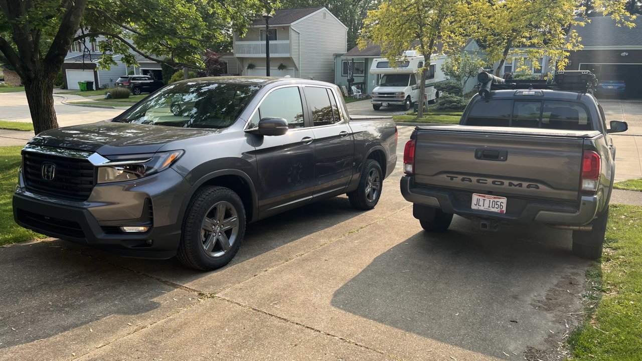

    Ridgeline NOT FOR ME! Yuck! but hey to each his own! It's a mini-van with a bed!

    Def not for me either. I’ll take the odyssey back. Much more room. And we converted it to add a platform and drawers for when we camp. Nice little setup.
