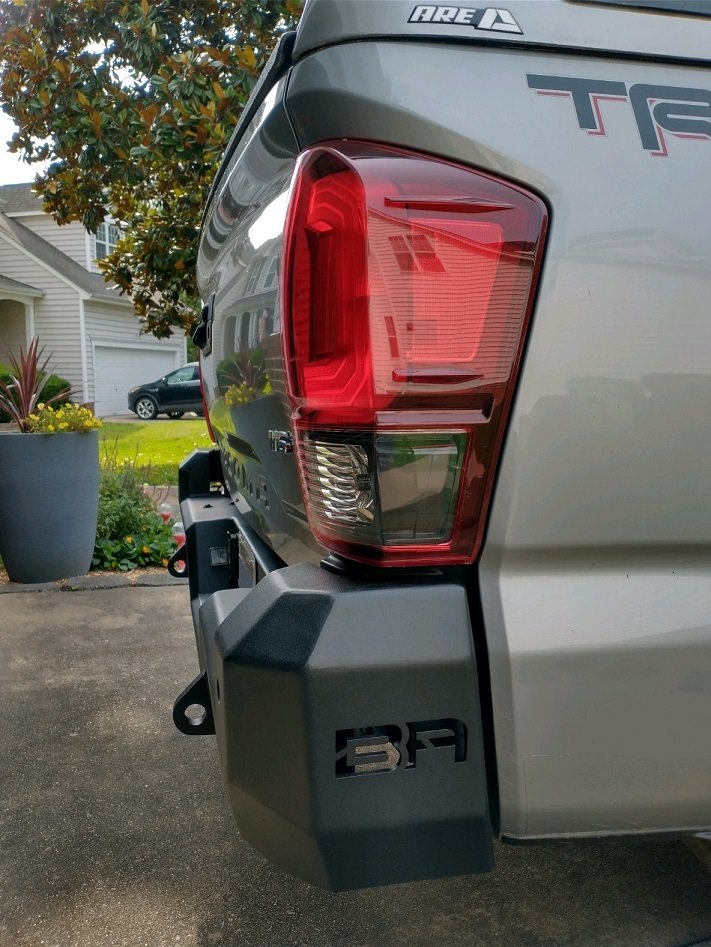

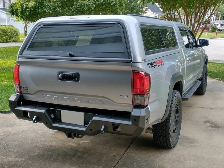

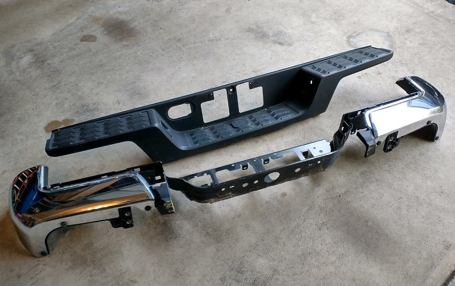

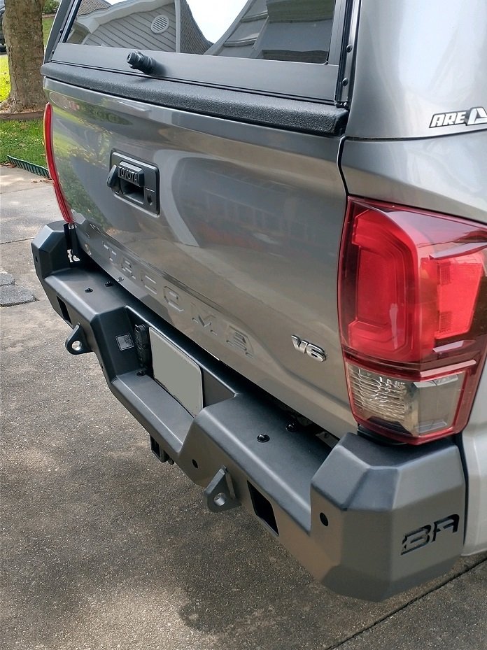

    I got rid of 14lbs of plastic & aluminum and added ~83lbs of steel.
    I got the Body Armor 4x4 Pro Bumper on sale for $510 with free shipping over Memorial Day. I still need to add some pod lights to it.
    Not a perfect bumper but an okay one for the price point.

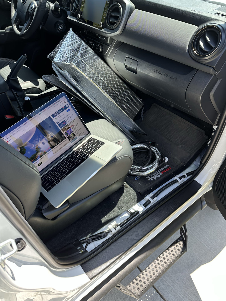

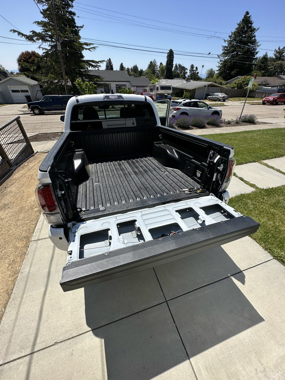

    Yesterday we finally got sun so I took advantage and installed my factory tailgate remote lock

    Interesting, i installed mine down the drivers side of the vehicle and under it, tough getting my hands under the vehicle in tight spots. but i did it. i didn't use factory i used an after market kit, but works just as well.

    1st thing is I love steel front and rear bumpers. Not trying to be a negative Nancy here but I would like to clarify a misconception regarding steel rear bumpers on 3rd gens. The only extra protection that they provide is saving the plastic oem bumper caps in very minor accidents. A friend of mine added a nice steel rear bumper to a 2020 Off Road. He was hit in the rear at roughly 40 mph. His truck was a total loss. The bumper was not badly damaged however the engineered crumple zone frame, under the bed, did buckle and that bumper did nothing to save his truck. At least the insurance company added the new bumper cost to the value. It may be a better bumper but it is still connected to a frame designed to bend on impact. In comparison I was rear ended in a 2nd gen Tacoma, in 2015, while sitting at a stop light, at around 30 mph. The kid never hit his brakes. His car was a total loss. I polished his paint off of my 2nd gen chrome rear bumper and there was no frame damage. All that I had was a couple of small dents in that bumper.

    guess aftermarket ones have different installation steps...I also had a hard time getting my hands/arm between things to get the zip ties on but overall it was a pretty straight forward installation.
