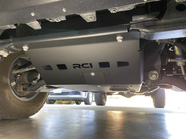

    I have protection…new RCI skid installed…

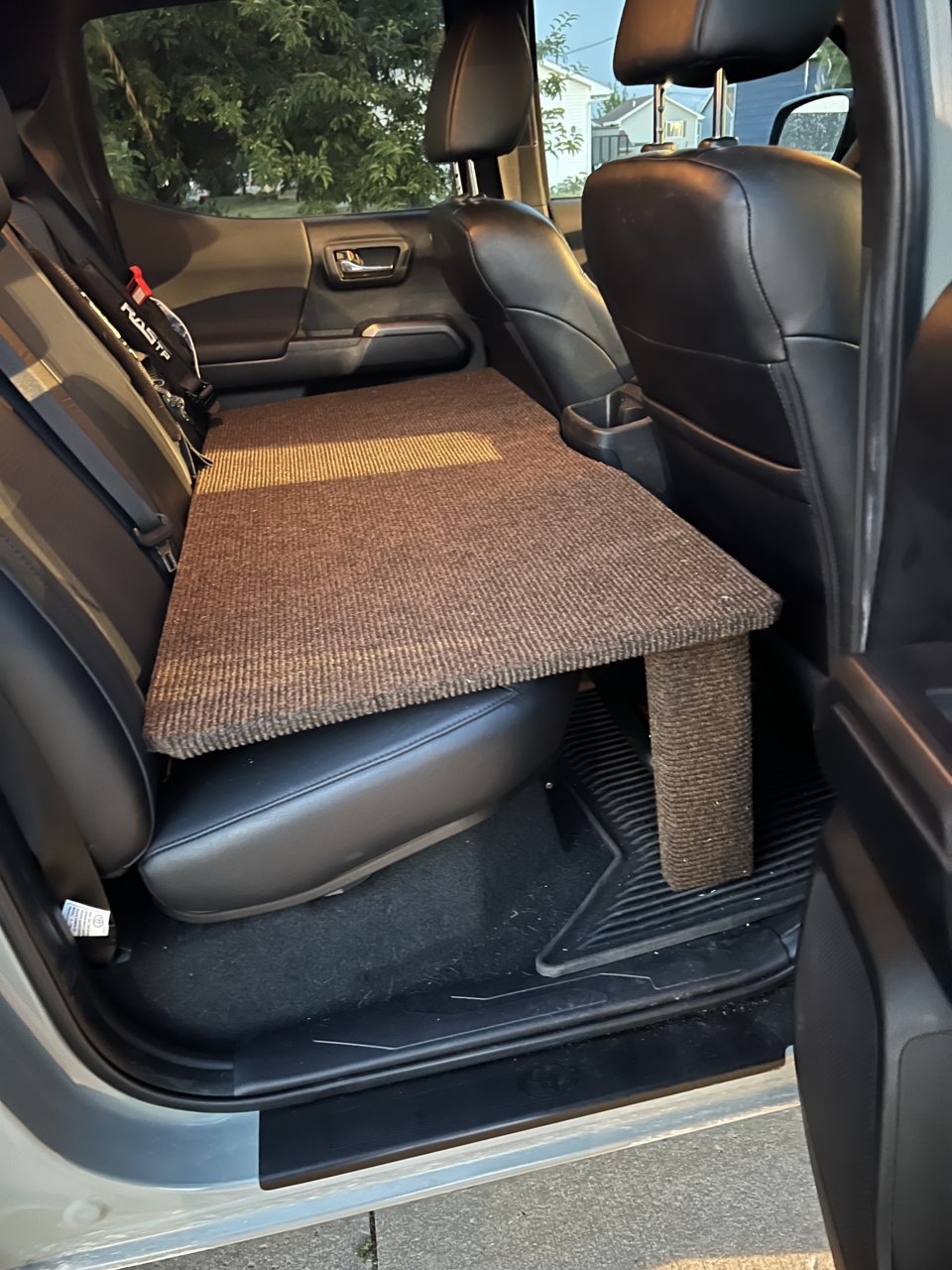

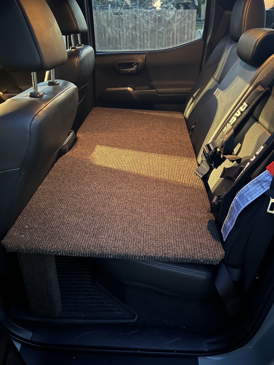

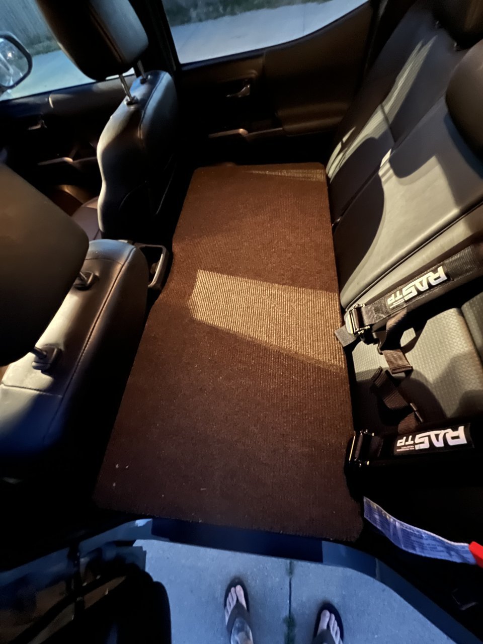

    Backseat dog deck.
    Just finished this up tonight as it’s getting dark. The Tacoma back seat was horrible for my bloodhounds due to the small size and their inability to think critically about why they keep falling on the floor between the front and back seats. So I’ve seen some similar simple solutions and thought I’d share my attempt.
    The deck is 24” x 53” 1/2” OSB because I had a good scrap piece in the garage. I laid that in and penciled the clearance for the center console. I used indoor/outdoor carpet wrapped over it with 3M spray adhesive and staples holding the upholstery. Then a solid bottom sheet of the carpet to complete and finish the wrap. I opted for the brown because that’s what they had at Menards with a texture on it and hopefully it will hide the hair a little better. The black carpet was smooth and thinner so this will hopefully be more comfortable and offer more traction.
    Legs are spare pieces of 2x4 cut to 13”, screwed together into L shaped and upholstered with the same carpet. Then I used deck screws through the top to mount them. It’s light and easy to install/remove.
    I’m sure someone smarter could engineer a folding and easier to store option, but simplicity seemed like a better route.
    This weekend I’ll see how it does with my two idiots.

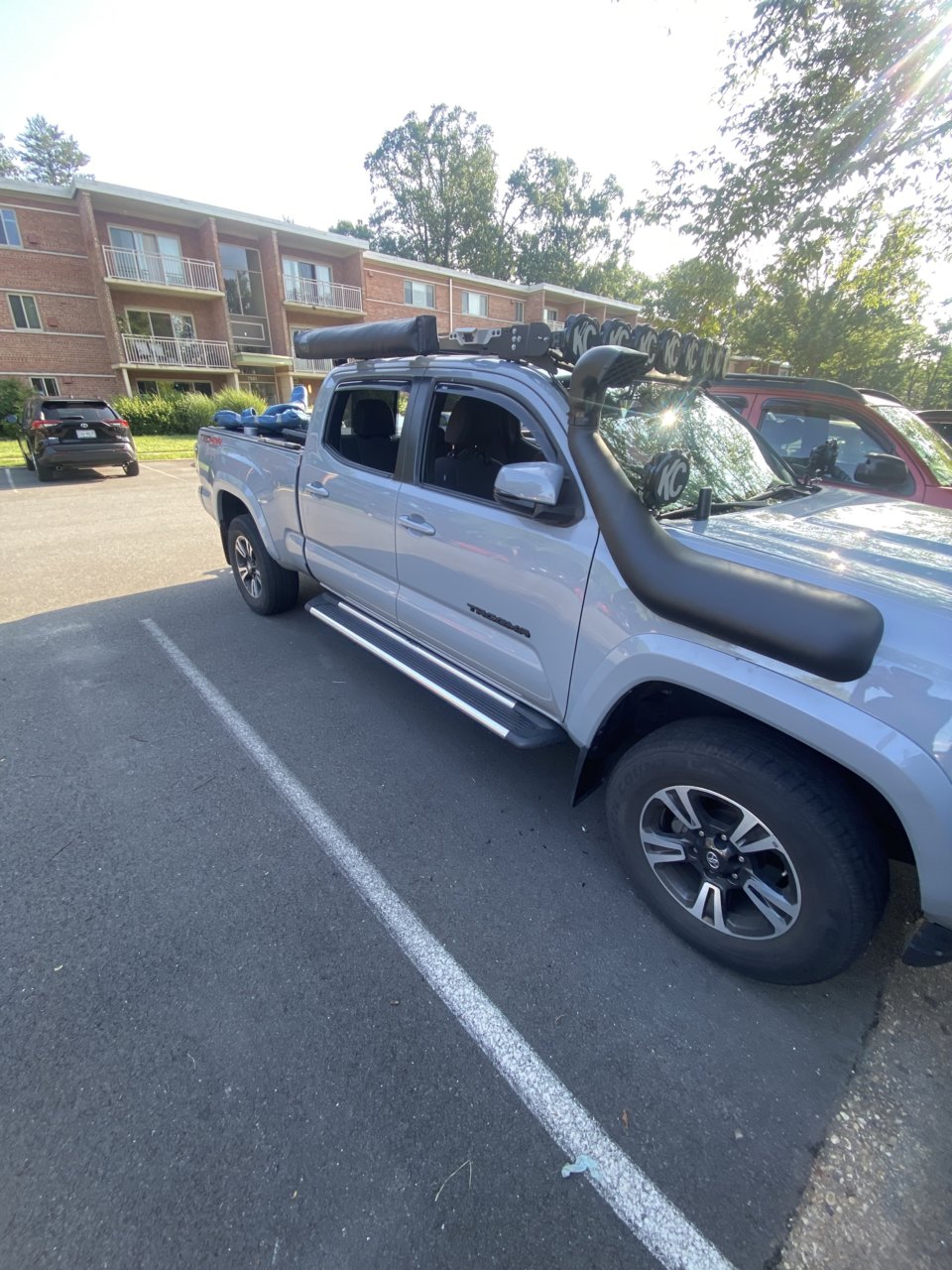

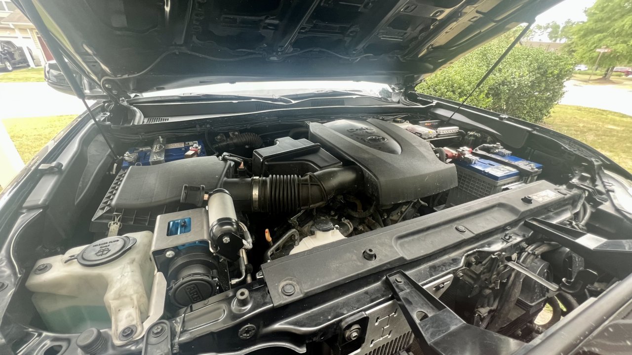

    Installed my ebay snorkel earlier today, did it in a little over 5 hours taking my time so I didn't mess any other parts up. I also changed front fenders since I found one really cheap on fb so i could keep my original because I was scared of messing up.
    The snorkel DID plug n play with my S & B Cold air intake box so it was great being able to keep that thing after looking on tw and only finding a couple "it doesn't fit" threads
