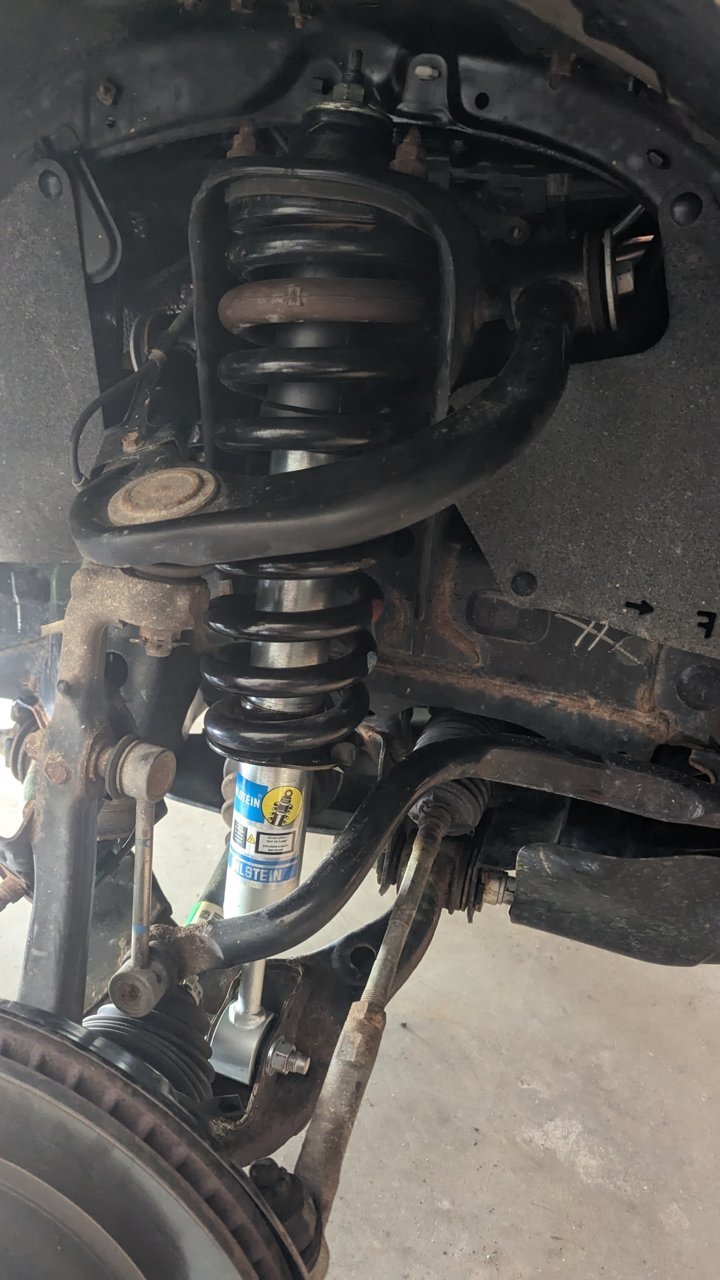

    PXL_20230806_174310456.jpgjust finished installing 5100s on all corners, set the front circlip at +1.1, and replaced the lower shock bolts with the Toyota 90105-14104 bolts to eliminate the clunk. I'll get the alignment done this week and be good to go

    looks good :thumbsup:
    I plan to do the same, what size tires do you plan to use?

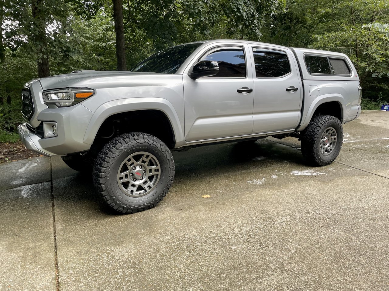

    PXL_20230806_202713668.jpgleveled it out for sure, next go around I might get bigger sneakers but will cross that bridge when I get there

    Nice !! Looks good with the stock sneakers to :D:cheers:

    very nice indeed!
