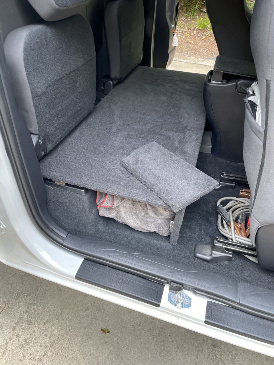

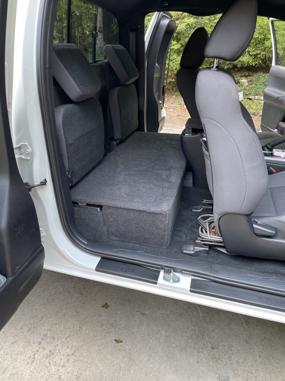

    S9AhES6pQYGQBJc5NU8edA.jpg I have a 2018 access cab and I made a flat platform above the rear seat area so my small dog would have more room when we're traveling but it also works well for an ice chest, groceries, etc. Decent storage underneath for my portable compressor, tool kit, tow strap and winch accessories. The end caps are held in place with some strong magnetic catches. I carpeted it to match. Lifts up and out easily when I need it gone. I'm pretty happy with the end result.

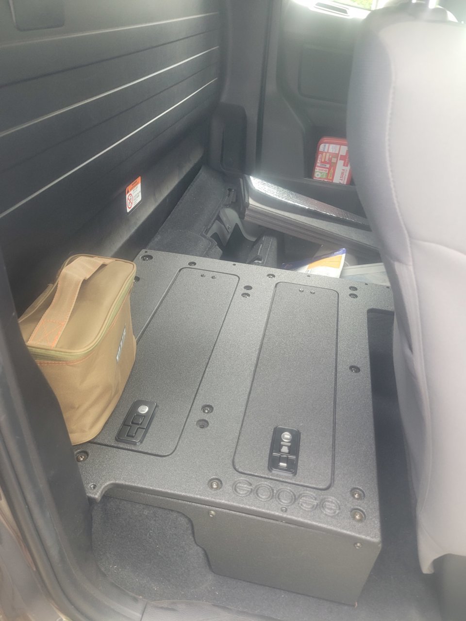

    Funny you posted that. I just put in a goose gear delete on one side. Plan on doing the other side soon.

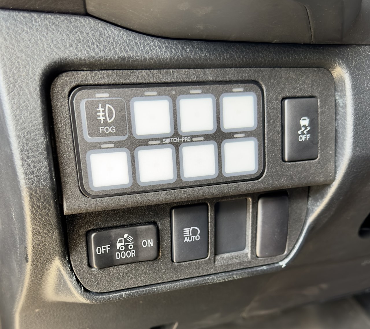

    Made it. The side ones were made by me and a router. The middle one I designed, and @paranoid56 cut it out for me.
    On the SSC2s, I wanted to have the option to turn them on and off with reverse, or anytime with a battery trigger. So I did use a 3 way switch for those, but the switch drives a relay for me. There are going to be more SSC1s on the rack on top of the topper, so the amps start to add up. Those VLED reverse lights are pulling 5.5A as it is, so they can really add up quick. I also have a power distribution in the rear, so relays were easy enough for me. Is all I use stock wiring for is triggers for relay if anything is going to pull more than about a half an amp. Like I said, nothing wrong with the way you did it, but I tend to overdo things :p

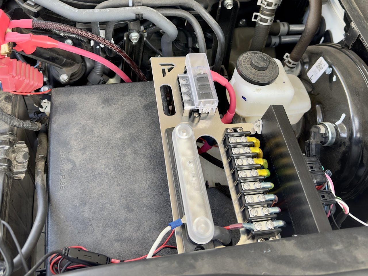

    Here is the power block behind the taillight if anyone is curious (another project from Paranoid Fabrications BTW. He made me the mount for this so it uses the stock bolts and gets it around some of the bends in the sheet metal):
    That block feeds a 96 position GEP distribution that has 13 relays, 10 diodes, 2 additional fuses, and 2 buss bars. So as you can guess, I have a few other things going on back there already.

    Todays excursion into making my SR do things SRs aren’t supposed to: AUTO LOW BEAMS!
    I know, they are standard now, but my 2019 didn’t come with them. I can disable them at anytime, and the headlight stalk switch still works like factory if they are disabled. The pictures don’t look like anything exciting, but to me it’s been a long road here :D
